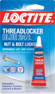

WHX?? 52,231 #3 Posted January 25, 2018 Hello Arthur and Your predicament is not unusual and hopefully easily fixed. Assuming you are talking about the oil drain/nipple coming out the back of the motor. First thing you must do is drain the oil. then loosen & remove the four bolts holding down the motor to the mounting plate. This will enable you to raise the motor up in the rear about a half inch or so. Wedge something suitable under it to hold it up there. This will enable you to remove both the drain pipe and then the elbow and the pipe that threads into the block. Check all threads for imperfections. If it looks suspicious replace it. They will be 3/8 NPT thread easily found, well maybe not on your side of the pond?, at any hardware store. Clean the female threads in the block very carefully and inspect. You might have to get in there with a cotton swab and some solvent as the threads must be clean and grease/oil free. I would suggest the product below but any quality thread locker would work. Get advice from the hardware store or auto store to see what's available in your neck of the woods. Reassemble the way it came apart, do take Jeff's advise on tightening. Refill with oil. and your done! Might be a good time to change the filter like above while your at it. 4 Share this post Link to post Share on other sites

Arthur England 5 #11 Posted January 26, 2018 Thank you all for your repies. I will get some of the loctite mentioned and give it a try. If that fails I migjht try one of the quick drain taps as there would be less lenght to resist vibration and if all else fails it might come down to a drain plug. I guess that its not that onerous to unbolt the motor once a year if the drain threads are not up to keeping the remote drain tube secure. I take the point of the never being sure of getting all the old oil with the vac tube, even if you reverse up a slope with one back wheel to tip the oil forward and towards the dip stick corner. I have bought a new filter and will next have to decide what the best oil is. My other mowers etc all get Groundforce SAE30 Use above 0 centigrade colder than that and they hide in the shed! The oil meets the API SF in the manual but I have seen discussions regarding synthetic oil. Cheers Arthur. Share this post Link to post Share on other sites

onanparts.com 185 #13 Posted January 27, 2018 On 1/25/2018 at 2:35 PM, 953 nut said: The 520-H is a great machine though the Onan engine parts are getting scarce here too. Agree the 520-H is a great machine! Disagree that Onan engine parts are getting scarce. We are not having any problems getting them. Cummins/Onan is still manufacturing all the common replacement parts. Pistons, rings, con rods, carbs, gaskets, seals, stators, voltage regulators etc. Millions of parts in stock at the Onan warehouse in Mephis. Also a vast amount of NOS, New Old Stock parts available. On the oil drain pipe nipple, as others have already stated, Loctite or any good thread sealant at the pan will eliminate leaks etc. 2 1 Share this post Link to post Share on other sites
