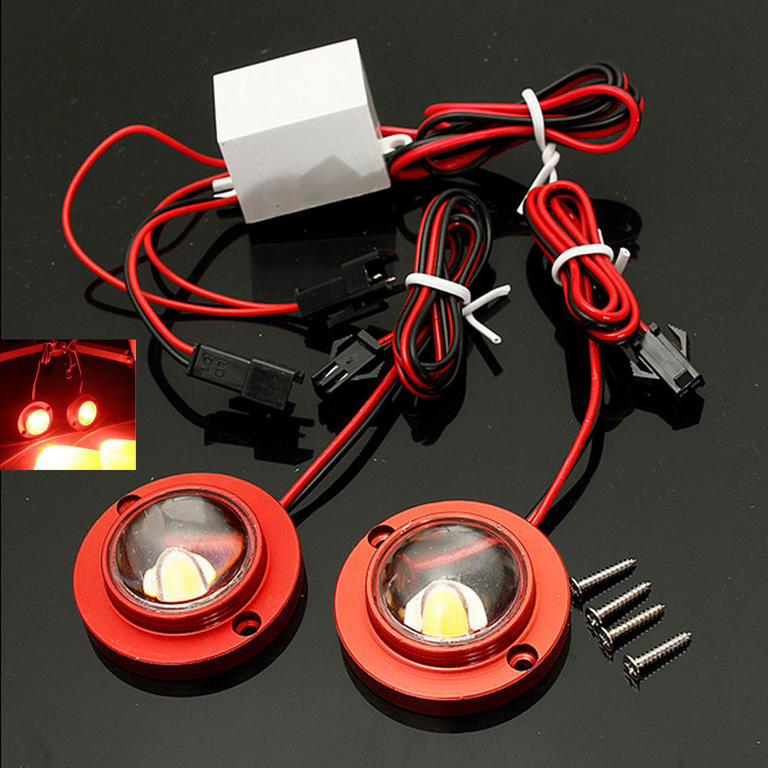

edgro 680 #8 Posted February 4, 2018 If you look at auction for Flashing motorcycle brake lights, you will find these I put one on each side of tractor for having to back out into the street to clear the driveway camera don't seem to like them, here is video flashing against the shed MVI_1376.MOV 3 Share this post Link to post Share on other sites
