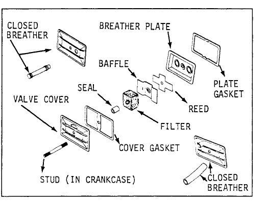

WHX?? 54,500 #10 Posted January 25, 2018 (edited) Yup same hole on mine so guessing it's supposed to be there. Sounds like you know how to build a motor Jake and with all Kohler parts sounds like you got some coin stuck in it too. I'm guessing you have the breather cover all back together right but double check yourself. Make sure that little hole on the inner cover points down. Also check the covers for flatness. Wouldn't. hurt for some gasket maker or sealer around those covers. All of them seep a little just more noticed on fresh red. From the service manual for your convenience. Still don't like the looks of that oil. Are you using the tractor for snow duty? Maybe getting some moisture in that way? Edited January 25, 2018 by WHX14 1 Share this post Link to post Share on other sites
