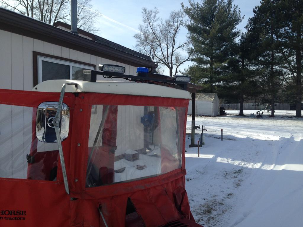

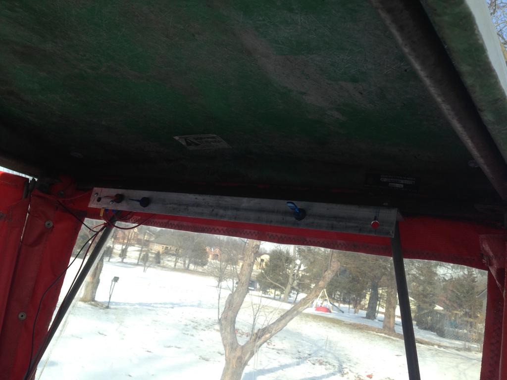

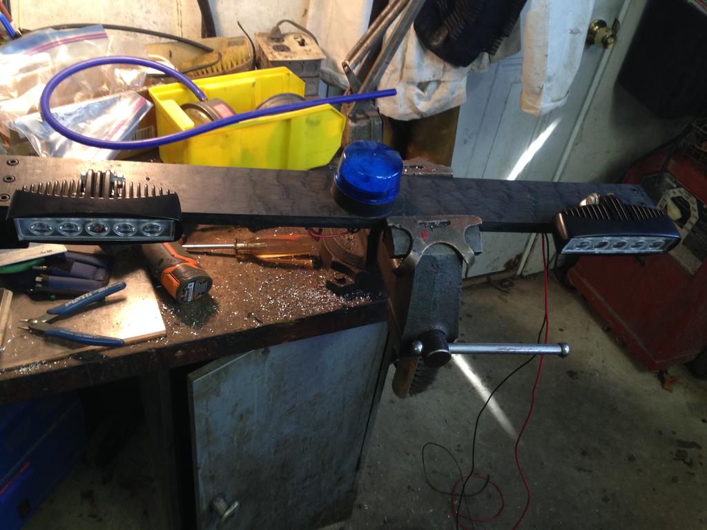

56servi 28 #1 Posted January 21, 2018 I got this 520H about a month ago to get the snow off the drive. I had a walk behind thrower before this and a C175 with thrower & cab before that. Temp got into the low 40s today so I wanted to get the lights mounted & working. I wired the switch directly to the battery with a 10A fuse in line. The bar is made from a piece of 3" wide by 3/4" thick nylon I got at work. I have 2 LED lights at each end and a blue flasher in the center. Alll from ebay. The switch bar inside is a piece of 1" x 2" aluminum angle. I have 3 switches mounted but am only using one for now. It turns on both the flasher & lights. In the spring I will have a separate switch for the flasher, 2 lights, and inside dome light. I wired the ground & 12 volts directly to the battery to save time today. The 12v wire has a 10A inline fuse connected. I will change the 12v supply to come from the key switch on position when I do the other changes. I also added the rear view mirror with home made mounting bar made from electrical conduit. I live on a dead end street with only 5 houses past me, but the young girls go driving past without slowing down. I dont always looking behind me when backing into the street so figures I needed a little warning light on the tractor. 8 1 Share this post Link to post Share on other sites

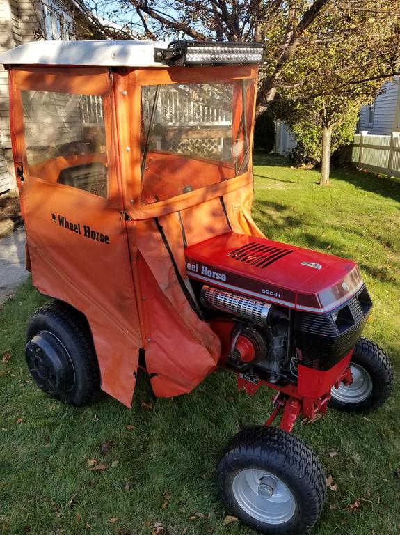

BaySide1 138 #6 Posted January 21, 2018 that Blue light could get me in trouble with Johnny Law here in Massachusetts Just now, BaySide1 said: that Blue light could get me in trouble with Johnny Law here in Massachusetts I have a very bright LED Light Bar 2 1 Share this post Link to post Share on other sites

r1jakecfd 51 #11 Posted January 21, 2018 6 hours ago, BaySide1 said: that Blue light could get me in trouble with Johnny Law here in Massachusetts I have a very bright LED Light Bar What brand/model of light bar is that? Your 520 is setup with cab like mine but definitely much prettier👌 I run a 44” 2 Stage blower. Share this post Link to post Share on other sites
