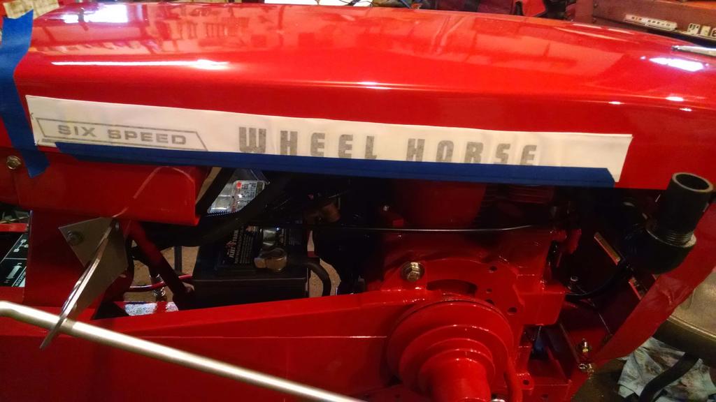

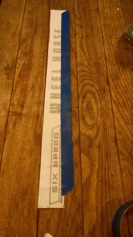

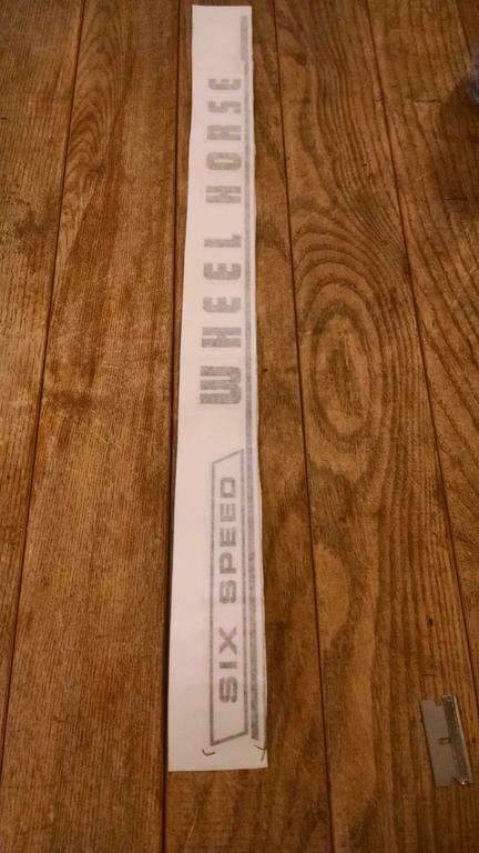

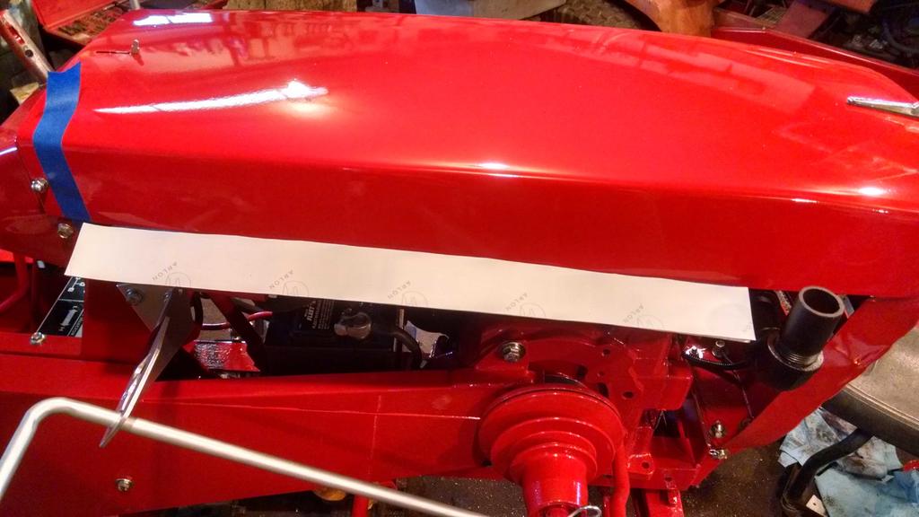

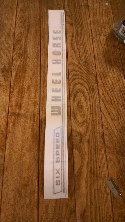

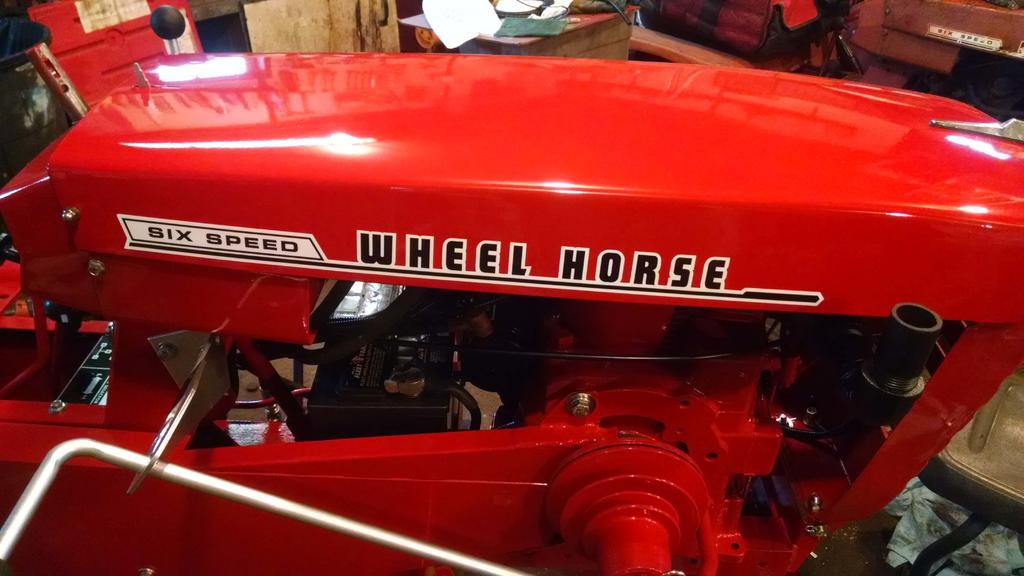

Achto 32,950 #128 Posted April 1, 2018 (edited) Assembly was going so smoothly that I for got to take many progression pictures. I slowed down when I got to the decals though because I wanted to share my method of installing them with you. First pic is the decal as received from the supplier. I usually like to work with the top of a decal but the nice strait line along the bottom of this decal made me choose to work with the bottom. You will notice that I drew a line along the bottom of the decal, I did this because the white on white edge was hard to see. Next I trimmed the paper off along the edge of the decal. After trimming then I put a strip of masking tape, half on the decal / half off along my trimmed edge. I stop the tape short of the ends of the decal, this allows me to be able to see the ends of the decal for alignment. Next I clean the surface with glass cleaner. Now I can use the masking tape to hold my decal in place. I position the decal and take measurements and reposition until I'm completely happy with the location. Once the location is perfect then I press the masking tape down tight a long the full length of the decal. Next step is to fold the decal down using the masking tape as a hinge. Now I clean the paint surface again with glass cleaner. Now I remove the backing from the decal and fold it back into place. Starting in the center of the decal I work all of the air out towards the outer edges. This method works very well for me. As for the rest of the tractor? Well, if I hadn't procrastinated so long with my hubs I could have been able to go for a cruise. I have finally decided what I'm going to do with my hubs, hope to share that soon. No hubs, no ride but I was able to fire engine and watch the paint cure on the exhaust stack.Ooooo,Ahhhh As long as it was running I worked all of the air out of the hydraulics and ran through all of the gears on the tranny. So far every thing checks out great. Very happy with the way that my belt guard for the hydro pump turned out. Edited April 1, 2018 by Achto 15 Share this post Link to post Share on other sites

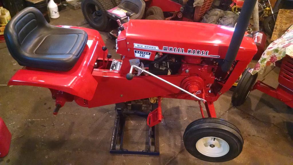

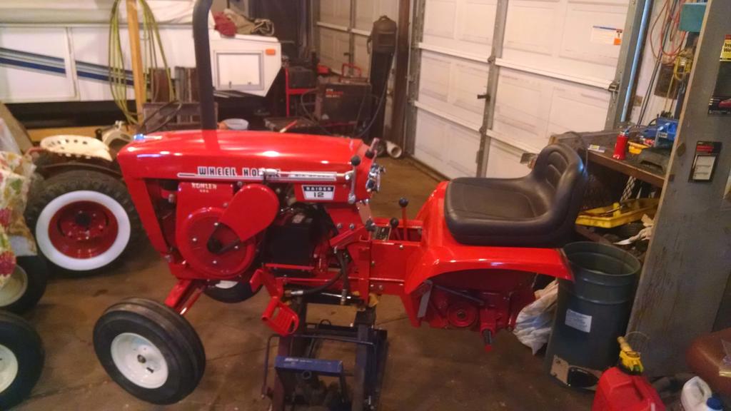

953 nut 70,542 #129 Posted April 1, 2018 1 hour ago, Achto said: Very happy with the way that my belt guard for the hydro pump turned out That is slick! I presume that is a HY-2 or HY-3 pump, very nice actuation lever setup. 2 1 Share this post Link to post Share on other sites
Achto 32,950 #130 Posted April 1, 2018 3 minutes ago, 953 nut said: I presume that is a HY-2 or HY-3 pump, very nice actuation lever setup. The hydro pump is a Century Fox. It was made by the Hien Werner company, the same company that made the HY pumps for . Unlike the HY's this pump turns clockwise which is why it drives off of the fly wheel side instead of the PTO side of the engine. 3 Share this post Link to post Share on other sites

Achto 32,950 #133 Posted April 2, 2018 (edited) No worries, this tractor will definitely pulling a plow, "Gotta get a little mud on the tires" I think that you're guess on my show load for this year is spot on... unless I buy a bigger trailer that is. 30 minutes ago, WHX16 said: Afer re reading your post Dan since that pump has the same internals as a Hein it is NOT bi-directional? The input shaft is in a different location. In the pic below you can see that rotation was determined by where they placed the input shaft at the factory. Check out the arrows by the shaft. The shaft on mine is placed by the CW arrow. Edited April 2, 2018 by Achto 2 2 Share this post Link to post Share on other sites

Achto 32,950 #135 Posted April 2, 2018 1 hour ago, WHX16 said: What is your source on the seat...comfy?? That seat came from the Milsco factory here in town, ( I know some people ). I'm sure that there is a void in it some place, but I can't find it. Unfortunately I think this exact style has been discontinued, which is too bad cause it is pretty comfy. 2 Share this post Link to post Share on other sites

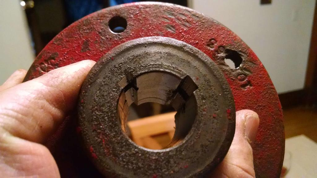

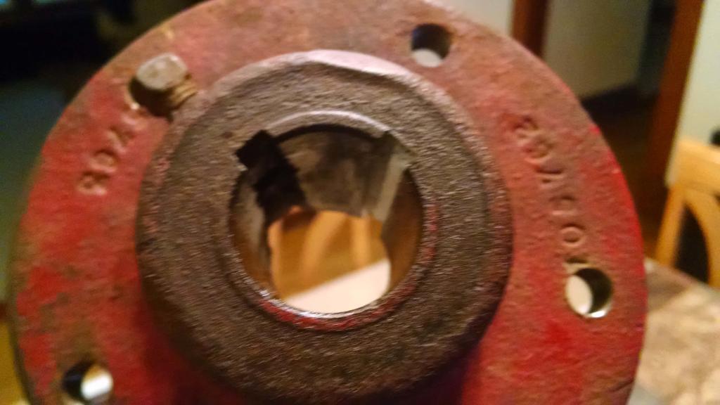

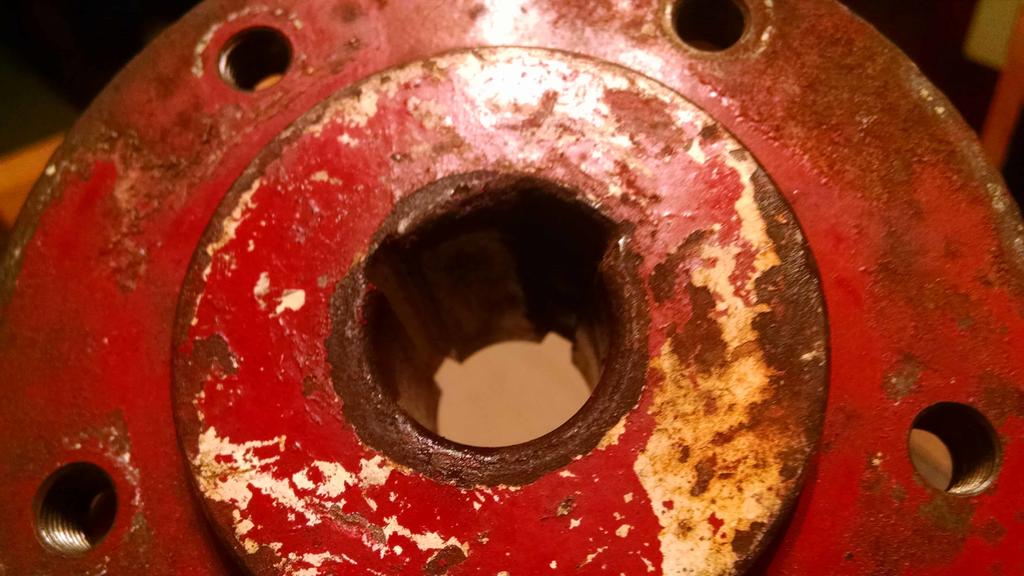

Achto 32,950 #142 Posted April 4, 2018 (edited) Right now I'm a happy boy. Hopefully my happiness will continue for years to come with my experiment. The key ways on my hubs were in terrible shape & it bugged me to think of throwing them away. After some deliberation and a lot of questions I decided to try this. Cut a new key way 90 degrees to the old one. Drill & tap a new set screw hole for the new key way and use the old set screw hole for my secondary set screw. Any thoughts on this experiment welcome. Edited April 4, 2018 by Achto 4 5 Share this post Link to post Share on other sites

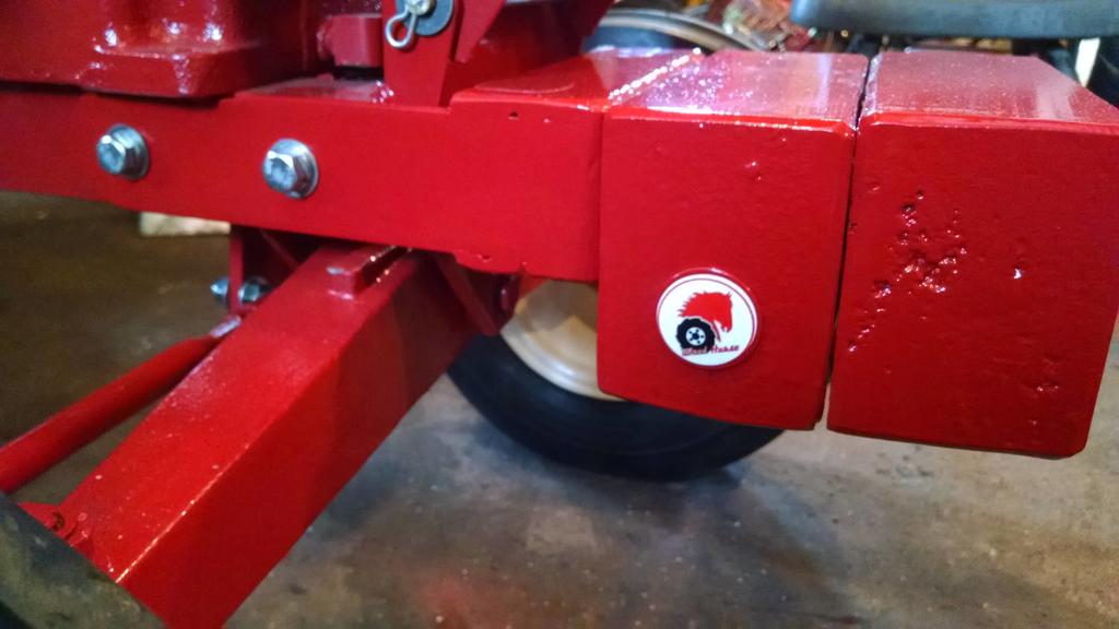

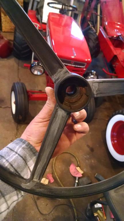

Achto 32,950 #143 Posted April 17, 2018 Working on the finishing touches. I figured out what to do with the unwanted holes in my nose weights. A couple of hole plugs adorned with some nice decals. Also working on repairing the cracks in the steering wheel. This is my first attempt at repairing a steering wheel. I ground all of the cracks back and filled them with JB weld, It still needs a couple of coats of a sandable primer, then wet sand & paint with a semi gloss paint. Hopefully it turns out OK. 4 8 Share this post Link to post Share on other sites

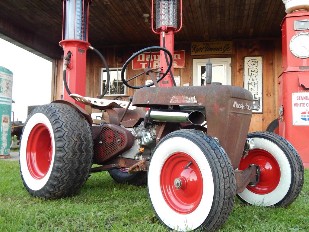

Achto 32,950 #148 Posted April 19, 2018 (edited) 3 hours ago, Joshn569 said: So a little off topic, but what lucky tractor gets to ride on white walls? Thanks for posting the link @AMC RULES !!! Here are a couple of my favorite pics of my lil monster. Edited April 19, 2018 by Achto 4 7 Share this post Link to post Share on other sites
PeacemakerJack 11,092 #149 Posted April 19, 2018 That’s what I’m talking about—thanks Dan for the SUPER I like both of them—I see a great trading card with both of those!!!! Just sayin... 1 1 Share this post Link to post Share on other sites
Joshn569 273 #150 Posted April 19, 2018 20 minutes ago, Achto said: Thanks for posting the link @AMC RULES !!! Here are a couple of my favorite pics of my lil monster. Thats awesome! Really cool rat rod concept. You definitely pulled it off. 1 Share this post Link to post Share on other sites
