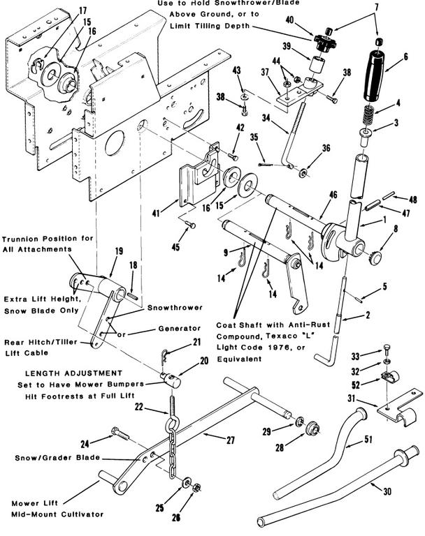

JimmyJam 542 #5 Posted January 19, 2018 While we are on the topic of "manual lift for attachments" (may be a bit ). However, I am looking for the WH illustration of the manual lift (rock shaft) that shows what holes are intended for. ie: deck, plow, snowblower etc. I tried looking in Manual section with no eval. I did see that illustration some time back. Just can't find it now. Any HELP would be appreciated. Share this post Link to post Share on other sites
gwest_ca-(File Mod) 12,281 #6 Posted January 19, 2018 2 hours ago, JimmyJam said: While we are on the topic of "manual lift for attachments" (may be a bit ). However, I am looking for the WH illustration of the manual lift (rock shaft) that shows what holes are intended for. ie: deck, plow, snowblower etc. I tried looking in Manual section with no eval. I did see that illustration some time back. Just can't find it now. Any HELP would be appreciated. Some of the tractor parts lists have what you are referring to I think. Believe there are named manual lift linkage or hydraulic lift linkage. Page 22 of the manual above for the GT models have this same page. Garry 1 Share this post Link to post Share on other sites
