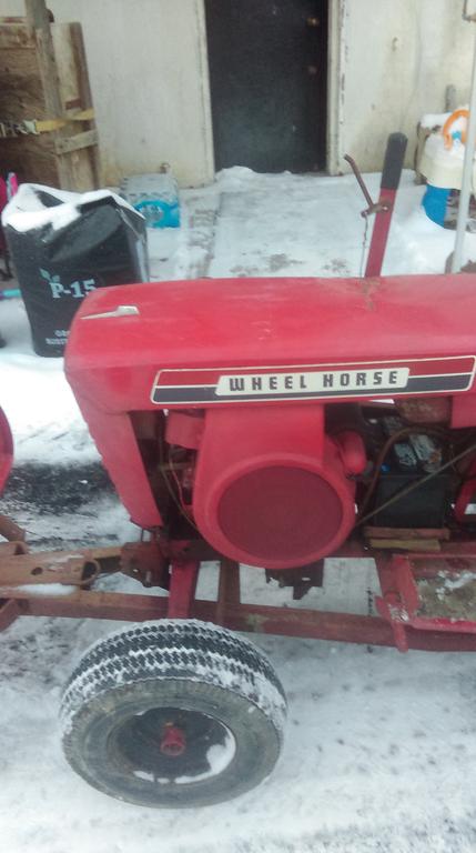

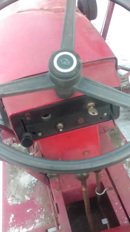

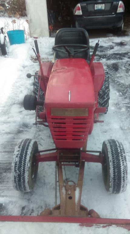

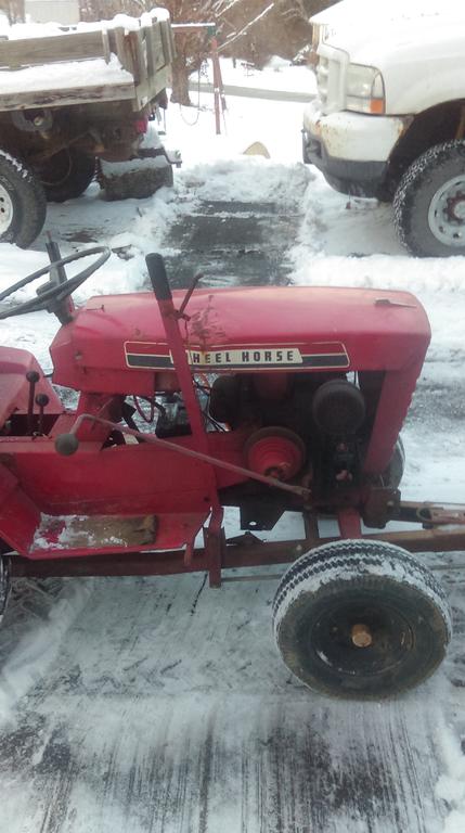

Rayrich53 2 #10 Posted January 16, 2018 Here's a few pics 2 Share this post Link to post Share on other sites
pfrederi 19,069 #11 Posted January 16, 2018 The engine has the breakerless ignition used on Chargers and Raiders...since it is a manual thinking Raider ???? 1 Share this post Link to post Share on other sites
Jakeshorsetuff 36 #12 Posted January 17, 2018 (edited) Check under the dash thats were they are on chargers.Looks like a charger/raider but could be an 857.If you can take a pic of the ID on the blower housing of the engine I could maybe give you the year of the engine. Edited January 17, 2018 by Jakeshorsetuff 2 Share this post Link to post Share on other sites
roadapples 6,985 #13 Posted January 17, 2018 Hood may not be original. Emblem is on backwards... Share this post Link to post Share on other sites
Jakeshorsetuff 36 #14 Posted January 17, 2018 I did see that and I don't no why the previous owner put the hood ornament on backwards?If you look at the first picture of the stick shifts it looks like some one put a hook on one of the shifters to keep it from slipping out, it's not a real concern right now though. Share this post Link to post Share on other sites
Rayrich53 2 #15 Posted January 17, 2018 I took it on a debt that was owed to me by a coworker, I think he might have tried his hand at mower pulling. Share this post Link to post Share on other sites
953 nut 62,522 #16 Posted January 17, 2018 I'm thinking a 1973, perhaps 12 HP. Share this post Link to post Share on other sites
Jakeshorsetuff 36 #17 Posted January 17, 2018 I’m thinking it is a 12hp or 14HP and hood is definitely not original.It’s not a 857 because the pto setup does not match a 857 but what it does match is a raider.The pto does match a charger but a charger is an automatic and this one is a six speed I think. Share this post Link to post Share on other sites
953 nut 62,522 #18 Posted January 17, 2018 8 minutes ago, Jakeshorsetuff said: I’m thinking it is a 12hp or 14HP and hood is definitely not original.It’s not a 857 because the pto setup does not match a 857 but what it does match is a raider.The pto does match a charger but a charger is an automatic and this one is a six speed I think. Take a look at the dash and the throttle/choke levers, 1972 or newer. Share this post Link to post Share on other sites
roadapples 6,985 #19 Posted January 17, 2018 Look at the front of the hood (grill).. Earlier than '72... Share this post Link to post Share on other sites
JimmyJam 542 #20 Posted January 17, 2018 Looks to me a 10-12hp. Kohler. Probably The "No-Name" series in the early 1970's with a 8-spd transmission. ???? ID tag would be on steering tower. Engine ID would be on the backside of flywheel shroud. Share this post Link to post Share on other sites
