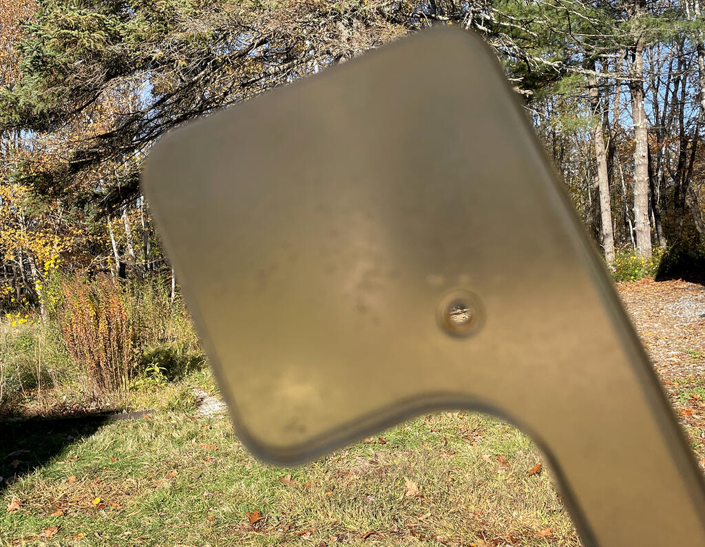

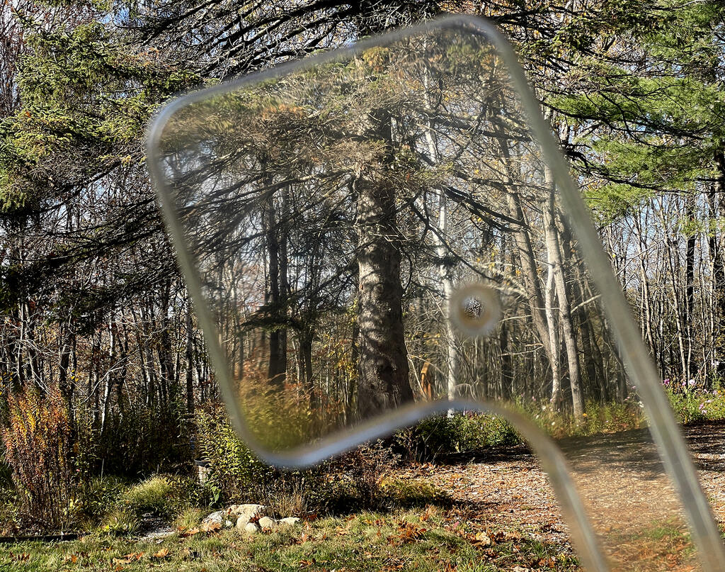

Blue Chips 822 #24828 Posted November 3, 2025 (edited) Just a small job today. The plastic instrument panel cover/lens of the GT18 was a bit yellowed and cloudy to say the least. Here's how it looked before cleaning: After about 30 minutes of rubbing compound, polish, wax...and elbow grease...it turned out pretty decent. Not quite as clear as glass, but not bad: I do run out of elbow grease once in a while, but usually a hot shower, a favorite libation or two, and a good night's sleep replenishes the supply. Edited November 5, 2025 by Blue Chips 12 7 Share this post Link to post Share on other sites

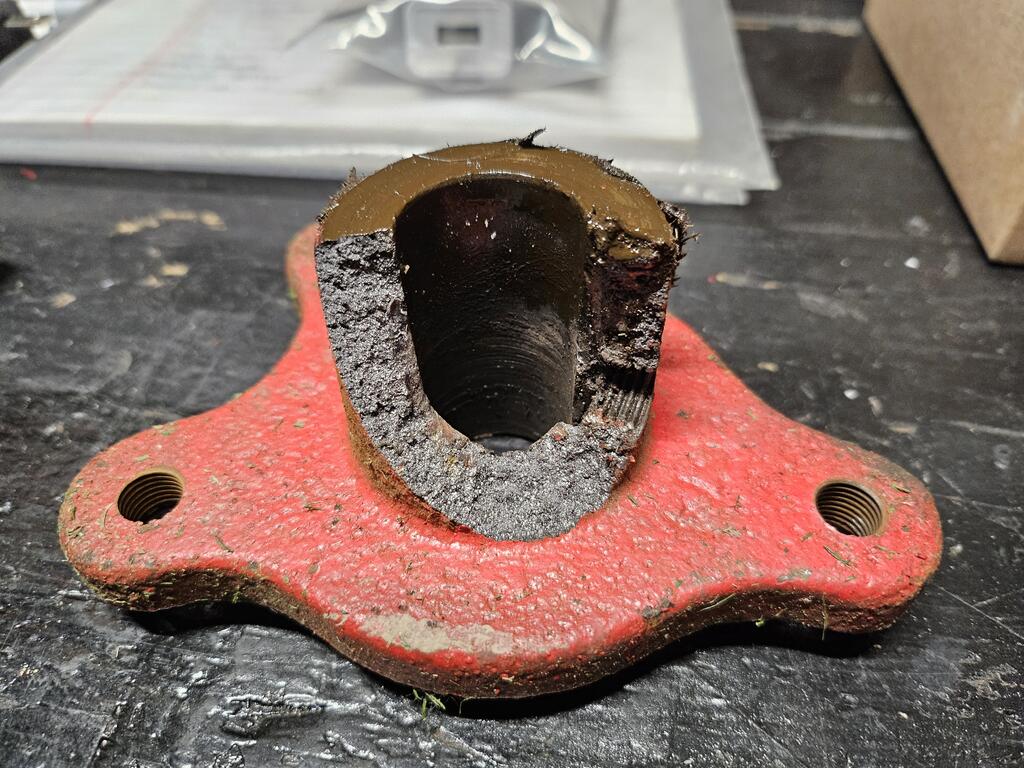

ML3 2,464 #24829 Posted November 3, 2025 Had to do mid mowing repair on 654. Left hub broke while mowing. Of course it happened in middle of the wettest, muddiest spot in the back yard! Fun when I was trying to jack up & repair. Fortunately I had the parts in my stash. 2 3 8 Share this post Link to post Share on other sites

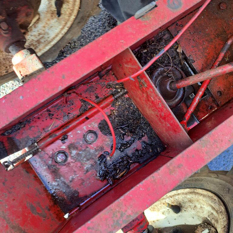

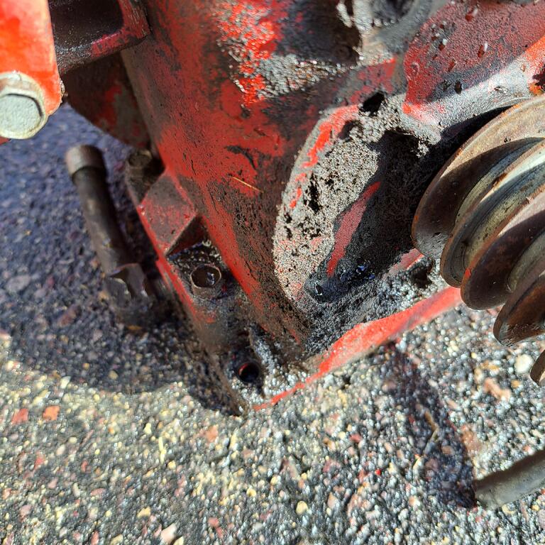

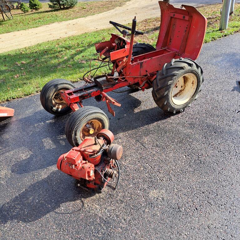

WHX?? 57,643 #24833 Posted November 4, 2025 Gave a 867 a bath before the washer goes nighty nite for the winter. What a greasy pig!!!! Pullstart brought this over from MI and I know fer sure we overpaid. Was having seller's remorse from sending another one back to Shynon but I needed his tool box worse. The crap was two inches thick on the motor & frame I kid you not. Spread the stuff out on the blacktop and walla ... seal coated. Never even tried to start it but probably wouldn't have taken much. Head gasket is blown among many other things. Nothing cobbled too bad that can't be reversed & strait sheet metal. good ags & orginal fronts in good shape. No sure what to do with it. Mechanical resto is right up my alley but missing lots of paint and don't think a touch up of rusty primer will do or look right. I've got a freshened up 181 shelf motor that is gonna go in it fer sure so partially dissembled it on the splash pad gut to get more crud off. 6 3 Share this post Link to post Share on other sites

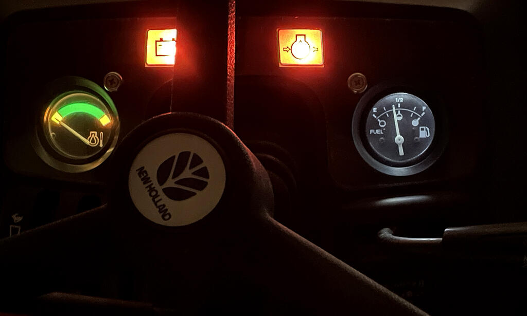

Blue Chips 822 #24835 Posted November 4, 2025 (edited) The fuel level gauge on my GT18 wasn’t working. The needle would peg all the way to full as soon as I switched the key on. First, I checked the sending unit. I didn’t remove it from the tank, but the tank was still unmounted, so I was able to slosh the partially full tank back and forth and check the resistance changes to see if the sending unit was responding more or less like it should. There was no apparent problem with the sending unit, the wiring to the sending unit was in good shape (not shorted), and the gauge and sending unit were both getting the correct voltage, so that pretty much narrowed it down to the gauge itself. OEM Toro fuel level gauges were $$$, so I found a universal-type replacement from Summit Racing with a 33-to-240 ohm resistance range at a fraction of the OEM gauge price. I had to substitute lugs for the original rubber three-socket connector and file down a plastic alignment tab behind the dashboard, but that was pretty easy, and it's working fine. The face of the gauge doesn't match the original, but it's the correct size and decent-looking (and it saved me about $150), so I can live with that. A couple of the warning lights were out, so I replaced all four of those bulbs, figuring that if two of them had burned out, the other two were probably of the same vintage and might not be far behind. They're all working now (shown here with the engine off and two of the four warning lights on): Edited November 4, 2025 by Blue Chips 4 Share this post Link to post Share on other sites

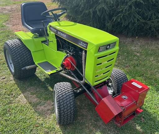

CRF857 498 #24836 Posted November 4, 2025 (edited) I pushed the C-141 out of the corner. Put in fresh gas, a battery, checked the tires and oil. Had to prime it to get the gas up to the carb, without doing a lot of cranking. Thinking about installing an electric fuel pump. Took it outside and started mulching leaves. May be a daily thing until they all drop. Or if it rains. Can,t get photos to upload. Edited November 4, 2025 by CRF857 Photos 3 Share this post Link to post Share on other sites

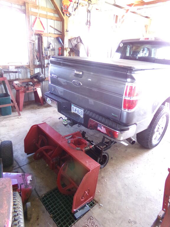

Ed Kennell 46,797 #24838 Posted November 5, 2025 Took the Ber Vac off the 520 and got it loaded for the trip to its new home tomorrow. 10 1 Share this post Link to post Share on other sites

Ed Kennell 46,797 #24843 Posted November 5, 2025 35 minutes ago, JoeM said: Ed you got rid of the snow beast? Gzzzz Yep, not a blowable snow for 10 years. So it's going to NE Ohio to take care of the snow coming off the lake. Now I can plow the sloppy wet snows we get in the warm cab. 6 3 Share this post Link to post Share on other sites
