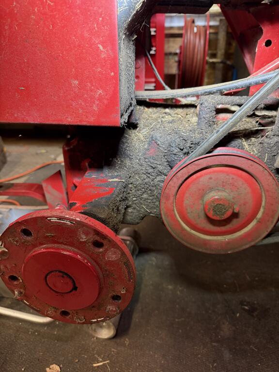

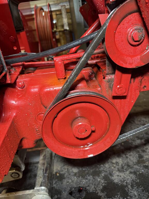

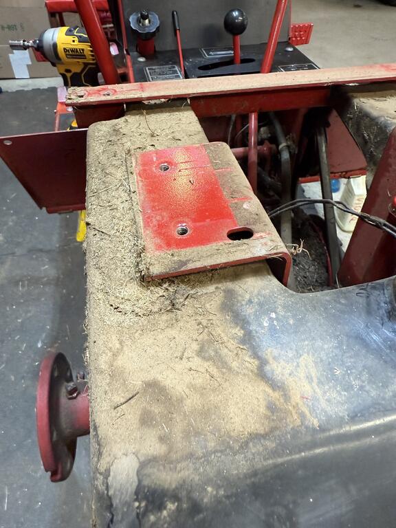

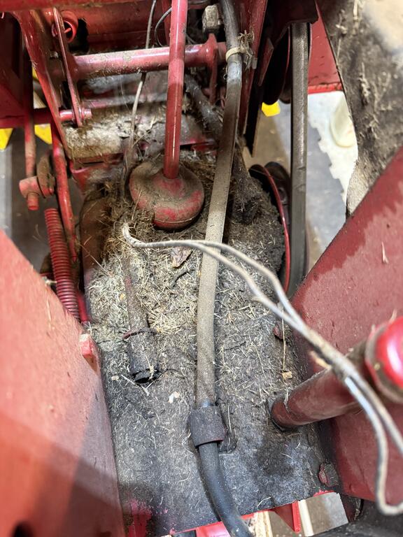

Sparky-(Admin) 26,621 #24326 Posted August 13, 2025 Continued with the deep cleaning of the C-85. A few before and after pics: 13 3 Share this post Link to post Share on other sites

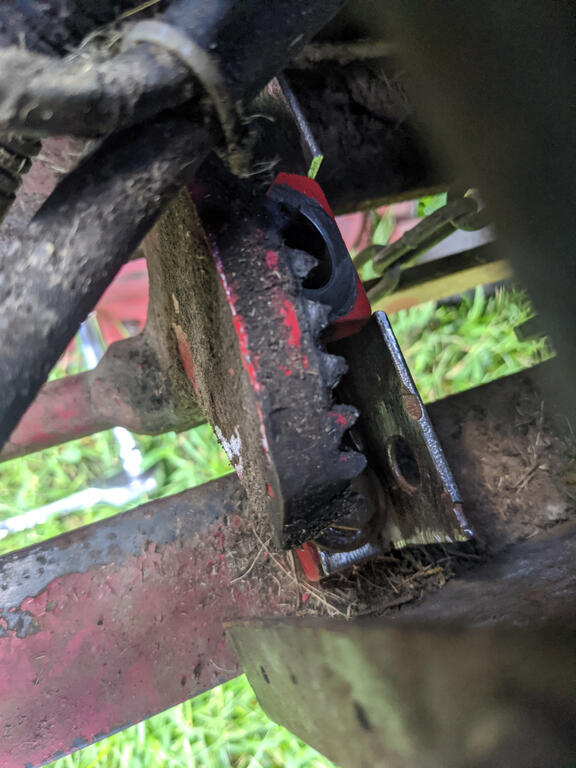

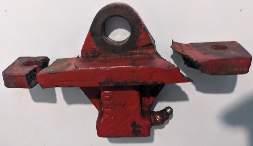

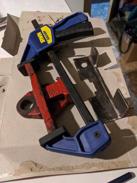

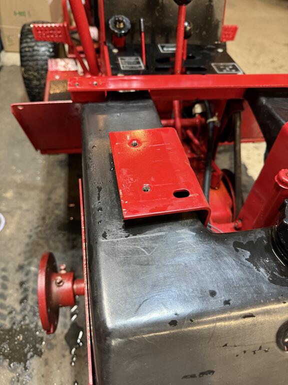

vogli 90 #24329 Posted August 14, 2025 There are some around here who obviously are known to do things right, and take pride in their work. However, *thumps his chest*, I am not limited by such quaint things things as skill and know-how. So, I fixed my steering problem with a no-weld, no-skill, no-shame solution. \ any bets on how many days it will last? 2 1 1 Share this post Link to post Share on other sites
ebinmaine 81,047 #24330 Posted August 14, 2025 3 minutes ago, vogli said: However, *thumps his chest*, I am not limited by such quaint things things as skill and know-how Share this post Link to post Share on other sites
Ed Kennell 47,750 #24331 Posted August 15, 2025 12 hours ago, vogli said: any bets on how many days it will last? 6,893 2 1 Share this post Link to post Share on other sites
c-series don 12,609 #24332 Posted August 15, 2025 And I if doesn’t last, Brian at K+B Wheel Horse Parts has them. 3 Share this post Link to post Share on other sites
JoeM 10,317 #24333 Posted August 15, 2025 Missed a spot Looks good! 1 3 Share this post Link to post Share on other sites

peter lena 10,103 #24335 Posted August 15, 2025 detailing belt belt belt belt pulley function @Sparky that upper idler pulley is in question . tiny bearings , metal flecks ,refitted / replaced the ones I had , often refer belt drag , noise / whyining , its not one part its the entire set up , also how easily do things move ? interesting since I have been on my belt related problem interest , have no belt fraying . splitting or related , anything , no screaming pto engagement , or sudden belt engagement . like to study a problem , and eliminate it , rarely if ever set it up the same way , or don't take advantage of when / how it messes up . only me . pete 2 Share this post Link to post Share on other sites

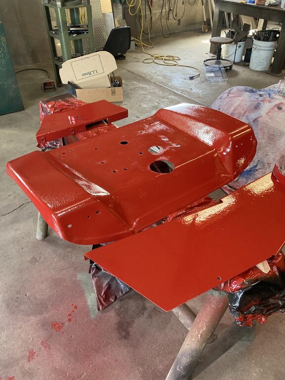

MainelyWheelhorse 3,170 #24336 Posted August 16, 2025 Today was paint day, I was also getting used to and dialing in my new gravity feed Husky paint gun. I got it in June for my birthday. The panels overall are going to need a little sanding and touch up especially the rear pan and guards as they were the first thing painted. The hood turned out great and no runs overall. It’s a learning curve. It beats using a spray can too. 3 5 Share this post Link to post Share on other sites

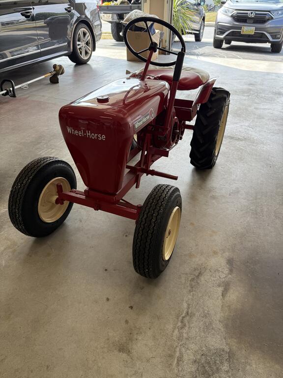

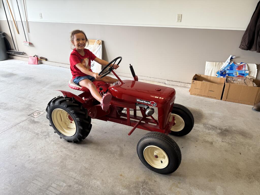

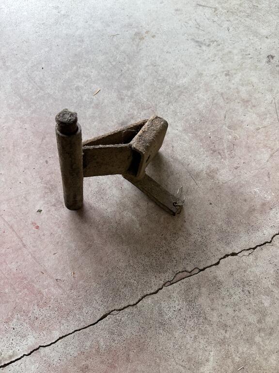

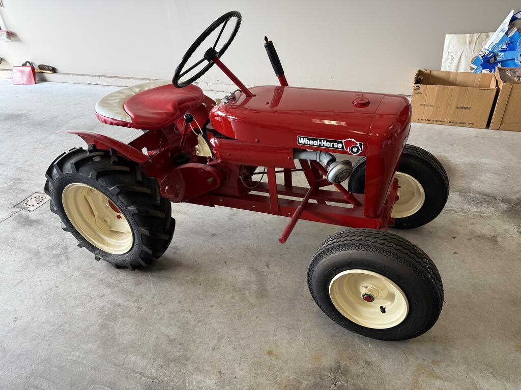

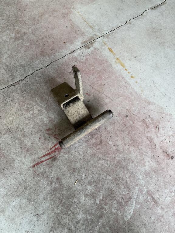

Dan 312-8 633 #24337 Posted August 16, 2025 I brought an RJ home today. 5 hour round trip. Older restoration, hasn’t ran in years, piston is free. I’ll work on this in my spare time …. The gentleman threw in what he said was an original fabricated slot hitch. Can anyone confirm this? I know the front wheels are not correct, saw that right away. Its granddaughter approved ! 2 7 3 Share this post Link to post Share on other sites
wallfish 20,724 #24338 Posted August 16, 2025 8 minutes ago, Dan 312-8 said: The gentleman threw in what he said was an original fabricated slot hitch. Can anyone confirm this? Yes, that's a correct factory hitch. You can get a lift cable for it at wheelhorsepartsandmore.com Very nice find as it has all of the usually missing parts 3 Share this post Link to post Share on other sites
kpinnc 19,036 #24339 Posted August 16, 2025 I'm not a RJ guru, but that's a nice looking tractor! I wouldn't change a thing! As @wallfish said, you got all the parts that are typically missing! ...and if that is a Kohler and has compression, it will run. 2 Share this post Link to post Share on other sites
Dan 312-8 633 #24340 Posted August 16, 2025 12 minutes ago, kpinnc said: I'm not a RJ guru, but that's a nice looking tractor! I wouldn't change a thing! As @wallfish said, you got all the parts that are typically missing! ...and if that is a Kohler and has compression, it will run. It’s a K91. 2 Share this post Link to post Share on other sites
953 nut 70,060 #24341 Posted August 16, 2025 1 hour ago, wallfish said: Very nice find as it has all of the usually missing parts Including the showerhead muffler. 1 1 Share this post Link to post Share on other sites

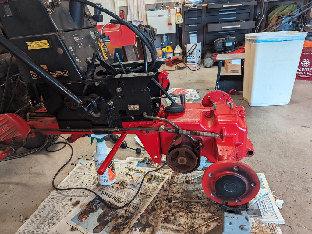

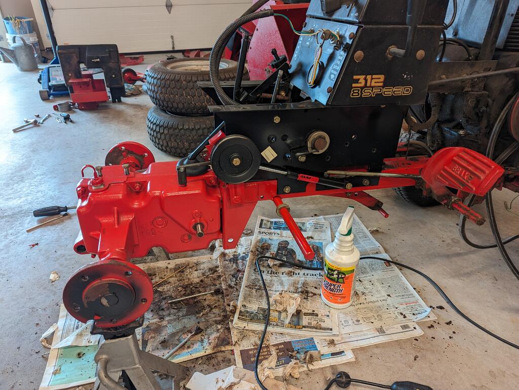

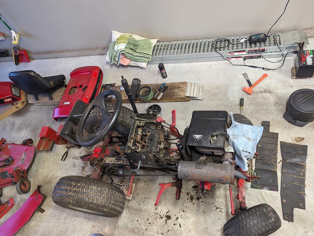

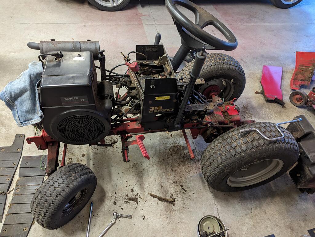

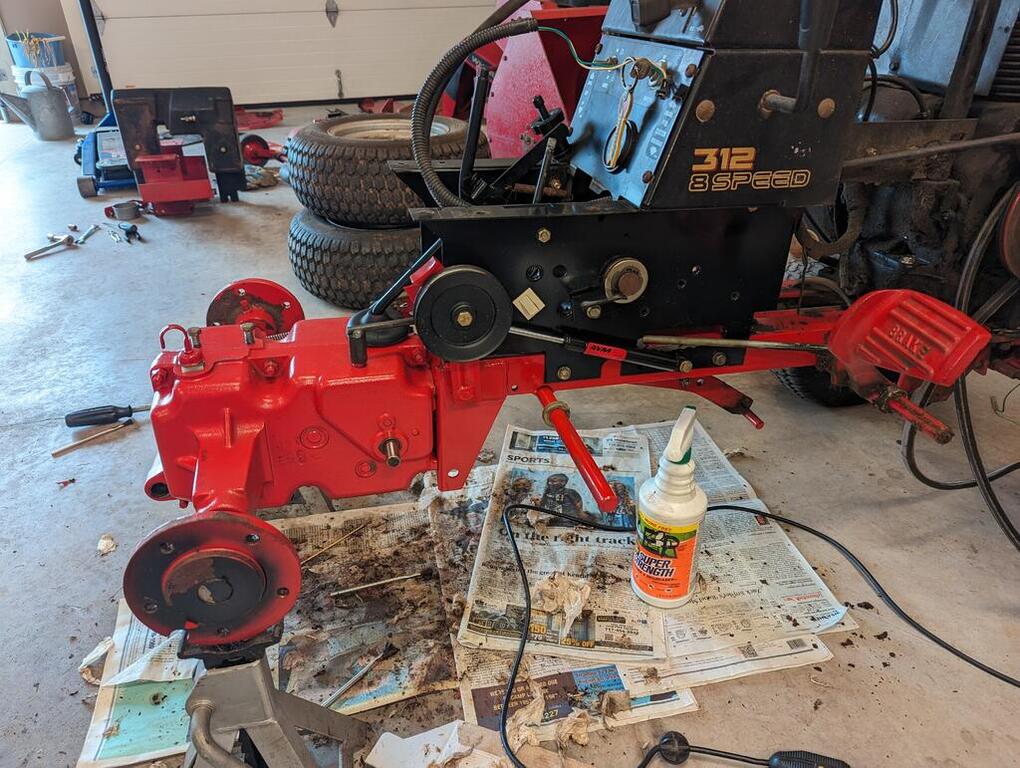

Dan 312-8 633 #24342 Posted August 17, 2025 On 8/13/2025 at 6:57 PM, Sparky said: Continued with the deep cleaning of the C-85. A few before and after pics: I can relate, deep cleaned this 312-8 before the 2024 big show. 5 5 Share this post Link to post Share on other sites

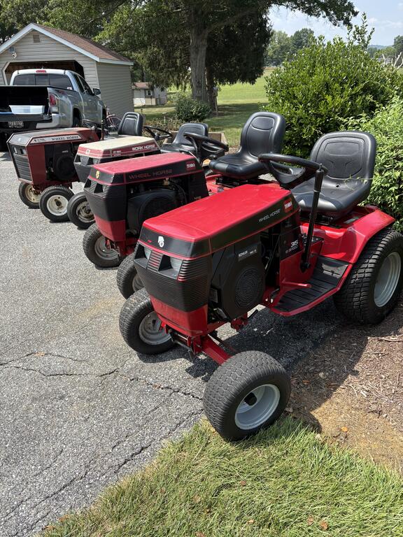

Sodaking27 1,391 #24343 Posted August 17, 2025 Had a few out stretching their legs. 4 8 Share this post Link to post Share on other sites

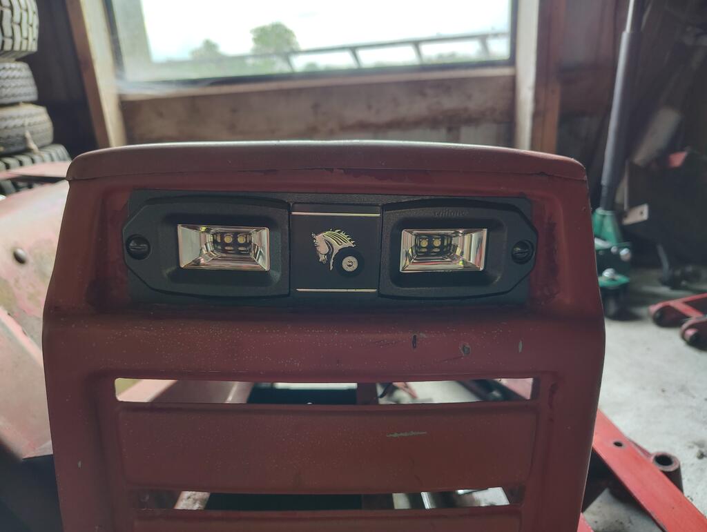

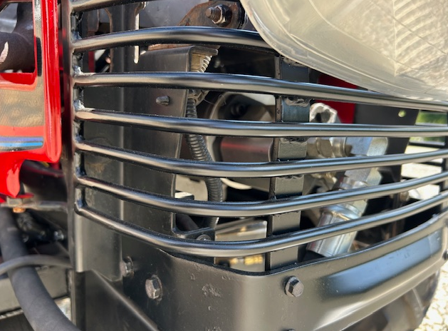

AlexR 3,136 #24345 Posted August 17, 2025 Finished the headlight mod. 5 10 1 Share this post Link to post Share on other sites

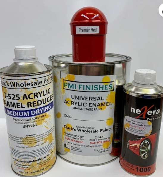

JoeM 10,317 #24346 Posted August 18, 2025 On 8/16/2025 at 4:24 PM, MainelyWheelhorse said: It beats using a spray can too started using a gun a few years back and yep it is so much better. I know you did not ask but here are a few tips. I was always shying away due to the clean up of the gun. I use brake cleaner now and with the straw and it cleans up in less than 5. especially when using disposable cups. I mix the hardener with the reducer first then add to the paint. I like about 1 to 5 mix @28psi. and use the thumb to pinky distance for the gun. of course using a piece of cardboard to get the pattern dialed in. I have found if I have a light in the background, it helps for how fast I move the gun. I look at the sheen in reflection of the light and speed up or slow down so it maintains a wet edge. I buy the single stage auto paint on eBay that has the reducer and hardener included. I have used this paint a few times and it works really well. Available in quarts too. 2 1 1 Share this post Link to post Share on other sites
MainelyWheelhorse 3,170 #24347 Posted August 18, 2025 (edited) @JoeM in the 1 to 5 paint to hardener/reducer mix, Is it 1 to 5 paint to reducer/hardener or the opposite? Also what are you setting your fluid and pattern control knobs at at least for a baseline. Thanks, the info has been helpful. Edited August 18, 2025 by MainelyWheelhorse Share this post Link to post Share on other sites
JoeM 10,317 #24348 Posted August 18, 2025 3 hours ago, MainelyWheelhorse said: Is it 1 to 5 paint to reducer/hardener or the opposite Start with 10 oz paint 1 1/2 of reducer and 1 oz hardener to start. And I usually end up with 10 oz paint and 2 oz reducer. with 1 oz hardener Start out on the low side on reducer you can always add. I never mix more than 10 oz of paint. I use those cheap Harbor Freight guns and run the feed near wide open. I move pretty fast on the first coat as the tack coat. About 10 minutes and re coat slower. Some like to touch the paint on an area like the tape and if the paint doesn't come off on your finger it is ready to re coat. The Mfg recommends 8 parts paint 2 parts reducer and 1 part hardener. Which is a little thinner than i prefer. 1 1 Share this post Link to post Share on other sites

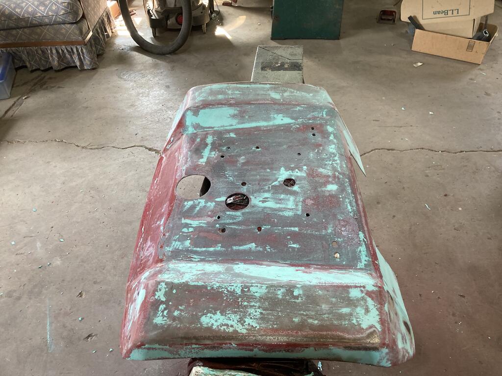

MainelyWheelhorse 3,170 #24349 Posted August 18, 2025 (edited) Yesterday after the initial coat of paint and filler primer, the body panels needed a bit more filler. after spot putty and apparently half kicked bondo that was still sticky today. I’ve got it figured out. After a scrape down of the old Bondo, and bit of new Bondo. It’s almost ready for another try at painting it. I’m going to attempt that before dark tonight if not tomorrow afternoon. It’s been an adventure😄 Edited August 18, 2025 by MainelyWheelhorse 2 1 1 Share this post Link to post Share on other sites
