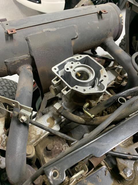

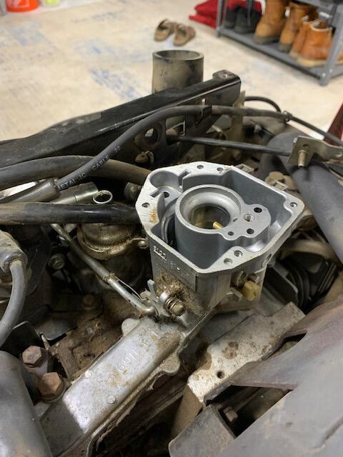

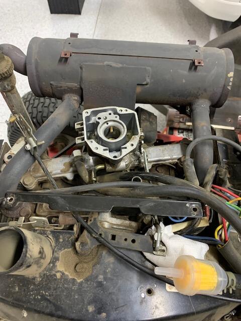

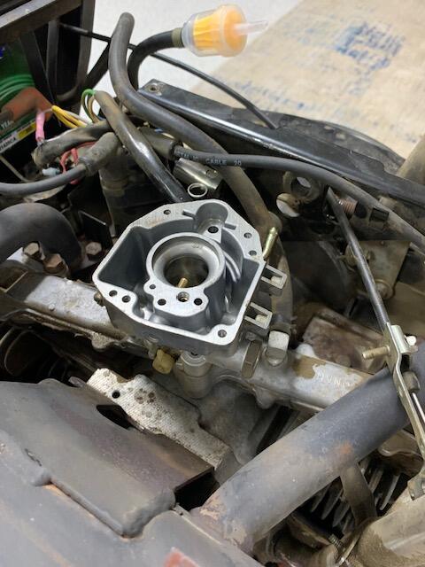

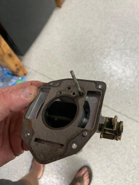

lynnmor 9,066 #23826 Posted June 5, 2025 Start spraying penetrating oil on the exhaust pipes where they go into the engine. I would take advantage of this carb removal to do a valve adjustment. Other worthwhile work is to glass bead the exhaust and paint it with Rustoleum high temperature spray paint. You will need to clean up the top of the engine before removing the valve covers, a shop vac can be a big help. New valve cover, intake, exhaust and carburetor gaskets will be needed, don't cheap out and use the Chinese junk. Have a torque wrench available and use the torque values in the Onan Service Manual. 2 Share this post Link to post Share on other sites

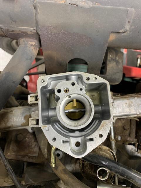

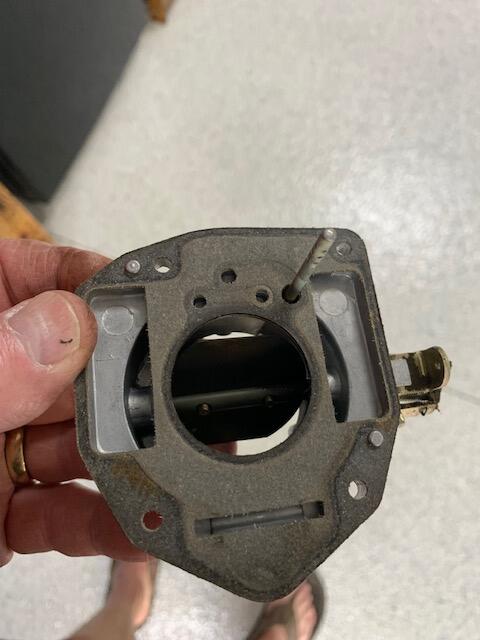

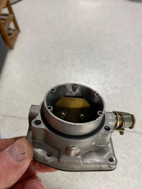

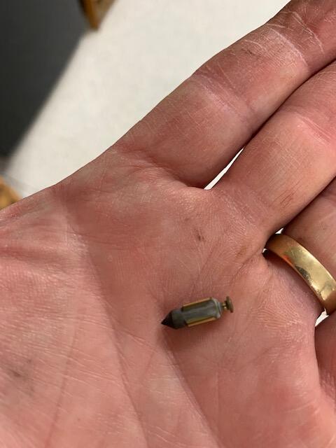

Bill D 3,177 #23827 Posted June 5, 2025 (edited) 4 hours ago, Thetbone said: I did not drop the pin into the carb!!! Sorry if this isn't the right place to post this, just adding to what I am doing. I have a question for the folks that know there stuff, how do I remove the rest of the carb, there are 2 bolts underneath, any easy way to get to them? Do I need to do that based on the pictures? Thanks. If you remove the large plug on the side of the carb it allows removal the .Ai. jet for cleaning. The is a also a jet in the top that unscrew. Sorry I can't figure out how to circle them. I'd take those out and clean all the passages and jets first, then put it back together and see how it runs, before taking the muffler and manifold off. Did you check compression on each cylinder? Edited June 5, 2025 by Bill D Share this post Link to post Share on other sites
Thetbone 61 #23828 Posted June 5, 2025 Will do, you mean the plastic looking plug? Did not check compression yet. Share this post Link to post Share on other sites
MainelyWheelhorse 3,170 #23829 Posted June 5, 2025 In a mix of today and yesterday, I got the drive pulley on the K321. Once I got the key switch from Fed Ex, I wired up 95% of the dash wiring for the C141. I ran out of plugs though so it’s at a standstill for now. I did mow today before it heated up though and the 312-8 performed flawlessly like usual. 2 Share this post Link to post Share on other sites
lynnmor 9,066 #23830 Posted June 5, 2025 28 minutes ago, Thetbone said: Will do, you mean the plastic looking plug? Did not check compression yet. That plastic thing is a stop to prevent you from turning the idle mixture screw too far. You can pull it off and dispose of it. With it off, carefully turn the screw in and count the turns till it stops, DO NOT force it, just a gentle touch. Now you can remove it and blast carb cleaner in the hole to clean it out. Now you can reinstall the screw running it in till it stops and turning it back out to exactly the same place it was. Fine adjustment will come later with the engine running. 1 Share this post Link to post Share on other sites

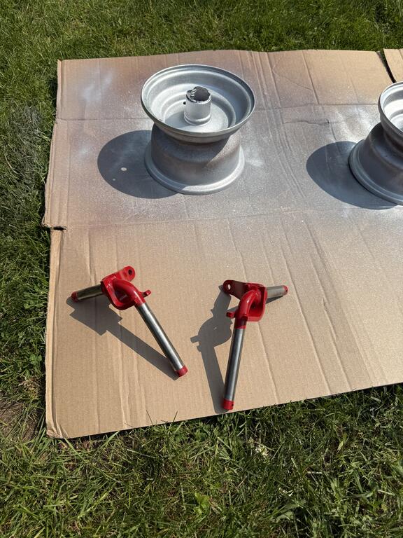

nylyon-(Admin) 9,133 #23833 Posted June 6, 2025 Painting has begun for the HD Spindles and Wheels 5 7 Share this post Link to post Share on other sites
Sparky-(Admin) 26,621 #23834 Posted June 6, 2025 21 minutes ago, nylyon said: Painting has begun for the HD Spindles and Wheels What machine is getting these? 1 Share this post Link to post Share on other sites

nylyon-(Admin) 9,133 #23836 Posted June 6, 2025 3 minutes ago, Sparky said: What machine is getting these? For the immediate time being, the 310 I picked up from you, longer term likely the 416-8 2 1 Share this post Link to post Share on other sites

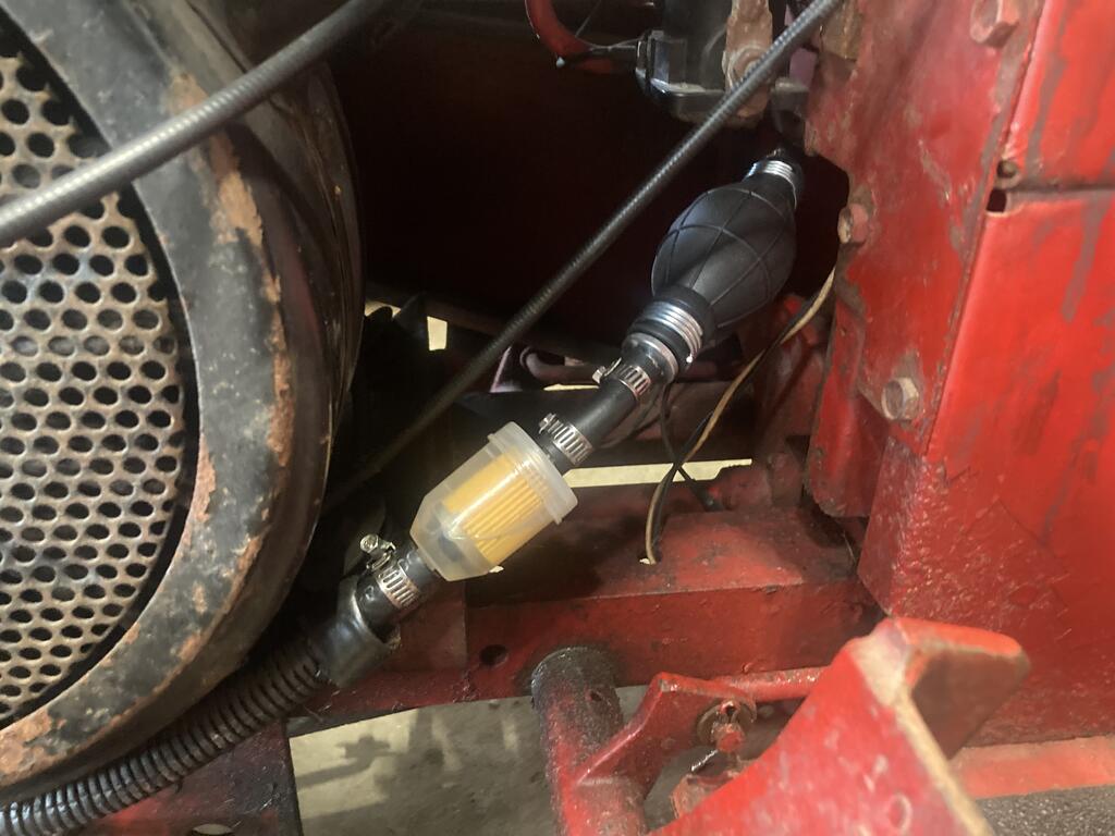

SylvanLakeWH 32,783 #23841 Posted June 6, 2025 (edited) New fuel line, filter and primer bulb on the C-105. Fired right up and no leaks... And just for @WHX?? since he needs pretty pictures and doesn't know what a fuel line looks like: How NOT to install: How to install after @WHX?? eagle eyes review: And what the old line still looks like in the trash... Edited June 7, 2025 by SylvanLakeWH @whxx 4 7 Share this post Link to post Share on other sites
WHX?? 58,328 #23842 Posted June 6, 2025 16 minutes ago, SylvanLakeWH said: New fuel line, filter and primer bulb on the C-105. Fired right up and no leaks... And we know you did this because yhe pics are where??? 6 Share this post Link to post Share on other sites
SylvanLakeWH 32,783 #23843 Posted June 6, 2025 1 hour ago, WHX?? said: And we know you did this because yhe pics are where??? See above... 1 3 Share this post Link to post Share on other sites

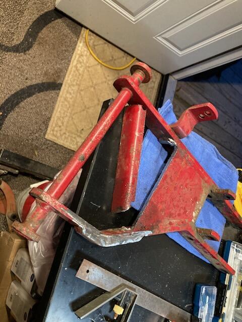

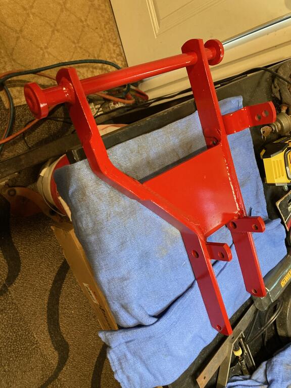

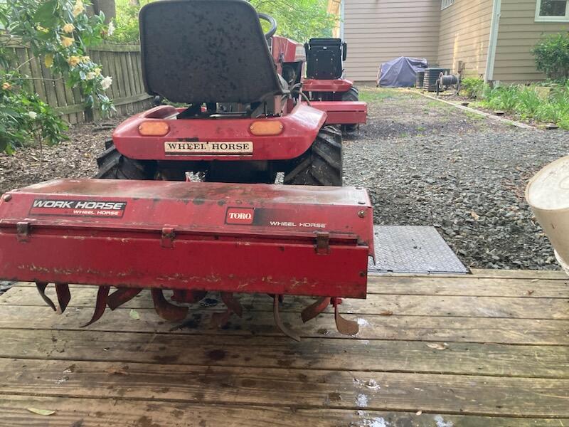

ineedanother 2,885 #23847 Posted June 7, 2025 Finally hitched up a tiller that's been sitting around here for a few years. I think it's from an XI and I offered it for sale a while back with no bites so I made a lift bracket and modified the front mount so it would clear the gearbox on a c-series. I don't have a need for it so it's just been sitting under my deck. It still has paint on the tines and it proved this evening that it can turn soil so it can stay. 1 9 Share this post Link to post Share on other sites
ebinmaine 81,049 #23848 Posted June 7, 2025 14 minutes ago, ineedanother said: Finally hitched up a tiller that's been sitting around here for a few years. I think it's from an XI and I offered it for sale a while back with no bites so I made a lift bracket and modified the front mount so it would clear the gearbox on a c-series. I don't have a need for it so it's just been sitting under my deck. It still has paint on the tines and it proved this evening that it can turn soil so it can stay. Nicely done! Use what ya have!! 1 Share this post Link to post Share on other sites

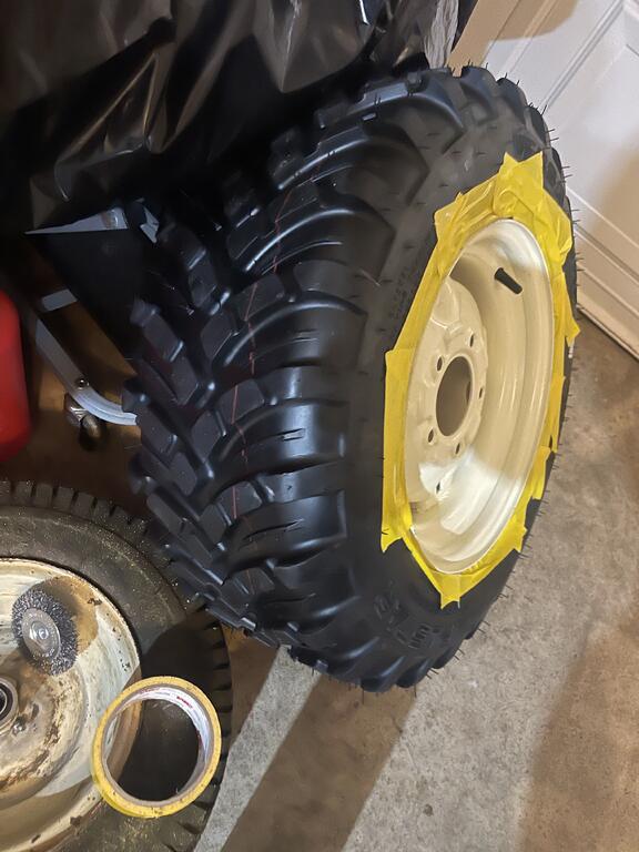

stvski80085 279 #23849 Posted June 7, 2025 Some new painted rims and tires. I went with versa turfs and my other set will get ag's. When I repaint the original wheels before winter i will get a set of ag's. Just happy to get the old rotten tires off. Steve 3 6 Share this post Link to post Share on other sites

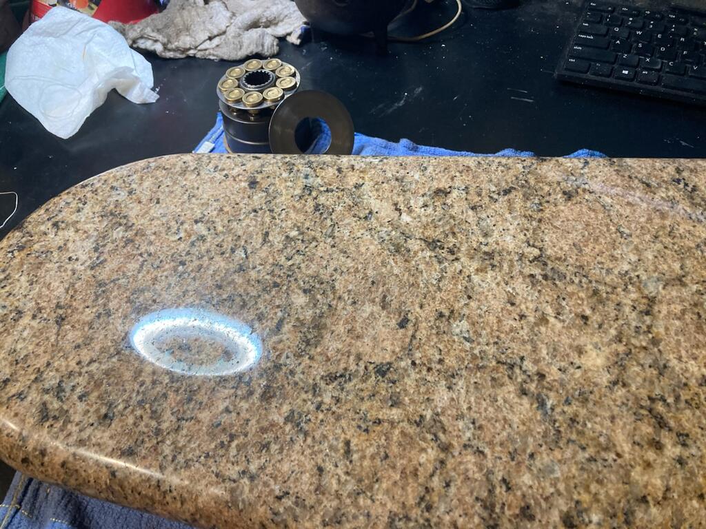

ineedanother 2,885 #23850 Posted June 7, 2025 It's supposed to rain this weekend so I verified flatness of a piece of granite and plan to do a bunch of figure eights and rinse a bunch of parts... 4 1 Share this post Link to post Share on other sites
