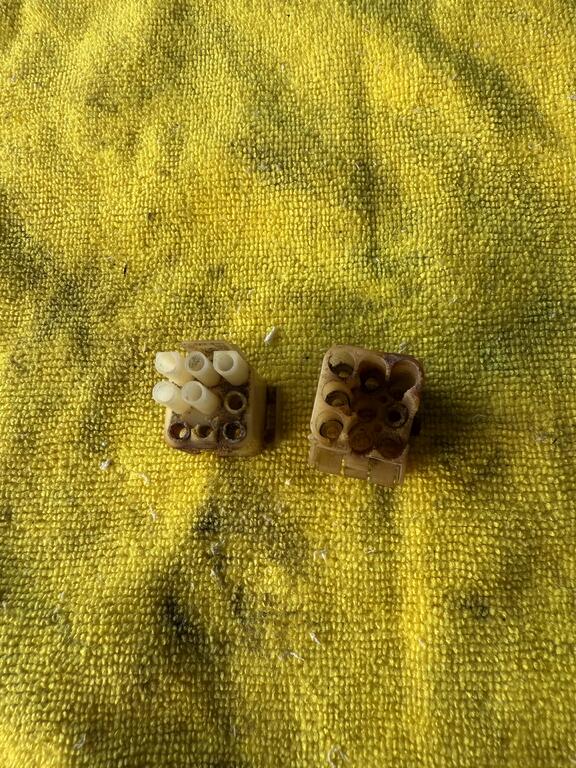

nylyon-(Admin) 9,066 #23383 Posted April 23, 2025 Continued my mission to fix the bad electrical connectors on my 416-8, this one was for the indicator light panel: 3 1 2 Share this post Link to post Share on other sites

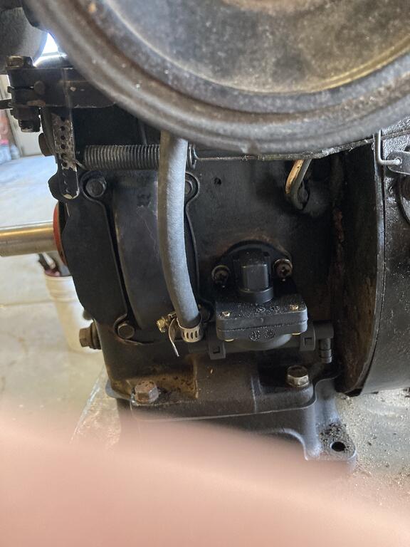

MainelyWheelhorse 3,145 #23384 Posted April 24, 2025 Today after work, I put my new fuel pump on the spare M12. Yes, I know it’s upside down due to accidentally ordering the pump for an M20…I figured I’d try it as logically it might work as everything but the finger to pump is the same as the old one. Now to test that theory tomorrow. Share this post Link to post Share on other sites

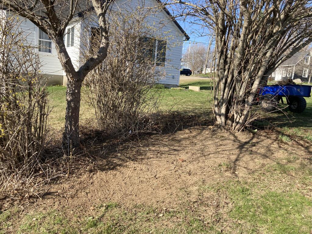

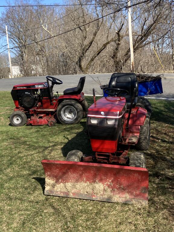

MainelyWheelhorse 3,145 #23386 Posted April 24, 2025 Today, on this nice day, I got the cobwebs out of both tractors. I did some spring clean out in front of my house, swept out my basement/workshop as it had a bunch of mud in it. And took the chains off the 308. I’m thinking about putting AG’s or a wider tire for the chains, so I only need one set for both tractors. 6 1 Share this post Link to post Share on other sites

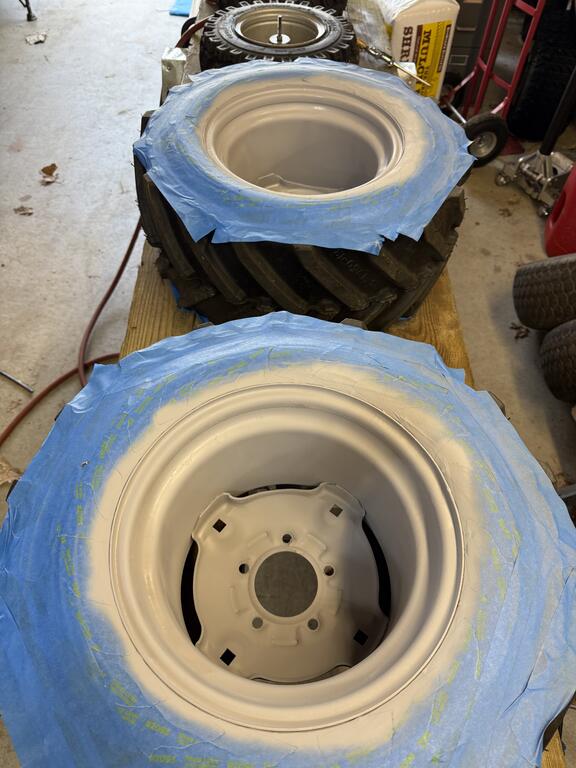

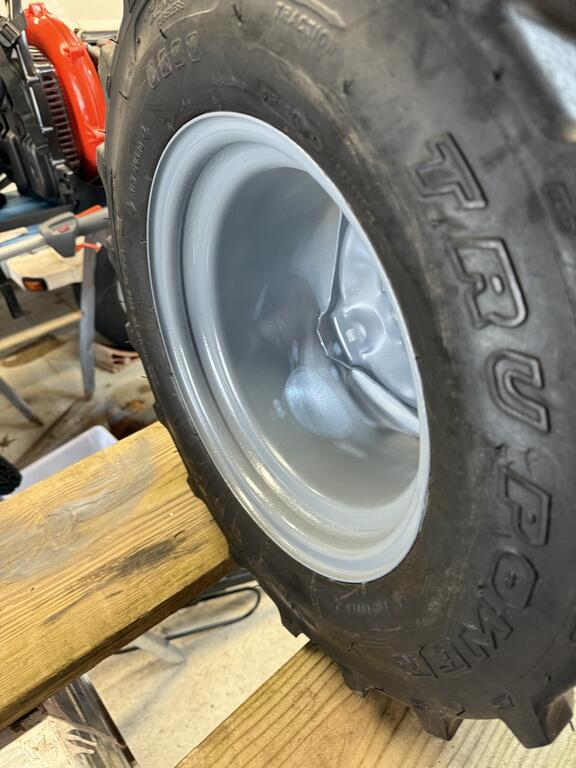

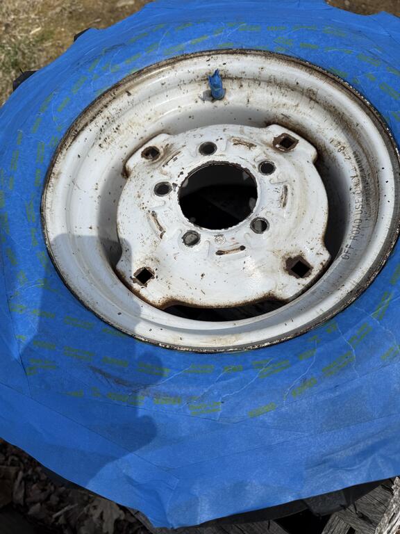

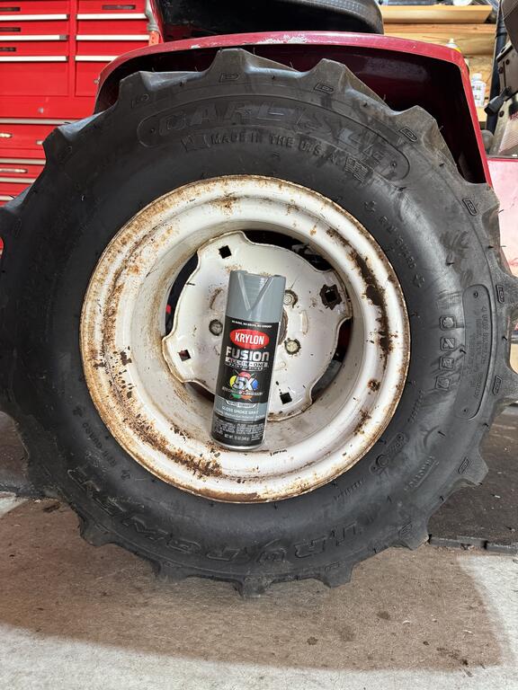

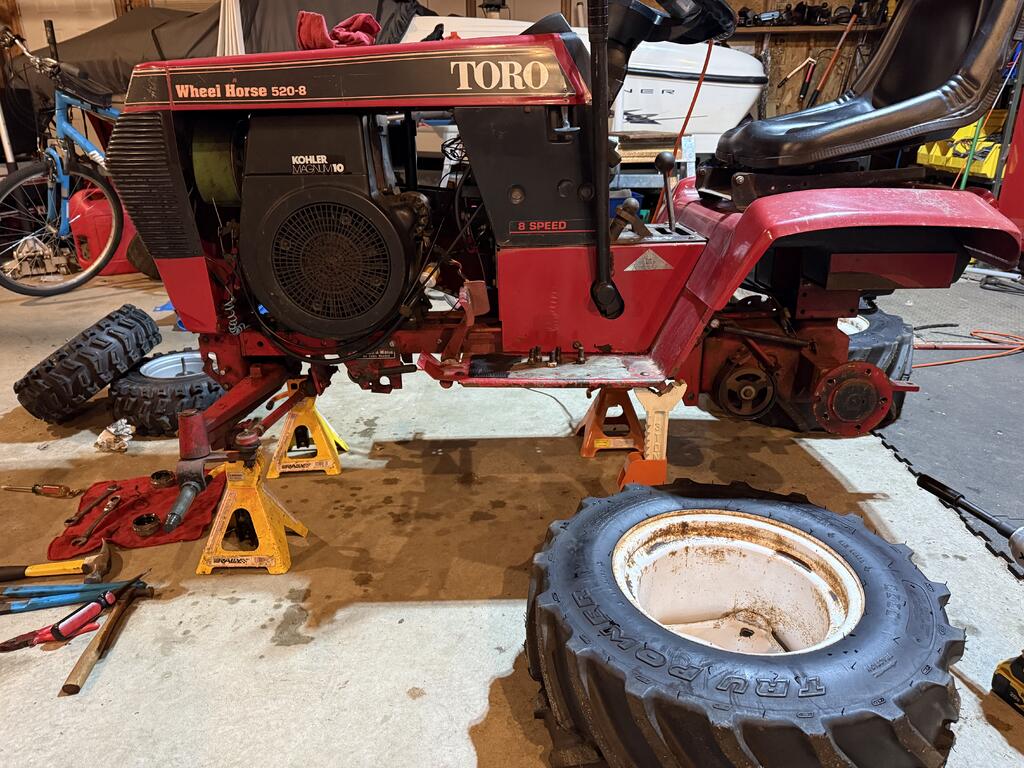

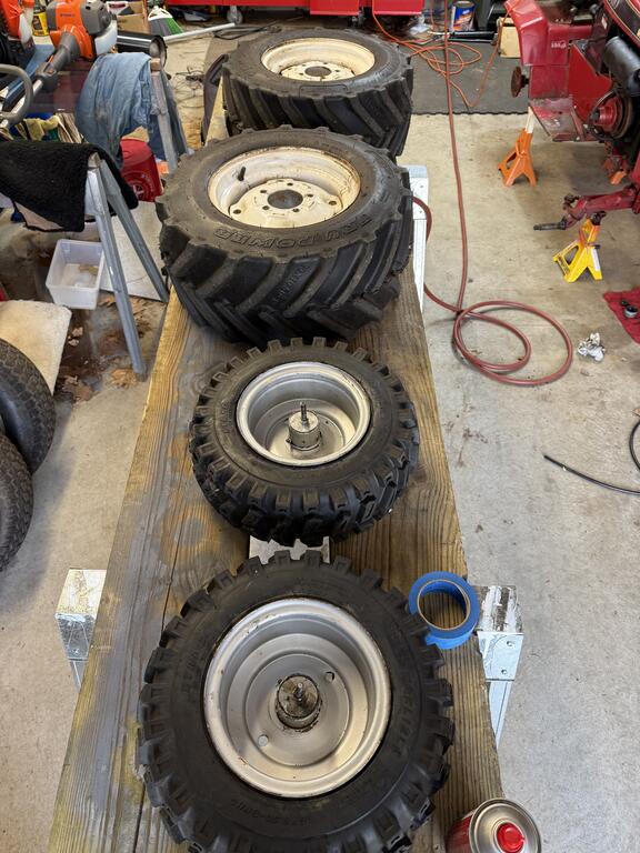

Sparky-(Admin) 26,489 #23387 Posted April 25, 2025 510-8 wheels getting a clean up. 8 3 Share this post Link to post Share on other sites

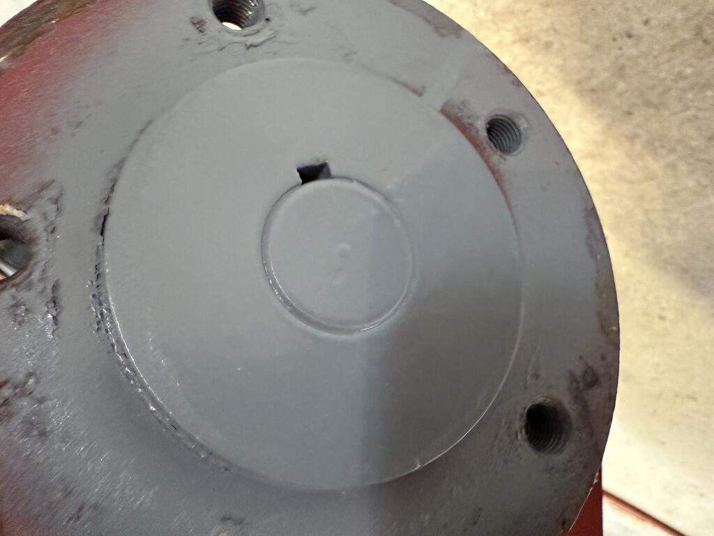

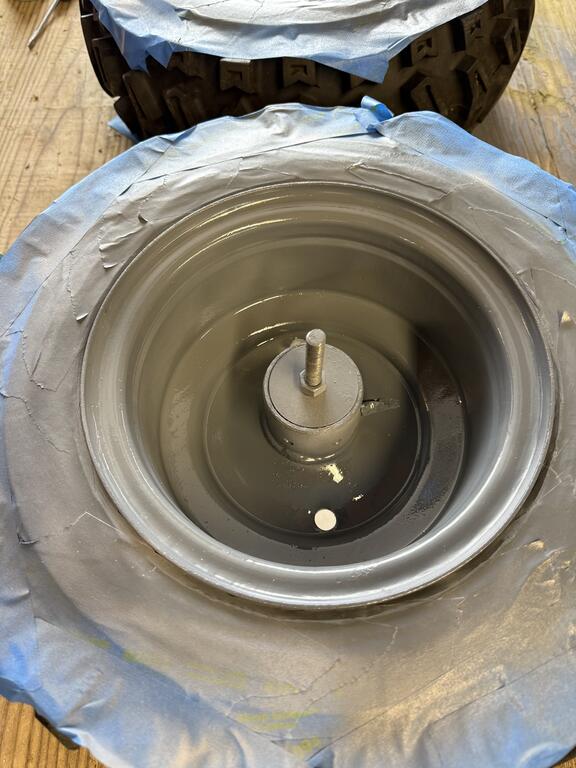

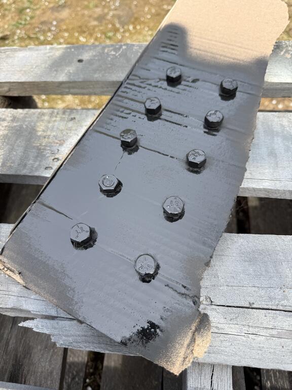

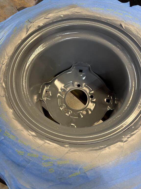

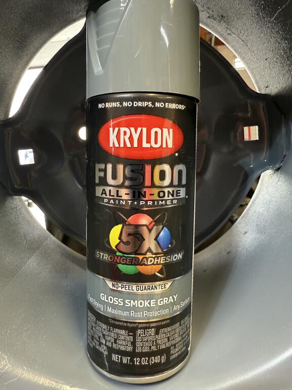

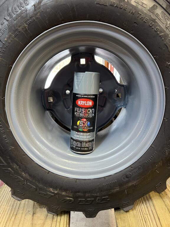

Sparky-(Admin) 26,489 #23388 Posted April 25, 2025 Matching gray hubs…and flat black (once their dried) lugs. 8 2 Share this post Link to post Share on other sites

kpinnc 19,003 #23390 Posted April 26, 2025 4 hours ago, Sparky said: 510-8 wheels getting a clean up. That color looks great with red! 2 1 Share this post Link to post Share on other sites

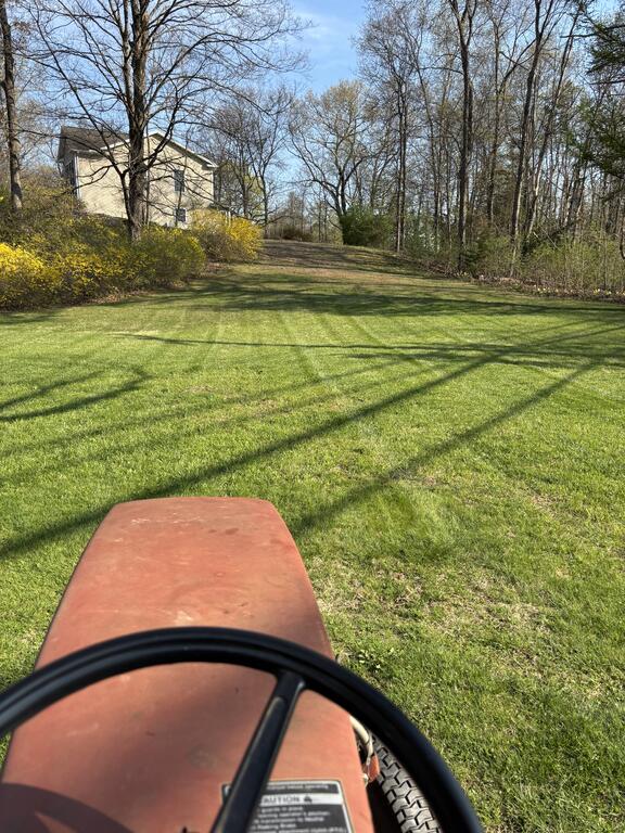

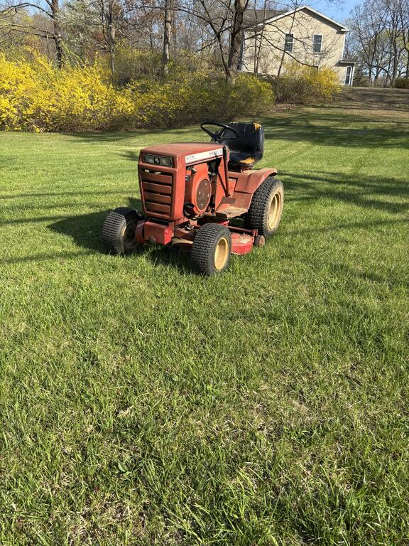

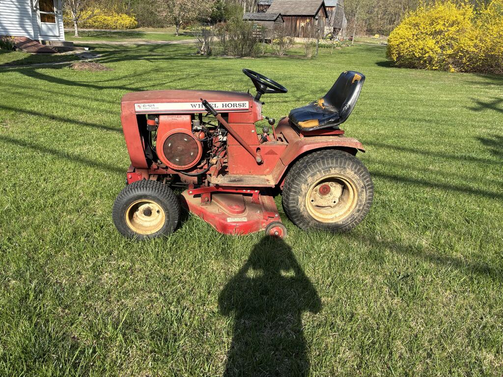

TonyToro Jr. 2,547 #23393 Posted April 26, 2025 Yesterday mounted up the 36” RD deck on my C-121. Then mowed the grandparents grass with it since it was high. 3 15 Share this post Link to post Share on other sites

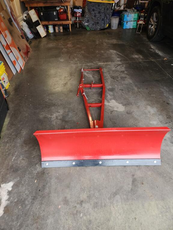

Goldnboy 1,154 #23394 Posted April 26, 2025 Finally put the 42" blade i picked up a few months ago together after a complete tear down and fresh paint. 7 7 Share this post Link to post Share on other sites

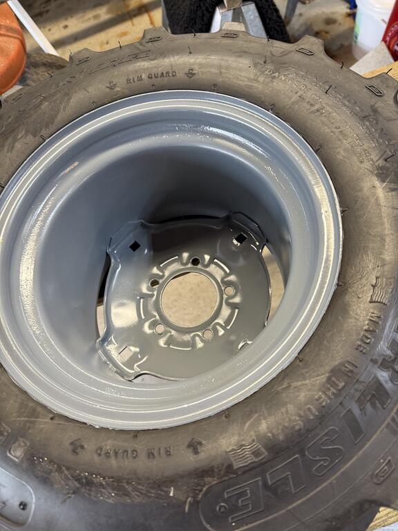

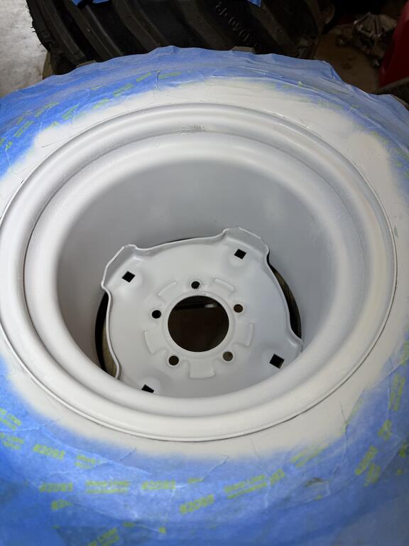

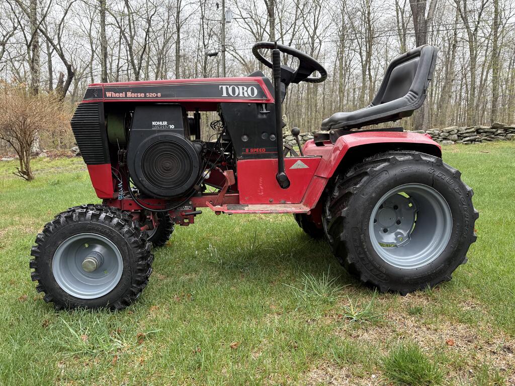

Sparky-(Admin) 26,489 #23395 Posted April 26, 2025 This pretty much wraps up the 510-8 project…wheel paint. 6 7 Share this post Link to post Share on other sites

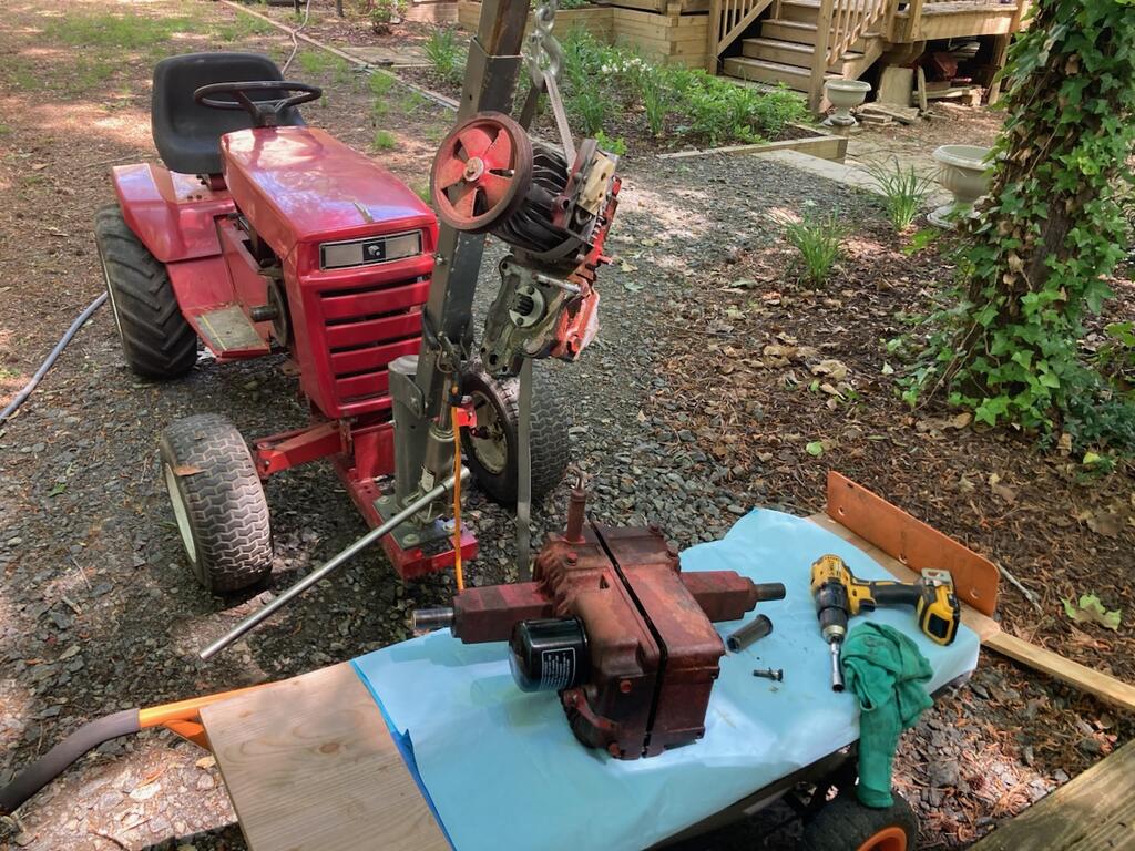

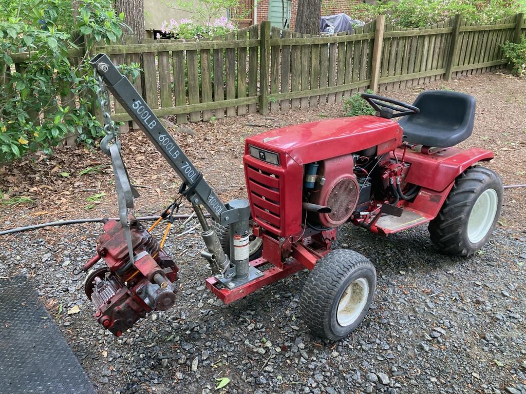

ineedanother 2,879 #23396 Posted April 26, 2025 Brought a spare hydro to the shop to go through it to have a spare. Needed to split the case to replace an axle that I've had sitting around waiting on me. Considering going through the pump. It was good when I took it off but it's never been open so I might take a look inside. 7 5 Share this post Link to post Share on other sites

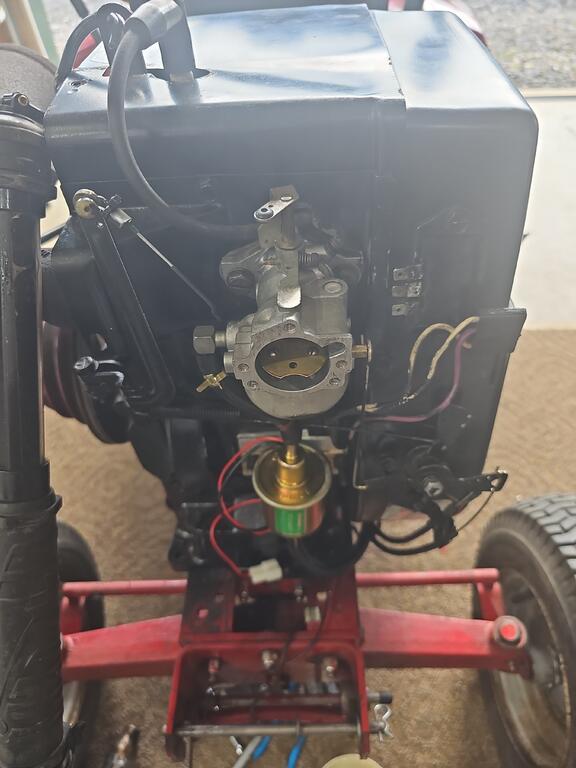

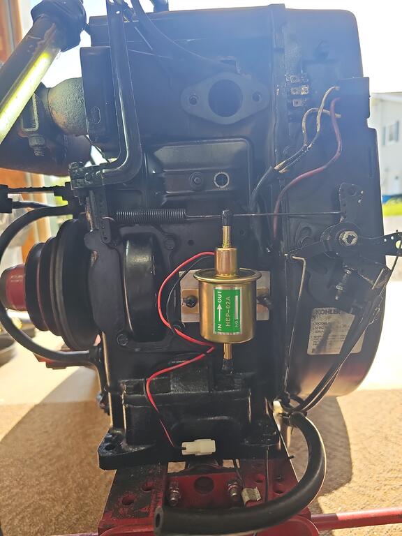

HyperPete 939 #23398 Posted April 26, 2025 I have fought a fuel problem with my 414-8 for weeks. It started not revving when on throttle-up from mid-throttle. Air filter was good, the Walbro carb only has idle adjustment and high-speed adjuster. I decided to rebuild. Two jets in the kit, plus a clip & a spring for the jets. I would either get no gas, or overflowing through the carb throat, regardless of combination and float setting. Today I put the original jet back & adjusted the float and no more issue with fuel level. I also found the mechanical fuel pump was failing. I went with a cheap electric one, but ordered 2 after reading about their reliability. I ran new fuel line, added a ball valve fuel shut off, and mounted the pump. I drove the tractor from my shop to my shed to fill the gas tank and it ran fine. When I went to drive it back to the shop, it wouldn't run. Fuel pump died! I decided that I would mount it better this time, and I created a better block off plate for the old mechanical fuel pump with a second plate atop it to mount the electric fuel pump. I routed the electric cables back under the dash and connected them there. Everything seems to be running properly now. I'm hoping this pump lasts a little longer than the last. 7 2 Share this post Link to post Share on other sites
953 nut 69,756 #23399 Posted April 27, 2025 12 hours ago, HyperPete said: block off plate for the old mechanical fuel pump with a second plate atop it to mount the electric fuel pump I would be better to mount the electric fuel pump on the frame making it lower than the fuel tank outlet. Electric pumps are good at pushing fuel but they suck at sucking. 6 Share this post Link to post Share on other sites
ranger 1,862 #23400 Posted April 27, 2025 (edited) 16 minutes ago, 953 nut said: I would be better to mount the electric fuel pump on the frame making it lower than the fuel tank outlet. Electric pumps are good at pushing fuel but they suck at sucking. I was going to suggest the same. Also, if you have concerns regarding the reliability of the low cost pumps, it’s probably not a good idea to mount it to the engine, which has the potential to “Shake” it to bits!!! Edited April 27, 2025 by ranger 3 4 Share this post Link to post Share on other sites
