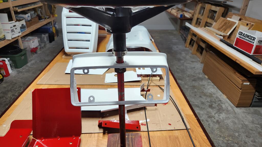

Racinbob 13,113 #23041 Posted February 27, 2025 That's the type I use in the Regal red. I can't say I've warmed up to the new nozzles though. I'm figuring on rattle can for the Dino dash so I can get it installed and have some proper steering as I wait for the opportunity to spray the major sheet metal parts. I'm going to try my hand with a HVLP sprayer and Rusty Regal with hardener for those. I made a half hearted attempt at getting the steering will roll pin out but wasn't giving up easily so I'll just cover it. 2 3 Share this post Link to post Share on other sites

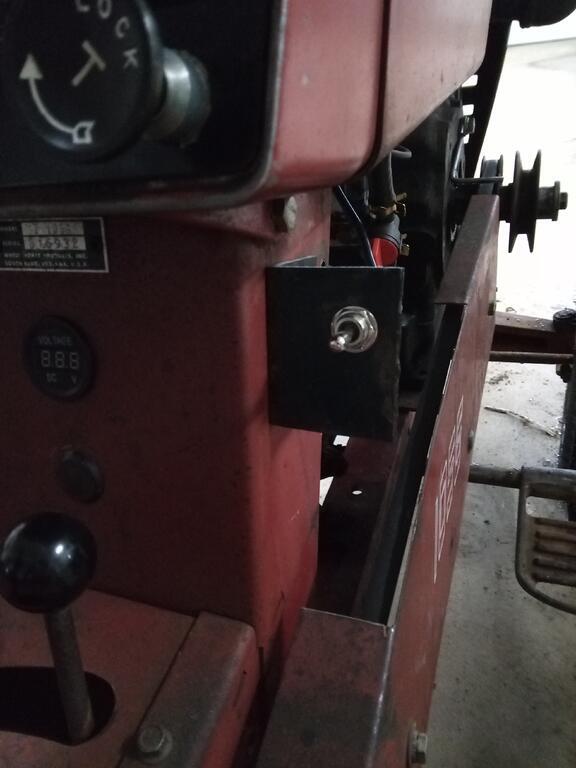

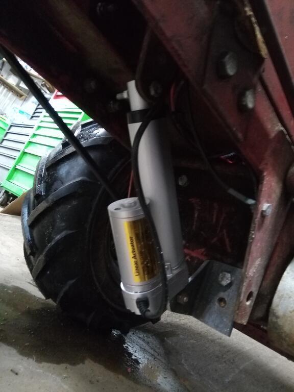

Toby Stockman 89 #23043 Posted February 28, 2025 Put a electric lift on my 1056. I only use this tractor for plowing so no idea if it would clear with a deck. Made a bracket that bolts to the frame/transaxle and the other end bolts right to the lower part of the rockshaft. Wired it up and it works great! its a bit slower than I would like says its 14mm/sec but still a reasonable speed. The cylinder can lift 265lbs and has no problem lifting my 48'' blade. 6 6 Share this post Link to post Share on other sites

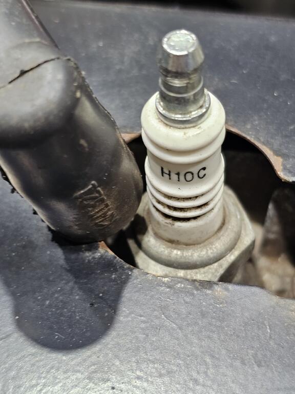

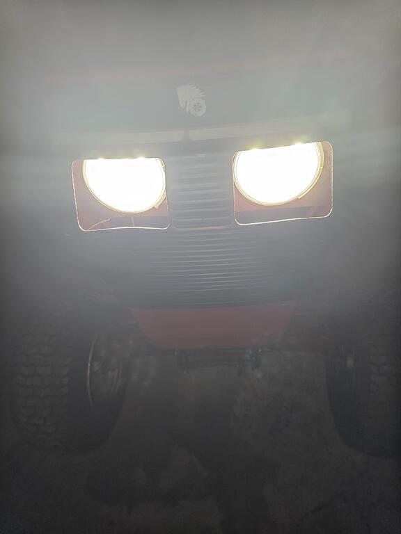

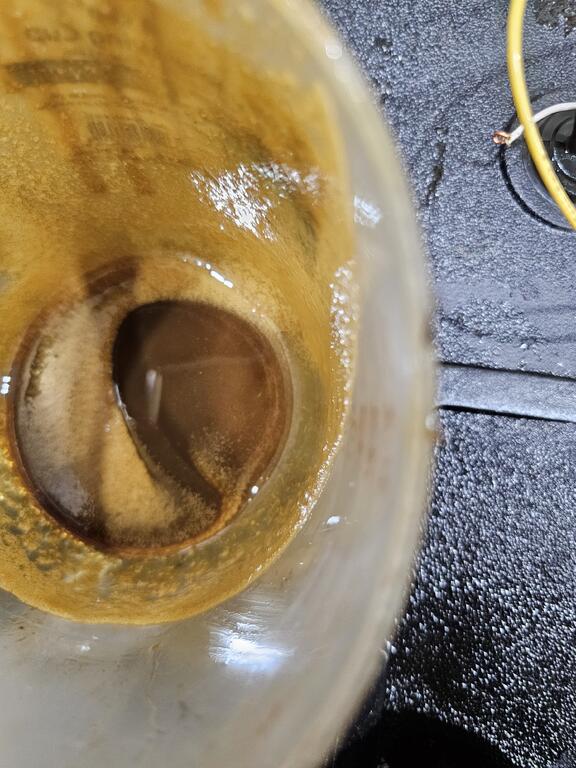

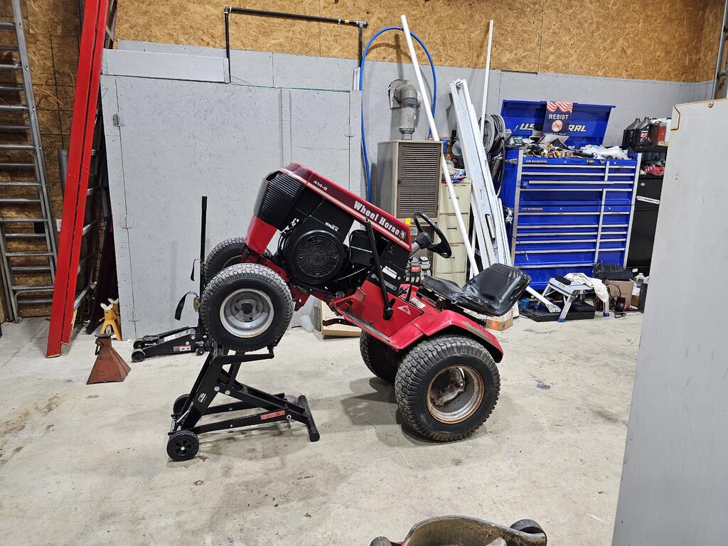

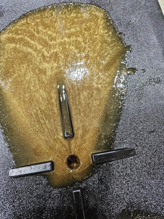

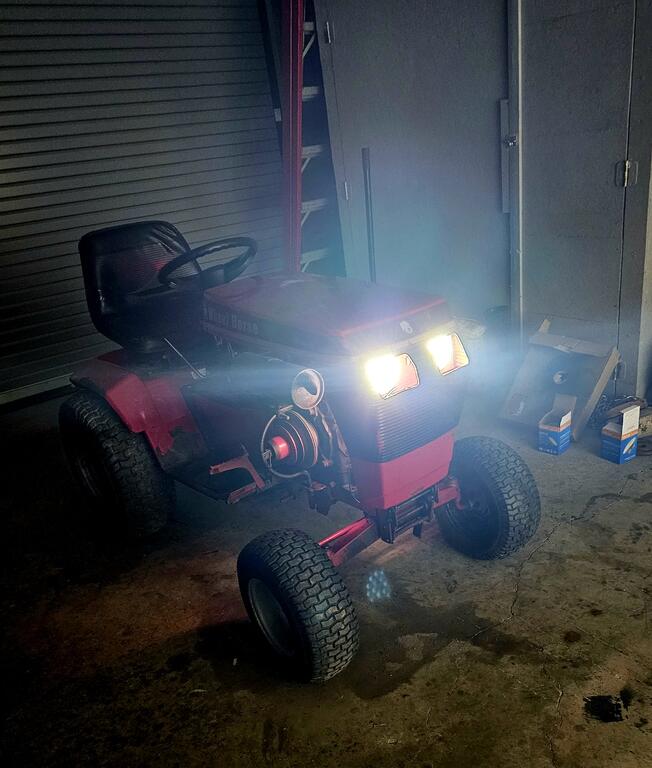

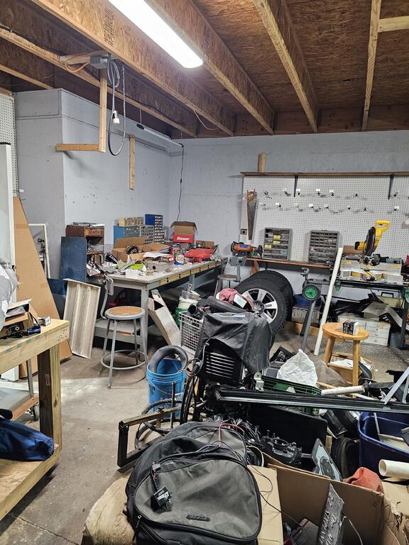

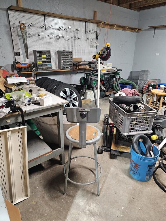

HyperPete 939 #23044 Posted March 2, 2025 Today I started working on my 414. Raided the heating oil, then drained, flushed, & filled the transmission. Water & froth in it was responsible for that look, not metal. I replaced the blown headlight & it's working twin with LEDs. They are BRIGHT! (Sorry for the messy shop.) Ordered an NGK plug to replace the Champion. Bought oil to change it. Much more to do, this is just a start. Tomorrow, after picking up a '73 frame, disassemble & clean carb. 3 6 Share this post Link to post Share on other sites
ebinmaine 80,434 #23045 Posted March 2, 2025 31 minutes ago, Pete D said: messy shop What mess??!!?? Amateurs............ 2 Share this post Link to post Share on other sites
HyperPete 939 #23046 Posted March 2, 2025 2 hours ago, ebinmaine said: What mess??!!?? Amateurs............ If you only saw behind the roll-up door... I have 10 tubs to get started sorting. 1 Share this post Link to post Share on other sites

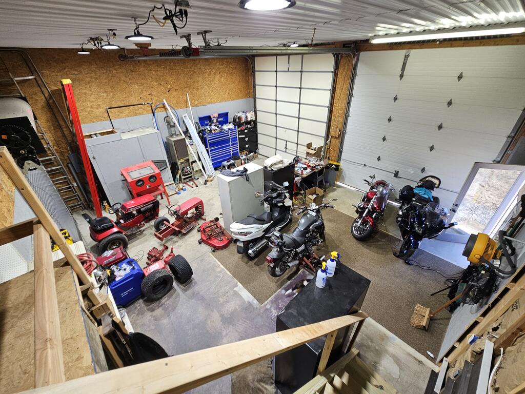

ebinmaine 80,434 #23048 Posted March 2, 2025 Yoooboyzz should see our local barn and workshop space right now. Actually the shed too. Whereas the Trina momma is soon to be here we've put the basement remodeling in high gear ⚙️ and the other three as "toss-it-there" mode. Oh. My. Word. Whattamess..... 1 Share this post Link to post Share on other sites

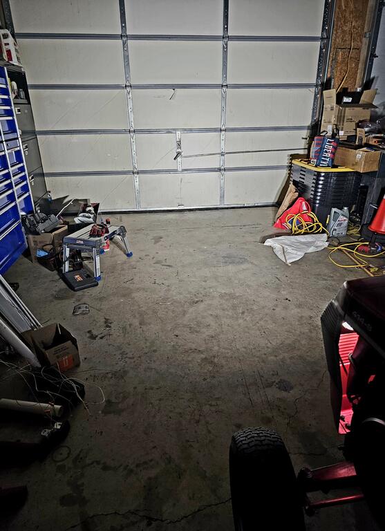

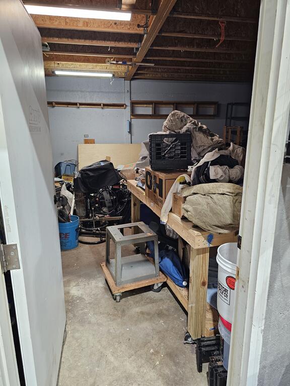

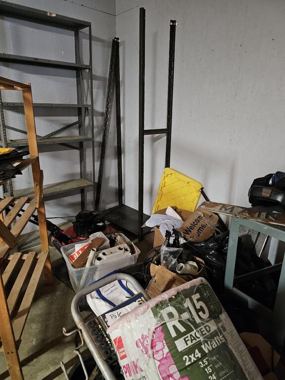

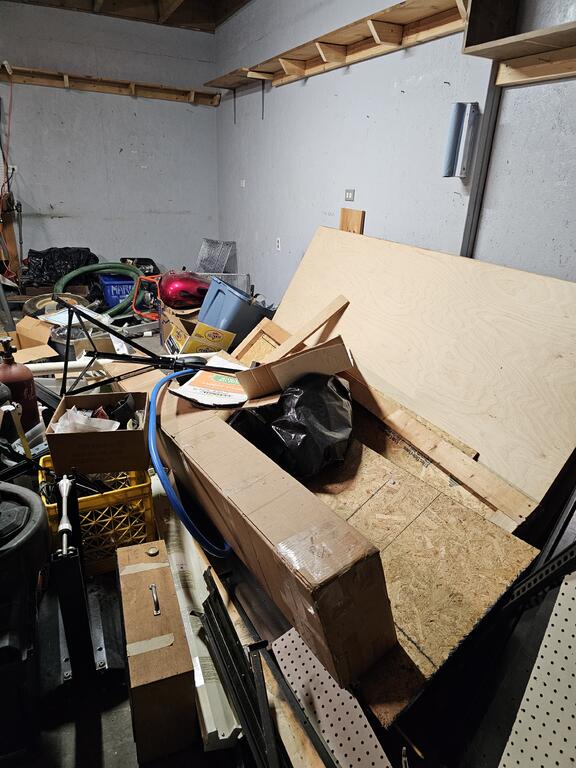

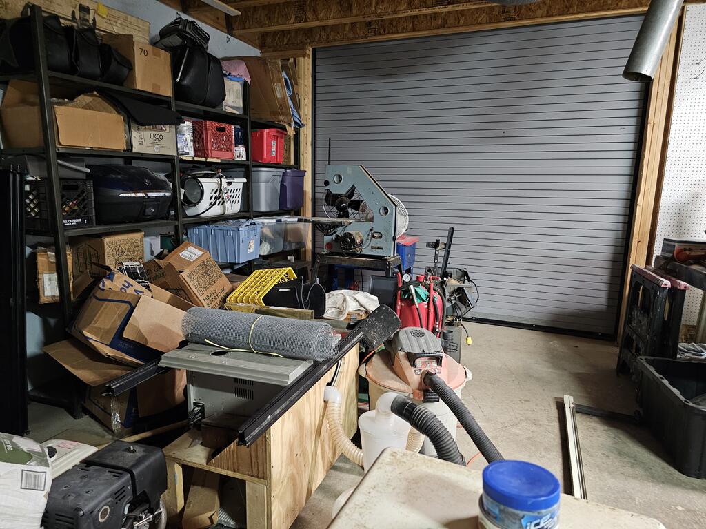

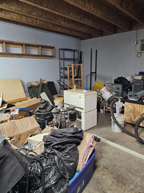

HyperPete 939 #23049 Posted March 2, 2025 Is This bragging rights for messiest garage?! I've gotta set the record straight! The FUNCTIONAL side of the shop... The uh, NOT so functional side of the shop... I have started setting up shelves. Can I interest anyone in my mom's old mangle & chair? 😉 2 1 1 Share this post Link to post Share on other sites
Wayne0 1,626 #23050 Posted March 2, 2025 5 minutes ago, Pete D said: mom's old mangle There's something I haven't heard in a LONG time! Younguns' don't know what that is. 3 Share this post Link to post Share on other sites
