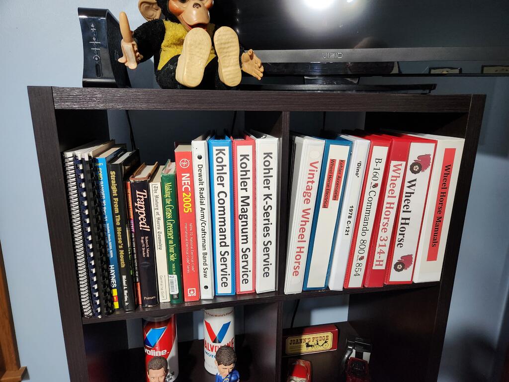

ebinmaine 80,310 #22578 Posted December 25, 2024 Been working on the organization and movement of the basement workshop to the new workshop space. Today I completely undid and redid my selection of paper manuals. I've had the BBT print a few here and had several Redsquare members send me older paper copies. I now have everything neatly divided into several general binders. As in the picture: 1. A Yost Vise manual. 2. General Wheelhorse info we've printed or had mailed here. 3. Original Wheelhorse tractor manuals or sales pieces. 4. Twin cylinder Kohler manuals. 5. Single cylinder Kohler manuals. 10 Share this post Link to post Share on other sites
cleat 9,229 #22579 Posted December 25, 2024 42 minutes ago, ebinmaine said: Been working on the organization and movement of the basement workshop to the new workshop space. Today I completely undid and redid my selection of paper manuals. I've had the BBT print a few here and had several Redsquare members send me older paper copies. I now have everything neatly divided into several general binders. As in the picture: 1. A Yost Vise manual. 2. General Wheelhorse info we've printed or had mailed here. 3. Original Wheelhorse tractor manuals or sales pieces. 4. Twin cylinder Kohler manuals. 5. Single cylinder Kohler manuals. Being organized is a great thing. If you need something, you can find it. 1 1 Share this post Link to post Share on other sites

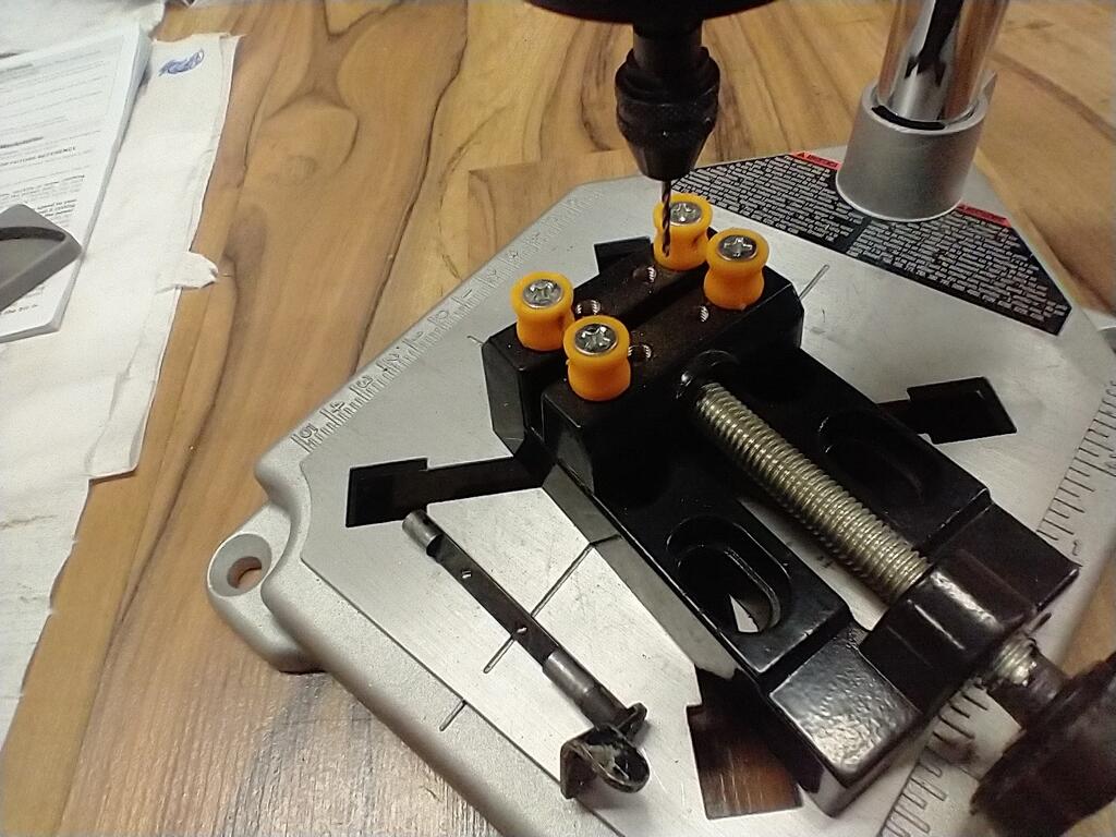

ebinmaine 80,310 #22580 Posted December 25, 2024 Did some experimenting on a choke shaft using the Dremel tool in a vise. The brass screws were broken off. I used a wee bitty drill bit (3/32"?) to get a few holes in the 3-48 screws. Went 2 sizes up in drill bit. Then used a tap to poke the remaining brass outta the steel shaft. I'd say it was a mild mostly success with a good amount of learning. One thread came out ok. The other is good one side only which isn't enough. I could still use the shaft if I pick up some 3-48 nuts and use Loctite for holding power. 3 Share this post Link to post Share on other sites
8ntruck 9,219 #22581 Posted December 25, 2024 (edited) try some left handed drill bits. Applied to the peened end of the screw, they might encourage the screw to thread itself through the shaft - assuming that the head is gone.. Edited December 25, 2024 by 8ntruck 1 1 1 Share this post Link to post Share on other sites

Wayne0 1,624 #22583 Posted December 26, 2024 2 hours ago, ebinmaine said: Did some experimenting on a choke shaft using the Dremel tool in a vise. The brass screws were broken off. I used a wee bitty drill bit (3/32"?) to get a few holes in the 3-48 screws. Went 2 sizes up in drill bit. Then used a tap to poke the remaining brass outta the steel shaft. I'd say it was a mild mostly success with a good amount of learning. One thread came out ok. The other is good one side only which isn't enough. I could still use the shaft if I pick up some 3-48 nuts and use Loctite for holding power. Eric, talk about wee bitty, if you need small, I have .05 and .065 bits if you need them. Got a few of both so I'll send one of each if needed. 2 Share this post Link to post Share on other sites
Bar Nuthin 3,043 #22584 Posted December 26, 2024 Would it be safer to go ahead tap threads to #4 - 48 UNF? Share this post Link to post Share on other sites
ebinmaine 80,310 #22585 Posted December 26, 2024 23 minutes ago, Wayne0 said: Eric, talk about wee bitty, if you need small, I have .05 and .065 bits if you need them. Got a few of both so I'll send one of each if needed. Appreciate that but I've got some smaller stuff here too. 3 minutes ago, Bar Nuthin said: Would it be safer to go ahead tap threads to #4 - 48 UNF? Might have to go bigger than that. I'd have to drill the holes to round, then tap to that size. Share this post Link to post Share on other sites
Bar Nuthin 3,043 #22586 Posted December 26, 2024 1 minute ago, ebinmaine said: Might have to go bigger than that. I'd have to drill the holes to round, then tap to that size. Just thinking that might be better than nuts possibly finding their way into the cylinder. 1 Share this post Link to post Share on other sites
ebinmaine 80,310 #22587 Posted December 26, 2024 3 minutes ago, Bar Nuthin said: Just thinking that might be better than nuts possibly finding their way into the cylinder. That's what the Loctite is for. I've seen several carbs with nuts and bolts holding the plate to shafts. 1 Share this post Link to post Share on other sites
Bar Nuthin 3,043 #22588 Posted December 26, 2024 1 minute ago, ebinmaine said: That's what the Loctite is for. I've seen several carbs with nuts and bolts holding the plate to shafts. Good to know. Carburetors are an area where I have little to no experience. Engineering voodoo! 1 Share this post Link to post Share on other sites
ebinmaine 80,310 #22589 Posted December 26, 2024 5 minutes ago, Bar Nuthin said: Good to know. Carburetors are an area where I have little to no experience. Engineering voodoo! Cleanliness and patience is your friend. 1 Share this post Link to post Share on other sites

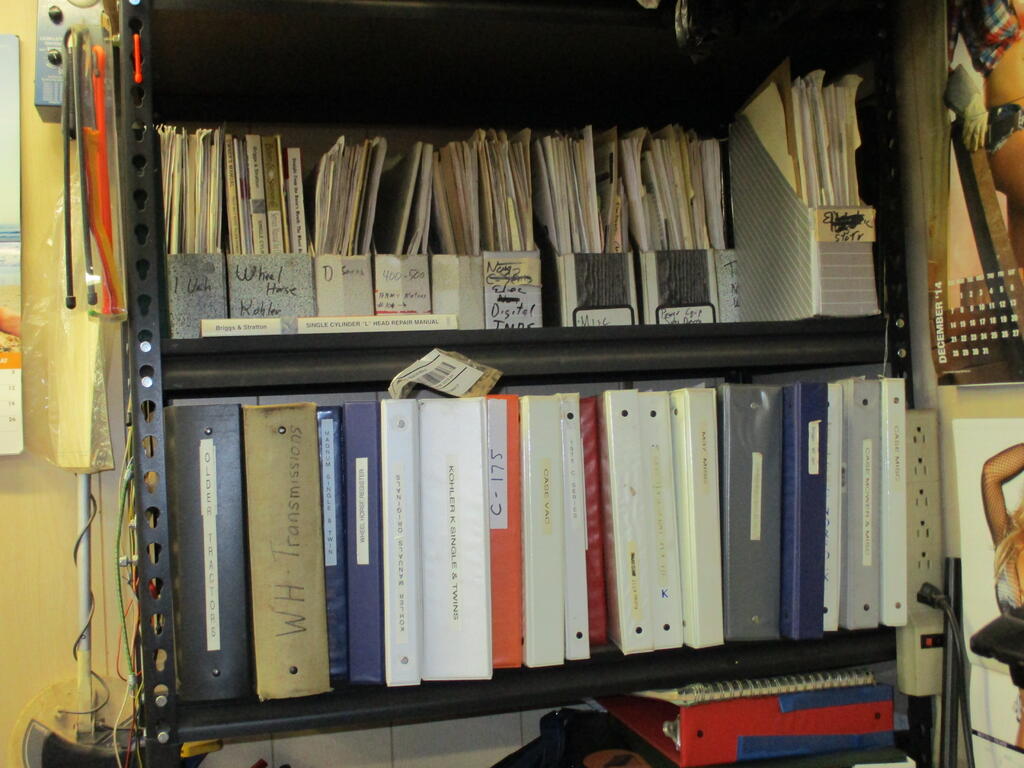

kpinnc 18,886 #22592 Posted December 26, 2024 10 hours ago, ebinmaine said: I now have everything neatly divided into several general binders. I always thought I was the only one who does this... I have binders for everything that I have to work on. Greasy smudge fingerprint marked pages and all! 1 1 Share this post Link to post Share on other sites

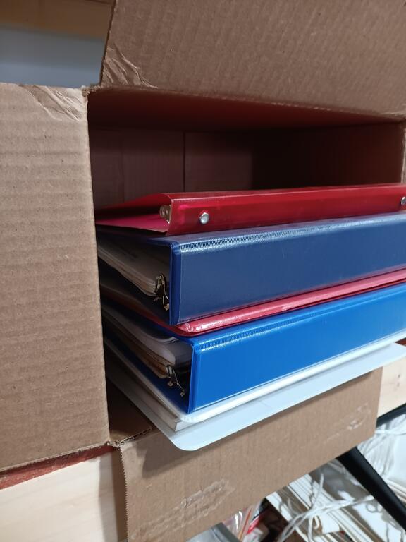

Racinbob 13,111 #22593 Posted December 26, 2024 16 hours ago, ebinmaine said: Been working on the organization and movement of the basement workshop to the new workshop space. Today I completely undid and redid my selection of paper manuals. I've had the BBT print a few here and had several Redsquare members send me older paper copies. I now have everything neatly divided into several general binders. As in the picture: 1. A Yost Vise manual. 2. General Wheelhorse info we've printed or had mailed here. 3. Original Wheelhorse tractor manuals or sales pieces. 4. Twin cylinder Kohler manuals. 5. Single cylinder Kohler manuals. Wife keeps saying I should just save it to the computer. 4 1 Share this post Link to post Share on other sites
ebinmaine 80,310 #22594 Posted December 26, 2024 1 minute ago, Racinbob said: Wife keeps saying I should just save it to the computer. I do most of my searching on the electronic devices but every once in awhile you just need to have a piece of paper in your hand so you can flip a page back and forth instead of trying to manage the smart dumb smart phone.. 2 Share this post Link to post Share on other sites

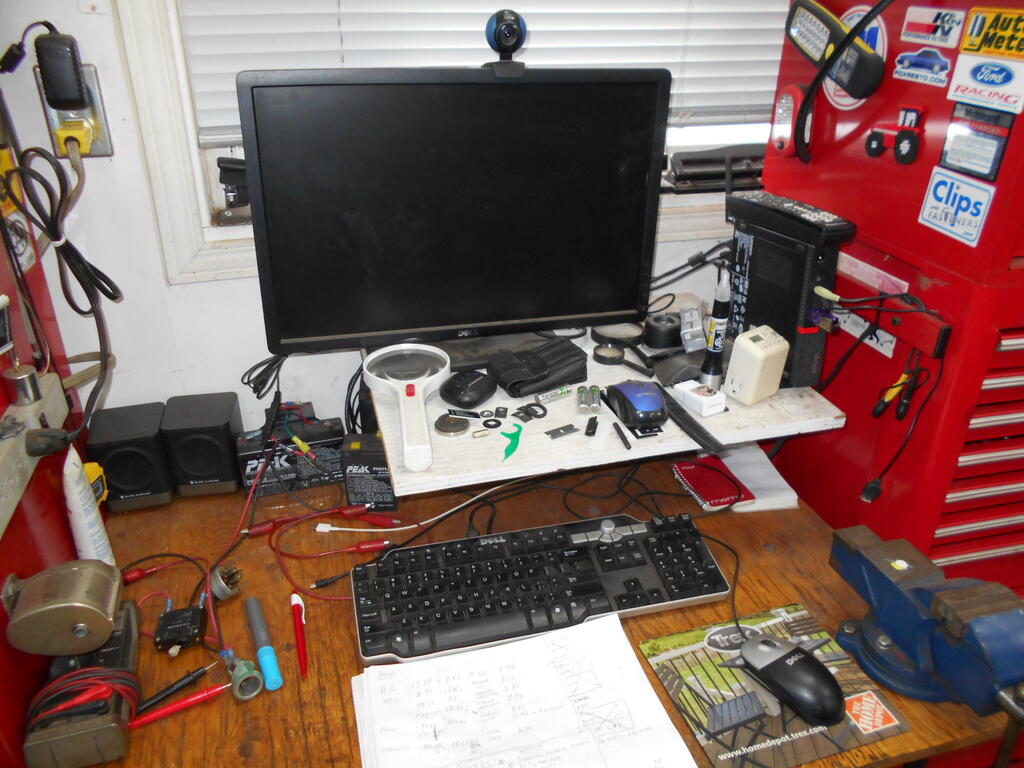

cleat 9,229 #22598 Posted December 26, 2024 I have most of the owners and parts manuals for all of my tractors and implements printed out. However, I rarely use these as I have a computer in the garage and have all the manuals saved on it as well. This manual contains some of the drawings for parts that I have fabricated. 1 5 Share this post Link to post Share on other sites
