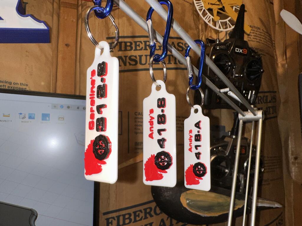

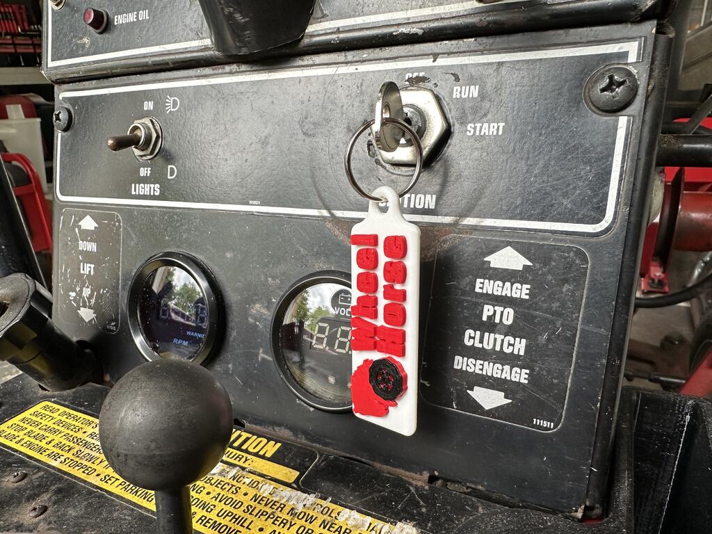

Steve Janninck 172 #21951 Posted August 25, 2024 (edited) Worked on making some personalized Key Chains for a friend. I think they turned out well! 3D printed in 3 colors. The one I made for mine is not personalized. Always fun to be making something unique and useful. It is a small thing to do on a WH, but an easy way to finding the key on the key rack! Steve Edited August 25, 2024 by Steve Janninck Text Spelling 7 14 Share this post Link to post Share on other sites

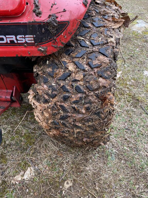

ebinmaine 80,892 #21952 Posted August 26, 2024 1 hour ago, Sparky said: Like this… Excellent pic Mike! This is what my whole forest floor is. 2 Share this post Link to post Share on other sites
rick 318 #21953 Posted August 26, 2024 Carlisle designed that tire for hard packed surfaces, I'm not surprised that the tires sort of failed the mud test. 3 Share this post Link to post Share on other sites
ebinmaine 80,892 #21954 Posted August 26, 2024 1 minute ago, rick said: Carlisle designed that tire for hard packed surfaces, I'm not surprised that the tires sort of failed the mud test. I can see the logic there. I've had great luck with a good old fashioned R1 AG tire. Just wondering if there's a usable alternative that goes well in reverse. Share this post Link to post Share on other sites
rick 318 #21955 Posted August 26, 2024 (edited) I use a Carlisle ag tire if I plow the garden. Otherwise I have found that a turf tire with 2 link chains works well in snow and wet ground. I wish there was a differential lock on our Horses. Of course then I'd dig two holes when I lose traction! Edited August 26, 2024 by rick hit enter too soon! 1 1 1 Share this post Link to post Share on other sites
ebinmaine 80,892 #21956 Posted August 26, 2024 48 minutes ago, rick said: I use a Carlisle ag tire if I plow the garden. Otherwise I have found that a turf tire with 2 link chains works well in snow and wet ground. I wish there was a differential lock on our Horses. Of course then I'd dig two holes when I lose traction! Agreed. Trina sometimes uses chains year round on her lighter mid 60s rigs with 6 speeds and Limited Slip Differential. Mine are all larger heavier C Series. On my 3 season tractors I use AG tires, sometimes chains. My winter Horse has turfs with chains. 1 Share this post Link to post Share on other sites
Ed Kennell 47,569 #21957 Posted August 26, 2024 Turfs and 2 link vee bar chains for me for woods work(dragging fire wood logs and pulling down leaner blowdowns) and snow removal on unpaved roads. Turfs and rubber chains on paved surfaces. Steel chains are useless on my steep paved driveway. 5 Share this post Link to post Share on other sites

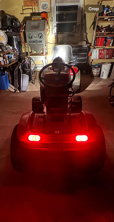

PWL216 1,294 #21961 Posted August 28, 2024 Replaced the rear lights on the 418-8. Ordered a new seat and a set of used Simplicity slides based on a recommendation from @wallfish in an older post. 7 3 1 Share this post Link to post Share on other sites

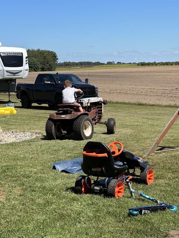

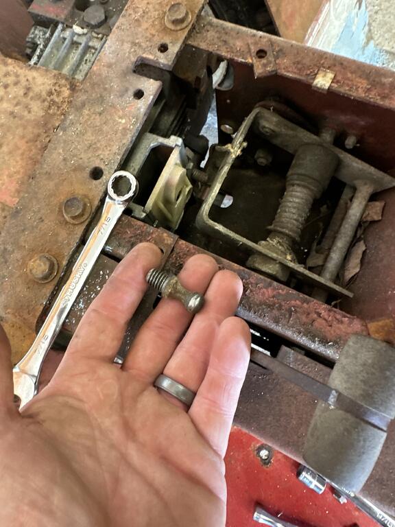

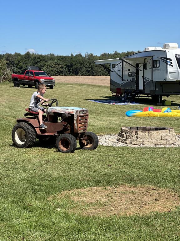

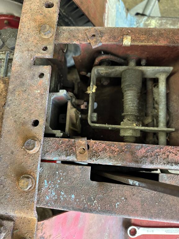

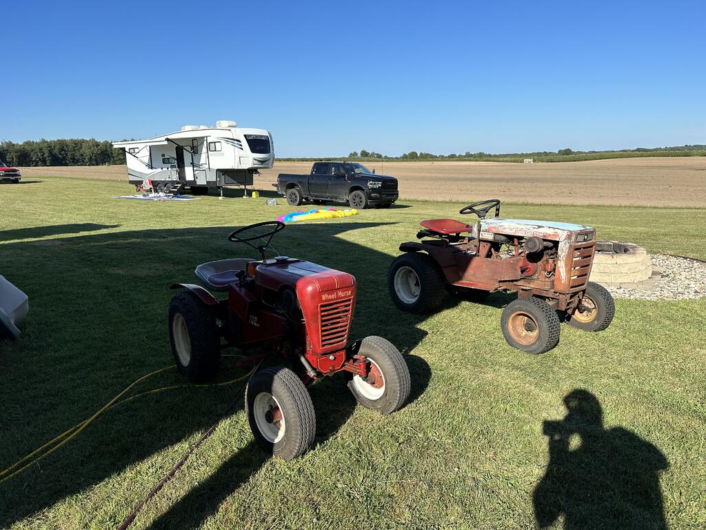

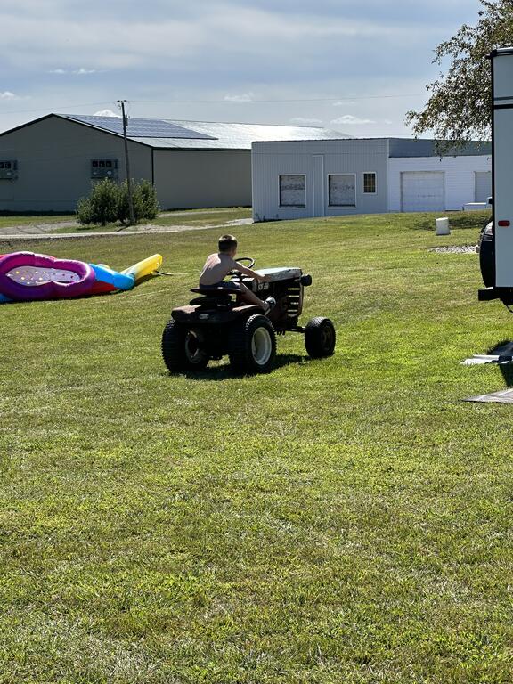

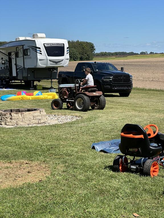

Pullstart 71,356 #21964 Posted September 1, 2024 I’ve talked of Henry before, and his C-120. When they got it from me, it only had forward gear and I sent another hydro with it. We are camping at their house this weekend and got it going again! It needed fresh transmission fluid and when the new trans got put in, the cam ball post apparatus wasn’t aligned. 2 1 Share this post Link to post Share on other sites
Pullstart 71,356 #21965 Posted September 1, 2024 I loosened the trans from the frame and we were able to jack it up enough to get the post in place. After pulling the plug and letting the engine rotate the transmission pulley with the starter for a bit, we pulled enough fluid down the fill tube to fire it up! 4 8 Share this post Link to post Share on other sites

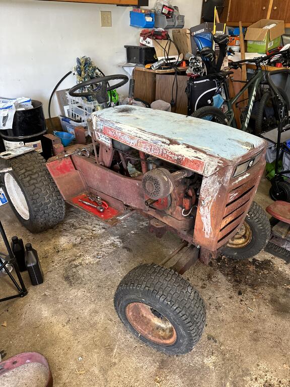

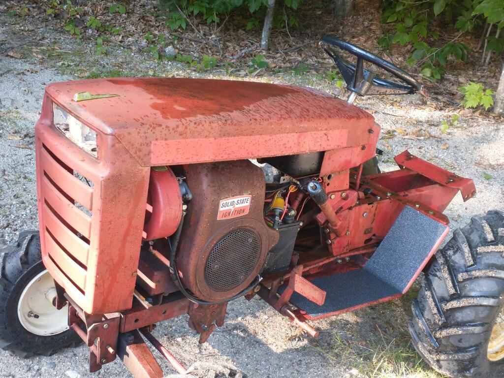

Wheelhorse#1 1,997 #21967 Posted September 1, 2024 (edited) Pressure washed the new to me C-101.It had been sitting for many yrs and was way over due. The hood is off to the side. Edited September 1, 2024 by Wheelhorse#1 3 5 Share this post Link to post Share on other sites

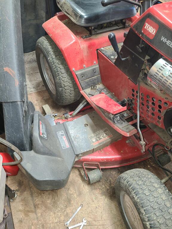

Cee245 861 #21969 Posted September 2, 2024 I put our grass collection system on the 416h and while mowing, the blades kept slowing down for some strange, odd, unknown reason. I contemplated stopping and investigating the cause, but the grass wasn't too high and was mostly weeds so it was very slow, but bearable as my lawn is about 1/2 acre. I mean, I KNOW I didn't over grease the pto FOR SURE this time. I'm positive 😌. I've cleaned and regreased many times! Right? ....hmm. well, on 2nd thought, I HAVE been wrong once or twice before... 🥸 3 1 2 Share this post Link to post Share on other sites
Handy Don 17,554 #21970 Posted September 2, 2024 (edited) 5 minutes ago, Cee245 said: over grease the pto Sadly, you may discover that the fiber has been irretrievably contaminated and need replacing. Edited September 2, 2024 by Handy Don 1 Share this post Link to post Share on other sites
Cee245 861 #21971 Posted September 2, 2024 @Handy Don No worries, I've been down this path before. Thankfully, I've keep 2 spare's for this possibility! 5 Share this post Link to post Share on other sites
8ntruck 9,330 #21972 Posted September 3, 2024 8 hours ago, Handy Don said: Sadly, you may discover that the fiber has been irretrievably contaminated and need replacing. Brake cleaner would not help? Maybe some Fullers earth? 2 Share this post Link to post Share on other sites
ebinmaine 80,892 #21973 Posted September 3, 2024 8 hours ago, 8ntruck said: Brake cleaner would not help? Maybe some Fullers earth? I've always been told by sales reps and technician training that once a brake shoe is soaked it is no longer usable.. But I can't honestly tell you if that's because they want to sell you brake shoes more than they want to sell you brake cleaner. I've used brake cleaner with success in the past but I wouldn't do it on somebody else's vehicle. 3 Share this post Link to post Share on other sites

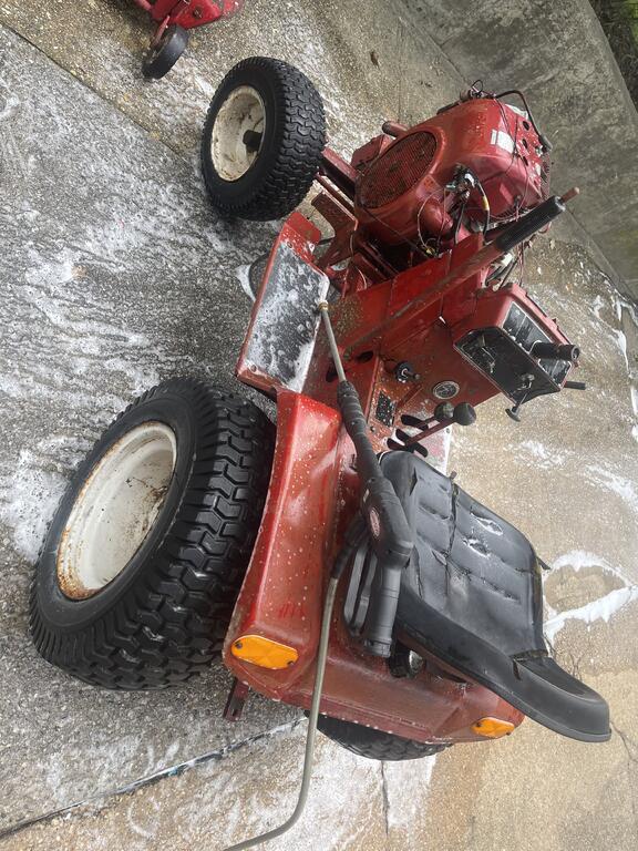

ebinmaine 80,892 #21975 Posted September 3, 2024 Bath time!! 5 4 Share this post Link to post Share on other sites
