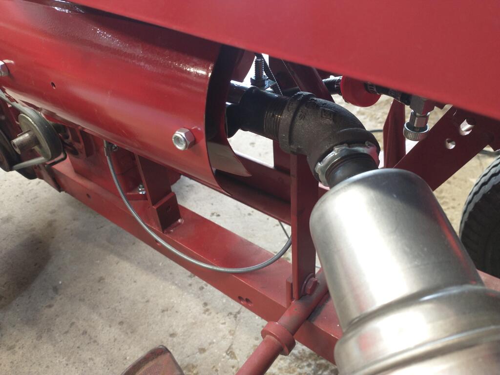

squonk 47,765 #21728 Posted July 12, 2024 (edited) Made a test run on my prototype 551 air gap heat shield on a fairly warm day. No singed leg hairs and the paint held up. I'd like a little better bend in the end but I'm not metal fab guy. If I can find the right size dolly maybe I can get it a little better. Edited July 12, 2024 by squonk 6 8 Share this post Link to post Share on other sites

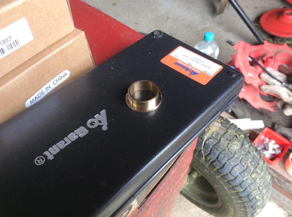

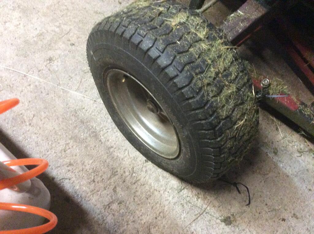

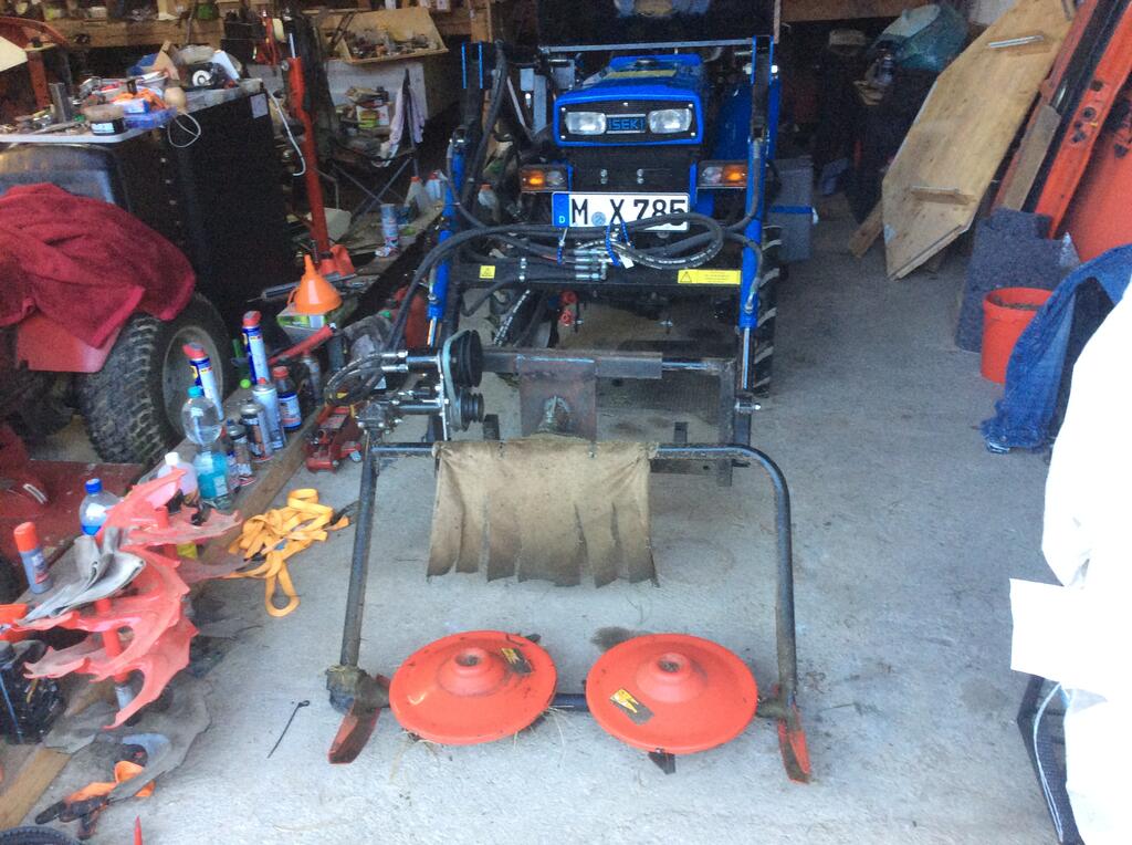

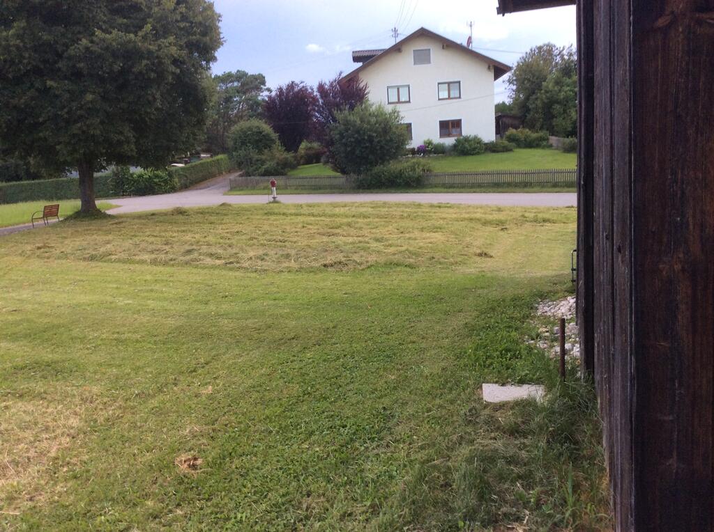

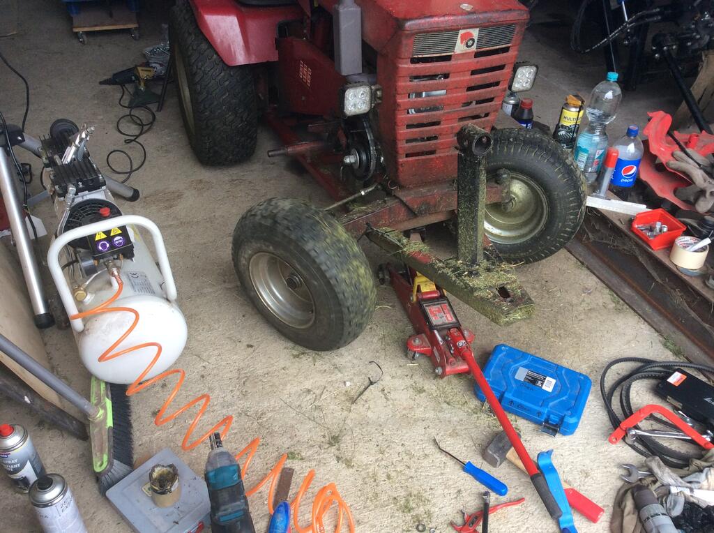

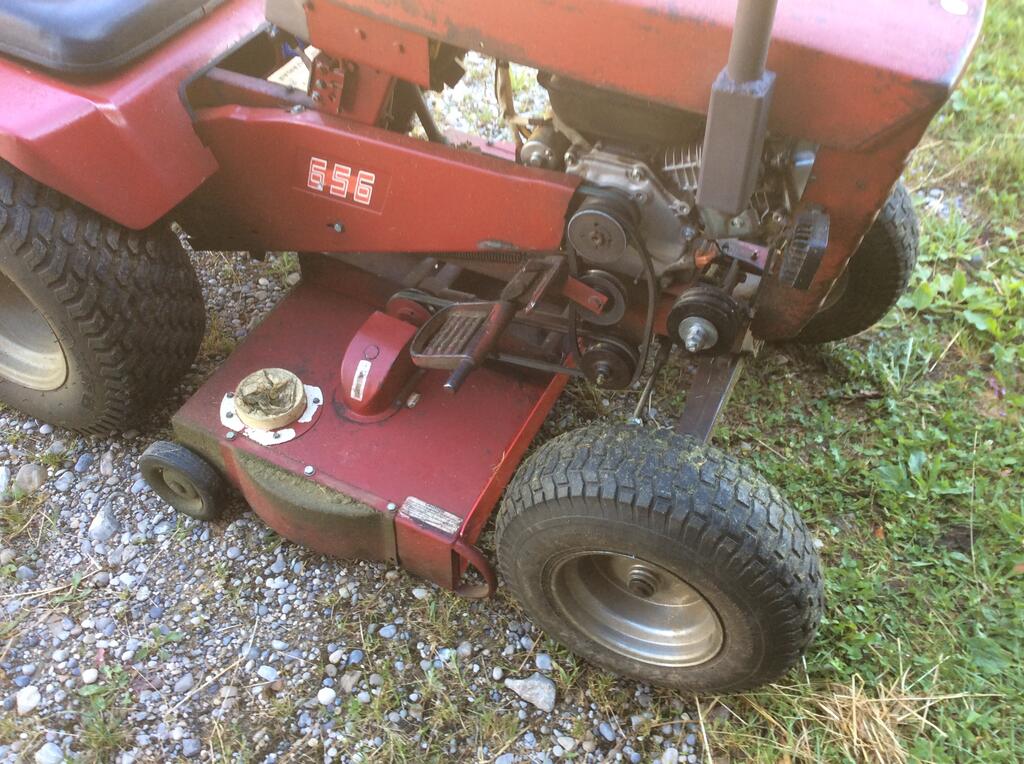

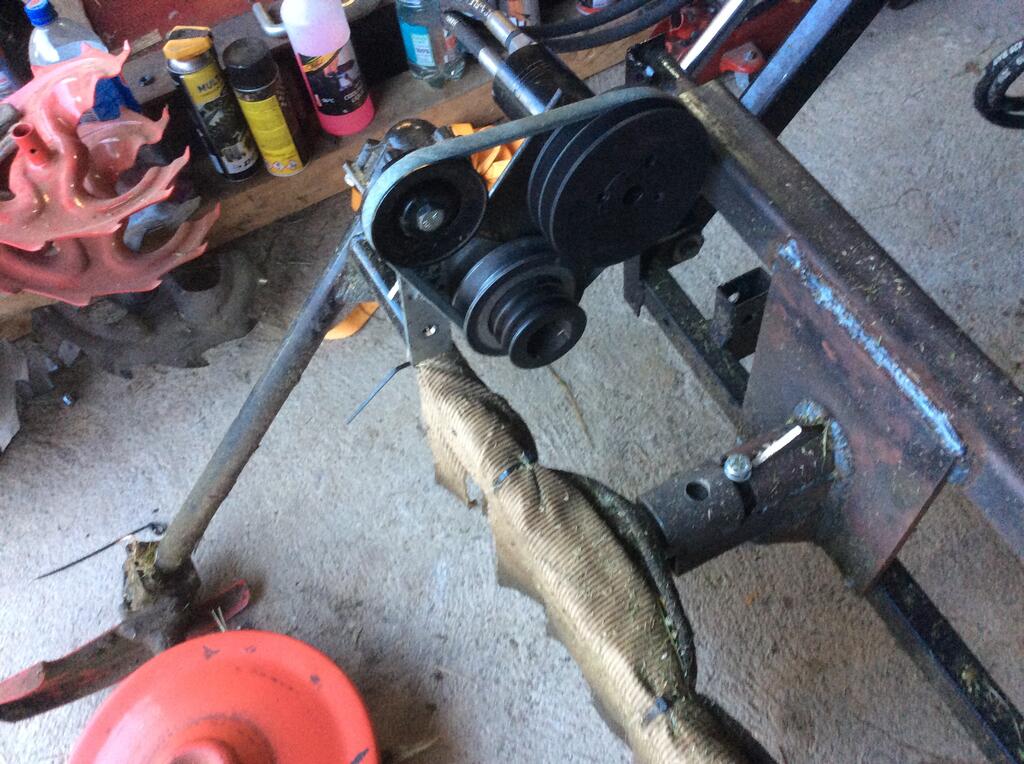

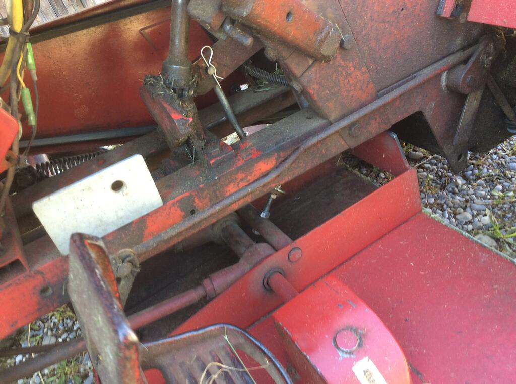

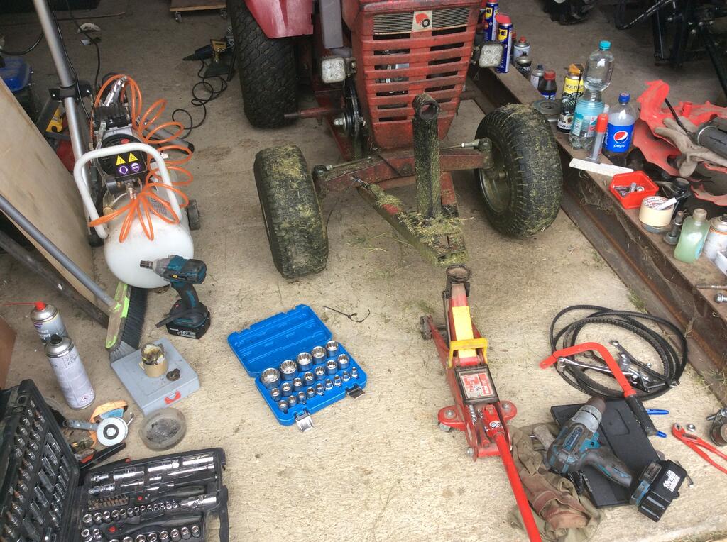

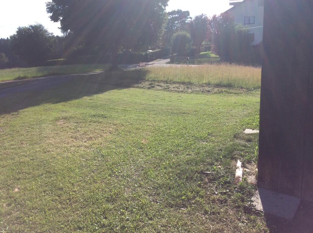

Tractorhead 9,217 #21731 Posted July 13, 2024 Firstly fixed the flat Tyre While i do this, i see the right front was also not proper filled and i increase the Pressure a little up to 0,8 Bar. but than i see the left tyre begins ti rip..🤬 Ok so far they will still be usable but 2 new tyres will be ordered soon. I don‘t trust em with heavier Load on the Trailer... 😎 T Than i fabbed me a sleeve bushing for the Steering to reduce the side gap it has. Need one more and reset the Mowerdeck to it‘s original link instead of the Chain. Than i installed the Suicidal Mower but it was not funny - zillions of Moleholes - each 2 m the belt jumps off. 3 h Sun wasn‘t enough to dry the Fields but next Rain occurs, so i decided it must go - now. I decided to give the Suicidal mower a Hydraulic Motor and check if i can better handle with the FEL. This plan was still in mind but now i give it a Try. Ok Not perfectly, i must multiple adjusting the right Angle and i have to rework the Gearratio. the high beltgear ratio consumpts too much power and it didn‘t need 7000 rpm on the Discs. it shure sounds like an Alarm - „don‘t get too close“ but on mowing task it has not enough power to stay at this rpm. have another solution prepared that reduces the ratio to 2900rpm with different Beltpulleys, what should be fine and increases the Power to mow. We will see how this turns out. At least Ed Kenells sign found it’s Way to my side door on the Shed. Thanks Ed ! 11 3 Share this post Link to post Share on other sites

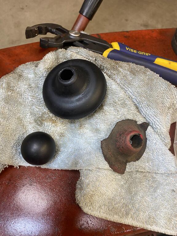

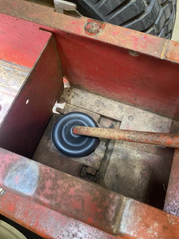

Sparky-(Admin) 26,186 #21732 Posted July 13, 2024 857 got a new shifter boot…the old boot still had another ten years of service left in her I’m sure, but figured why not 10 2 Share this post Link to post Share on other sites

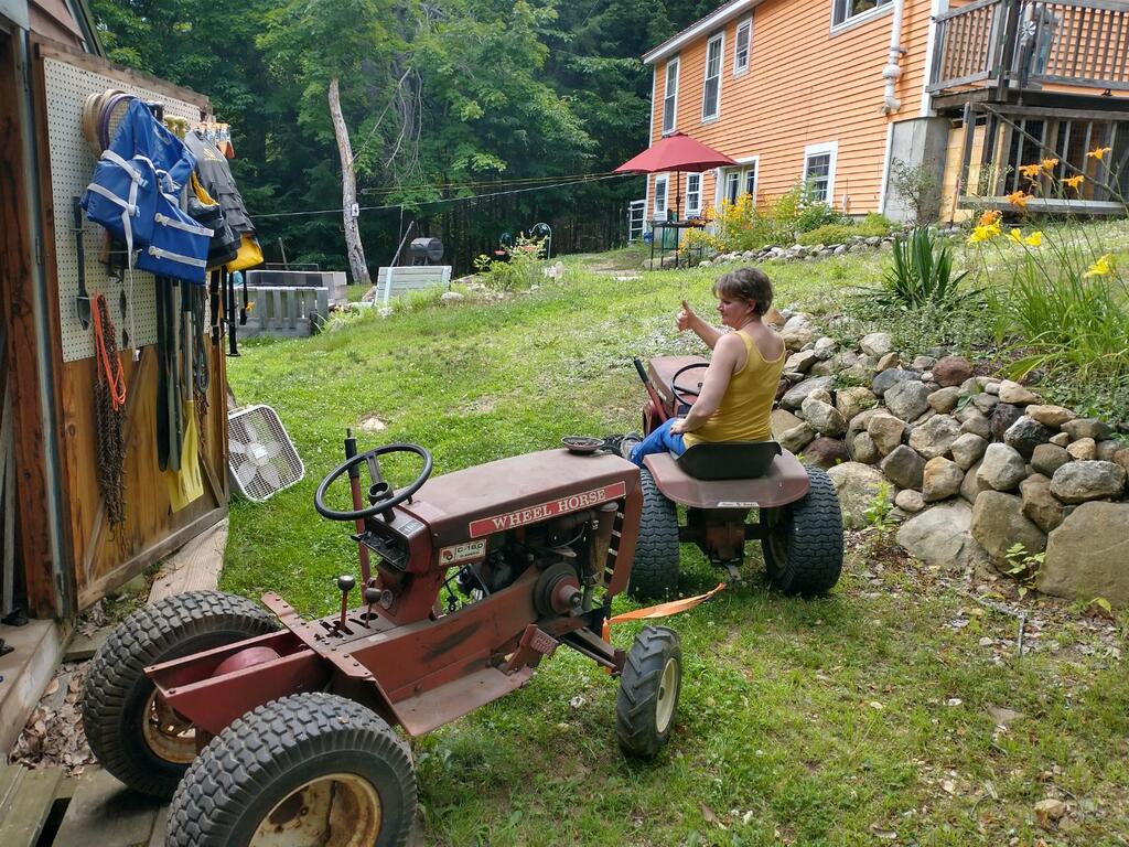

ebinmaine 80,089 #21736 Posted July 13, 2024 Got another carb in the ultrasonic cleaner. Also had BBT pull tug tow yank my 1974 C160-8 Tecumseh Horse project up to the barn for some work. 6 6 Share this post Link to post Share on other sites

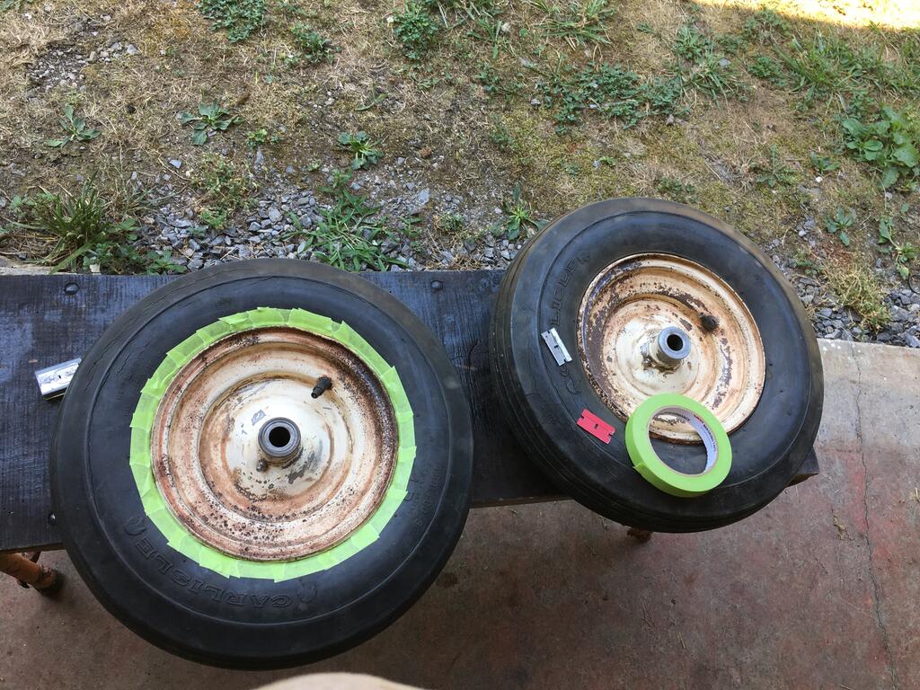

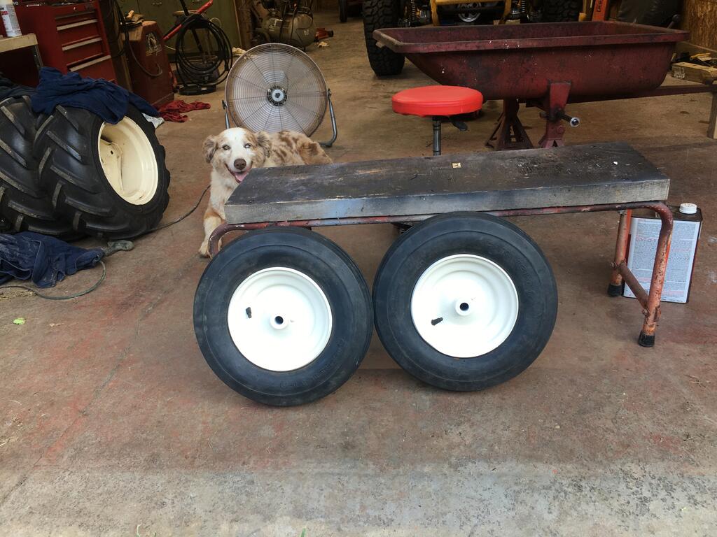

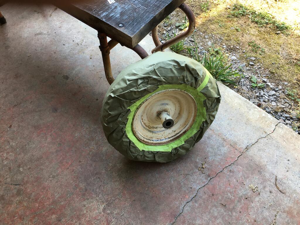

sqrlgtr 3,598 #21737 Posted July 14, 2024 Painted some wheels RustyO Canvas White for my new to me cart. Actually done these on Saturday but just getting around to posting it… 11 4 Share this post Link to post Share on other sites

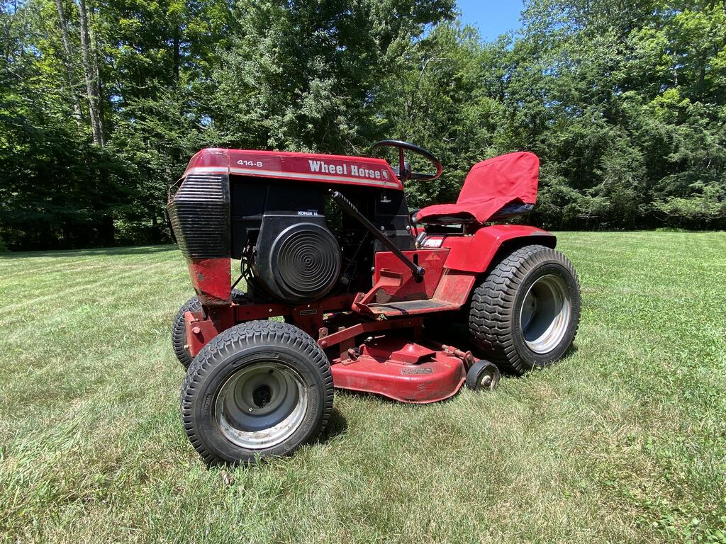

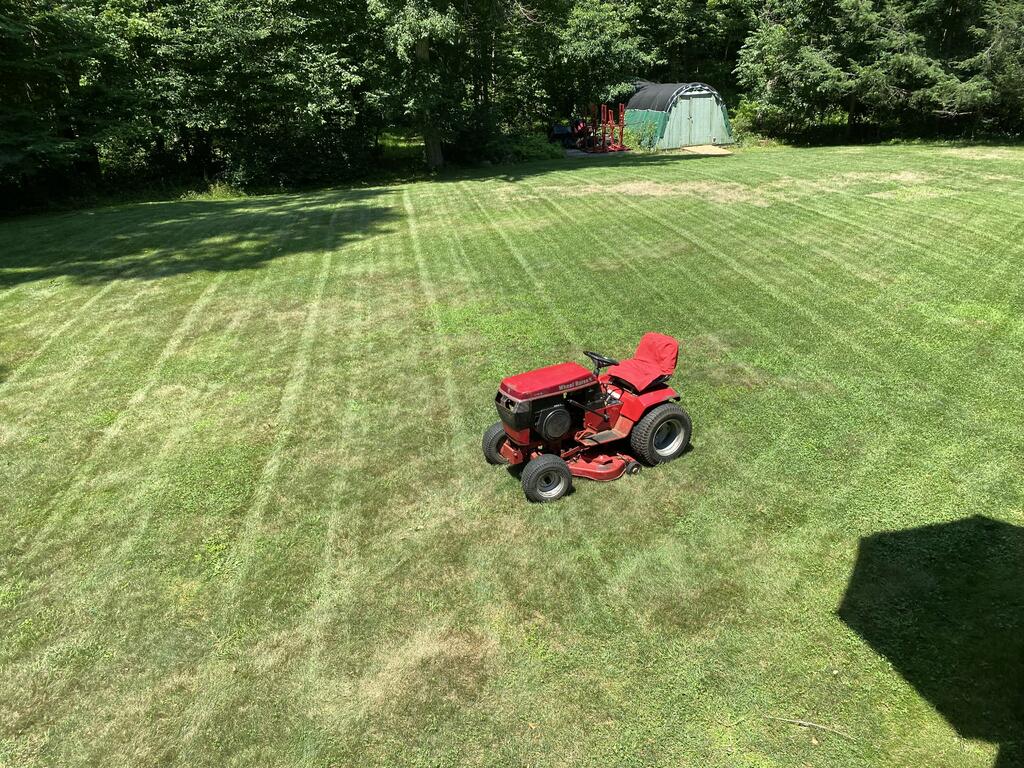

Sparky-(Admin) 26,186 #21738 Posted July 14, 2024 Mowed with my $100 414-8 today. She needed a slight carb adjustment today and then ran and mowed great . Todays lawn stripes brought to you by a 36” RD 7 8 Share this post Link to post Share on other sites

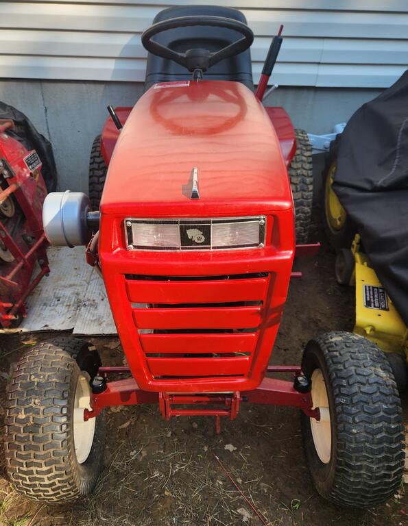

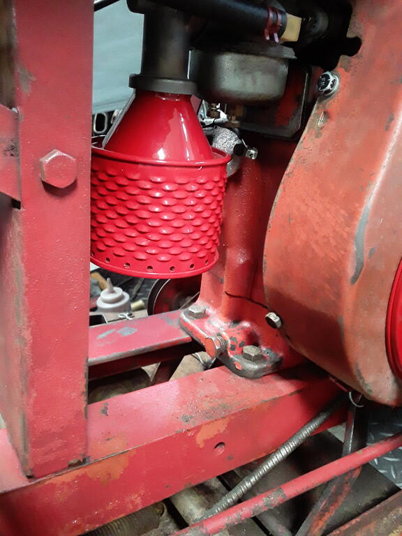

76c12091520h 4,282 #21739 Posted July 15, 2024 Installed a NOS air cleaner assembly on the 401 since the original was long gone. 2 5 Share this post Link to post Share on other sites
Handy Don 17,203 #21740 Posted July 15, 2024 4 minutes ago, 76c12091520h said: How do these work internally? Oiled foam or oil bath or some sort of filter element? Share this post Link to post Share on other sites

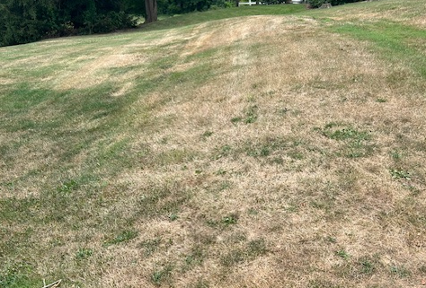

JoeM 10,122 #21741 Posted July 15, 2024 20 hours ago, Sparky said: Todays lawn stripes brought to you by a 36” RD I always liked those 36's, mowed for 20 years with one. Now that I am retired, i had to go bigger cause of the lack of free time! No strips here, just brown accents! Not much rain in the last 3 weeks. 1 1 2 Share this post Link to post Share on other sites

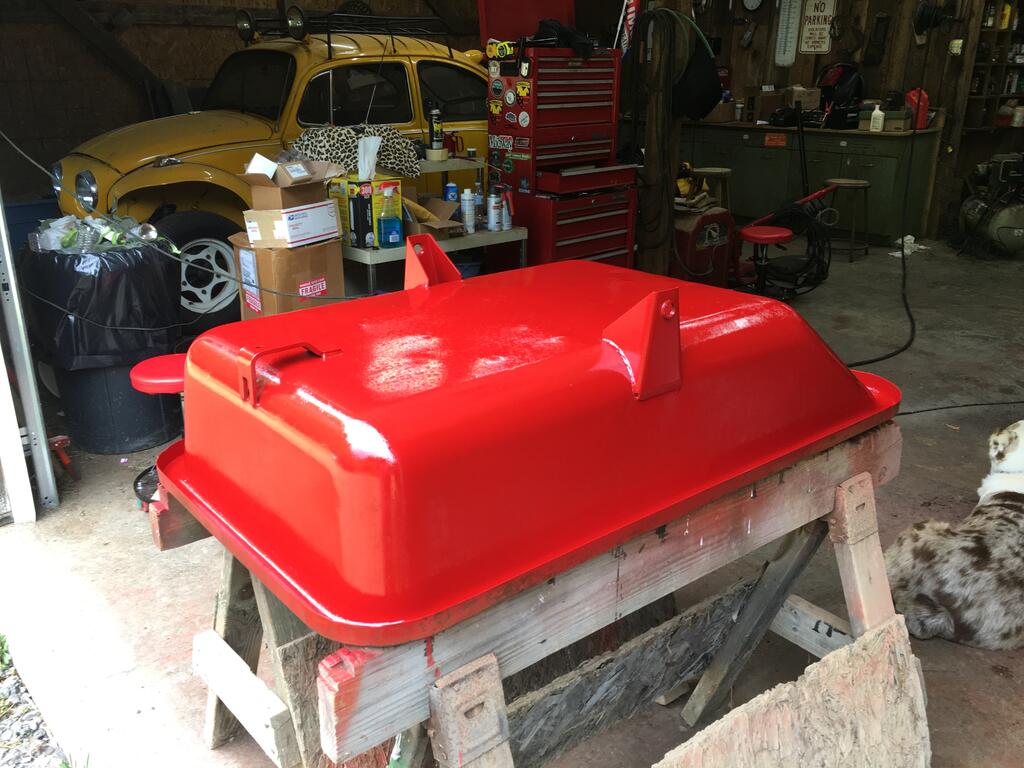

sqrlgtr 3,598 #21742 Posted July 15, 2024 Sprayed some Regal Red on bottom of my cart, will wait until tomorrow and flip it over to finish it and running gears. Just barely had enough paint so hopefully can find some more in morning . 4 7 Share this post Link to post Share on other sites
lynnmor 8,971 #21743 Posted July 15, 2024 1 hour ago, sqrlgtr said: Sprayed some Regal Red on bottom of my cart, will wait until tomorrow and flip it over to finish it and running gears. Just barely had enough paint so hopefully can find some more in morning . Keep in mind that spraying over what already has been applied can lead to issues. The instructions say "Dries tack free in 2-4 hours, to handle in 5-9 hours and fully dry in 24 hours. Primers may be top coated immediately. Apply a second coat or clear coat within 1 hour or after 48 hours." 2 Share this post Link to post Share on other sites

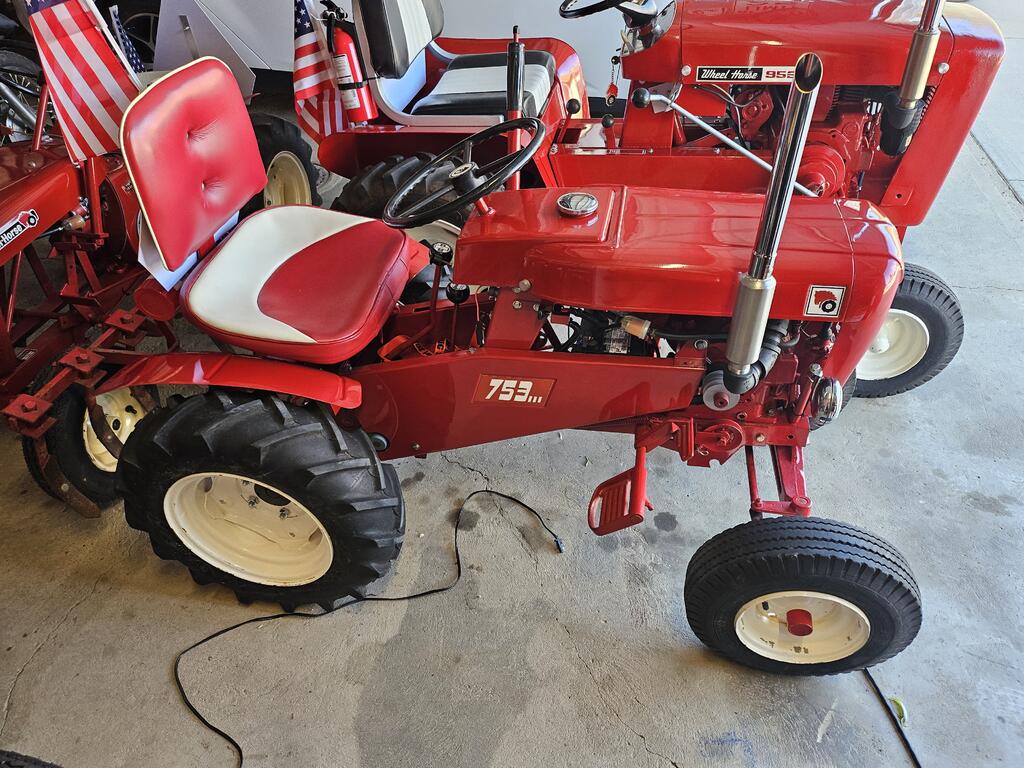

ML3 2,464 #21744 Posted July 15, 2024 My stack came today for the 753. Shout out to Chad @Phat Stacks. 1 8 Share this post Link to post Share on other sites

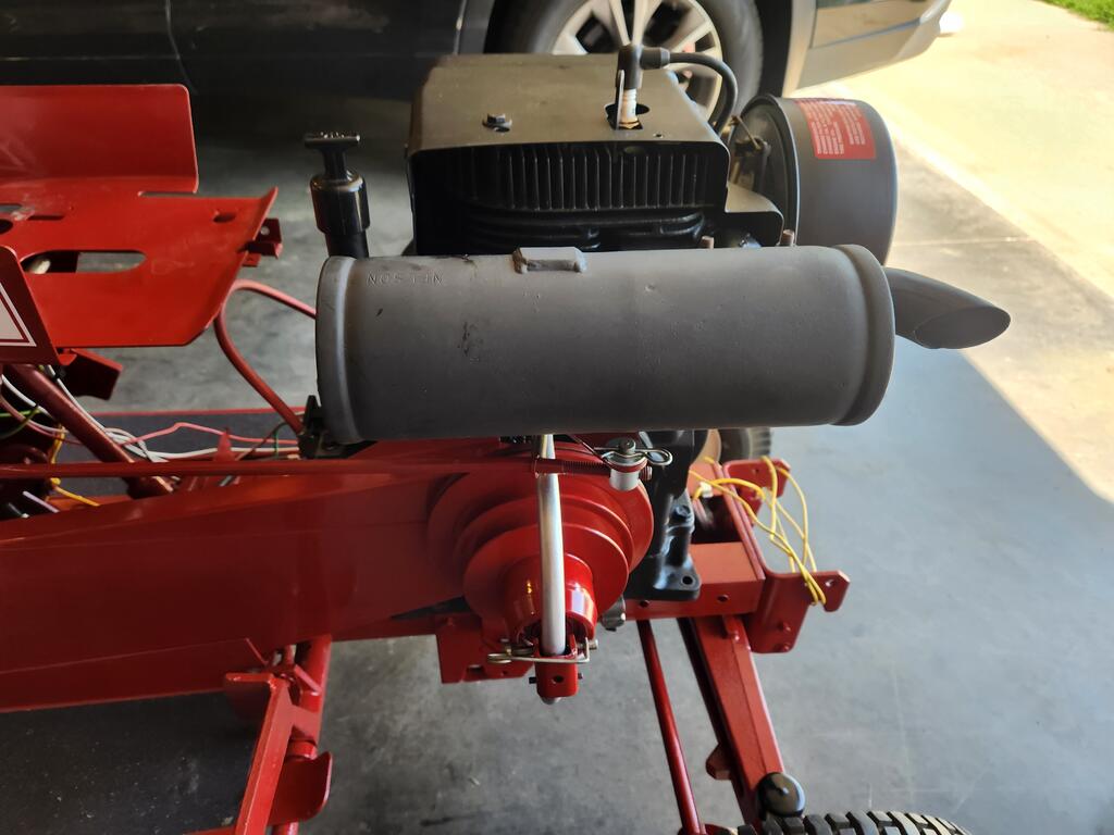

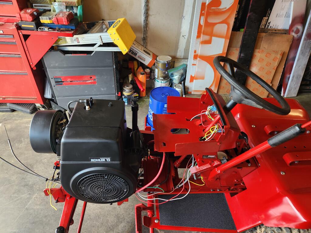

Goldnboy 1,140 #21745 Posted July 16, 2024 C120 special says...tecky no more! I also never could find out if the hood will fit...and Magnum mufflers will not work... So went to a round muffler. 3 4 Share this post Link to post Share on other sites
ebinmaine 80,089 #21746 Posted July 16, 2024 54 minutes ago, Goldnboy said: C120 special says...tecky no more! I also never could find out if the hood will fit... >>>>> Magnum Does the stock OE C120 hood fit over the more square Magnum engine? 1 Share this post Link to post Share on other sites

Monstrosity 1,153 #21749 Posted July 16, 2024 On 7/13/2024 at 10:30 AM, Sparky said: 857 got a new shifter boot…the old boot still had another ten years of service left in her I’m sure, but figured why not Yeah I picked up a few boots myself I said why not lol Share this post Link to post Share on other sites
