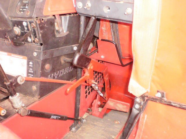

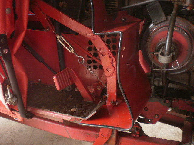

Ed Kennell 47,594 #2128 Posted April 10, 2019 (edited) Got the 520H plow installation finished yesterday. Blade angle and was a challenge. It ain't purdy, but it works great. Edited April 10, 2019 by Ed Kennell 3 2 Share this post Link to post Share on other sites

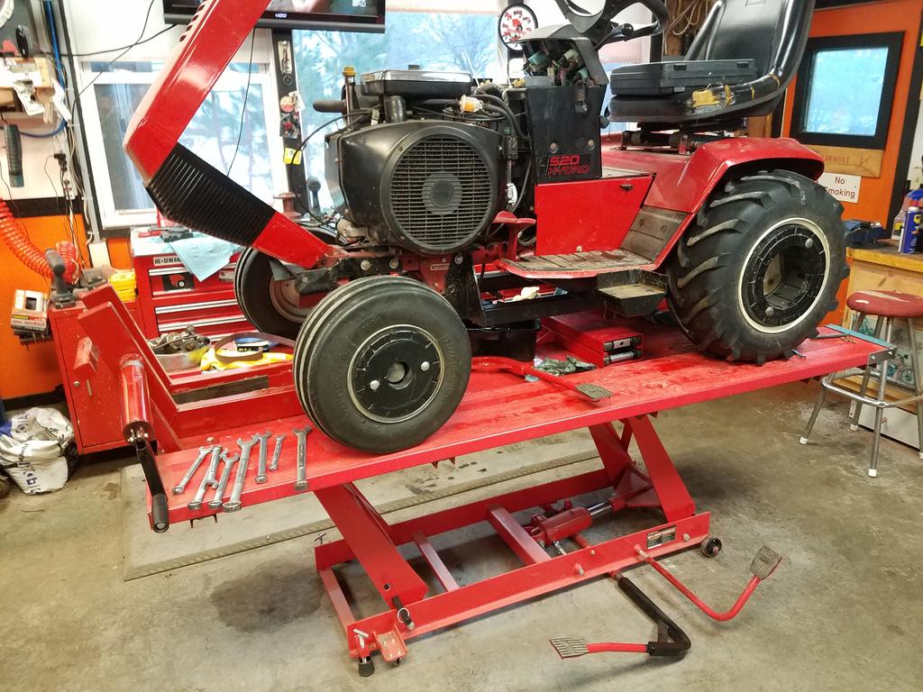

Alex175 785 #2132 Posted April 13, 2019 Got my C-175 back up and running yesterday. I had a laundry list of problems, some big and some small, so I put the tractor on the lift and got them done. Project one was to find out why my key stopped working. Turns out my PTO interlock switch had some gunk in it. Sprayed it down with electrical parts cleaner and that convinced it to start working again. Project two was to replace my front axle. Years ago before I owned the tractor part of the axle cracked and was repaired. I picked up a spare to replace it with when I had time so that went fairly smooth, just need to replace the tie rods soon now Project three was a decision made after taking half the tractor apart for projects one and two. For as long as I have owned it (5 years) and for as long as I can remember before that when it was my grandparents tractor the lights never worked. So I picked up some new lights for it, ran all new wiring, and now the old girl can see in the dark again. Now it's time to get the mower blades sharpened, the deck on it, and get my leaf vacuum that is in pieces back together because I need to clear my yard before I can mow it but at least today is supposed to be 70 and sunny! 5 3 Share this post Link to post Share on other sites

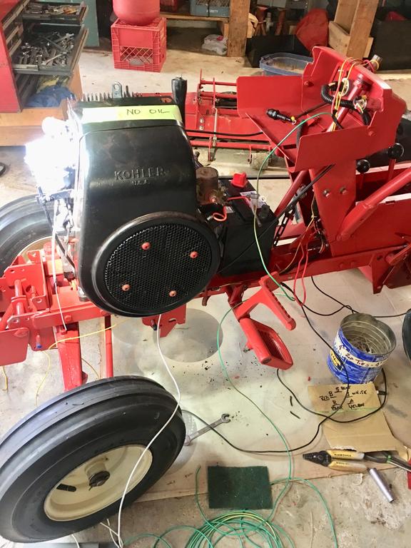

The Tuul Crib 7,354 #2134 Posted April 13, 2019 Went for another run with my 855 today ! Got a little frustrated with wiring up my 1067 build! 6 3 Share this post Link to post Share on other sites

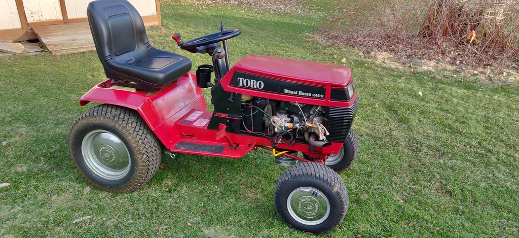

CountryRock 199 #2135 Posted April 13, 2019 Woke up the 246H from its winter slumber and pulled the deck off to clean remnants from last seasons final mowing out of it. Gotta wire brush the underside and paint it before I start mowing this year. Decided I'm gonna change out the battery cables on it as well. Also put the proper drive belt tension spring on the tractor. Previous owner had two smaller springs hooked together on it. 6 4 Share this post Link to post Share on other sites

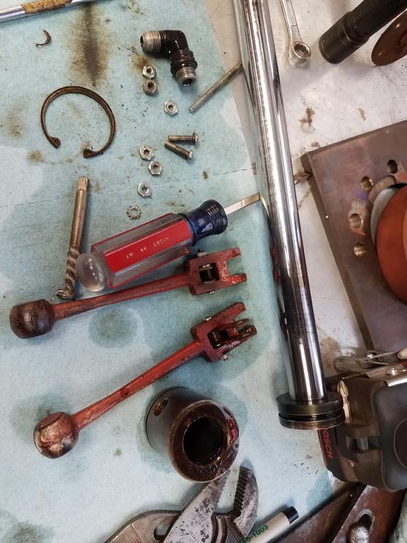

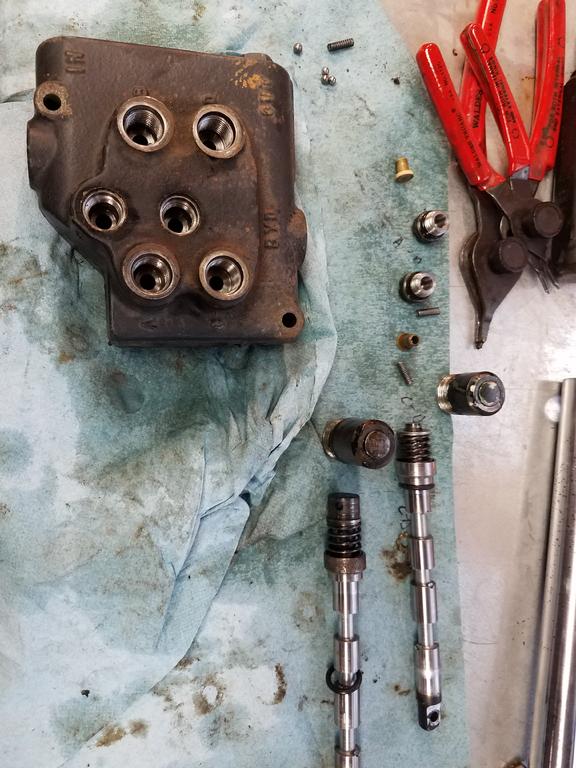

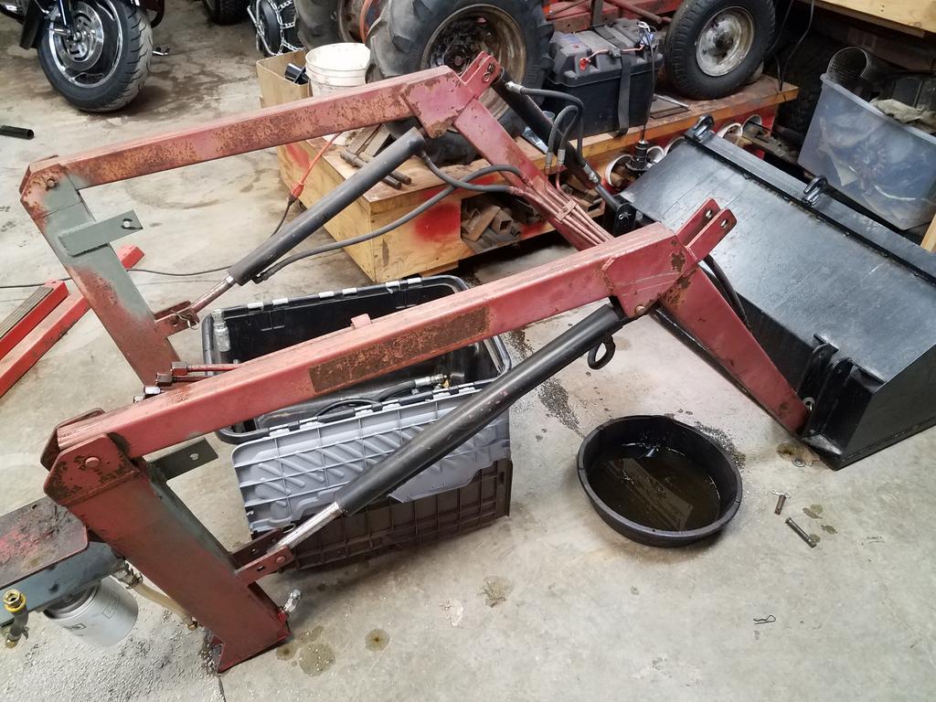

Shynon 7,723 #2137 Posted April 14, 2019 Fixed a leaking wheel seal on the loader. Hub was pretty loose thought I had a bad bearing. Key was loose installed a new one tried some JB weld to make up the small gap. We'll see if that works. Pulled the vavle apart to clean out and new o rings. Opened up one cylinder for rebuild. Plan to do them all plus a few new hoses. Then gonna make a quick attach for the bucket and forks. 6 4 Share this post Link to post Share on other sites

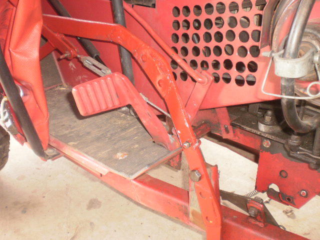

Lee1977 7,805 #2138 Posted April 14, 2019 I decided to put the grader blade back on the 312-8. Crawled under 312 and attached the solid lift link. Pushed the grader blade under the tractor dropped the lift and the solid link was too short. I had loaned grader blade to a friend last fall and just got it back a couple of weeks ago. The 312 has 25 x 900 x 12 Alltrails II on the rear and a few mounts ago I put 16 x 400 x 8 Triribs on the front in place the little 6". I didn't want to fix the grader blade where it wouldn't fit on my other tractors. So I had to make an adapter kit. It's on there but it's not completely finished . 7 2 Share this post Link to post Share on other sites

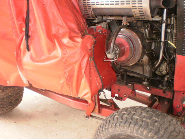

EricF 589 #2139 Posted April 14, 2019 Took a chance with Mother Nature and removed the snowthrower and put it away in the shed... This time I got one of Harbor Freight's heavy duty (molded, steel-reinforced) furniture dollies to roll it away. Sure makes moving that monster a lot easier! Also time to change the paper air filter and clean and re-oil the outer foam dust catcher -- The air filter restriction indicator had flashed a couple of times during the last snow. Took the whole air box off the Onan to check the crankcase breather. And discovered that the shop which had done the work last hadn't even bothered to seat the bottom screen in the breather housing correctly. Not a big problem; it still kept the steel wool filter from falling down too far, but it just bugs me every time I find that shop's slap-dash careless work. Now it's all cleaned up and put together nice and neat. Cleaned up all the inevitable crud that builds up on the surfaces on top of the engine, and found the front spark plug wire's clip was getting loose, so I snugged that up while I was in there. Next, it'll be on to greasing the front end and various other spots, and getting the mower deck tuned up... 3 Share this post Link to post Share on other sites

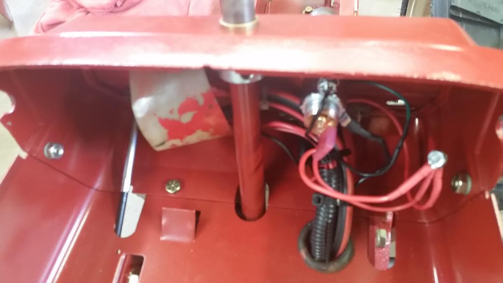

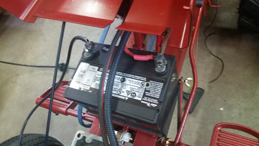

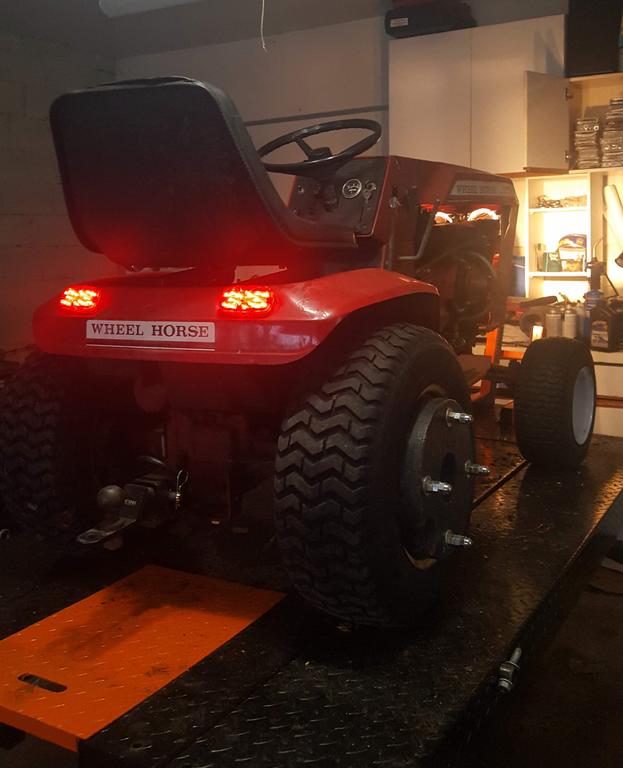

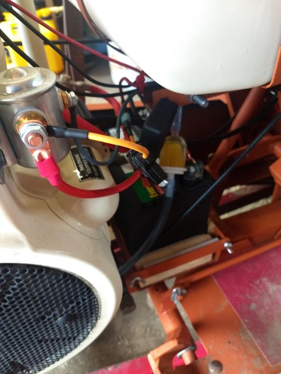

WHX?? 58,302 #2140 Posted April 14, 2019 Looks like you got a rats nest goin on there Cribs Did a little wiring of my own ...definitely gotta have a battle plan going in....'specially with custom indicators. An old set of jumper cables sacrificed their life to provide the 6 ga cables to run to the 70 amp ignition switch. They were made with many strands of small gauge wire and the insulation made them real flexible. I have no clue how they used to do it at the factory with the original stiff cables. 2 4 Share this post Link to post Share on other sites
WHX?? 58,302 #2141 Posted April 14, 2019 (edited) Looks like you got a rats nest goin on there Cribs Did a little wiring of my own ...definitely gotta have a battle plan going in....'specially with custom indicators. An old set of jumper cables sacrificed their life to provide the 6 ga cables to run to the 70 amp ignition switch. They were made with many strands of small gauge wire and the insulation made them real flexible. I have no clue how they used to do it at the factory with the original stiff cables. Edited April 14, 2019 by WHX22 2 Share this post Link to post Share on other sites
WHX?? 58,302 #2142 Posted April 15, 2019 (edited) I have no clue why that double posted!...I may have short stroked it! Edited April 15, 2019 by WHX22 6 Share this post Link to post Share on other sites
Shynon 7,723 #2143 Posted April 15, 2019 (edited) 55 minutes ago, WHX22 said: Looks like you got a rats nest goin on there Cribs Did a little wiring of my own ...definitely gotta have a battle plan going in....'specially with custom indicators. An old set of jumper cables sacrificed their life to provide the 6 ga cables to run to the 70 amp ignition switch. They were made with many strands of small gauge wire and the insulation made them real flexible. I have no clue how they used to do it at the factory with the original stiff cables. How's the oil pan run? Since you got your wiring done. Edited April 15, 2019 by Shynon 2 Share this post Link to post Share on other sites
WHX?? 58,302 #2144 Posted April 15, 2019 Lol... long bases make for a better for garbage cans and ash trays then short pans do.....I really do need to get that .020 piston to the machine shop! 1 1 Share this post Link to post Share on other sites
squonk 48,215 #2145 Posted April 15, 2019 Jim, just curious why you went with the 70 amp switch instead of a solenoid? Originality? 1 Share this post Link to post Share on other sites
WHX?? 58,302 #2146 Posted April 15, 2019 Pretty much Mike not to mention I am well stocked on the 70 switches. After the fact now sure is nicer to go solenoid and a five term switch.... just so much more wiring options. 1 Share this post Link to post Share on other sites

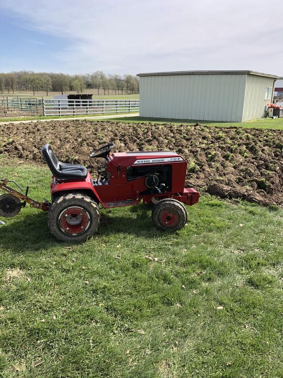

cschannuth 3,821 #2147 Posted April 15, 2019 I removed the snow blade from my Dad’s old C-161 and installed the plow so I could plow my friend’s garden. 2 7 Share this post Link to post Share on other sites
PeacemakerJack 11,068 #2148 Posted April 15, 2019 Love these plowing pics! Make sure you ad this one to the plowing thread please and tell a little bit about your experience—good, bad, or ugly! That is a nice looking machine and I always like to see ‘em with a land plow hooked up. Yes...I’m hopelessly a “plow dog”. I’ll go climb back into the furrow now 2 1 Share this post Link to post Share on other sites

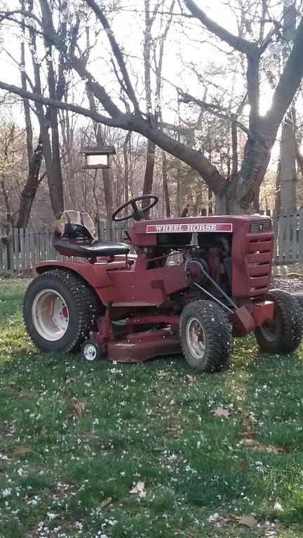

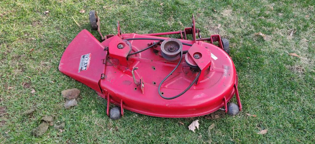

RetroMower 350 #2150 Posted April 15, 2019 I know the clock is ticking on the rear discharge deck my b100 came with but i cleaned it up, sharpened the blades and fixed the tensioning mech anyway. Today i thought what the heck, I will hook it up and see how she mows. Well what I thought was just going to be a few passes turned out to be a half acre. Now I see what everyone is raving about. For being 45 years old she runs and cuts pretty darn good. She does smoke a little and lord knows I need a new seat but what a beautiful machine 5 2 Share this post Link to post Share on other sites
