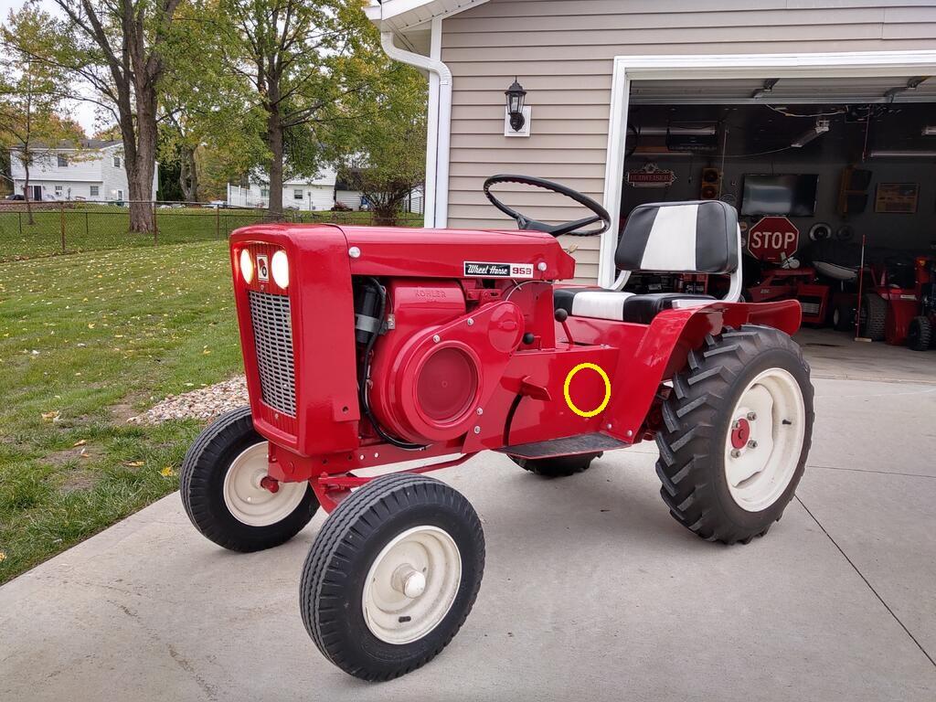

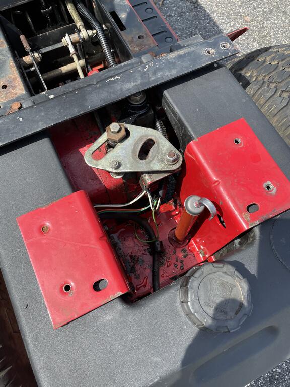

Achto 32,816 #21107 Posted April 7, 2024 (edited) 22 minutes ago, ML3 said: Thinking about changing over to electric fuel pump as well on my 953. If you remove the center panel and the left hand side panel for access. There is a perfect place to install an electric pump in front of the shifter and just behind the hydraulic pump. In the area I have circled. No one will ever know it's there. Edited April 7, 2024 by Achto 3 Share this post Link to post Share on other sites
Ed Kennell 47,551 #21108 Posted April 7, 2024 (edited) 28 minutes ago, cafoose said: Are you referring to the 953 I got from you Ed? Yep, that one should have a lectric pump right behind Dans yellow circle. Edited April 7, 2024 by Ed Kennell 1 3 Share this post Link to post Share on other sites
ML3 2,533 #21109 Posted April 7, 2024 6 minutes ago, Achto said: If you remove the center panel and the left hand side panel for access. There is a perfect place to install an electric pump in front of the shifter and just behind the hydraulic pump. In the area I have circled. No one will ever know it's there. Thanks. 1 2 Share this post Link to post Share on other sites
WHX?? 58,290 #21110 Posted April 7, 2024 8 minutes ago, Achto said: If you remove the center panel and the left hand side panel for access. There is a perfect place to install an electric pump in front of the shifter and just behind the hydraulic pump. In the area I have circled. No one will ever know it's there. Wire it right to the coil hot. 2 2 Share this post Link to post Share on other sites

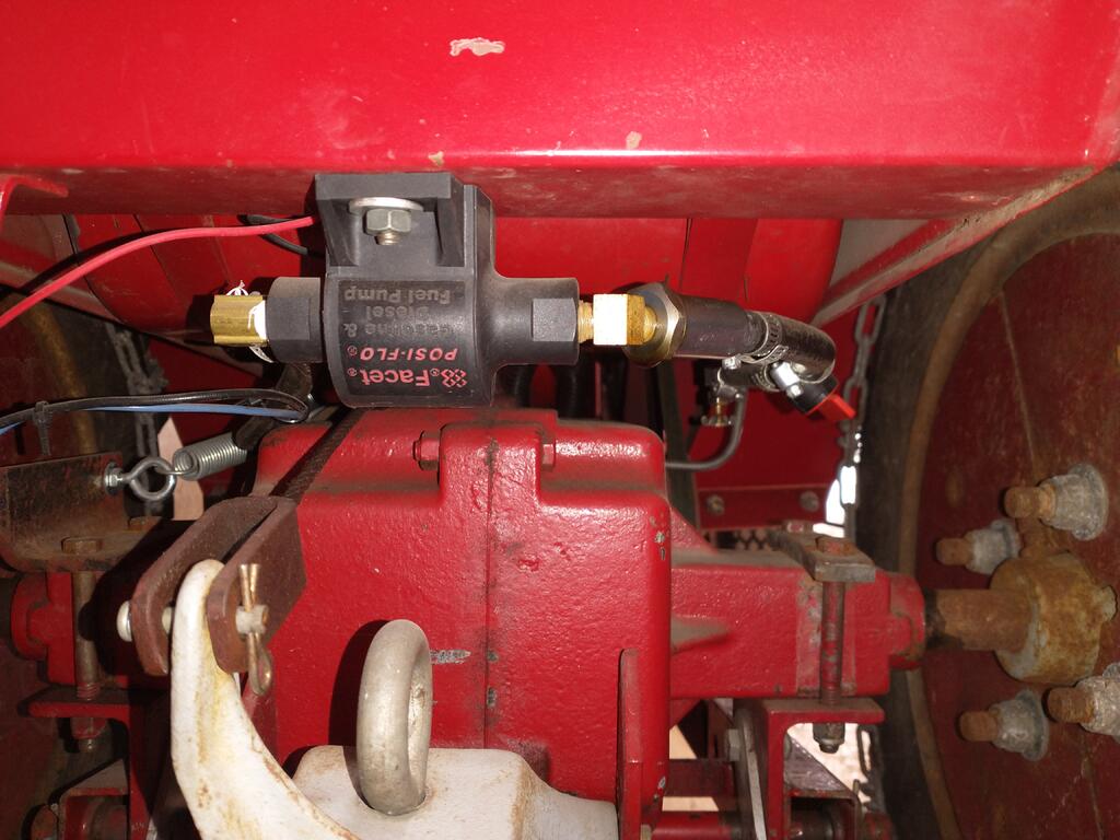

squonk 48,207 #21111 Posted April 7, 2024 (edited) I mounted mine right under the tool box nice and close to the tank. Easy access to the pump and filter. I don't care if it isn't hidden. I just want it to work. Edited April 7, 2024 by squonk 4 Share this post Link to post Share on other sites

Achto 32,816 #21118 Posted April 8, 2024 8 minutes ago, ML3 said: By chance any pics of your fuel pump installation? Unfortunately no. My pump bolted to the left side inside this area. Share this post Link to post Share on other sites
ML3 2,533 #21119 Posted April 8, 2024 8 minutes ago, Achto said: Unfortunately no. My pump bolted to the left side inside this area. I'll figure it out. Just want to keep fuel line away from moving parts. Thanks! 1 Share this post Link to post Share on other sites

squonk 48,207 #21121 Posted April 8, 2024 3 hours ago, ML3 said: Thanks! I'll look it up. Just another project to add to my "to do" list 🙄 By chance any pics of your fuel pump installation? Here's where I mounted my pump 4 1 1 Share this post Link to post Share on other sites

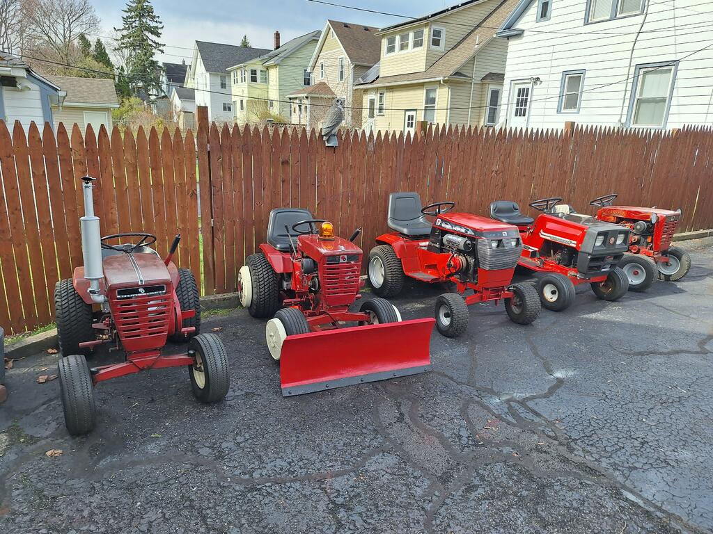

D_Mac 9,339 #21122 Posted April 8, 2024 So I emptied the garage out today. Figured I would take a family photo. Guess which one isn't related. Still love it, but just not family. 9 2 Share this post Link to post Share on other sites
SylvanLakeWH 32,685 #21123 Posted April 8, 2024 Right color though...! 3 Share this post Link to post Share on other sites
D_Mac 9,339 #21124 Posted April 8, 2024 1 hour ago, SylvanLakeWH said: Right color though...! And a black hood ! 1 1 1 Share this post Link to post Share on other sites

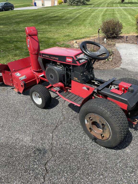

Sodaking27 1,358 #21125 Posted April 9, 2024 A much needed bath for the new addition. Discovered it’s missing a bolt and washers from the control on the trans. Hopefully someone will have a junk trans that they would be willing to sell me the missing parts. 3 2 Share this post Link to post Share on other sites
