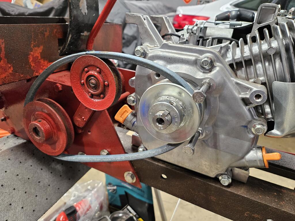

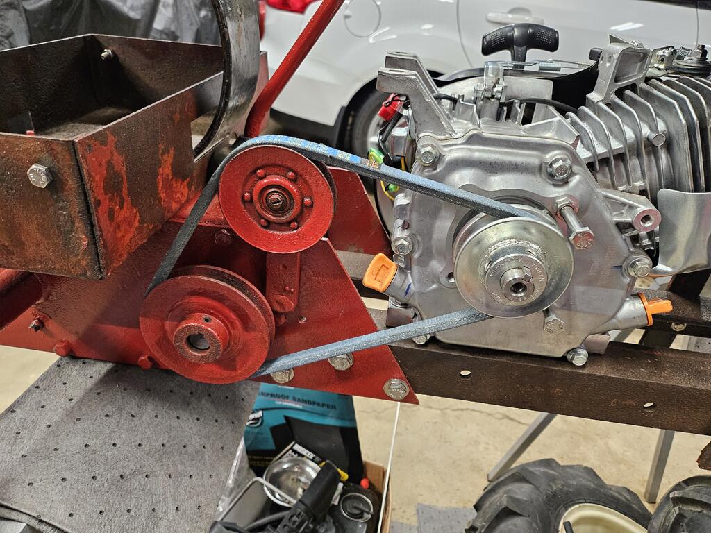

ML3 2,485 #20726 Posted January 28, 2024 Made some headway on rat rod Suburban. Got it running great. It's definitely loud & obnoxious! Need to do more work on drive belt/clutch. It's still turning transmission when clutch is depressed.....so back to drawing board on that. I have pics attached. 20240128_150442.mp4 3 3 Share this post Link to post Share on other sites

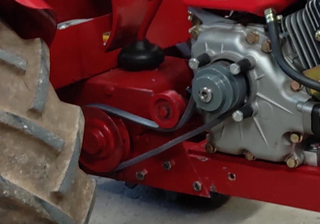

ML3 2,485 #20729 Posted January 29, 2024 (edited) 9 hours ago, 953 nut said: Try it with the belt guard on. There is no belt guard. That's what the bolts atttaced to engine at drive pulley were intended to do. I did same thing on my diesel RJ & it worked. May have to make some sort of belt guard or tabs to let belt slip more? Or may try to change clutch pulley to type that presses on outside of belt like it does on my RJ diesel? (see pic) It works flawlessly Edited January 29, 2024 by ML3 1 Share this post Link to post Share on other sites
953 nut 68,746 #20730 Posted January 29, 2024 When you depress the clutch on a Suburban (or any newer ) the built guard catches the slack on the belt stopping it. Try mounting a piece of angel iron under the bottom belt section to do that. 2 Share this post Link to post Share on other sites

Ed Kennell 47,097 #20732 Posted January 29, 2024 4 hours ago, ML3 said: May have to make some sort of belt guard or tabs to let belt slip more? One positive way to stop a belt. 7 1 Share this post Link to post Share on other sites
ML3 2,485 #20733 Posted January 29, 2024 56 minutes ago, Ed Kennell said: One positive way to stop a belt. Thanks! I'll look into something like that. Hopefully that will work. Belt barely grabs with clutch depressed so it's close. Hopefully my clutch pulley is at a good enough angle? See pics.... 1 Share this post Link to post Share on other sites

953 nut 68,746 #20735 Posted January 29, 2024 9 hours ago, ML3 said: Belt barely grabs with clutch depressed so it's close. The output shaft of your engine turns counterclockwise and PULLS the belt so if the slack at the bottom is supported by a belt guard it will stop the belt from moving. 1 1 Share this post Link to post Share on other sites
JoeM 10,184 #20736 Posted January 30, 2024 13 hours ago, 953 nut said: bottom is supported by a belt guard it will stop the belt from moving. Or at least a wire support that allows slack to be thrown off the drive pulley. Share this post Link to post Share on other sites

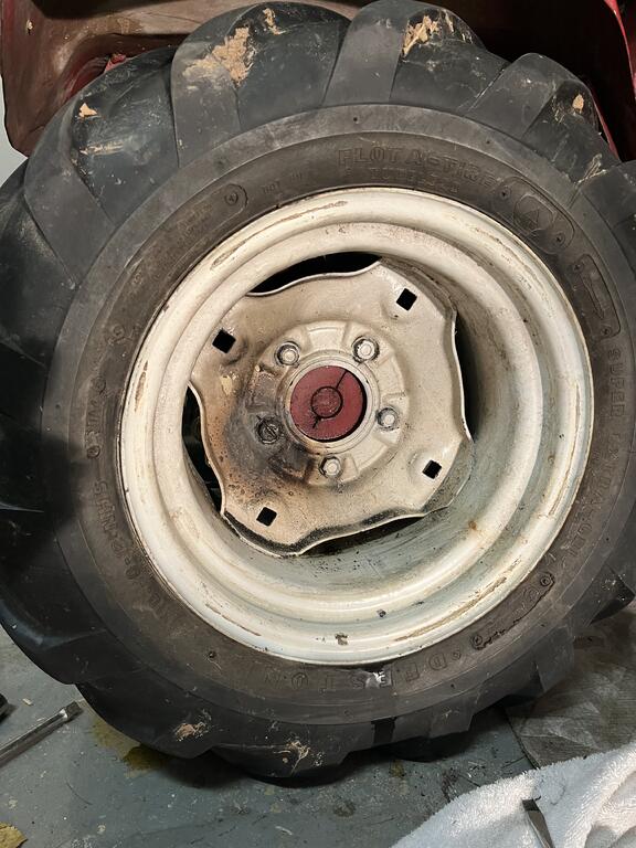

BrianKoch 370 #20738 Posted January 31, 2024 (edited) Gentlemen, Today I planned on changing the transmission oil on the ‘69, but came across a seized lug bolt. After many rounds of heat and penetrating oil, I still ended up stripping the head pretty good and no progress to show for it. After that, I cut a notch to try using a big flat head screwdriver. No dice. Think now I’m going to invest in a bolt extractor set. Any recommendations? Edited January 31, 2024 by BrianKoch 1 Share this post Link to post Share on other sites
ebinmaine 80,449 #20739 Posted January 31, 2024 34 minutes ago, BrianKoch said: Gentlemen, Today I planned on changing the transmission oil on the ‘69, but came across a seized lug bolt. After many rounds of heat and penetrating oil, I still ended up stripping the head pretty good and no progress to show for it. After that, I cut a notch to try using a big flat head screwdriver. No dice. Think now I’m going to invest in a bolt extractor set. Any recommendations? Is that a stock Wheelhorse hub? Looks like there's a locking mechanism in it maybe? You might be able to replace the part or get a good used hub for less money and/or irritation value than trying to save whatever that hub is. Share this post Link to post Share on other sites

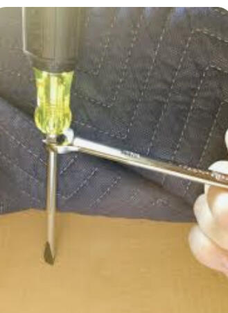

PWL216 1,278 #20740 Posted January 31, 2024 (edited) Might be silly question, but have you tried a wrench on a square shaft screwdriver for leverage? This is the main reason I prefer square shaft screwdrivers. Like the below pic but with a square shaft screwdriver.,, Edited January 31, 2024 by PWL216 1 Share this post Link to post Share on other sites
Evguy 567 #20741 Posted February 1, 2024 53 minutes ago, BrianKoch said: Today I planned on changing the transmission oil on the ‘69, but came across a seized lug bolt. After many rounds of heat and penetrating oil, I still ended up stripping the head pretty good and no progress to show for it. After that, I cut a notch to try using a big flat head screwdriver. No dice. Think now I’m going to invest in a bolt extractor set. Any recommendations? I’ve had luck using grinder to one faceof the nut, then split the nut with a chisel 2 Share this post Link to post Share on other sites
953 nut 68,746 #20742 Posted February 1, 2024 59 minutes ago, BrianKoch said: Any recommendations? Could that be a long bolt with a nut on the back? Try going in a clockwise direction to see if you can make it move a bit then go counterclockwise. 3 Share this post Link to post Share on other sites
8ntruck 9,241 #20743 Posted February 1, 2024 I'vs got some sockets designed to grab hex head nuts/bolts that have the corners rounded off. Have not had an occasion to use them yet, though. 1 Share this post Link to post Share on other sites
Ed Kennell 47,097 #20744 Posted February 1, 2024 (edited) I think you have a welder Brian. Use a welders magnet to hold a large nut ( 3/4 or 1") over the bolt. Weld them together and turn it out. Just a reminder Brian. If you weld, make sure you have a good ground as close as possible to the weld area. Edited February 1, 2024 by Ed Kennell 3 Share this post Link to post Share on other sites

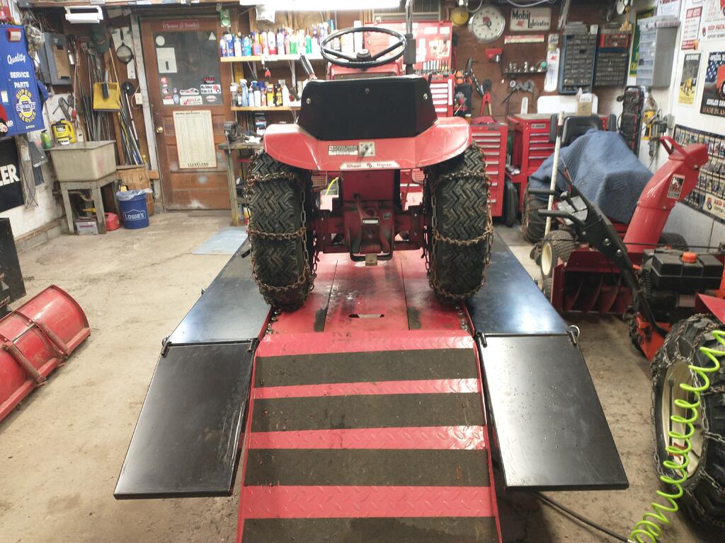

squonk 47,983 #20747 Posted February 1, 2024 Picked up a modded Horror Fright motorcycle lift. Has air over hydraulic lift cylinder and Handy Lift side extensions and ramps. Also HD locking casters on one end 4 6 Share this post Link to post Share on other sites
