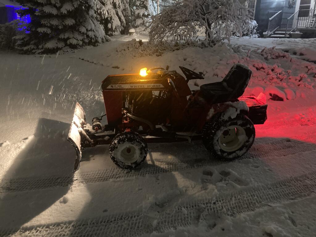

TonyToro Jr. 2,534 #20611 Posted January 19, 2024 Got to get my C-145 out with the plow and haul horse poop!! Then took it out after with the lights on for a little ride. I had the plow on my 310-8 but that is out of commission for now and I don’t really use my blower often so I thought I would treat myself with a hydro and hydraulic lift for a plow tractor! IMG_1771.MOV IMG_1770.MOV 1 3 Share this post Link to post Share on other sites

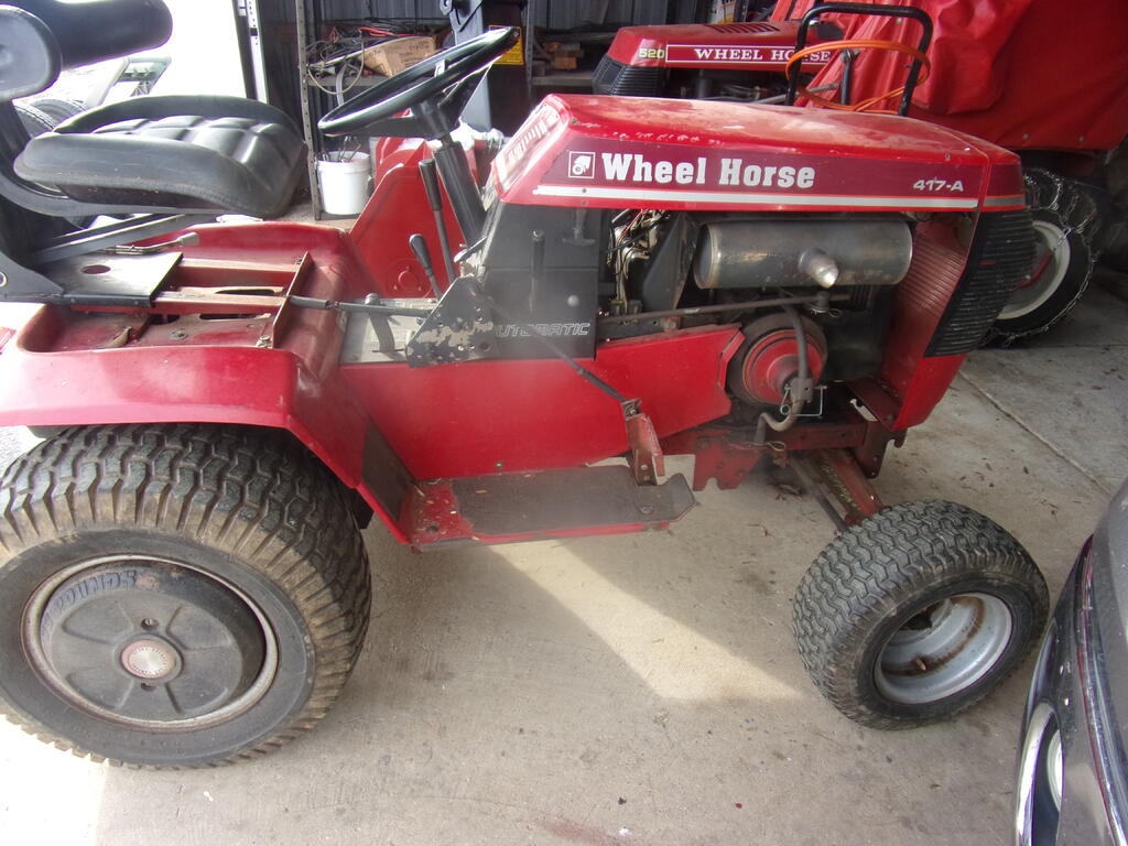

Ed Kennell 47,096 #20612 Posted January 19, 2024 I had to make room for a couple new horses, so I moved this one on down the road today. I bought her at auction in 2017 with a 48" SD and used her for mowing for 6 years. Her new job will be pushing cars in and out of an auto repair business.....nice cushy retirement duty. 5 5 Share this post Link to post Share on other sites

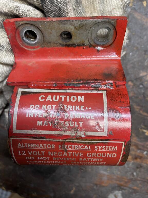

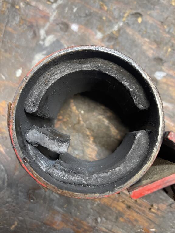

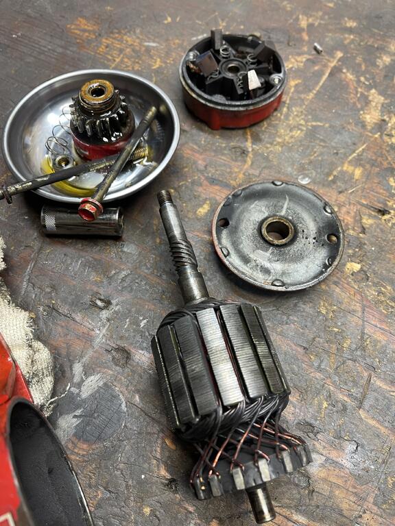

Wheelhorse#1 1,976 #20613 Posted January 19, 2024 (edited) Found the culprit, starter crapped out on the B80 all the sudden. Have no idea how long it was cracked …..guess someone didn’t read the warning sticker But beat on it instead 😆 Good news looks like one peace only.Should be able to epoxy back in and clean up ! Edited January 19, 2024 by Wheelhorse#1 8 2 Share this post Link to post Share on other sites

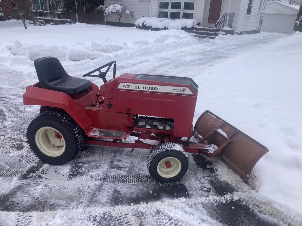

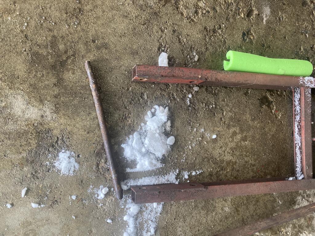

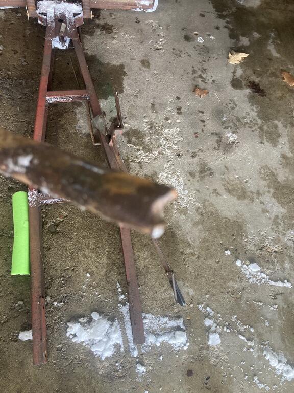

SylvanLakeWH 32,262 #20618 Posted January 19, 2024 (edited) Ugh... Plowing with the C-105 and all of a sudden the blade starts swinging free... Rear 3/4" cross pin sheared off... Old blade and obvious PO repair finally gave up to rust / stress... On the hunt for some hardened 3/4" and a couple shaft collars... All not lost. E-141 finished up the 3 drives i do quietly and efficiently...! Edited January 19, 2024 by SylvanLakeWH 8 5 Share this post Link to post Share on other sites

Lee1977 7,750 #20621 Posted January 19, 2024 29 minutes ago, SylvanLakeWH said: Ugh... Plowing with the C-105 and all of a sudden the blade starts swinging free... Rear 3/4" cross pin sheared off... Old blade and obvious PO repair finally gave up to rust / stress... On the hunt for some hardened 3/4" and a couple shaft collars... All not list. E-141 finished up the 3 drives i do quietly and efficiently...! You want cold rolled steel 3/4" round. Hot rolled the 3/4"collars won't go on. . 1 1 Share this post Link to post Share on other sites
SylvanLakeWH 32,262 #20622 Posted January 19, 2024 54 minutes ago, Lee1977 said: You want cold rolled steel 3/4" round. Hot rolled the 3/4"collars won't go on. . I'm having tough time finding it local... Would 3/4" threaded work in a pinch? Just use washers and nylon lock nuts? Probably need to order cold rolled online... 1 hour ago, Tonytoro416 said: That has to be something to see there Snow being pushed no noise being made It is quite nice...! Very quiet. 1 Share this post Link to post Share on other sites
ebinmaine 80,449 #20623 Posted January 19, 2024 1 minute ago, SylvanLakeWH said: I'm having tough time finding it local... Would 3/4" threaded work in a pinch? Just use washers and nylon lock nuts? Probably need to order cold rolled online... It is quite nice...! Very quiet. 3/4 threaded Rod would certainly get you going for a bit while you are waiting for the online order to come in. Depending on how the threads are put on, you may have to grind the ends to get it through the hole in the plow frame. Orange big box maybe an option. Local hardware supply. McMaster Car I'm sure would have something. 1 1 Share this post Link to post Share on other sites
D_Mac 9,339 #20624 Posted January 19, 2024 Been snowing all day here. Just got home from work and got some seat time in plowing the driveway. 875 did not even work up a sweat pushing the white stuff around. We got about 6 inches. I get to do it again tomorrow !!! 10 4 Share this post Link to post Share on other sites
SylvanLakeWH 32,262 #20625 Posted January 20, 2024 Back up and running with 3/4" threaded rod... No cold rolled around local... Gonna see how this holds up. For $15 it's doing the trick... 4 1 Share this post Link to post Share on other sites
