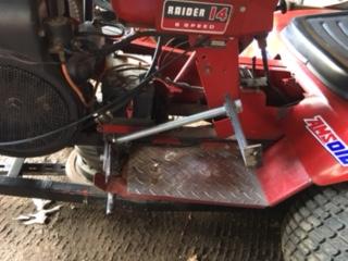

TonyToro 1,190 #2031 Posted March 26, 2019 9 hours ago, peter lena said: tonytoro , i was not even thinking about your son trying to use the pedal, my goof. probably a combo of a SEAT BOLSTER to get him closer ,along with a pedal block extension for leg fit. i just got the rod extension i need to INCREASE MY CLUTCH PEDAL AREA . just thinking about that , the newer clutch pedals , sweep foward giving you added inches of reach that could help your son.. just the opposet of what i am doing . pete Lol I figured you were thinking longer for more comfort. He has little legs. Lol Here is what we came up with. We have some rounding to do so no sharp edges and add diamond plate but it works. 3 Share this post Link to post Share on other sites

TonyToro 1,190 #2037 Posted March 27, 2019 On 3/26/2019 at 6:23 PM, pullstart said: Check this build for my 8 year old, the pedal is all from Wheelhorse parts. Great idea! I just wasn’t thinking out of the box. Thank you! 1 Share this post Link to post Share on other sites

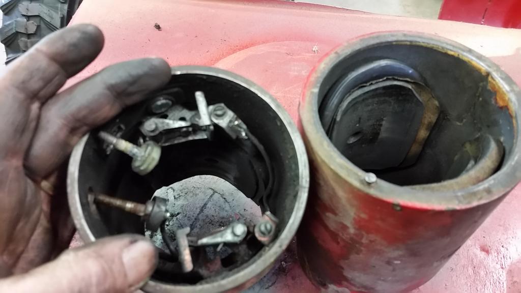

WHX?? 58,302 #2038 Posted March 27, 2019 (edited) Tied into a pair of jugs today...starter generator jugs that is! These are actually enjoyable to rebuild once one gets past the grime. Getting the field coil screws out is the worse. Figured gonna get dirty might as well do one for the shelf. Got two more to do tho. This is what I get for having a dozen tractors with these on them!p Edited March 28, 2019 by WHX22 Pic 4 3 Share this post Link to post Share on other sites
oliver2-44 11,782 #2039 Posted March 28, 2019 @WHX22 Tak us along on your starter/gen rebuild. I have one for my 953 project to rebuild. Thanks 1 Share this post Link to post Share on other sites
WHX?? 58,302 #2040 Posted March 28, 2019 (edited) Ya know Oliie I just thought of that this morning, I should do an instructional. May throw one back together and have the missus take disassembly pictures. Your hands get pretty grimy and phone cams and parts washers do not mix! Here's a primer He's got a lot of good videos for newbies and veterans alike. He does cheat abit in the fact I usually remove the field coils and blast and clean the parts better. He also doesn't do any armature work which I always do. This just involves undercutting the mica and polish the poles up. Not very hard and adds a whopping half hour to the job. He is also either smart or a sally to get his hands dirty... he wears gloves! Edited March 28, 2019 by WHX22 speeling & gramma 5 Share this post Link to post Share on other sites
squonk 48,215 #2041 Posted March 28, 2019 19 hours ago, WHX22 said: Tied into a pair of jugs today...starter generator jugs that is! These are actually enjoyable to rebuild once one gets past the grime. Getting the field coil screws out is the worse. Figured gonna get dirty might as well do one for the shelf. Got two more to do tho. This is what I get for having a dozen tractors with these on them!p Hand impact driver with the slotted head. With your track record better get some gloves on or a box of band-aids near by. 1 5 Share this post Link to post Share on other sites

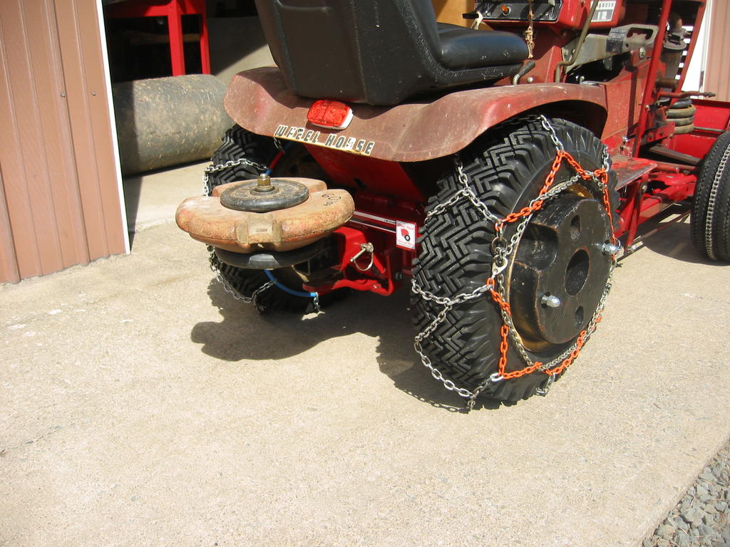

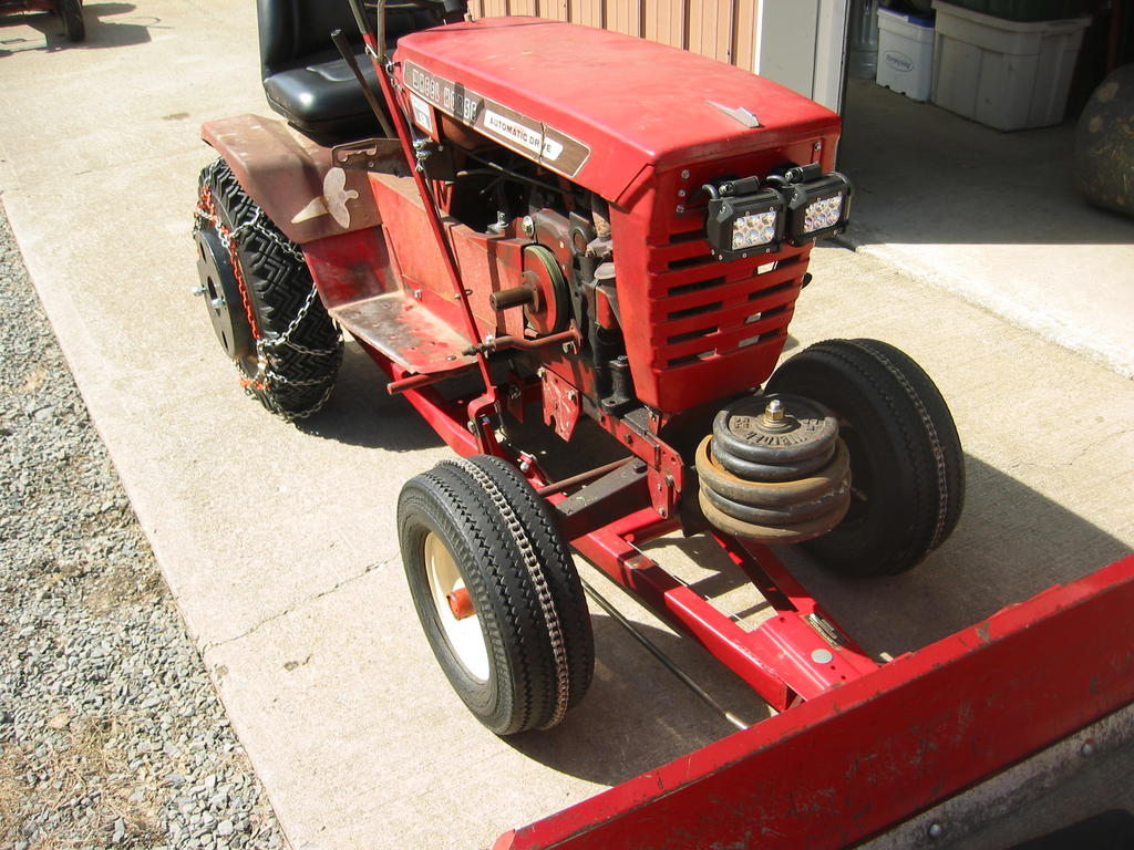

pfrederi 21,218 #2045 Posted March 28, 2019 Summerizing the snow horse. Finished up the hydro work. Works great no drips...yet. Held the blade up for over an hour. Added weight. Now carries 250 lbs. Didn't want too much on the rear hitch so i got one of Lowells...very nice!!! Somewhere I have another 60 lb tractor front wheel weight which I may add to the rear hitch. 3 4 Share this post Link to post Share on other sites
squonk 48,215 #2046 Posted March 28, 2019 Thats some PSI on the ground there Paul! Share this post Link to post Share on other sites

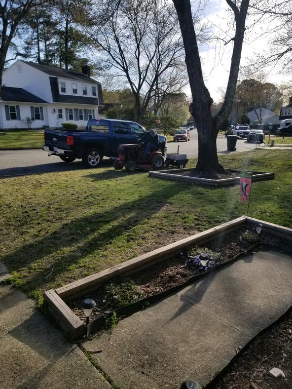

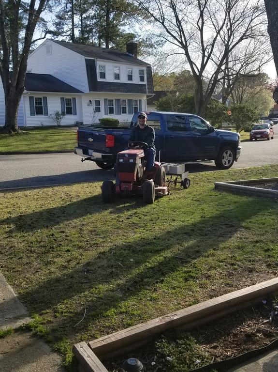

MIGHTYMO 50 #2047 Posted March 28, 2019 Airated the front lawn Share this post Link to post Share on other sites
WHX?? 58,302 #2048 Posted March 29, 2019 You sure Mo? We ain't seein any ??? Share this post Link to post Share on other sites
WHX?? 58,302 #2050 Posted March 29, 2019 Much better .... anyone notice his grin in the 2nd pic?!?! 3 Share this post Link to post Share on other sites
