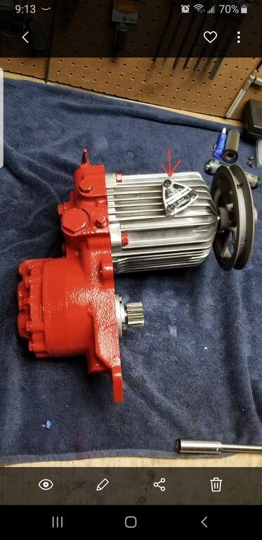

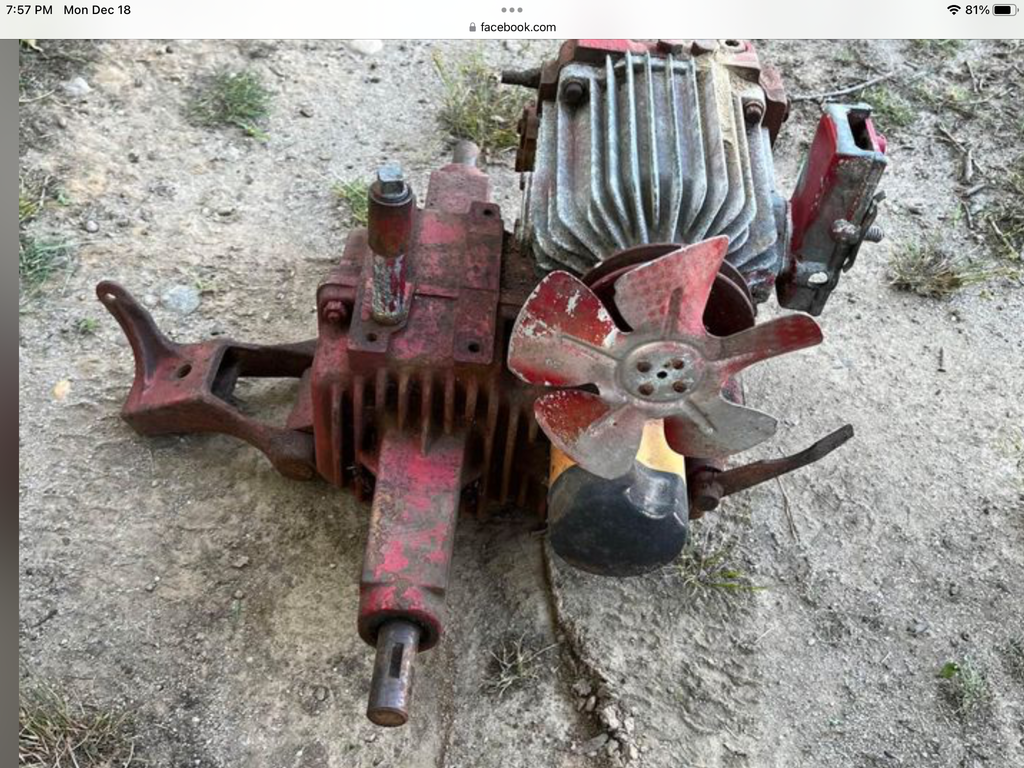

Colby G 248 #20426 Posted December 19, 2023 (edited) Can somebody tell me what tractor this transmission came out of? I'm trying to order a pulley for it and I can't figure out what transmission it is. I did a swap from a charger 12 thinking it was also a charger 12 (which it was not) and now I cannot figure out what transmission it is... Edited December 19, 2023 by Colby G Share this post Link to post Share on other sites
c-series don 12,600 #20427 Posted December 19, 2023 I believe that you have a Sunstrand transmission, however I don’t know the exact model. Someone here does. You need the pulley with the slots in it that makes it the cooling fan also. 1 Share this post Link to post Share on other sites

c-series don 12,600 #20430 Posted December 19, 2023 (edited) Never mind my last post, it looks like you might need the pulley that you can bolt a fan to. Okay I’ll shut up now. For a minute anyway!😂 Edited December 19, 2023 by c-series don Share this post Link to post Share on other sites
Colby G 248 #20431 Posted December 19, 2023 (edited) 7 minutes ago, c-series don said: Never mind my last post, it looks like you might need the pulley that you can bolt a fan to. Okay I’ll shut up now. For a minute anyway!😂 So what would the fan be for? Extra cooling? And could you tell me what tractor mine came off of originally? Edited December 19, 2023 by Colby G Share this post Link to post Share on other sites
WHX?? 58,310 #20432 Posted December 19, 2023 I don't think you are wrong Don but I might be full of $hi! too. Looks to be late 60s on up that used the fan cast with the pully. Either that or it's gonna be pre late 68 before they went to 5/8 belt on the Raider. Then it would have the aluminum fan. 2 Share this post Link to post Share on other sites
WHX?? 58,310 #20433 Posted December 19, 2023 (edited) Nope that pic says it all ...came off a 65 to late 68 tractor. Most likely a 1077 1277 or such. Edited December 19, 2023 by WHX?? Model screw up 1 Share this post Link to post Share on other sites
Colby G 248 #20434 Posted December 19, 2023 6 minutes ago, WHX?? said: Nope that pic says it all ...came off a 65 to late 68 tractor. Most likely a 1077 1277 or such. So I need a pulley and a fan for a transmission from a 1077 1277? Share this post Link to post Share on other sites

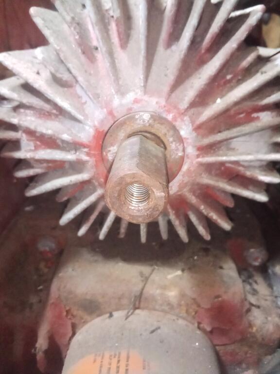

WHX?? 58,310 #20435 Posted December 19, 2023 40 minutes ago, Colby G said: So I need a pulley and a fan for a transmission from a 1077 1277? Almost think so. Is that input shaft double D? Kinda looks like it. Will take a look at my parts. The aluminum fan, if needed might be hen's teeth tho. Another question is what size drive belt are you going you going to run? 4L or 5L? 1 Share this post Link to post Share on other sites
Colby G 248 #20436 Posted December 19, 2023 (edited) 26 minutes ago, WHX?? said: Almost think so. Is that input shaft double D? Kinda looks like it. Will take a look at my parts. The aluminum fan, if needed might be hen's teeth tho. Another question is what size drive belt are you going you going to run? 4L or 5L? I believe it's double d, I'm kinda new to this wheel horse stuff, so I'm not sure. It's flat on two sides and round on two sides. And for my belt size I'm thinking 1/2 width and not sure on length or height yet. Gotta mount motor and get pulleys. I'm going to put a predator 420cc on it since I bought it with no motor. and don't know what I need for pulleys yet. Edited December 19, 2023 by Colby G 1 Share this post Link to post Share on other sites

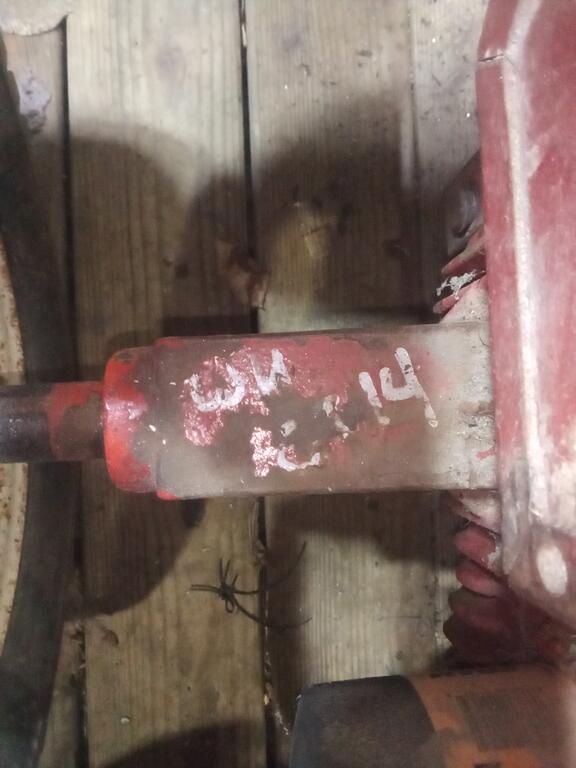

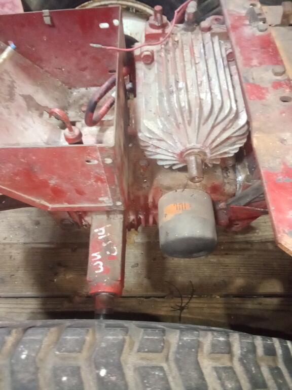

Thor27 892 #20437 Posted December 19, 2023 Just a guess here, but that axle looks wide....and looks like witness marks from longer hubs... And it appears to have gt-14 written in paint pen. Does it have the big keyways? 1 1 Share this post Link to post Share on other sites
oliver2-44 11,790 #20438 Posted December 19, 2023 1 hour ago, Colby G said: I believe it's double d, I'm kinda new to this wheel horse stuff, so I'm not sure. It's flat on two sides and round on two sides. And for my belt size I'm thinking 1/2 width and not sure on length or height yet. Gotta mount motor and get pulleys. I'm going to put a predator 420cc on it since I bought it with no motor. and don't know what I need for pulleys yet. Most WH likely hydro pulleys are 5/8 width Share this post Link to post Share on other sites
Colby G 248 #20439 Posted December 19, 2023 9 minutes ago, Thor27 said: Just a guess here, but that axle looks wide....and looks like witness marks from longer hubs... And it appears to have gt-14 written in paint pen. Does it have the big keyways? Coming off the pump shaft, it's a double d with a hole coming off the end with threads Share this post Link to post Share on other sites
Thor27 892 #20440 Posted December 19, 2023 3 hours ago, Colby G said: Can somebody tell me what tractor this transmission came out of? I'm trying to order a pulley for it and I can't figure out what transmission it is. I did a swap from a charger 12 thinking it was also a charger 12 (which it was not) and now I cannot figure out what transmission it is... Sorry Colby, I was referring to what it possibly came out of as GT-14? I am not at all versed in sunstrand and have never seen a double D input. I should have read the rest of the way down the page as C-series Don, and WHX? are both much brighter than I. 1 Share this post Link to post Share on other sites

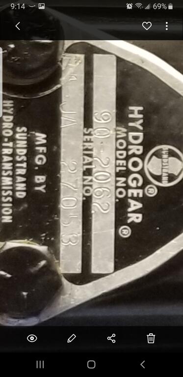

Ed Kennell 47,729 #20441 Posted December 19, 2023 The double d shaft and the tee handle bypass tow valve looks like Sundstrand #90-2062. 3 Share this post Link to post Share on other sites
WHX?? 58,310 #20442 Posted December 19, 2023 9 hours ago, oliver2-44 said: Most WH likely hydro pulleys are 5/8 width True except '67 and earlier. Might not find a pully in 4L belt size to fit if indeed it is a GT 14 rear end. That motor you should be running a 5L belt anyway. Share this post Link to post Share on other sites
pfrederi 21,268 #20443 Posted December 19, 2023 I looked at parts listings for the old Wheelamatics (875 1075 1076) and some GT14 listings. All of diagrams showed a round shaft with keyway. I know diagrams are not always accurate but they all showed and listed a part number for a woodruff key. Would not be using one of those on flat side shaft... Is there a metal Sunstrand Tag attached somewhere on the pump??? Share this post Link to post Share on other sites

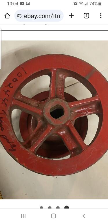

gt14rider 1,283 #20444 Posted December 19, 2023 (edited) This is a GT14. The tag would be between tool box and pump. 69, 70 used 8144, then I think that changed to using the double pulley, the double pulley could have had the double D drive. The early pulley shaft had failed and changed to the 1 piece pulley . If someone has a 73 gt14 parts list there could be a p/n#. Edited December 19, 2023 by gt14rider Share this post Link to post Share on other sites
gt14rider 1,283 #20445 Posted December 19, 2023 There's one on ebay. 100244. 2 Share this post Link to post Share on other sites

Colby G 248 #20447 Posted December 19, 2023 6 hours ago, pfrederi said: I looked at parts listings for the old Wheelamatics (875 1075 1076) and some GT14 listings. All of diagrams showed a round shaft with keyway. I know diagrams are not always accurate but they all showed and listed a part number for a woodruff key. Would not be using one of those on flat side shaft... Is there a metal Sunstrand Tag attached somewhere on the pump??? I didn't see one Share this post Link to post Share on other sites
Colby G 248 #20448 Posted December 19, 2023 5 hours ago, gt14rider said: There's one on ebay. 100244. Are you sure thats the one I need? Looks right but I want to make sure, already bought one that wasn't the right size due to error. Share this post Link to post Share on other sites
