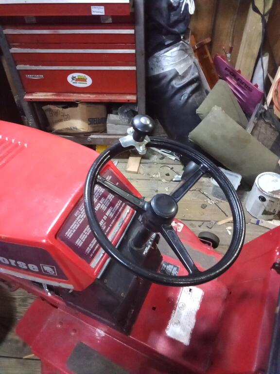

Colby G 248 #19976 Posted September 19, 2023 The 211-4 steered a bit hard, so I put a suicide knob on it and I think it looks really good! 4 Share this post Link to post Share on other sites

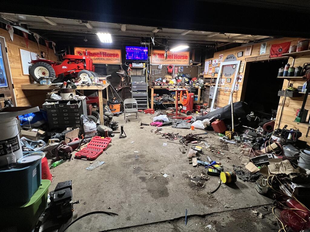

WHGuy413 2,859 #19979 Posted September 19, 2023 Knowing winter is going to sneak up on us sooner rather than later I spent a little time in the garage moving things around. Alex and I are going to make a push to get all the show tractors put away and the garage cleaned up this weekend. It would be nice to have a garage that’s organized chaos instead of just chaos that it’s in now. We both have a tractor project we want to work on in the near future. I’d like to get mine done before snow flies so I can use the 12 auto around the yard and then I will probably use it as my snow plow tractor or designate it as my fire wood hauler for the winter. For those who have garages and still work on stuff in the cold months what are you using for a heat source? 2 Share this post Link to post Share on other sites

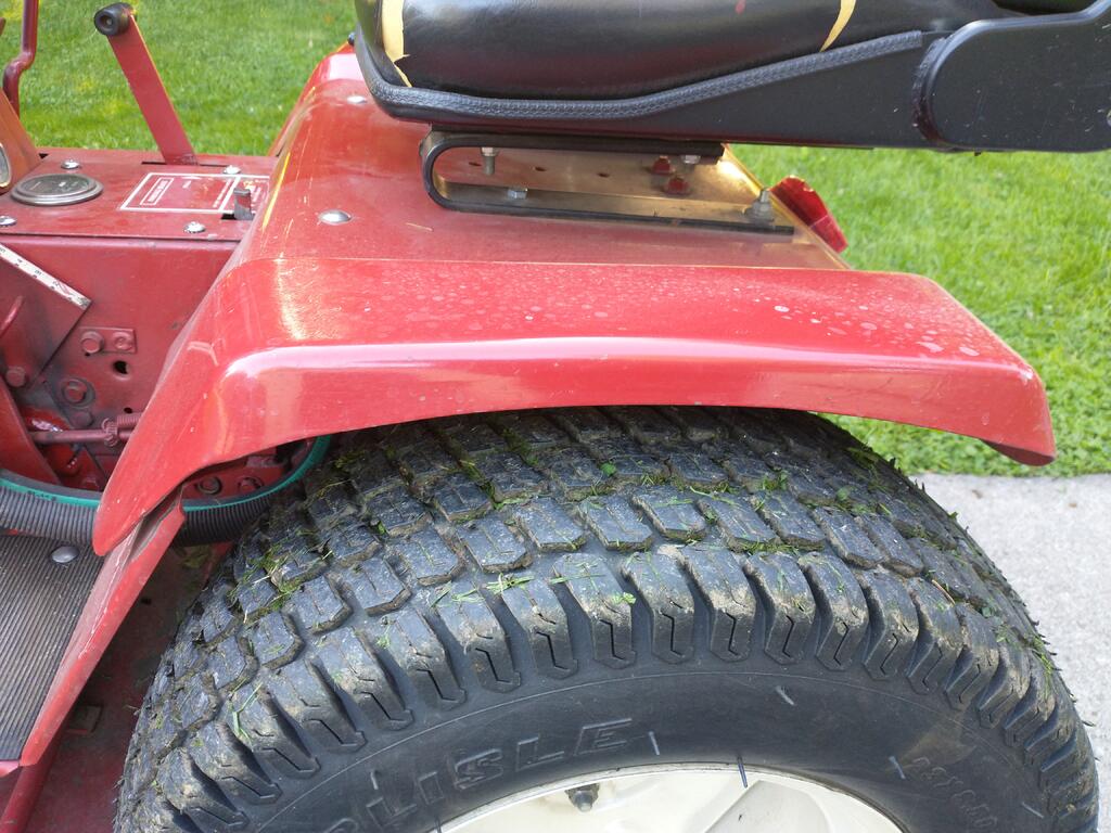

squonk 48,277 #19988 Posted September 19, 2023 My C160 has a seat raised on springs and my 250 L Bees make for a bit of a teeter totter ride. Add some of the normal cracks a 46 yr old fender pan you get some creaks and groans. Add a couple 3/16 thick strips to spread the load. Made a huge difference on the ride. 5 1 Share this post Link to post Share on other sites

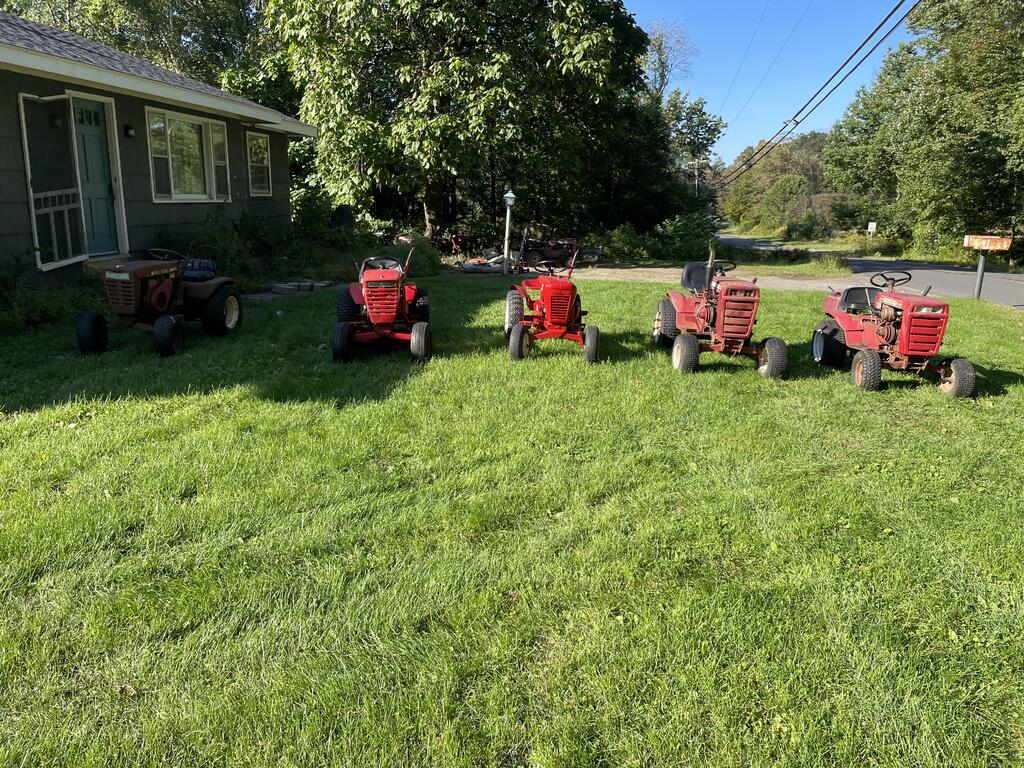

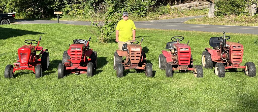

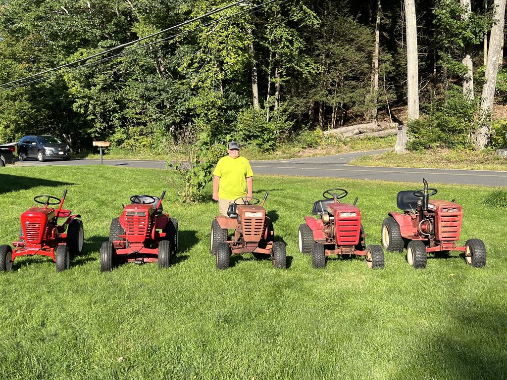

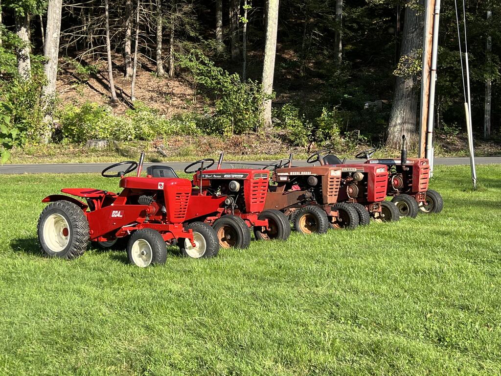

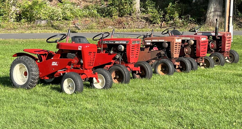

WheelHorse_Kid 359 #19989 Posted September 21, 2023 (edited) I got 5 of my tractors and took pictures of all of them before we put some of them away for the winter. Edited September 21, 2023 by WheelHorse_Kid 2 10 1 3 Share this post Link to post Share on other sites

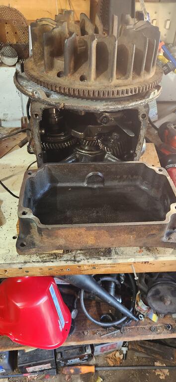

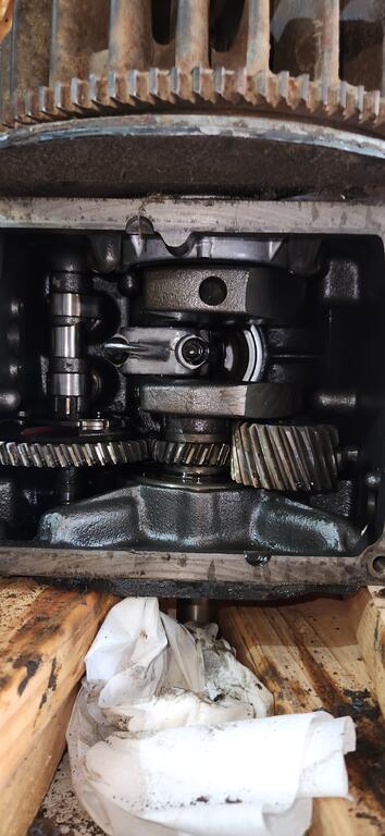

314-8 wheel horse 7 #19990 Posted September 22, 2023 Rebuilding kholer k321 short block and building adapter for long block oil pan. So it fits on 314-8. 6 1 Share this post Link to post Share on other sites
ebinmaine 81,032 #19991 Posted September 22, 2023 6 hours ago, 314-8 wheel horse said: Rebuilding kholer k321 short block and building adapter for long block oil pan. So it fits on 314-8. This is something you're creating? Machine shop ? Share this post Link to post Share on other sites

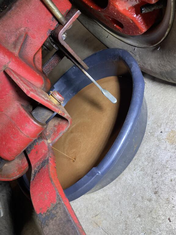

Sparky-(Admin) 26,619 #19997 Posted September 26, 2023 This afternoon my newly assembled “308” got a trans fluid swap. Nasty stuff came out (I’ve seen worse). This gear oil only has like 15-20 minutes of use! Luckily NAPA has this on sale for $5.99 8 2 Share this post Link to post Share on other sites

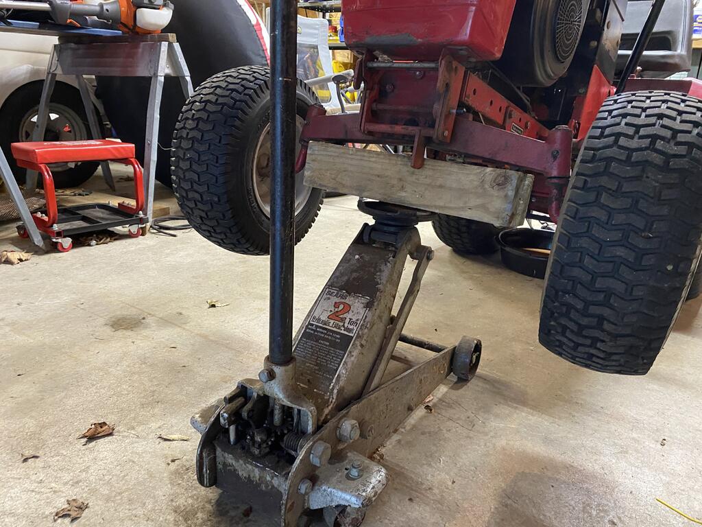

Handy Don 17,623 #19998 Posted September 26, 2023 Wheel chocks! (I don’t trust parking brakes and I want to be able to shift the gears while draining.) 1 Share this post Link to post Share on other sites
ebinmaine 81,032 #19999 Posted September 26, 2023 16 minutes ago, Handy Don said: Wheel chocks! (I don’t trust parking brakes and I want to be able to shift the gears while draining.) As long as that wooden block is secured to the tractor I'd prefer NOT to use wheel chocks. The large rubber tires will be able to roll as the front is raised easier than the steel wheels of the jack. 1 Share this post Link to post Share on other sites
Sparky-(Admin) 26,619 #20000 Posted September 26, 2023 19 minutes ago, Handy Don said: I want to be able to shift the gears while draining.) Shift gears while draining? Never heard about doing that before 1 Share this post Link to post Share on other sites
