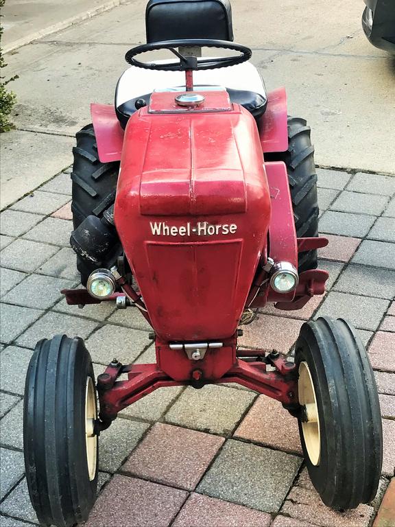

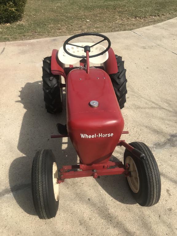

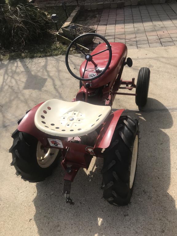

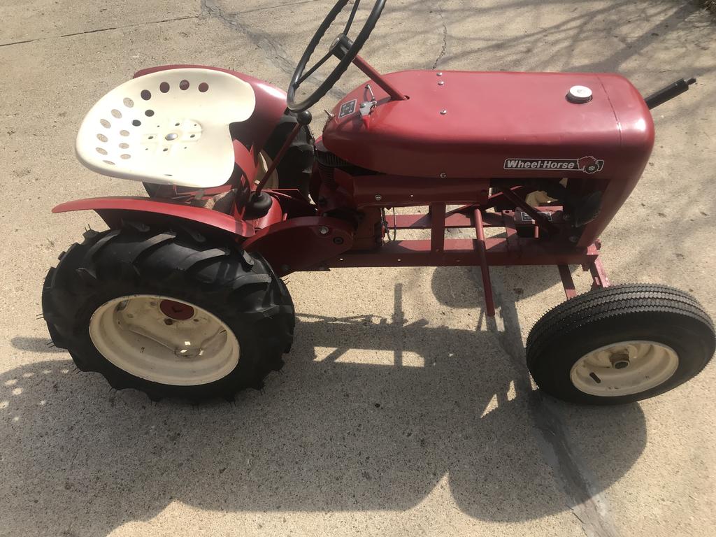

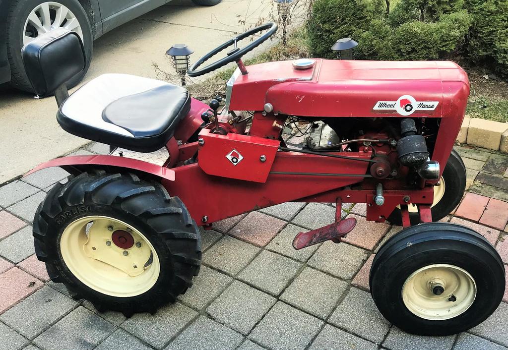

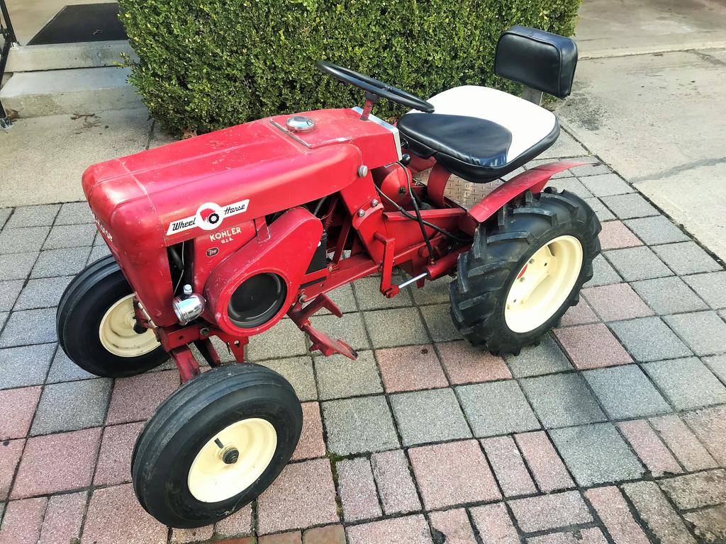

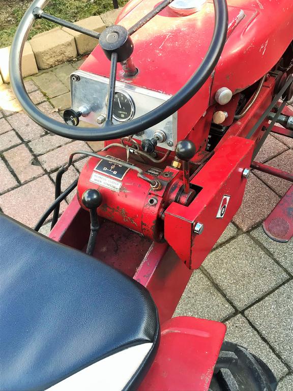

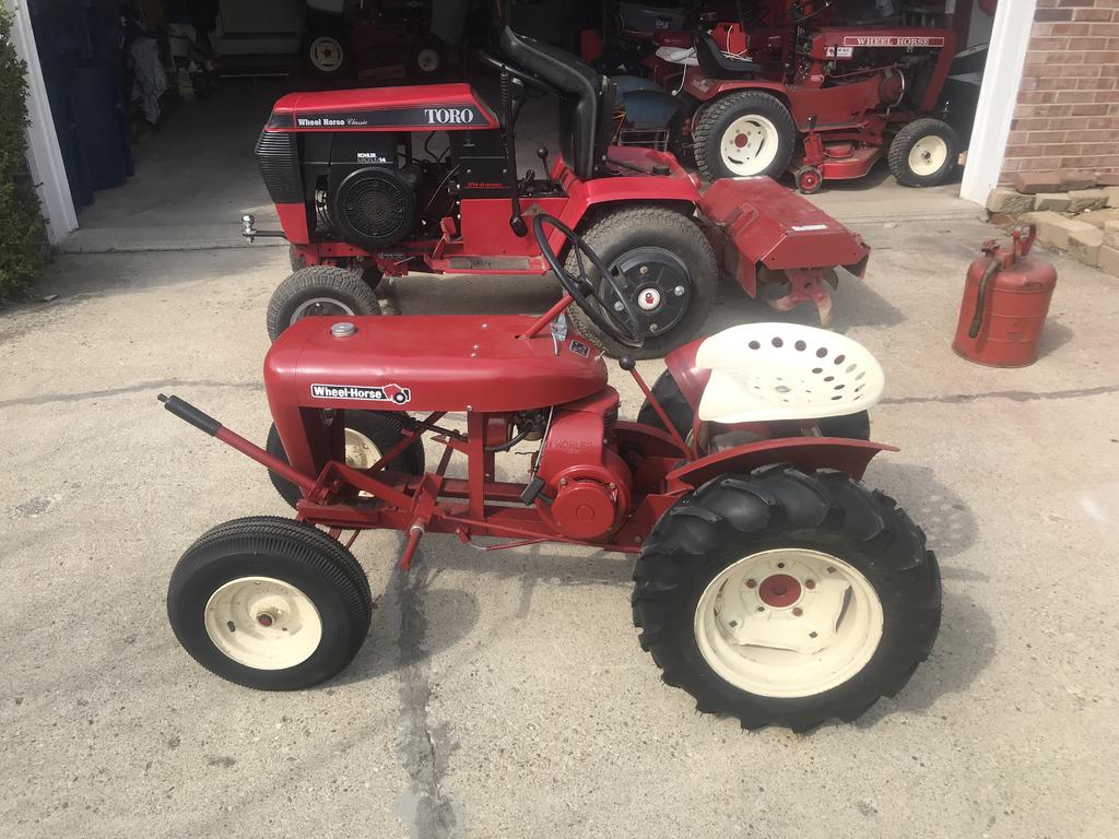

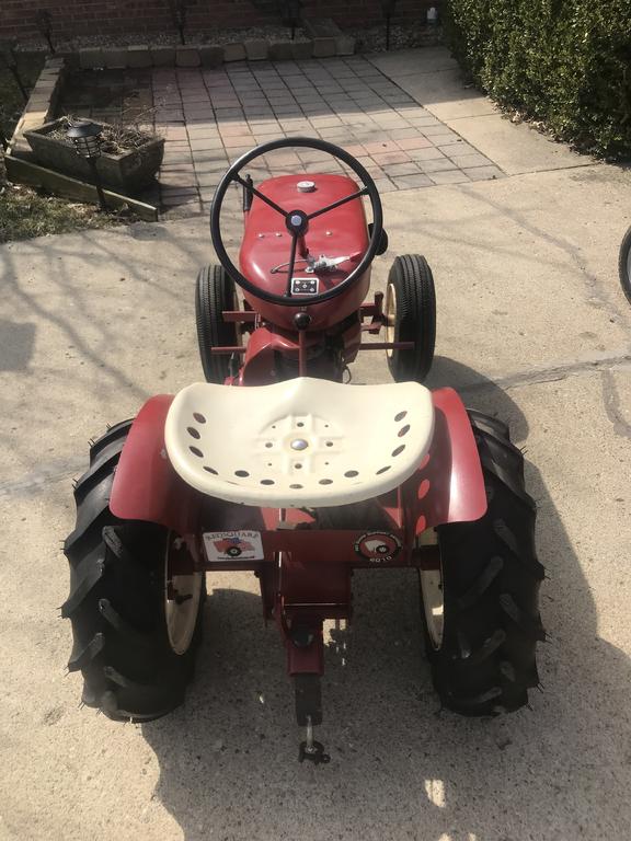

Lane Ranger 12,151 #1984 Posted March 18, 2019 I had my 1961 Wheel Horse 701 out yesterday and checked out the vitals to get ready for the coming garden planting season. The 701 still looks good and functions pretty good ! 2 6 Share this post Link to post Share on other sites

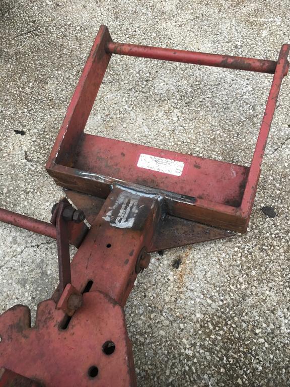

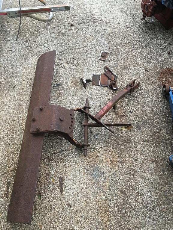

19richie66 17,937 #1986 Posted March 19, 2019 Cut all the monkey welds and scrap metal off my blades and returned them back to the way they were supposed to be. Ran out of daylight and mig wire. 9 1 Share this post Link to post Share on other sites

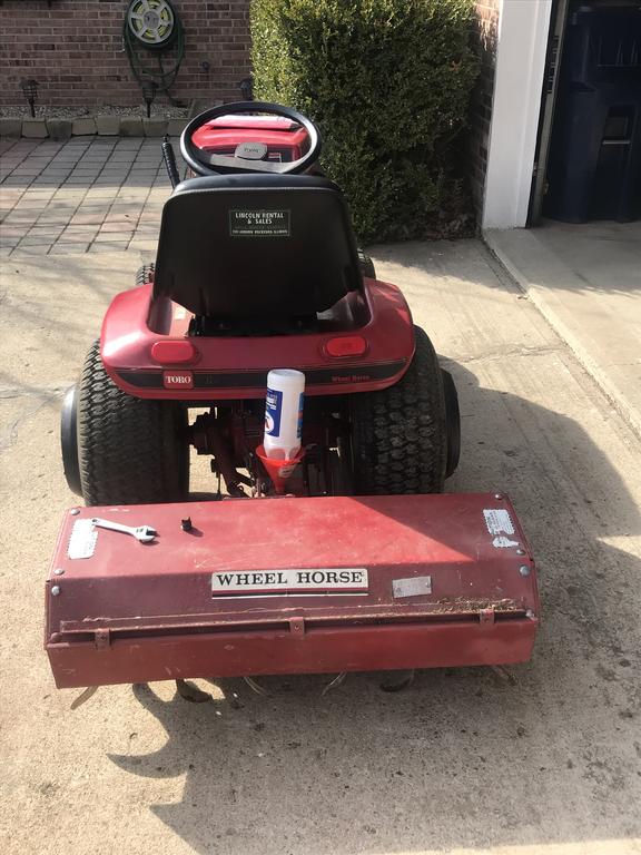

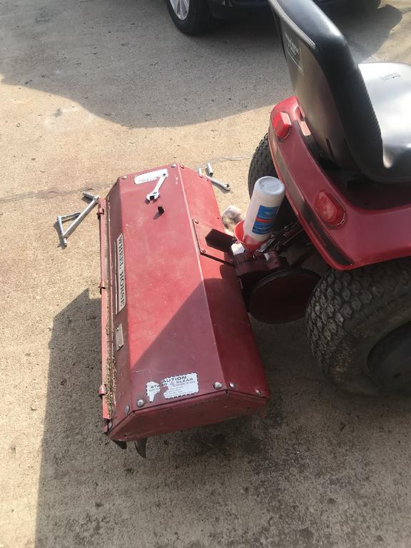

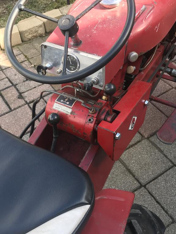

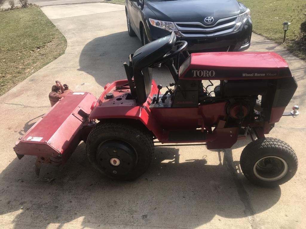

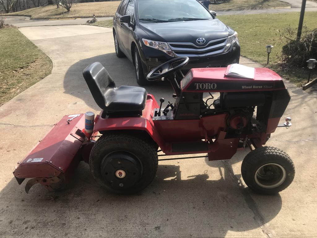

Lane Ranger 12,151 #1987 Posted March 19, 2019 (edited) Did some work on my 314-8 tiller tractor and one of my RJ’s this am. Ran the RJ and drove around to make sure ready for show season. Added some gear oil to the tiller gearcase. 972CBE30-64F5-4EAC-BA19-8BCF99FDC06F.MOV Edited March 19, 2019 by Lane Ranger 4 5 Share this post Link to post Share on other sites

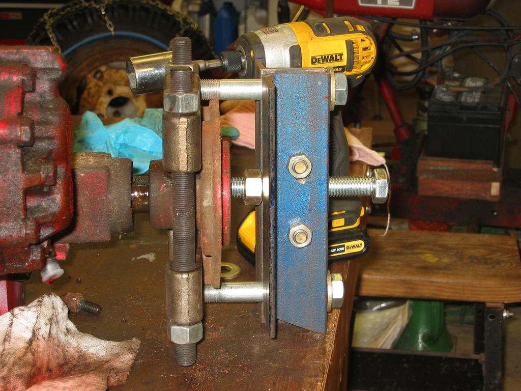

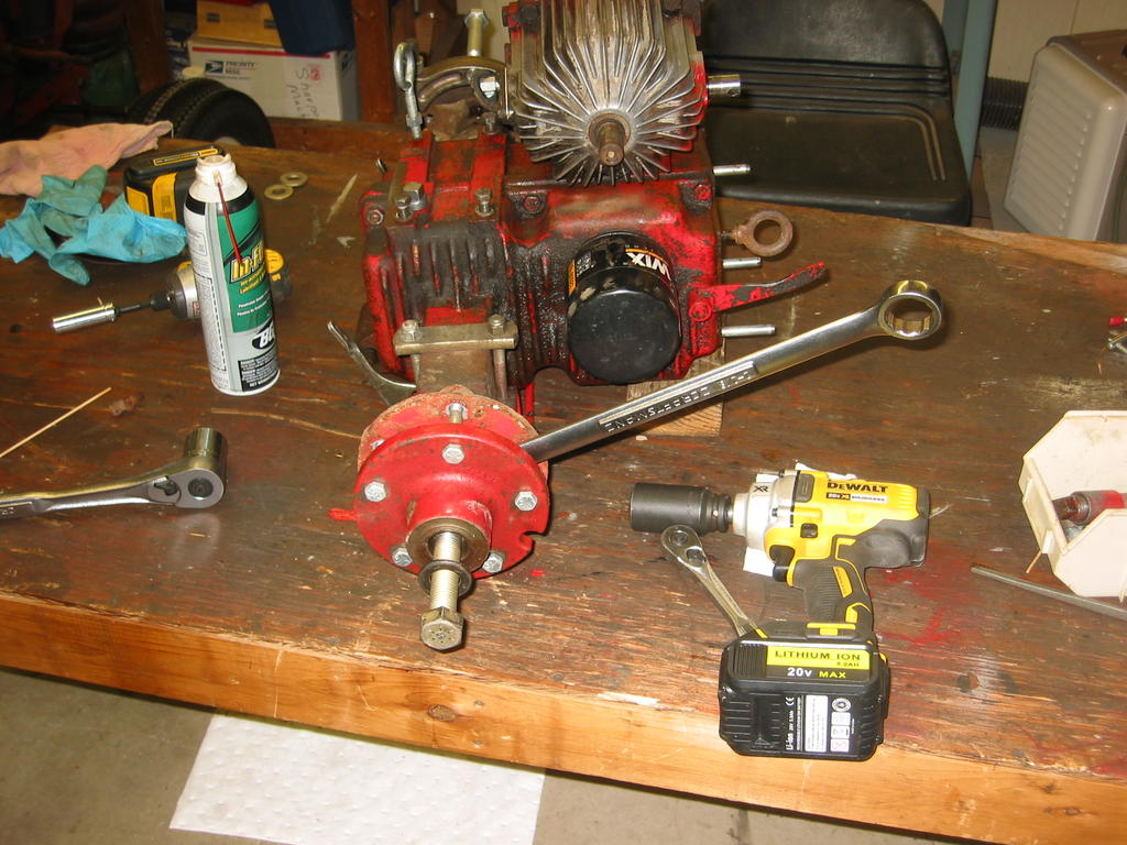

pfrederi 21,240 #1988 Posted March 19, 2019 Running down hydro leaks on my primary snow horse. New hose and new control vlave seals form Wheelhorseman. Now to the pump. Motion control leaking. One axle seal was seeping hardly enouogh to bother with but as long as she is off snow duty. Decided to pull the hubs...Absolutely one of my favorite passtimes...NOT!!! Do not believe the hubs have been disturbed since 1969... 8 Share this post Link to post Share on other sites
pfrederi 21,240 #1989 Posted March 19, 2019 So waiting for the magic juice to work set up another puller on the other hub..sliding off easily...go figure 2 4 Share this post Link to post Share on other sites

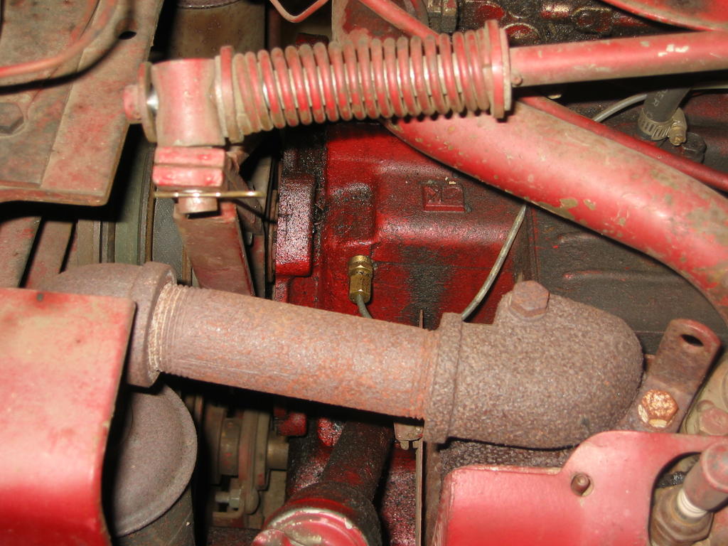

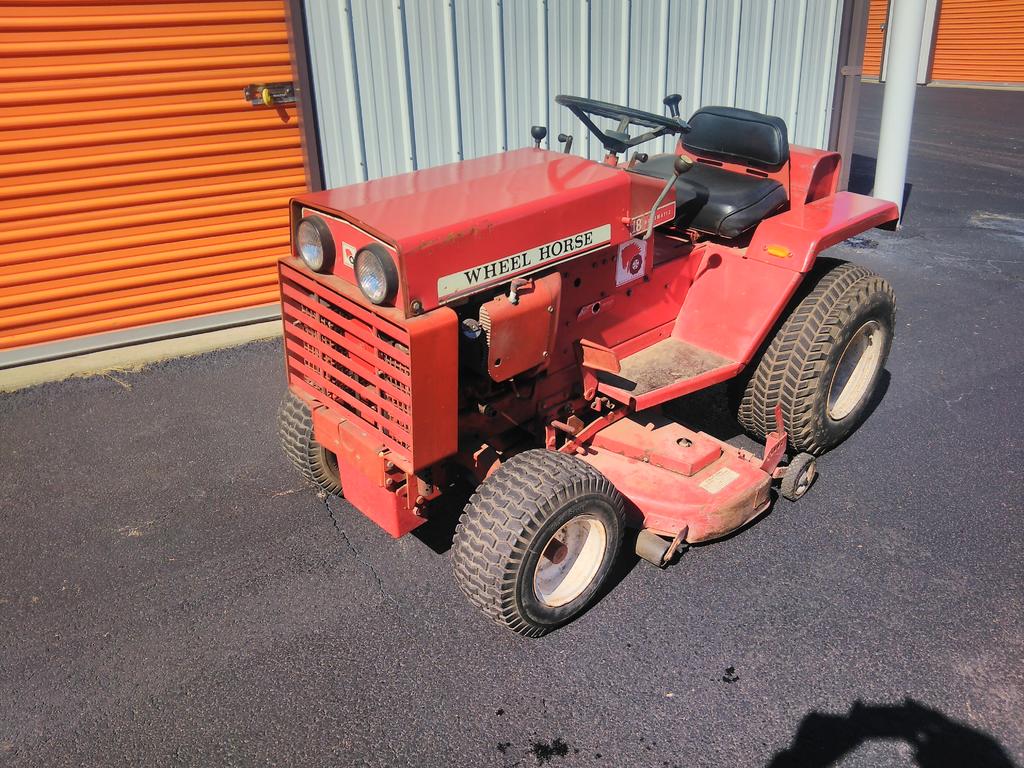

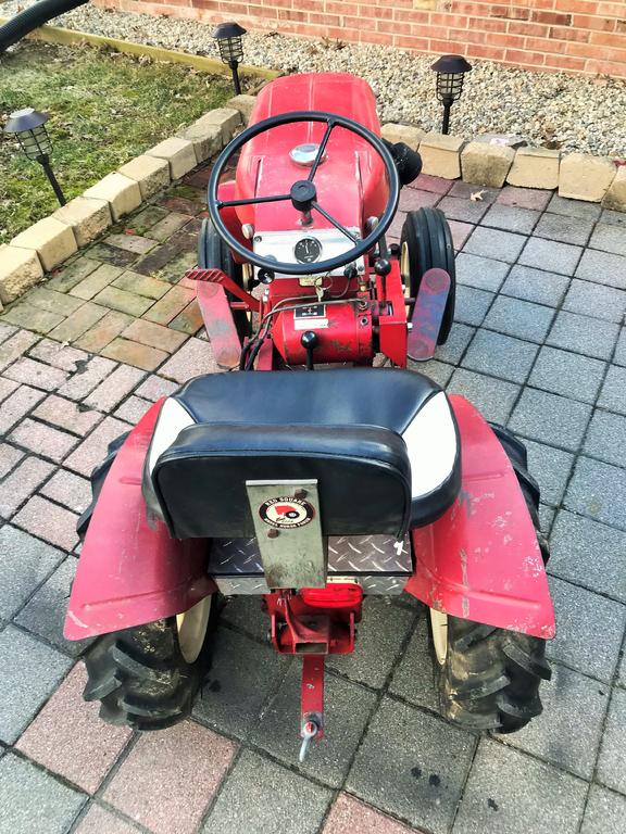

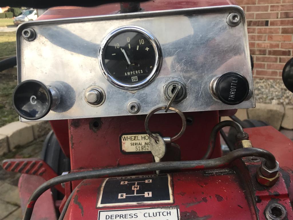

BPEisenhower 685 #1990 Posted March 19, 2019 Finally got the Auto 18 home. Have to track down no charge issue but don't seem too complicated...yet. I got an oil filter adapter to install and probably hunt for a tin with a hole instead of cutting one. Is it possible to add an oil pressure gauge someplace? If so, electric or not? And, can steering brakes be added at some point? Might have to get a new transmission temp gauge since it goes to 250 when ignition is off but zeros out when on but never reads a temp after running. Came with 3 point, new rear end, extra rear and internals, 4 hydro pumps, front axle, rims, fenders, 2 gas tanks, hubs, blah blah blah. The 4 ft tiller is no joke. After carrying it twice, I need to get 3 point re-attached and be done. Any advice on this beast is welcome! I have been reading a lot thanks to the free files but, we all know reality and print are different ends of the same snake! Thank you so much Horse Fans! 5 3 Share this post Link to post Share on other sites

Sarge 3,473 #1992 Posted March 20, 2019 Stewart Warner makes an electric gauge and short enough sending unit to fit into the pump port on that Sundstrand - I had the same problem with my '74 D-180/K482 Kohler equipped model. There are various 1/8"-27NPT ports in the engine that are live oil gallies - you can Google your engine and find the oil pump galley map. Just look for the small plugs with a recessed Allen socket hole. I need to add the oil gauge to mine this summer as well as ditch the semi-working ammeter. I'm also planning to add an oil filter, but want to use the stock adapter head along with a remote to put the filter in a better place if possible - not much room due to how the whole tractor is built. Sarge 1 Share this post Link to post Share on other sites
Sarge 3,473 #1993 Posted March 20, 2019 Oh - I forgot your other issue of charging. Most likely, the voltage regulator/rectifier has lost the case ground - very common on any version that is bolted to the frame. Without the case ground, the unit cannot read the battery voltage. It isn't any fun to get to the thing due to where its located - best way is from under the tractor. Lately, I've just been soldering a wire directly to the regulator case and tie that into a ground circuit for all the lamps/engine/battery grounding point in a central location - stops a lot of potential problems. Don't forget all the gauges/lamps in that dash panel - they all require case grounds to work correctly and may be the reason your temperature gauge doesn't work right. If the gauge can't make a circuit through the pump sending unit to ground - no worky. Sarge 2 Share this post Link to post Share on other sites
pfrederi 21,240 #1994 Posted March 20, 2019 19 hours ago, BPEisenhower said: Finally got the Auto 18 home. Have to track down no charge issue but don't seem too complicated...yet. I got an oil filter adapter to install and probably hunt for a tin with a hole instead of cutting one. Is it possible to add an oil pressure gauge someplace? If so, electric or not? And, can steering brakes be added at some point? Might have to get a new transmission temp gauge since it goes to 250 when ignition is off but zeros out when on but never reads a temp after running. Came with 3 point, new rear end, extra rear and internals, 4 hydro pumps, front axle, rims, fenders, 2 gas tanks, hubs, blah blah blah. The 4 ft tiller is no joke. After carrying it twice, I need to get 3 point re-attached and be done. Any advice on this beast is welcome! I have been reading a lot thanks to the free files but, we all know reality and print are different ends of the same snake! Thank you so much Horse Fans! Oil pressure port 1 Share this post Link to post Share on other sites
BPEisenhower 685 #1995 Posted March 20, 2019 3 hours ago, Sarge said: Oh - I forgot your other issue of charging. Most likely, the voltage regulator/rectifier has lost the case ground - very common on any version that is bolted to the frame. Without the case ground, the unit cannot read the battery voltage. It isn't any fun to get to the thing due to where its located - best way is from under the tractor. Lately, I've just been soldering a wire directly to the regulator case and tie that into a ground circuit for all the lamps/engine/battery grounding point in a central location - stops a lot of potential problems. Don't forget all the gauges/lamps in that dash panel - they all require case grounds to work correctly and may be the reason your temperature gauge doesn't work right. If the gauge can't make a circuit through the pump sending unit to ground - no worky. Sarge Thank you so much for the info! I'm hoping to check out everything you mentioned and keep you updated as I died electric issues. Thinking positive thoughts 😃 Share this post Link to post Share on other sites
BPEisenhower 685 #1996 Posted March 20, 2019 2 hours ago, pfrederi said: Oil pressure port I appreciate the photo very much. Thank you for your time and hopefully I can return the favor someday. Much easier than I had anticipated 😊 1 Share this post Link to post Share on other sites
ericj 1,580 #1997 Posted March 21, 2019 9 hours ago, pfrederi said: Oil pressure port what pressure doe it run with a live gauge ? eric j Share this post Link to post Share on other sites
Sarge 3,473 #1998 Posted March 21, 2019 Last time I checked my K482 - 50psi at full throttle, around 25psi at idle. Pretty happy with that, well within original specifications. Sarge 3 Share this post Link to post Share on other sites

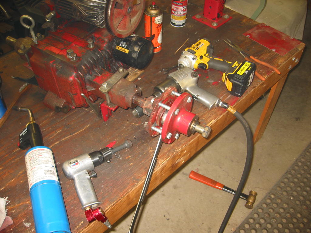

pfrederi 21,240 #1999 Posted March 21, 2019 (edited) I HATE HUBS!!!!!!!!!!!!!!!!!!! 48 hours of soaking (3 different magic juices). Used the air chisel with a flat tip (worked well on two exhaust nipples) Propane torch, ran the battery down on my dewalt had to get out the old IR231 finally started to move. Edited March 21, 2019 by pfrederi 3 1 Share this post Link to post Share on other sites
squonk 48,236 #2000 Posted March 21, 2019 7 minutes ago, pfrederi said: I HATE HUBS!!!!!!!!!!!!!!!!!!! 48 hours of soaking (3 different magic juices). Used the air chisel with a flat tip (worked well on two exhaust nipples) Propane torch, ran the battery down on my dewalt had to get out the old IR231 finally started to move. Maybe use a Mapp/Pro tank next time. Little more heat. You can see the rust on that axle pretty good. Good old trusty IR231 . PO put the wrong filter on but at least it was a Wix! Share this post Link to post Share on other sites
