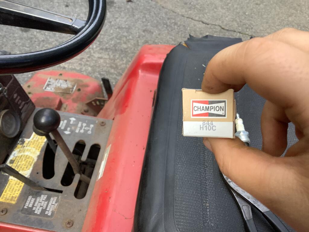

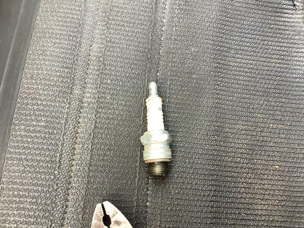

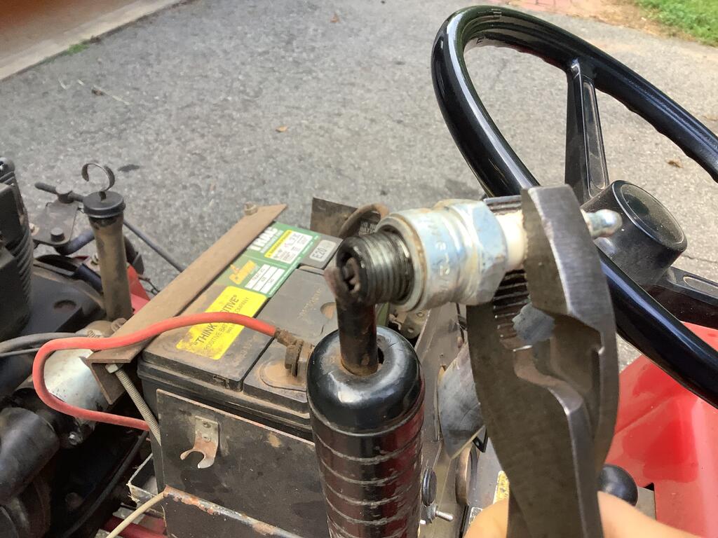

TonyToro Jr. 2,547 #19931 Posted September 11, 2023 Gave my 310-8 a well deserved spark plug change. 6 3 Share this post Link to post Share on other sites

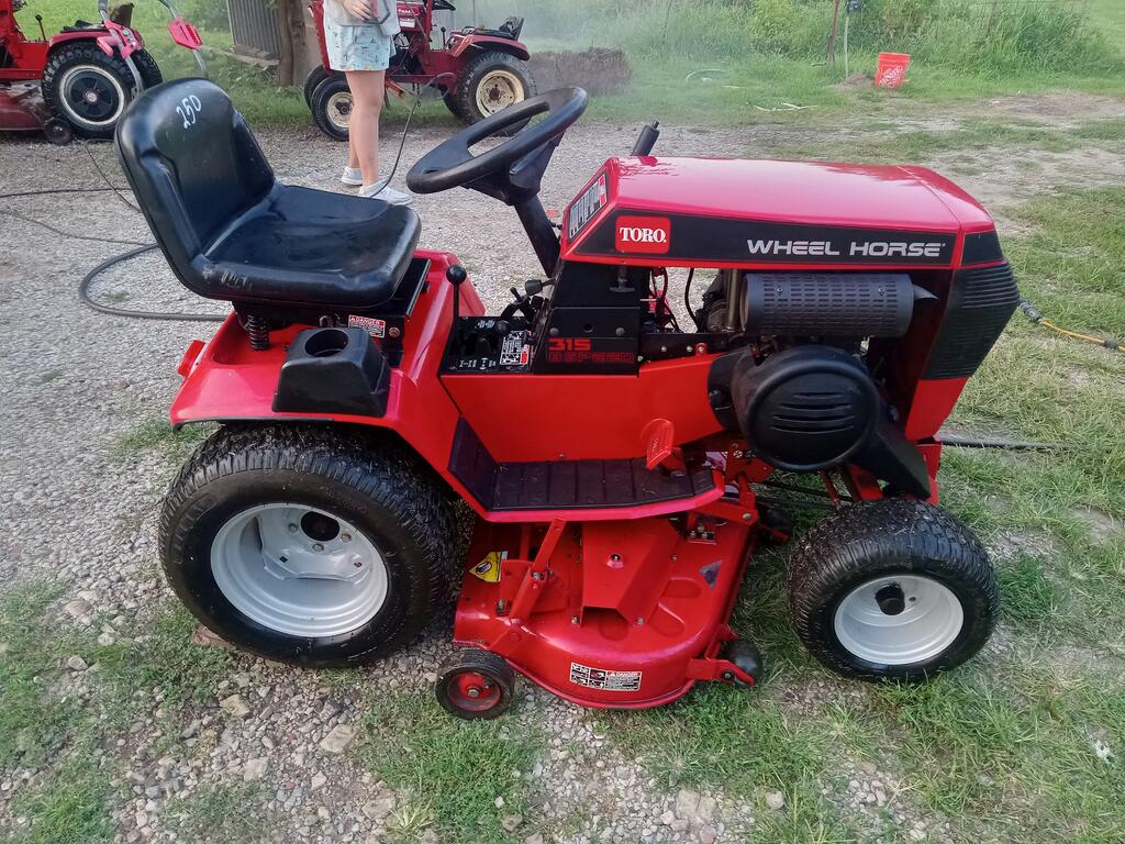

parks416 22 #19932 Posted September 12, 2023 Picked this up at auction last month, got it all washed up and waxed this weekend 1 13 Share this post Link to post Share on other sites

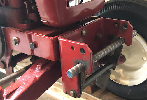

Handy Don 17,623 #19934 Posted September 13, 2023 Assembled an Attach-a-matic to the bracket I made last week and mounted them on the 854. I added flanges to the rearward side members to fit over the still-attached mid-hitch--that way I got to use two bolts on each side. Didn’t quite get the hole for the front hood base screw lined up so that’ll have to be remedied. Once done, I’ll make up a new, much longer, thumbscrew. Bar in place to take measurements for the next step--a hanger for front weights. 1 8 Share this post Link to post Share on other sites

Lee1977 7,807 #19945 Posted September 14, 2023 On 9/12/2023 at 10:26 PM, Handy Don said: Assembled an Attach-a-matic to the bracket I made last week and mounted them on the 854. I added flanges to the rearward side members to fit over the still-attached mid-hitch--that way I got to use two bolts on each side. Didn’t quite get the hole for the front hood base screw lined up so that’ll have to be remedied. Once done, I’ll make up a new, much longer, thumbscrew. Bar in place to take measurements for the next step--a hanger for front weights. I had to saw the hood hinges off my raider to install the front hitch. I drilled and bolted it to the front and made a new longer axle pin. and a 5/8" spacer behind the hitch. spaced in the raider hood brackets and bolted them to the hitch. Those formed Raider axle brackets are hard takes good drill bits to drill it. 1 1 Share this post Link to post Share on other sites
Handy Don 17,623 #19946 Posted September 14, 2023 36 minutes ago, Lee1977 said: Those formed Raider axle brackets are hard takes good drill bits to drill it. Much more complex than doing the 854. I specifically wanted to use available holes to avoid drilling any parts of the frame. My setup mimics the “factory” add on for the short-frame owners wanting to use a deck needing a front mule. I’m content with the side PTO setup for my mower deck but when occasionally moving loaded garden carts uphill 30-40 lbs of easy on/easy off front weight will make things safer. 1 Share this post Link to post Share on other sites
Lee1977 7,807 #19947 Posted September 14, 2023 9 minutes ago, Handy Don said: Much more complex than doing the 854. I specifically wanted to use available holes to avoid drilling any parts of the frame. My setup mimics the “factory” add on for the short-frame owners wanting to use a deck needing a front mule. I’m content with the side PTO setup for my mower deck but when occasionally moving loaded garden carts uphill 30-40 lbs of easy on/easy off front weight will make things safer. That works great for the short frame puts the hitch at the same place as the long frame. My raider is a long frame so I didn't want to have longer deck drive belts. I also changed to Tack-a Matic mid hitch just like my later model WH's. 1 Share this post Link to post Share on other sites
Handy Don 17,623 #19948 Posted September 14, 2023 7 minutes ago, Lee1977 said: I also changed to Tack-a Matic mid hitch just like my later model WH's. Yeah, the newer, 3-bolt attach-a-matic mid hitches are a nice improvement over the 2-bolt flavor for operating. Are the dimensions different vis-a-vie how implements attach? 1 Share this post Link to post Share on other sites
