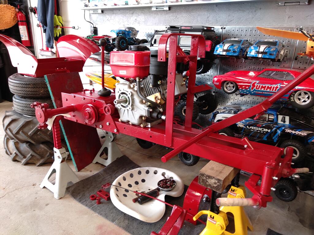

ML3 2,485 #19676 Posted July 28, 2023 6 minutes ago, peter lena said: @ML3 noting your bare frame opportunity , to tuck / lay in a steel fuel line the length of the frame , up against the inner frame bend point . extend out about 6" + cap it off , now as you build up , you can add a clear vinyl fuel rated hose and filter , coming from tank and going to engine . what you have done is to MINIMIZE FUEL LINE BREAK DOWN . people complain about , ethenol fuel . if you make an elimination of the hose composition , you will have fewer problms , even with diesel fuel , BTW also swap out the drive belt idler pulley , nown for failure / noise . looks like you are on track , pete The steel fuel line I am considering. I think I found a fuel tank that I can locate where original was at. I will still have to modify to accept fuel return line into tank. I'm still waiting on my engine pulley to arrive. Then I'll get pulleys & proper belt size/length figured out along with precise engine location. I'll need to make a mounting plate. Since I don't have a belt guard I gotta make something to allow belt to slip without throwing belt when clutch is pressed or trans in neutral. I want to get moving quicker but I'm busy w/work, it's been really hot (I don't like the heat & haven't gotten a/c installed yet in garage) & my sciatica is still giving me problems so that limits the time I can spend working on it. 1 1 Share this post Link to post Share on other sites

ebinmaine 80,445 #19678 Posted July 28, 2023 28 minutes ago, ML3 said: Then I'll get pulleys & proper belt size/length figured out along with precise engine location. I'll need to make a mounting plate. Since I don't have a belt guard I gotta make something to allow belt to slip without throwing belt when clutch is pressed or trans in neutral There are a couple very good description videos on YouTube I keep in my Watch Later File. I'll post them when I remember. 1 Share this post Link to post Share on other sites
ML3 2,485 #19679 Posted July 28, 2023 12 minutes ago, ebinmaine said: There are a couple very good description videos on YouTube I keep in my Watch Later File. I'll post them when I remember. I think I've seen the videos. Want to get all the difficult engineering/fab work done to get tractor up & running before winter with some hours running etc. Once I get all the bugs worked out then I'll get the details done during winter months. My hood has unfortunately already been trimmed at the back. I'm probably going to have to trim a bit more to try & clean it up to make it look better. It was trimmed crooked. 🙄Ultimately, I'm going to redo the exhaust & with fuel tank located in stock location I will get a nice hood on. They definitely aren't easy to come by. And....of course I still got my Suburban rat rod Predator 212 project in line next...... Share this post Link to post Share on other sites

ebinmaine 80,445 #19683 Posted July 28, 2023 2 hours ago, ML3 said: I think I've seen the videos. Want to get all the difficult engineering/fab work done to get tractor up & running before winter with some hours running etc. Forgive my bad memory. What's the rig you're building up ? Share this post Link to post Share on other sites

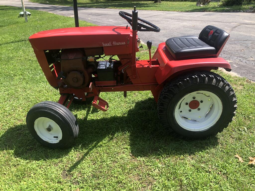

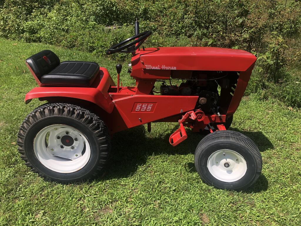

Rob J. 1,944 #19684 Posted July 28, 2023 Finally got to the 656. Got it running awesome. Cleaned it up and put a seat on him. 88 degrees can kiss my ass though! 😂 2 8 Share this post Link to post Share on other sites

ML3 2,485 #19686 Posted July 28, 2023 5 hours ago, ebinmaine said: Forgive my bad memory. What's the rig you're building up ? I'm putting an Amazon purchased diesel in my RJ. 2 7 1 Share this post Link to post Share on other sites
cleat 9,277 #19687 Posted July 28, 2023 I nicknamed those wheel horses the ballburners. I wonder if a cooler running diesel would be another benefit. 2 1 Share this post Link to post Share on other sites

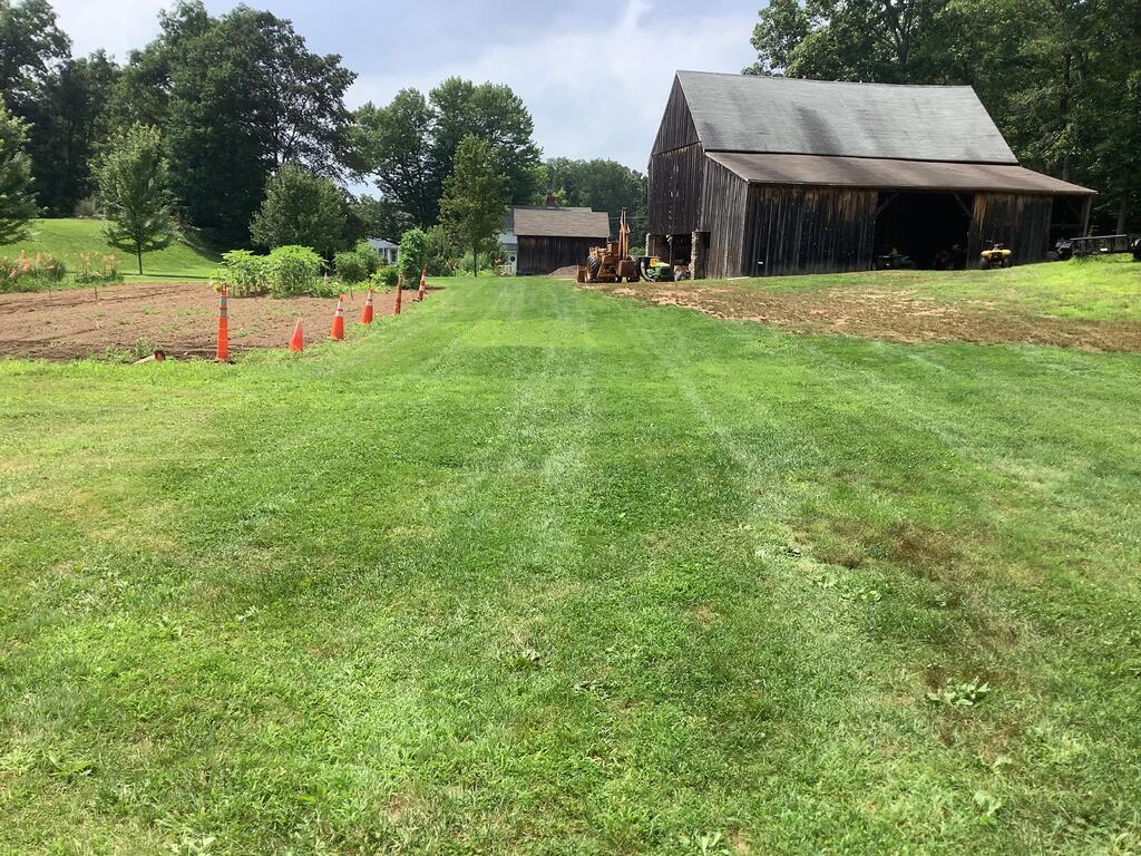

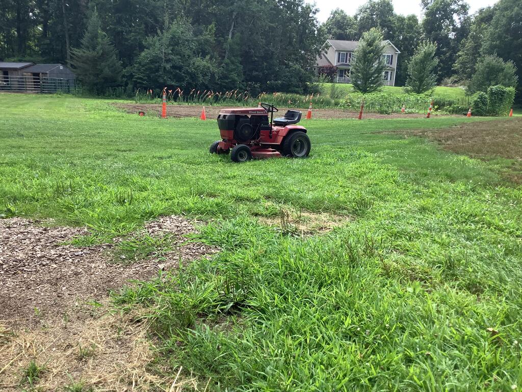

TonyToro Jr. 2,534 #19688 Posted July 28, 2023 Gave my 310-8 a real workout today doing some mowing. Did a great job and layed some nice stripes! 4 4 Share this post Link to post Share on other sites
pfrederi 21,091 #19689 Posted July 29, 2023 16 hours ago, ML3 said: I'm putting an Amazon purchased diesel in my RJ. Not sure at my age I would be able to deal with a pullstart diesel. Good thing you are younger 1 1 Share this post Link to post Share on other sites
ML3 2,485 #19690 Posted July 29, 2023 3 hours ago, pfrederi said: Not sure at my age I would be able to deal with a pullstart diesel. Good thing you are younger Actually it starts easy. Has a decompression lever. Almost always starts on 1st pull. I'm at age that electric start is way I wanna go. 2 Share this post Link to post Share on other sites

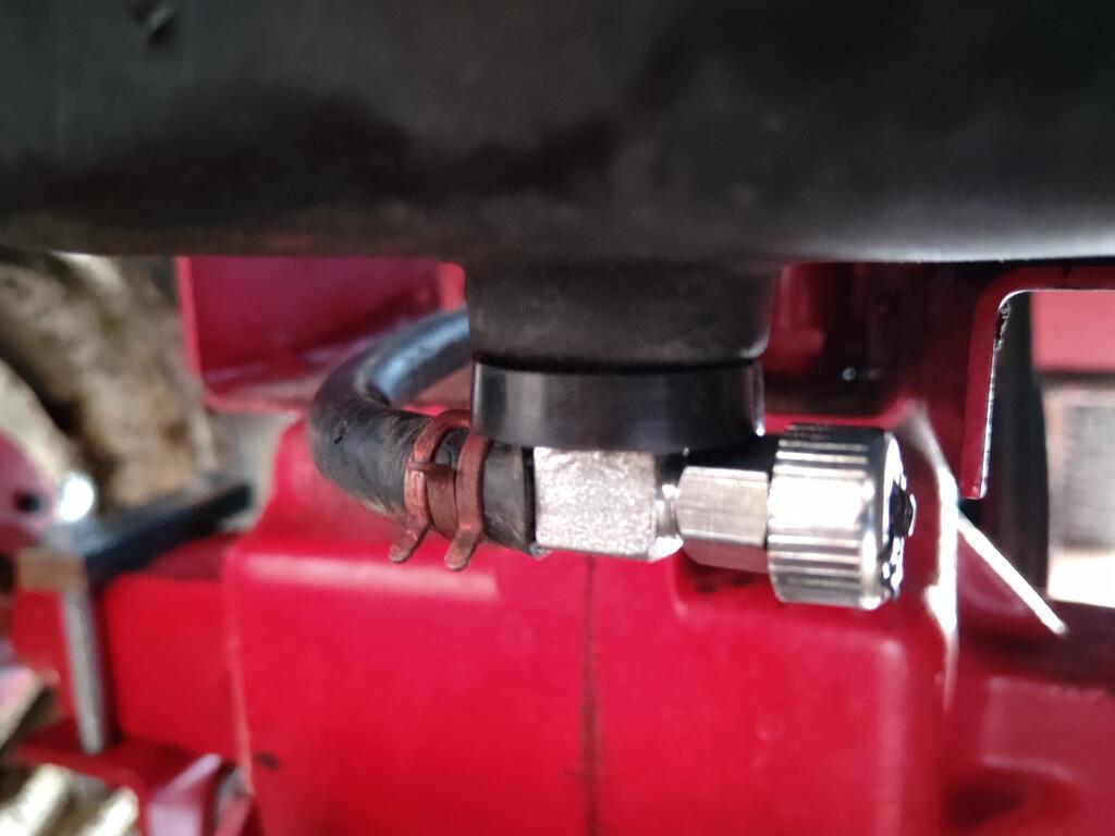

ML3 2,485 #19692 Posted July 29, 2023 New fuel shut off on C105. Got up for work this morning & smelled fuel. Took a bit to figure out what it was. Minibike? Motorcycles? Moped? Which tractor? Outboard on boat? Still waiting on my pulley so can't do anything more with the RJ. 4 Share this post Link to post Share on other sites

cleat 9,277 #19694 Posted July 29, 2023 1 hour ago, ML3 said: New fuel shut off on C105. Got up for work this morning & smelled fuel. Took a bit to figure out what it was. Minibike? Motorcycles? Moped? Which tractor? Outboard on boat? Still waiting on my pulley so can't do anything more with the RJ. Sometimes all you need to do is unscrew the packing nut then totally unscrew the shutoff. At this point you should be able to remove the little "O" ring and replace with a new one then just reassemble the valve. I have done this with the valve still in the tank and only takes a couple of minutes aside from draining the fuel tank. I don't know the o ring size off-hand, I just grab one from an o ring kit that fits. 3 Share this post Link to post Share on other sites
ML3 2,485 #19695 Posted July 29, 2023 I had a new shut off so I just replaced it. Easy fix. 2 Share this post Link to post Share on other sites
Redav72 231 #19696 Posted July 30, 2023 On 7/28/2023 at 1:45 PM, Rob J. said: Finally got to the 656. Got it running awesome. Cleaned it up and put a seat on him. 88 degrees can kiss my ass though! 😂 That seat looks terrific. How’d you come by it? 3 Share this post Link to post Share on other sites

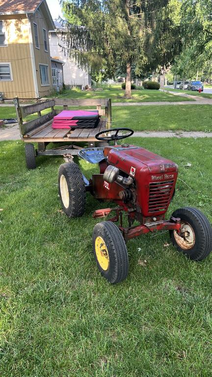

Redav72 231 #19697 Posted July 30, 2023 Bought a hitch sleeve insert from parts ‘n more. Hooked up the 753 to the hay wagon and took it for a test drive around the neighborhood. 7 2 Share this post Link to post Share on other sites
Rob J. 1,944 #19698 Posted July 30, 2023 12 minutes ago, Redav72 said: That seat looks terrific. How’d you come by it? Matt Castagno 3 Share this post Link to post Share on other sites

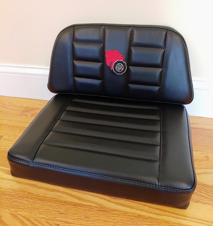

Tonytoro416 1,380 #19699 Posted July 30, 2023 Matt did this seat for my 953 as well. Totally awesome and quality product he puts out. He is the man 3 7 Share this post Link to post Share on other sites
