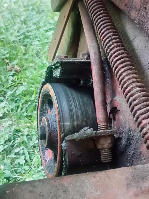

Colby G 248 #19629 Posted July 26, 2023 Should my brakes have grease on them like this? I'm not quite sure that brakes should be greasy. Share this post Link to post Share on other sites
ineedanother 2,885 #19630 Posted July 26, 2023 13 minutes ago, Colby G said: Should my brakes have grease on them like this? I'm not quite sure that brakes should be greasy. Negative G.R. That's gear oil, not grease. Bad seal and possibly a bad bearing there but very likely just the seal. 2 Share this post Link to post Share on other sites
ebinmaine 81,032 #19631 Posted July 26, 2023 15 minutes ago, Colby G said: Should my brakes have grease on them like this? I'm not quite sure that brakes should be greasy. Nope. Them's gunked up some. There's a seal behind the brake drum that's likely bad. Fairly easy job for replacement. 2 Share this post Link to post Share on other sites
Colby G 248 #19632 Posted July 26, 2023 13 minutes ago, ineedanother said: Negative G.R. That's gear oil, not grease. Bad seal and possibly a bad bearing there but very likely just the seal. Do you know where I could get a new seal? Share this post Link to post Share on other sites
ineedanother 2,885 #19633 Posted July 26, 2023 1 minute ago, Colby G said: Do you know where I could get a new seal? Sure. Some here would be able to give you a part # crosswalk to local sources (NAPA and the like) but if you have access to your ID, contact a vendor in their section below and they will hook you up. Share this post Link to post Share on other sites
Colby G 248 #19634 Posted July 26, 2023 5 minutes ago, ineedanother said: Sure. Some here would be able to give you a part # crosswalk to local sources (NAPA and the like) but if you have access to your ID, contact a vendor in their section below and they will hook you up. How do I get the part number? Share this post Link to post Share on other sites

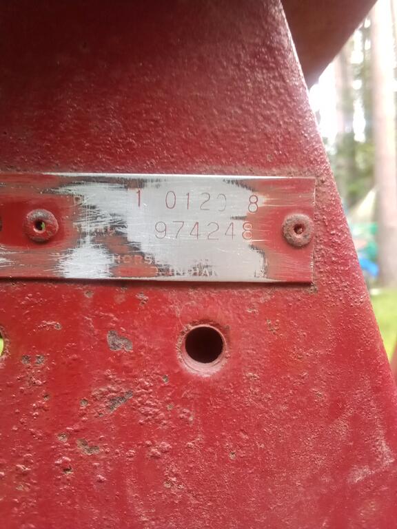

ineedanother 2,885 #19635 Posted July 26, 2023 4 minutes ago, Colby G said: How do I get the part number? Post your tractor ID and we'll help. A pic of the tag is the best way to do that. Share this post Link to post Share on other sites
Colby G 248 #19636 Posted July 26, 2023 2 minutes ago, ineedanother said: Post your tractor ID and we'll help. A pic of the tag is the best way to do that. It's not pretty, but I believe this is the tag you are looking for Share this post Link to post Share on other sites

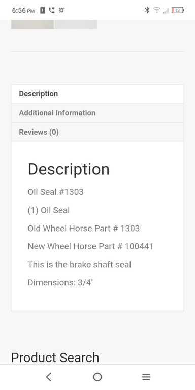

ineedanother 2,885 #19639 Posted July 26, 2023 You can search for WH # 100441, or look at SKF 7410 1 1 Share this post Link to post Share on other sites
Colby G 248 #19640 Posted July 26, 2023 4 minutes ago, ineedanother said: You can search for WH # 100441, or look at SKF 7410 This the one I need? 2 Share this post Link to post Share on other sites
ineedanother 2,885 #19641 Posted July 26, 2023 Yessir. 1 Share this post Link to post Share on other sites
Colby G 248 #19642 Posted July 26, 2023 3 minutes ago, ineedanother said: Yessir. Great, thank you for all the help! 1 Share this post Link to post Share on other sites

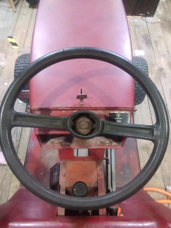

Colby G 248 #19644 Posted July 27, 2023 Does anyone know how to take the steering wheel off this no name? Id like to replace it for a nicer one and can't figure out how to get it off Share this post Link to post Share on other sites
Handy Don 17,623 #19645 Posted July 27, 2023 (edited) 9 minutes ago, Colby G said: Does anyone know how to take the steering wheel off this no name? Id like to replace it for a nicer one and can't figure out how to get it off Yes. Search this site for “remove steering wheel” or “steering wheel removal” (flip the “use all my keywords” switch on and choose “Topics” as the area to search Numerous threads with info. There is either a Spirol or a Roll Pin through the hub of the wheel and the steering shaft. Removing one that’s nature welded (rusted) in place can be a real challenge--one of the WH rites of passage, I’d say, along with a stuck wheel hub or a stuck rear hitch pin. Edited July 27, 2023 by Handy Don 2 Share this post Link to post Share on other sites
ebinmaine 81,032 #19646 Posted July 27, 2023 8 hours ago, Colby G said: Does anyone know how to take the steering wheel off this no name? Id like to replace it for a nicer one and can't figure out how to get it off Like Don says above, the steering wheel on a Wheelhorse is one of the biggest challenges many of us face. To remove one it takes the right tools, some know how, and most of all ~ patience. If the wheel you have is solid, as in no flexibility at the joints, it would be great to save it by removing without damage. They're a very good strong wheel. 1 Share this post Link to post Share on other sites
johnnymag3 2,646 #19647 Posted July 27, 2023 Looks to me like you just need the center cap !!! It sits in the groove inside the steering wheel center area above the Bolt head you can see John Share this post Link to post Share on other sites
Colby G 248 #19648 Posted July 27, 2023 (edited) 13 minutes ago, johnnymag3 said: Looks to me like you just need the center cap !!! It sits in the groove inside the steering wheel center area above the Bolt head you can see John Idk if it could fit a center cap, as you may be able to see, the center is a bit stretched, and it also has a little cut in it. What I wanted to do was put an old Studebaker wheel on it. Would that be possible? Edited July 27, 2023 by Colby G Share this post Link to post Share on other sites
Ed Kennell 47,727 #19649 Posted July 27, 2023 5 minutes ago, Colby G said: What I wanted to do was put an old Studebaker wheel on it. Would that be possible? All things are possible....if you have a 4.5" angle grinder and a welder. 1 4 Share this post Link to post Share on other sites
