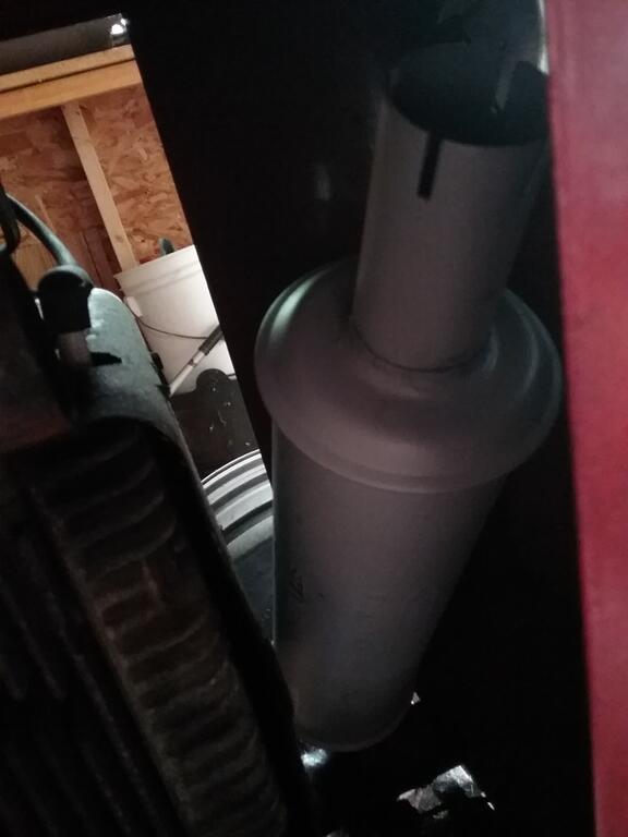

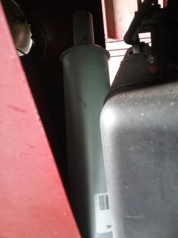

8ntruck 8,978 #19226 Posted June 13, 2023 I stopped by the local TSC store and picked up a IH Cub muffler today. It turns out to be much longer than the muffler on my C-195. Following pictures are of my C-195 with the original muffler removed and the Cub muffler 'mocked up'. If I squint just right, I think I can make it fit. Major surgery will be required. From left side: From right side: No, the surgery will NOT be performed on the hood. It appears that the Cub muffler is built like a Thrush muffler of old. It has a perforated pipe welded inside a can. There is no fiberglass in the can and there does not seem to be a baffle in the can, either. I'm thinking of sectioning the muffler, maybe 3" shorter. Called my neighbor over for a consultation. He came up with the same solution. I've got a welder, he has a band saw. I'll probably start a thread on this when I get into it. I know, the easiest way to use this muffler would be to make it as a stack. I don't really want a stack on this tractor, though. 5 Share this post Link to post Share on other sites

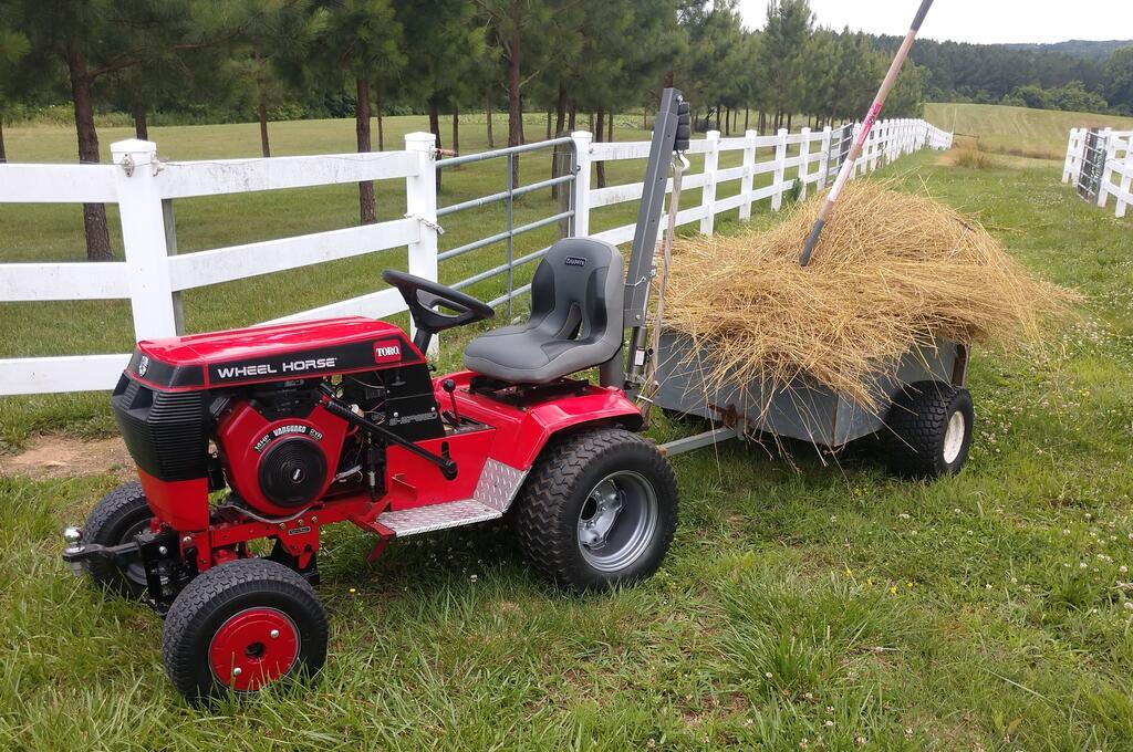

kpinnc 18,558 #19229 Posted June 13, 2023 My neighbor was cutting hay a few days ago, and was kind enough to cut my back pasture as well. He got more than 3 round bales from it, but of course couldn't fit in some of the corners with the bailer. Since I really hate to waste it, I decided to rake it up and give it to my critters. Needless to say, my ass is happy! 2 3 20 Share this post Link to post Share on other sites

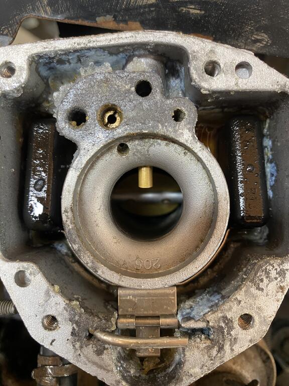

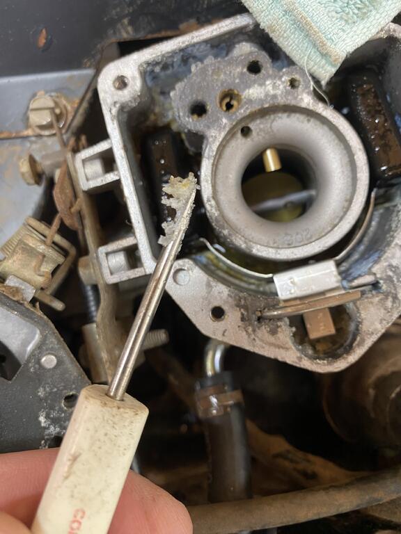

Sparky-(Admin) 25,622 #19235 Posted June 14, 2023 Couple pics inside the unloved Onan 416’s carb from last night. 2 1 3 3 Share this post Link to post Share on other sites
Handy Don 16,763 #19236 Posted June 14, 2023 1 minute ago, Sparky said: Couple pics inside the unloved Onan 416’s carb from last night. Screaming “save me, save me” .... 2 1 Share this post Link to post Share on other sites
Sparky-(Admin) 25,622 #19237 Posted June 14, 2023 1 minute ago, Handy Don said: Screaming “save me, save me” .... I cleaned it once..runs better but not great. Going in again to give it a second “scrubbing” 1 Share this post Link to post Share on other sites

WHX?? 56,959 #19241 Posted June 14, 2023 7 hours ago, Sparky said: I cleaned it once..runs better but not great. Going in again to give it a second “scrubbing” You get the charging issue fingered out Sparky? 1 Share this post Link to post Share on other sites
Sparky-(Admin) 25,622 #19242 Posted June 15, 2023 2 hours ago, WHX?? said: You get the charging issue fingered out Sparky? No, I focused on getting it to run, then trying to get it to run better (came close ). I did verify that the stator is putting out the correct AC volts, so that’s good news. I’ll dig into the charging issue this weekend. 3 Share this post Link to post Share on other sites
johnnymag3 2,646 #19243 Posted June 15, 2023 21 hours ago, Sparky said: unloved Onan 416’s carb Thats proof that we are not paying / buying for gasoline anymore...we are buying some sort of combustible JUNK. 4.00 a GALLON !!!! What a shame 4 Share this post Link to post Share on other sites

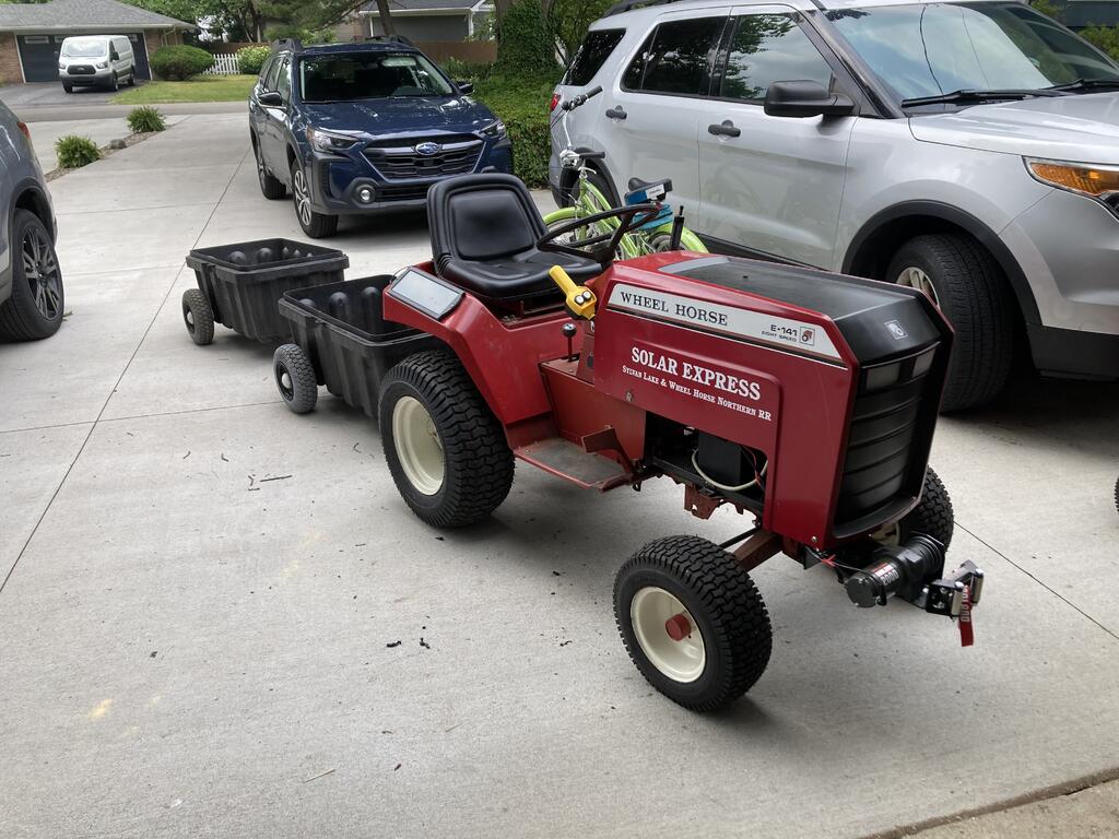

SylvanLakeWH 31,577 #19250 Posted June 16, 2023 Proof of concept for the two new tub cars for the SL&WHN RR... Works pretty good. Seats and some paint, hitch pins etc. and good to go... 2 6 1 Share this post Link to post Share on other sites
