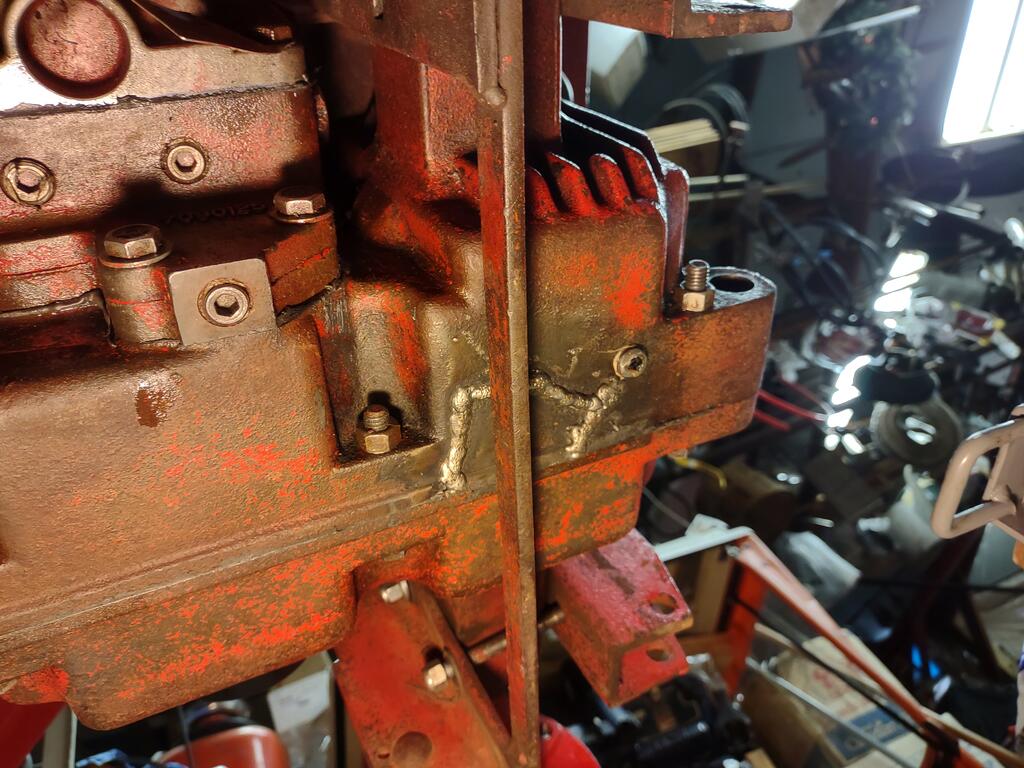

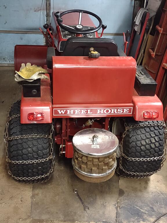

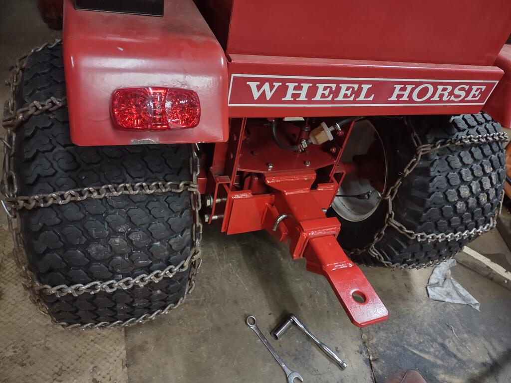

tmix61 95 #18461 Posted February 21, 2023 It all started 6 weeks ago. Was plowing and seeing hydraulic fluid on the ground oh no what happened. The d200 was pushing snow like mad then all of a sudden I see a trail of hydraulic fluid as I'm backing up oh no back to the garage. Found the case on the run was broken open from the inside low and behold. A boat that loose inside and got caught around the bull gear and the housing lost got it apart did I mention it's a 1977 so it's been together for a long time got the hubs off broke one had to order a new used hub got it apart needed a set of needle bearings in one side ordered gasket put it back together and it leaked not in the same spot on one of the gaskets that had never been taken apart take it apart put gasket sealer on and we're all better. The weld is holding up great. Decided to make a 2-in receiver because I used the ball hitch to put my weights on before and everybody told me bad move so after doing a little research and figuring I made my own now we have the weights on there securely all said and done thanks to the members and transmission forum for all the help and shining light on what was wrong with the inside yes of course a boat broken side grade 5 should have been grade 8 now updated these are a few pictures of my fun time 6 11 Share this post Link to post Share on other sites
kpinnc 18,979 #18462 Posted February 21, 2023 9 hours ago, tmix61 said: It all started 6 weeks ago. Congrats on having the fortitude to keep that big D in service! Most would have given up and that machine would have been scrapped. Your repair looks solid! Nice fab on the hitch too. Looks bulletproof! Well done! 4 Share this post Link to post Share on other sites
Wheelhorse#1 1,997 #18463 Posted February 21, 2023 The D200 is one machine I’m hopeful to find in my budget range. So far no luck.Guess I’m just too cheap! Nice job on the repair. 1 Share this post Link to post Share on other sites
19richie66 17,936 #18464 Posted February 21, 2023 (edited) @tmix61 I do have a good case if you need it. Tractor looks great and that hitch looks very stout. Nice job. Edited February 21, 2023 by 19richie66 2 1 Share this post Link to post Share on other sites

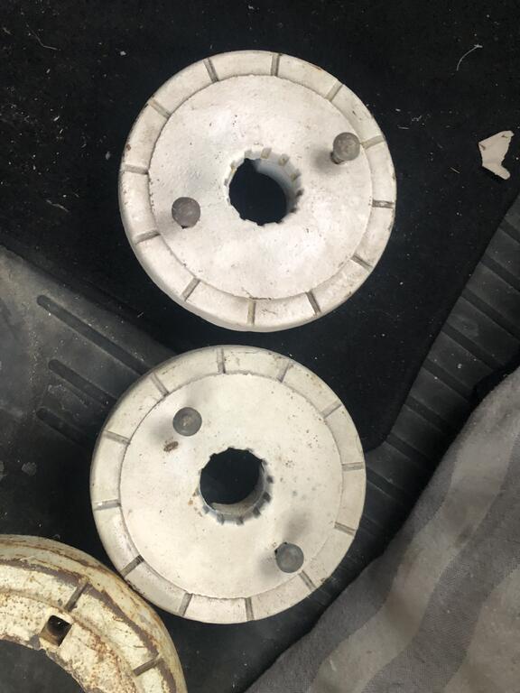

Rob J. 1,944 #18465 Posted February 21, 2023 Found me a set of fronts, feel like I won the lottery. Gitty up! 9 1 Share this post Link to post Share on other sites

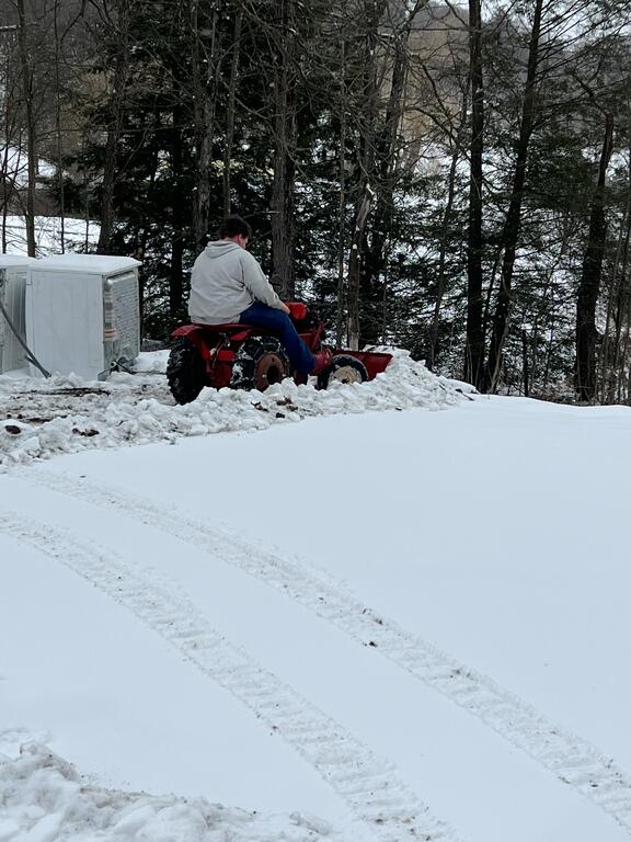

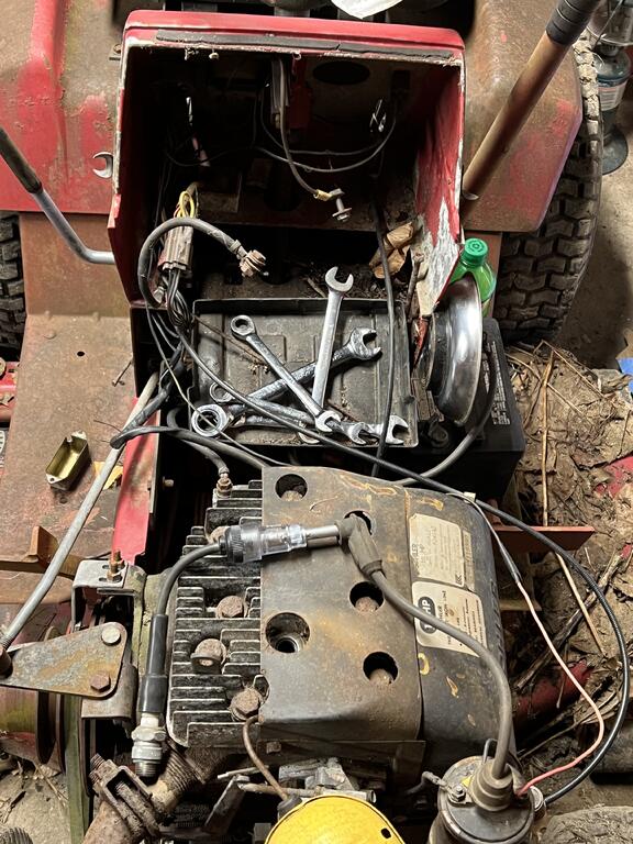

WHGuy413 2,859 #18466 Posted February 21, 2023 Haven’t been out in the garage much the last few weeks. Picked the kids up and got home. @WheelHorse_Kid wanted to work on the B-80 4 speed that someone did a trans swap on to an 8 speed. We are debating about using this as the tractor that has our loader on it. Overall it’s in good shape. While he took the snow plow, home made weight bracket and plow bracket off I worked on my friends c-105. I really hate this tractor. Give me anything from the 50’s, 60’s and 70’s. I evicted the mouse nest around the whole fly wheel a few weeks ago put the engine shroud back on and tried cranking it over and it is super sluggish even with the plug out. Guess I need to figure that issue out. Not sure if it could be the starter. It’s sat outside for years so could be about anything. I have Thursday and Friday off this week. I will probably try to get some time in there to work on it. Really want it gone. It’s taking up critical space lol. 6 Share this post Link to post Share on other sites
mrc 1,119 #18467 Posted February 21, 2023 hi tmix61, great welding on the case. the hitch looks well fabricated too. super workmanship! 2 1 Share this post Link to post Share on other sites

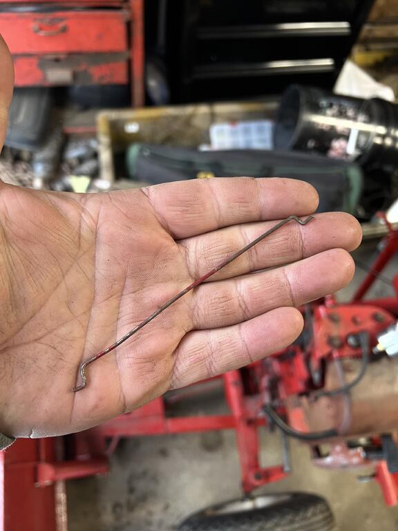

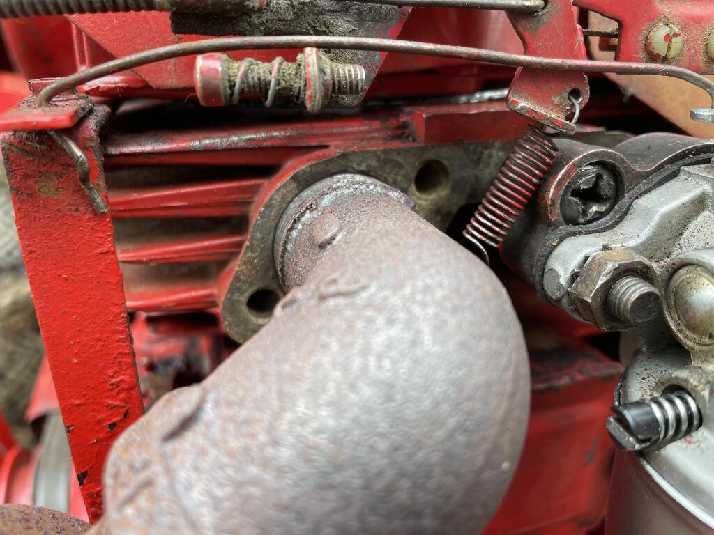

WHGuy413 2,859 #18468 Posted February 23, 2023 (edited) Dad to the rescue. Alex aka @WheelHorse_Kid had to clean the carburetor on his 604 yesterday while I was at work. I think we are running into a fuel line issue but that will get swapped out. In the process he texts me and says the governor arm is sticking and making it stay at full throttle. He sent me some pics and it wasn’t until the last one I saw the error to his ways. In the process of putting things back together he bent the governor arm at a 90 causing the rod to be significantly shorter. Fast forward to this morning I tried to assist him by carefully bending and twisting it back. But sure enough I broke it. To the work bench I went and found a small piece of mechanics wire and used my vise a pair of pliers and a hammer and punch and bent a new one. Shockingly it worked great and him and his brother plowed with the 604 and the 856. He didn’t put the hood back on to plow because he doubted my fix (let’s face it so did I)but after plowing for 1 1/2hours it was still running perfectly fine. Edited February 23, 2023 by WHGuy413 3 12 Share this post Link to post Share on other sites
kpinnc 18,979 #18469 Posted February 23, 2023 (edited) On 2/21/2023 at 3:48 PM, Rob J. said: Found me a set of fronts, feel like I won the lottery. Gitty up! I have fronts. ...I want a set of rears! Shockingly, they were still available from Toro a few years ago. Not sure about now, but I couldn't afford a set. Still kicking myself.... Edited February 23, 2023 by kpinnc 2 Share this post Link to post Share on other sites

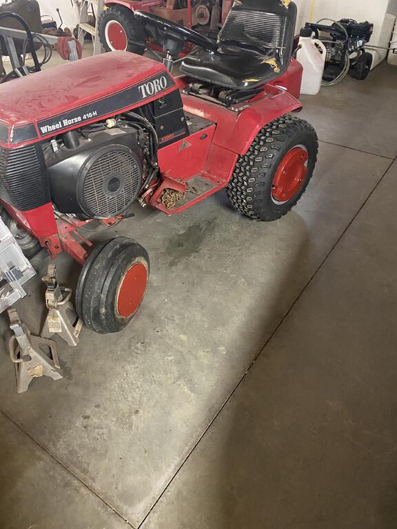

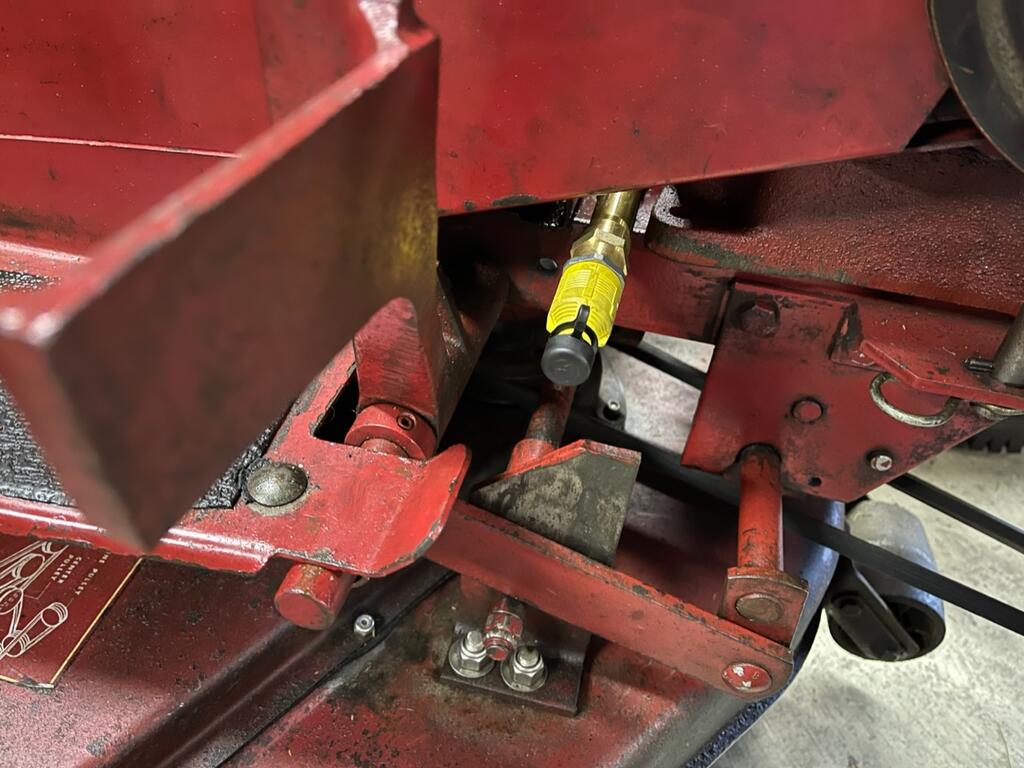

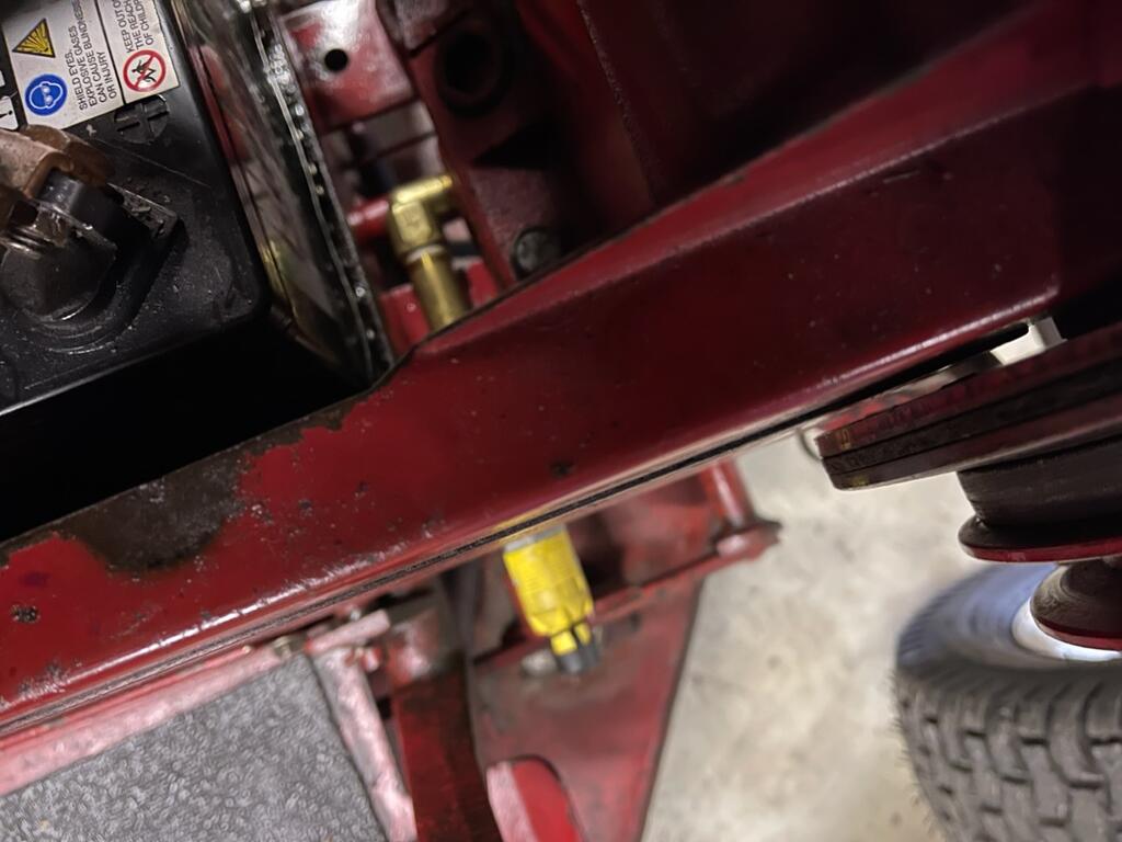

TractorEd 675 #18470 Posted February 24, 2023 (edited) I installed a new oil drain with a tool-less plug on the C-100 and changed the oil after the 1st 5hrs upon rebuild. Edited February 24, 2023 by TractorEd 5 4 Share this post Link to post Share on other sites

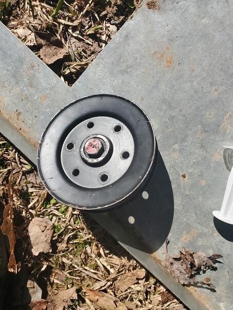

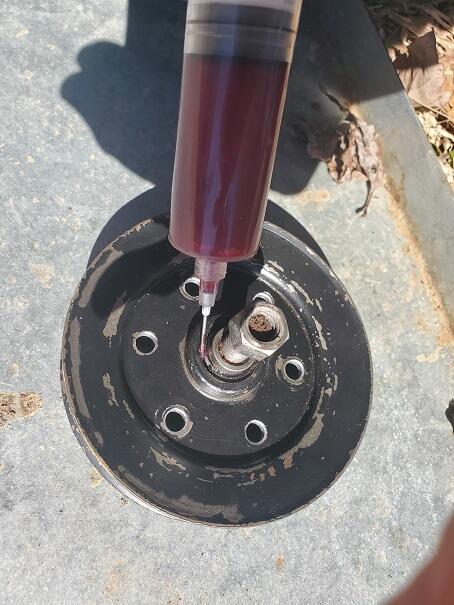

GAJoe 852 #18473 Posted February 25, 2023 (edited) My c-160 input belt idler pully is in good shape but the bearing is dry; smooth but dry. As you can see I tried drilling out the spot welds but the halves are fused I guess by induction welding as another has stated. I took a large syringe from the local farm supply and took the sharp tip off of the needle. I found that the seal on the side of the bearing is just thin rubber. I really did a number on that seal with the 1/16" dia needle. It's about half gone. I should have left the sharp point on the needle to make a small hole in the seal. Any way I was able to fill the bearing with Lucas Red that I has loaded. I'm thinking that it'll probably stay fairly clean and not loose the grease very fast considering that it's behind the sheet metal. It beats buying a new one and will probably last as long as I need it to. It spins smoothly now without the dry bearing noise. . Edited February 25, 2023 by GAJoe corrected spelling. 8 1 Share this post Link to post Share on other sites

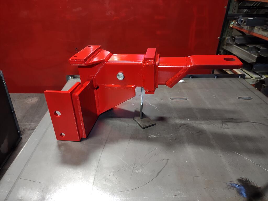

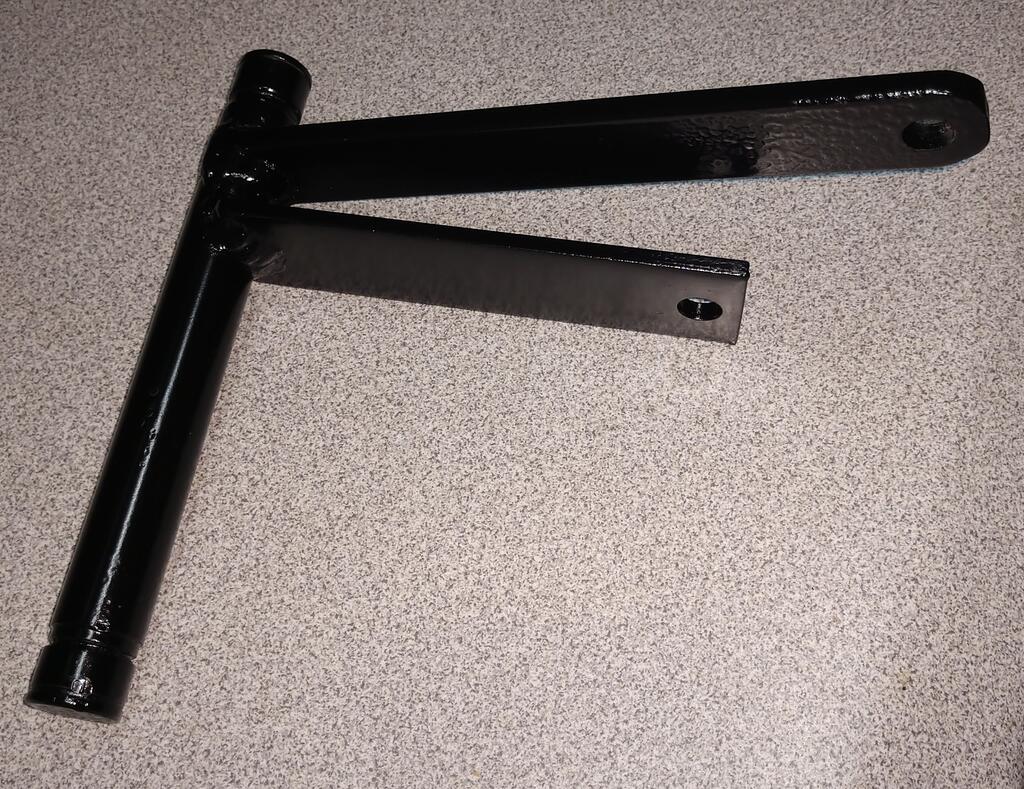

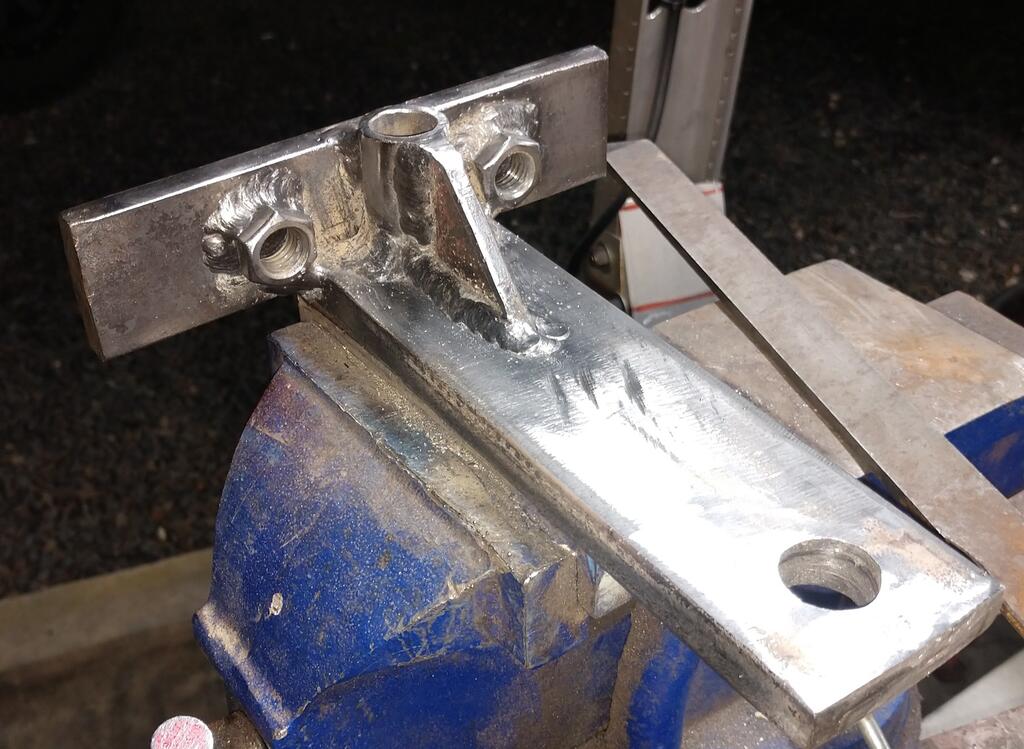

kpinnc 18,979 #18474 Posted February 27, 2023 Finished up the rear hitch I'm building for a friend. Looking back, it would have been faster to just buy the thing, but I decided to just build it. Best I could do from memory. It'll be good enough. 4 7 Share this post Link to post Share on other sites
ebinmaine 80,772 #18475 Posted February 27, 2023 4 hours ago, kpinnc said: Best I could do Excellent 👍👍 1 Share this post Link to post Share on other sites
