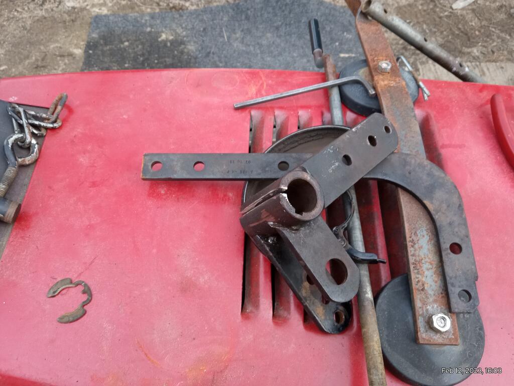

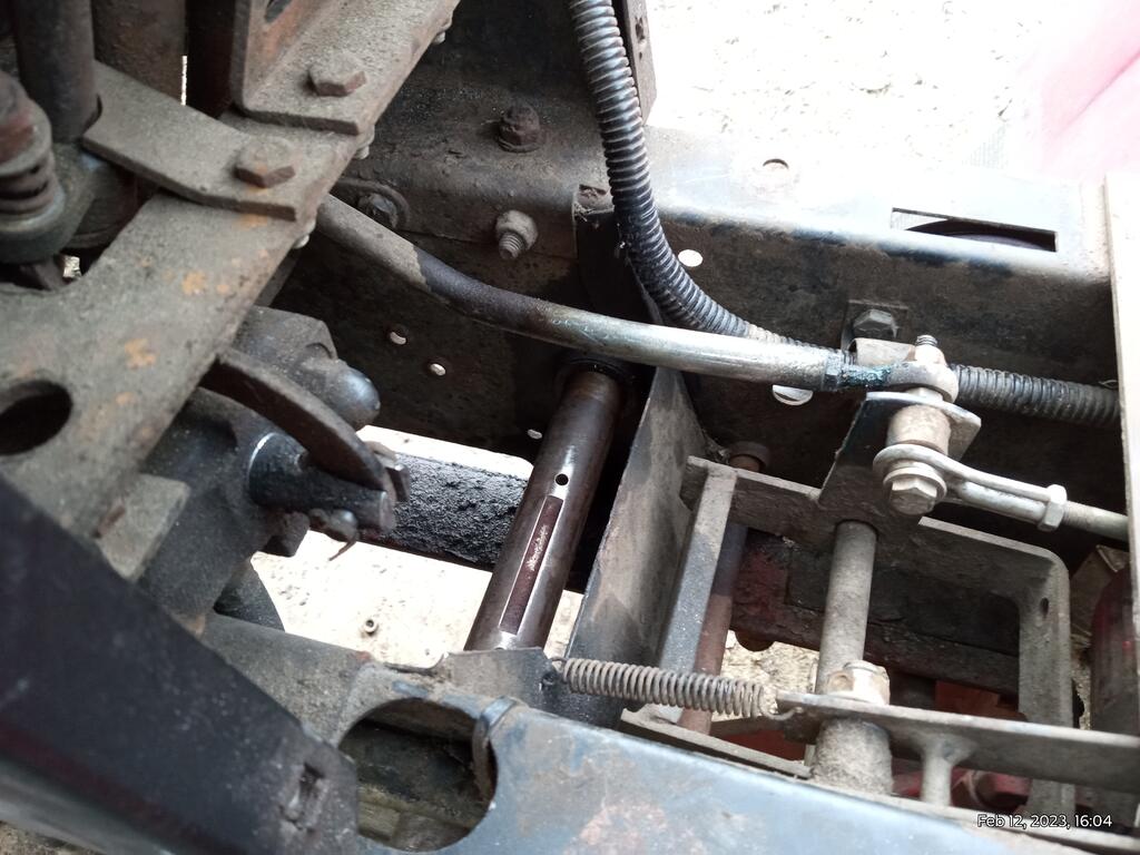

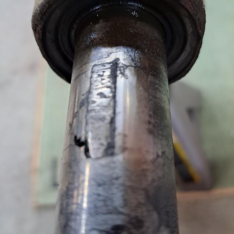

NA73 82 #18426 Posted February 13, 2023 I got bored and went looking for a project with all the unseasonable warm weather. the plan is to make an extension(bolt-on) to the bell-crank arm for greater range of motion for the snow blower. I'm going to drill out the far end hole to the same size as the others. With the motion-control rod unbolted, one can get an angle-grinder w/ cut-off wheel down to make a slice and after 30 seconds with an air-chisel, everything came apart. ended up with this: 4 Share this post Link to post Share on other sites

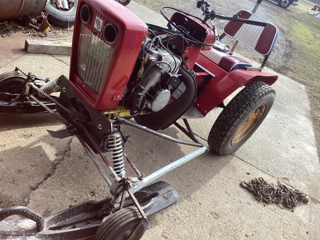

Pullstart 71,333 #18427 Posted February 14, 2023 I’m doing some all so often but never lasts cleaning and organizing. I put the skinnies on for ease of rolling around. Oh how much fun it would be to spin them to a smoke show! 4 1 Share this post Link to post Share on other sites

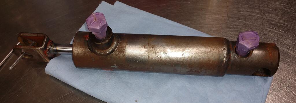

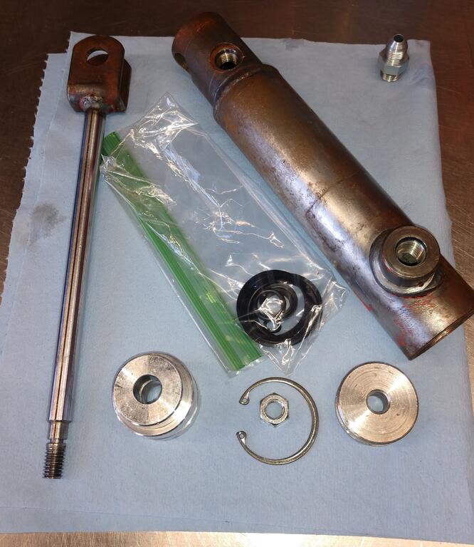

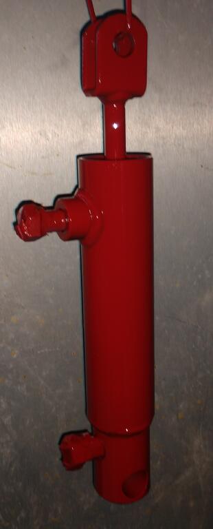

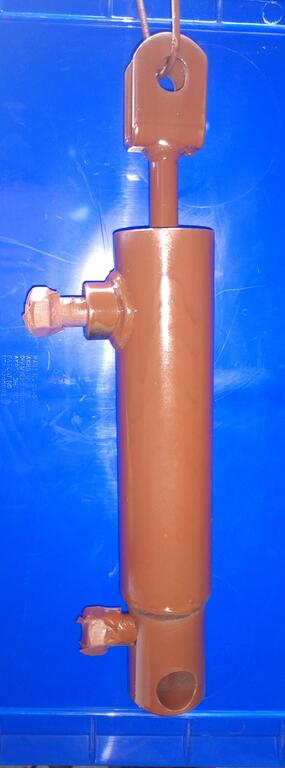

kpinnc 18,982 #18435 Posted February 14, 2023 (edited) I took it easy today. I rebuilt a hydraulic cylinder to go on the Bronco. It has one of the older welded cylinders that is leaking a little. I just rebuilt a newer spare and will swap them in a few days. Took it completely apart and soaked in hot water and degreaser. Then rinsed in hot water. Must be good stuff, because it took the paint off! The wipers on the plunger were completely disentigrated, so I'm glad I took the time to rebuild instead of just swapping as-is. Lubed all the new o-rings with dex/merc and it went back together with about 2.6 grunts. Wiped down and shot a coat of primer and paint. Not show quality, but hopefully will last another few years. Start to finish around 30 mins. Edited February 14, 2023 by kpinnc 1 11 Share this post Link to post Share on other sites

953 nut 69,578 #18437 Posted February 15, 2023 1 hour ago, kpinnc said: it went back together with about 2.6 grunts. Are you sure about that 6/10 of a grunt! Nice work. 1 Share this post Link to post Share on other sites
ineedanother 2,871 #18438 Posted February 15, 2023 7 minutes ago, 953 nut said: Are you sure about that 6/10 of a grunt! Nice work. Every grunt = 200mg Ibuprofen for me these days and I just can't do the math on that 4 Share this post Link to post Share on other sites
kpinnc 18,982 #18439 Posted February 15, 2023 50 minutes ago, 953 nut said: Are you sure about that 6/10 of a grunt! Nice work. The other .4 grunt came when the plunger finally slipped in and I pinched my thumb... 2 Share this post Link to post Share on other sites
kpinnc 18,982 #18440 Posted February 15, 2023 42 minutes ago, ineedanother said: Every grunt = 200mg Ibuprofen for me these days and I just can't do the math on that I always round up. I'm a big boy, so 600mg is nothing. 1 Share this post Link to post Share on other sites

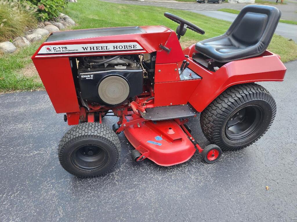

19richie66 17,936 #18442 Posted February 18, 2023 I have been trying to get my dad’s tractor ready to take to my son next week. Hope is that he will get the bug and redo it later. Swapped out a bunch of different parts that my dad put on it and tried to get it back to stock. Also put a deck on it and mowed a little. Little rough on the rear without a seat 😁. 7 5 1 Share this post Link to post Share on other sites

kpinnc 18,982 #18444 Posted February 19, 2023 (edited) 21 hours ago, 19richie66 said: Swapped out a bunch of different parts that my dad put on it and tried to get it back to stock. Also put a deck on it and mowed a little. Little rough on the rear without a seat 😁. That thing has the potential to be a beast! And yeah, no seat hurts! Edited February 19, 2023 by kpinnc 1 Share this post Link to post Share on other sites
Brockport Bill 2,478 #18445 Posted February 19, 2023 30 minutes ago, kpinnc said: That thing has the potential to be a beast! And yeah, no seat hurts! enjoying the black hoods, and yes, the KT17s are beasts 1 6 Share this post Link to post Share on other sites

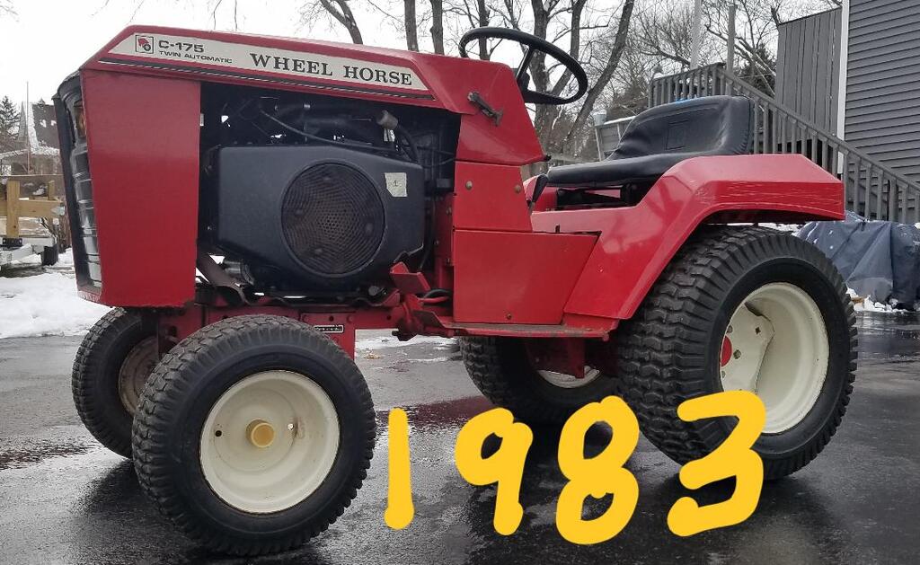

ebinmaine 80,777 #18446 Posted February 19, 2023 What have I done to my Wheelhorse today? DROVE IT !!! 2 7 Share this post Link to post Share on other sites
rjg854 13,384 #18447 Posted February 19, 2023 Trinna does really nice work 1 Share this post Link to post Share on other sites
ebinmaine 80,777 #18448 Posted February 19, 2023 8 minutes ago, rjg854 said: Trinna does really nice work Absolutely agreed !! Share this post Link to post Share on other sites
rjg854 13,384 #18449 Posted February 19, 2023 You might have helped a bit too, Eric. . 1 Share this post Link to post Share on other sites

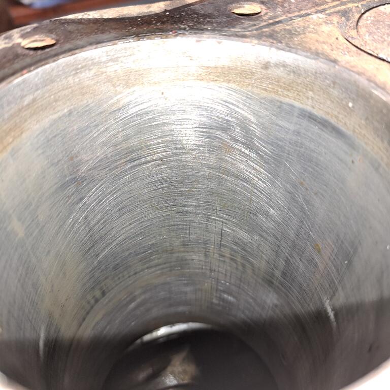

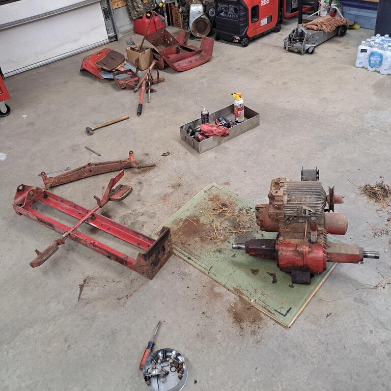

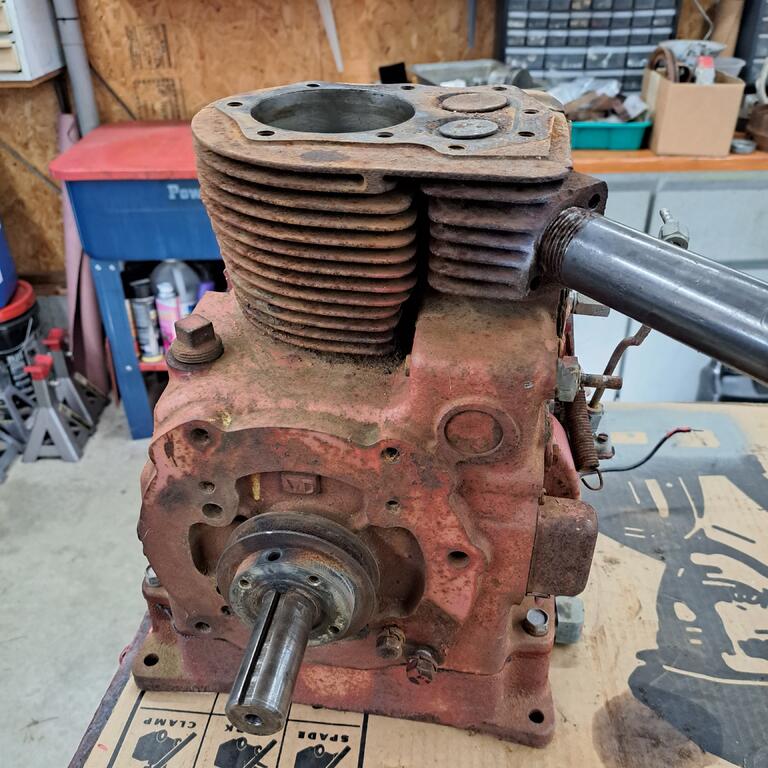

WHX?? 58,237 #18450 Posted February 19, 2023 (edited) Tore down a 1276 parts tractor. Anybody see anything they need speak now or forever hold yer peace. Tore into the motor and the boys measured it up. Within std. specs but some weird cross hatching. Will get cleaned up, honed and new rings & paint and on the shelf for a ready spare or project. We think this might have been a service motor at one time. I.D. plate is MIA. Drilled out the pully set screws and came off no problem @Achto From the we seen it all files. Hubs are savable tho with new keyway. Axles good yet too! Edited February 19, 2023 by WHX?? 4 4 Share this post Link to post Share on other sites
