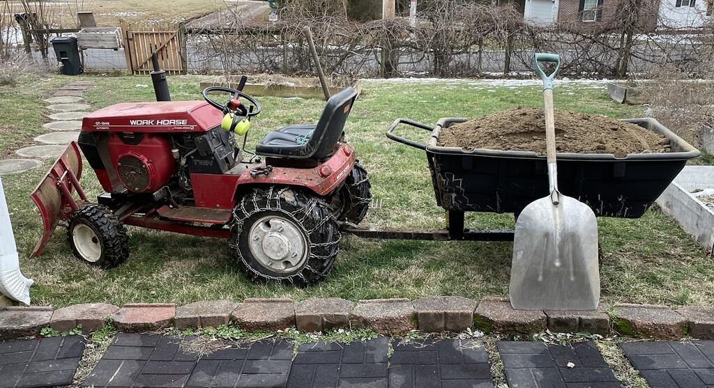

davem1111 2,453 #18351 Posted January 29, 2023 I put the snow plow blade, rear weights and chains on the GT-1848 (which my wife has now dubbed "The Beast") early last week, when they were saying we might get as much as 11" of snow. But we only got about 3", so I didn't need to plow. However, today my wife asked me to cover up the lily and daffodil bed with "something" that would protect them from the next wave of cold, since they are already starting to peek out green. Hmmm.... took The Beast and trailer back to the old horse barn, made a few passes with the plow, and had a wagon load in about 10 minutes. Spread that out and went back for more. 2 loads was enough, but there's plenty left for other things. Maybe a new garden in the spring. We only have four 4' x 8' planter boxes right now. Dang, really wish I could get my hands on a tiller for this thing. 8 3 Share this post Link to post Share on other sites
Blasterdad 3,168 #18352 Posted January 29, 2023 4 minutes ago, davem1111 said: I put the snow plow blade, rear weights and chains on the GT-1848 (which my wife has now dubbed "The Beast") early last week, when they were saying we might get as much as 11" of snow. But we only got about 3", so I didn't need to plow. However, today my wife asked me to cover up the lily and daffodil bed with "something" that would protect them from the next wave of cold, since they are already starting to peek out green. Hmmm.... took The Beast and trailer back to the old horse barn, made a few passes with the plow, and had a wagon load in about 10 minutes. Spread that out and went back for more. 2 loads was enough, but there's plenty left for other things. Maybe a new garden in the spring. We only have four 4' x 8' planter boxes right now. Dang, really wish I could get my hands on a tiller for this thing. It is a beast for sure! I love the "shin schredders" on the wheel weights... Share this post Link to post Share on other sites
davem1111 2,453 #18353 Posted January 29, 2023 12 hours ago, Blasterdad said: It is a beast for sure! I love the "shin schredders" on the wheel weights... Well, I did use some shorter bolts this time, but I should probably grind those off a bit shorter. But, no shins will get shredded. Mine got it enough from the longer ones that I think I've learned my lesson, and I'll make sure no one else gets close enough. Unless it's parked in the garage. Then you're on your own... I guess that's kinda mean - I'll probably at least drape a towel over them when it's in the garage. 4 Share this post Link to post Share on other sites

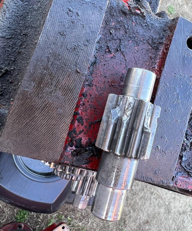

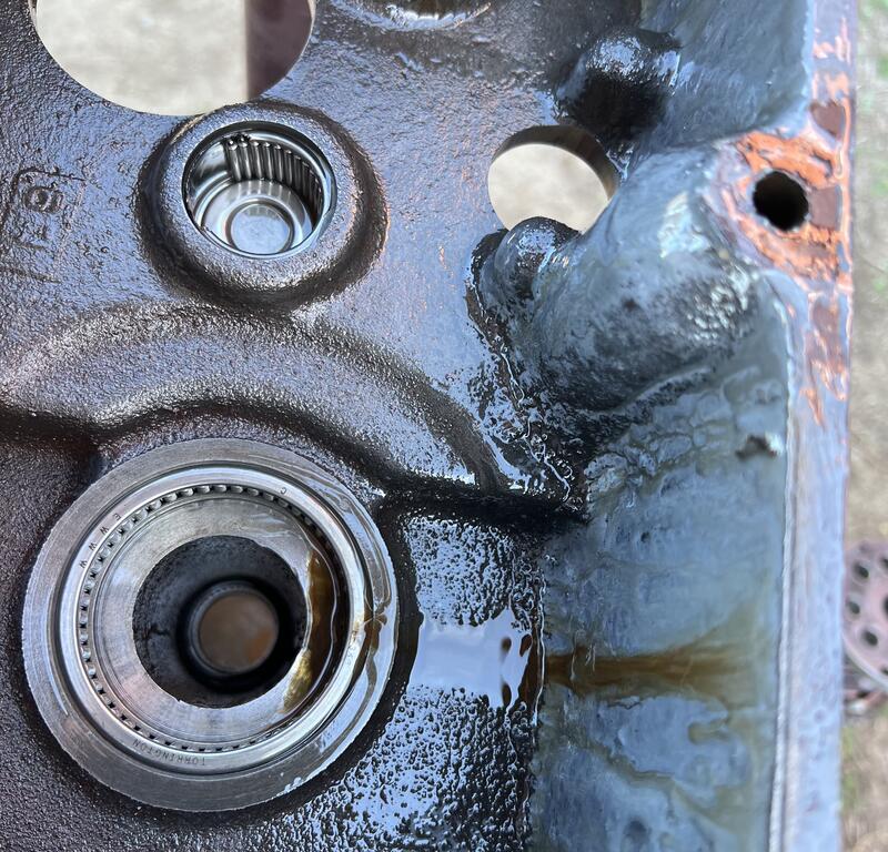

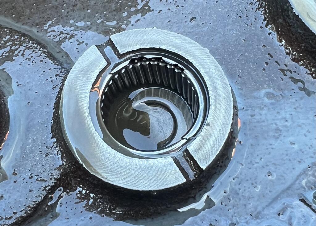

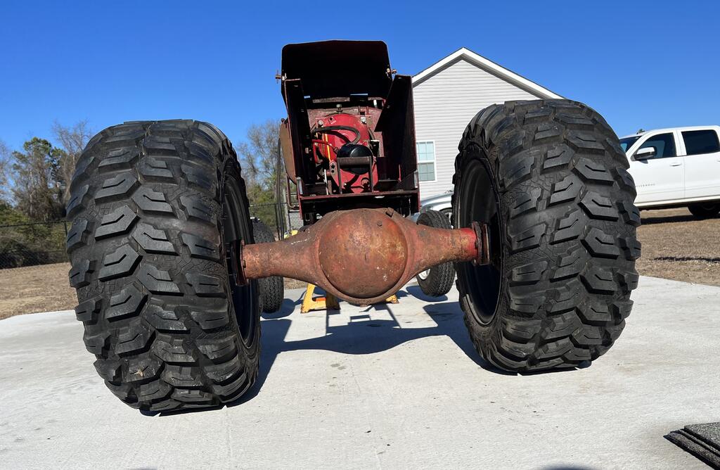

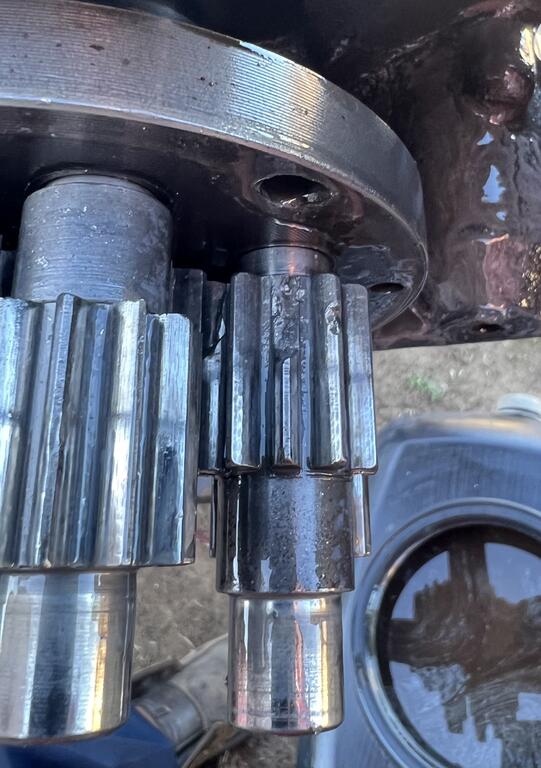

19richie66 17,951 #18354 Posted January 29, 2023 (edited) Tore the transaxle apart I took out of the D200. She wouldn’t have lasted long if she was able to move. She just sat and made noises. Now I see why. The bull gear bolts were loose and one axle side gear was missing some teeth also. I have another transaxle that needs attention but we are way past that point Edited January 29, 2023 by 19richie66 8 2 4 Share this post Link to post Share on other sites

ebinmaine 81,252 #18356 Posted January 29, 2023 8 hours ago, davem1111 said: bolts I had some that were a bit long but they made it easier to install the weights. I left em long and put cap acorn style nuts on the ends. 2 Share this post Link to post Share on other sites

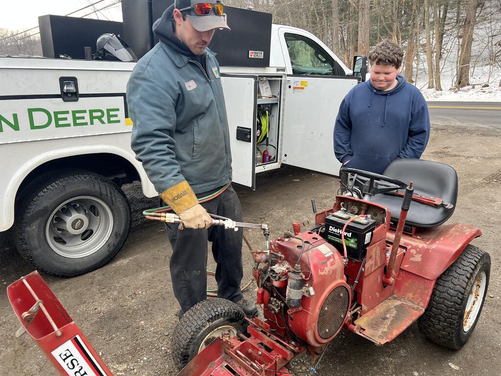

WHGuy413 2,859 #18357 Posted January 30, 2023 This happened today. @WheelHorse_Kid asked our neighbor Kyle for some help heating his engine block on the C-121 in hopes of getting the rusted pipe out. The exhaust has been broken since he got it. Now before anyone comments about Kyle’s work truck let me say this. The kid works for our local Deere dealer but collects wheel horses. I don’t have a set of torches at home and he happens to have them on his truck. We were unsuccessful today but already have the plan in motion to get the last of the pipe out of the block tomorrow with some cutting and a chisel. I added a photo of Kyle on my 753 driving with Aiden my oldest son. Kyle bought his first wheel horse from me when he was about 14 and has hung around here since. It created a friendship and we have gone on countless tractor runs, to dozens of shows together. Back before he started working we spent many long nights working on tractors in the garage. 1 12 1 Share this post Link to post Share on other sites
ebinmaine 81,252 #18358 Posted January 30, 2023 9 hours ago, WHGuy413 said: plan in motion to get the last of the pipe out of the block tomorrow with some cutting and a chisel. It can be done by cutting the pipe about ½" from the engine then making a slice through that pipe to the threads. One small shallow notch in the threads won't hurt anything. Use a good punch or thick chisel to curl the pipe inward on itself and it'll break the rust tension while turning out... 8 Share this post Link to post Share on other sites
WHGuy413 2,859 #18359 Posted January 30, 2023 44 minutes ago, ebinmaine said: It can be done by cutting the pipe about ½" from the engine then making a slice through that pipe to the threads. One small shallow notch in the threads won't hurt anything. Use a good punch or thick chisel to curl the pipe inward on itself and it'll break the rust tension while turning out... yup that’s the new plan. The last couple we just put a little heat to them and they popped out. 4 Share this post Link to post Share on other sites

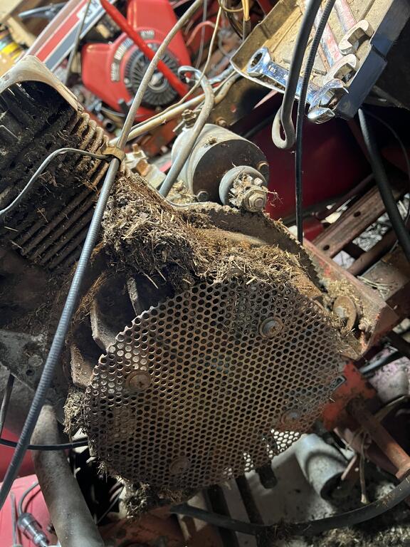

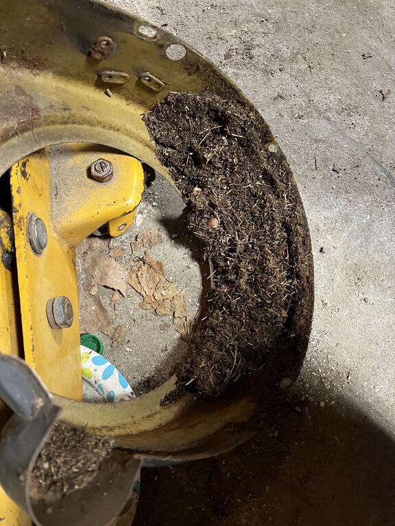

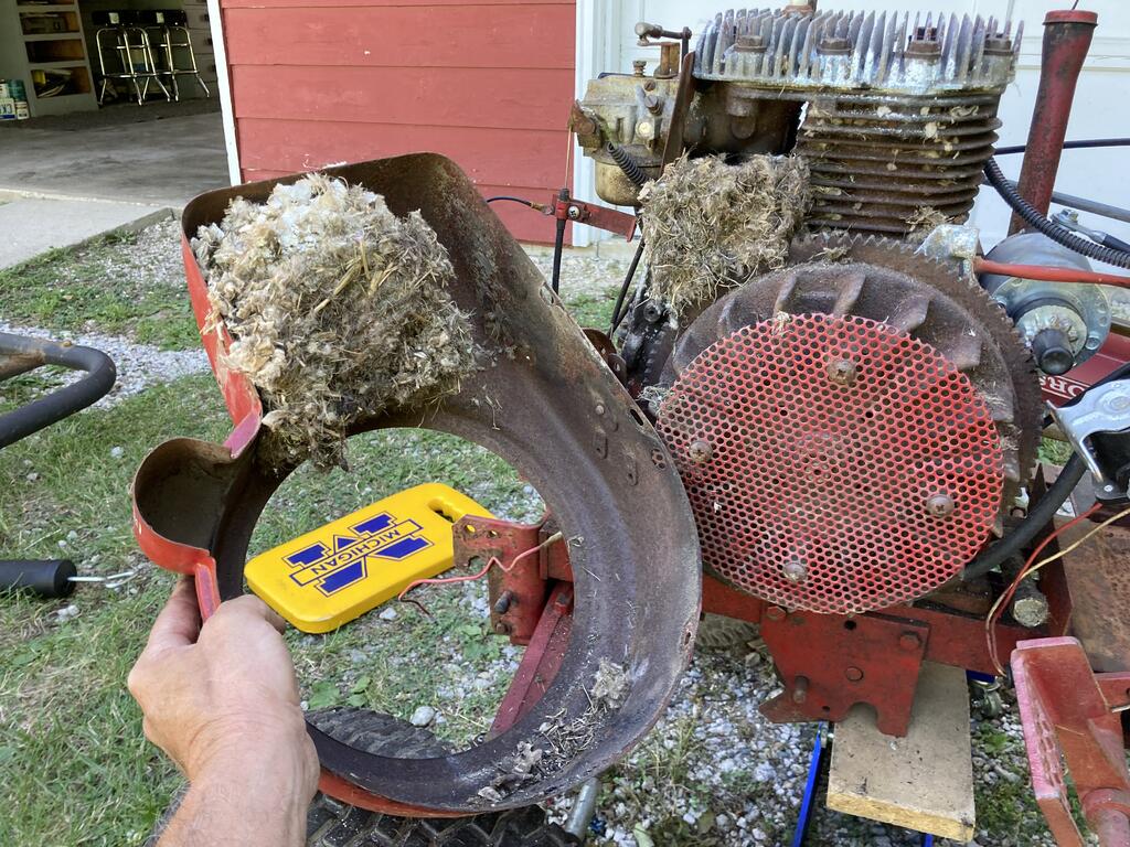

WHGuy413 2,859 #18363 Posted February 1, 2023 Got out early to bring “thing 2” to the dentist. When I got home I started moving things around in the garage so I could get my friends C-105 in there. It’s been sitting here forever and I’m finally sick of looking at it. Figured I would try starting it just for giggles. No turn over with the key switch but will spin over if I jump right to the starter. Holy mouse nest and grass clippings coming out of there. Bogged it down. I previously tried dragging it out of its spot with Aiden’s 856 and it wouldn’t drag due to being on 3 flats and sunk into the ground. Hooked it up to my tundra and had my daughter slowly back up and got it to where it was more or less lined up with the garage. The 856 handled it from there with no issues. Once I got it to the front of the garage I pushed it the rest of the way. Pulled the engine shroud off tonight. Started to get cold (really could use heat and a garage expansion) and called it a night. Officially 12 wheel horses in the 2 car garage. Starting to run out of room to work on things. I will be happy when I can take the 2 stage off again. 9 Share this post Link to post Share on other sites
Blasterdad 3,168 #18364 Posted February 1, 2023 9 minutes ago, WHGuy413 said: Not trying to start another mouse discussion but... of all the available space on a , why do they always always go for the flywheel.. Every time I have one of my shroud's off I want to epoxy razor blades to the fin's... 1 7 Share this post Link to post Share on other sites
kpinnc 19,100 #18365 Posted February 1, 2023 1 hour ago, WHGuy413 said: Holy mouse nest and grass clippings I bleeping hate mice! Cleaned out my garage over the weekend. Mice nests in every corner. How the heck do they get in? 2 Share this post Link to post Share on other sites
ebinmaine 81,252 #18366 Posted February 1, 2023 5 hours ago, kpinnc said: I bleeping hate mice! Cleaned out my garage over the weekend. Mice nests in every corner. How the heck do they get in? Magic portals 4 Share this post Link to post Share on other sites
