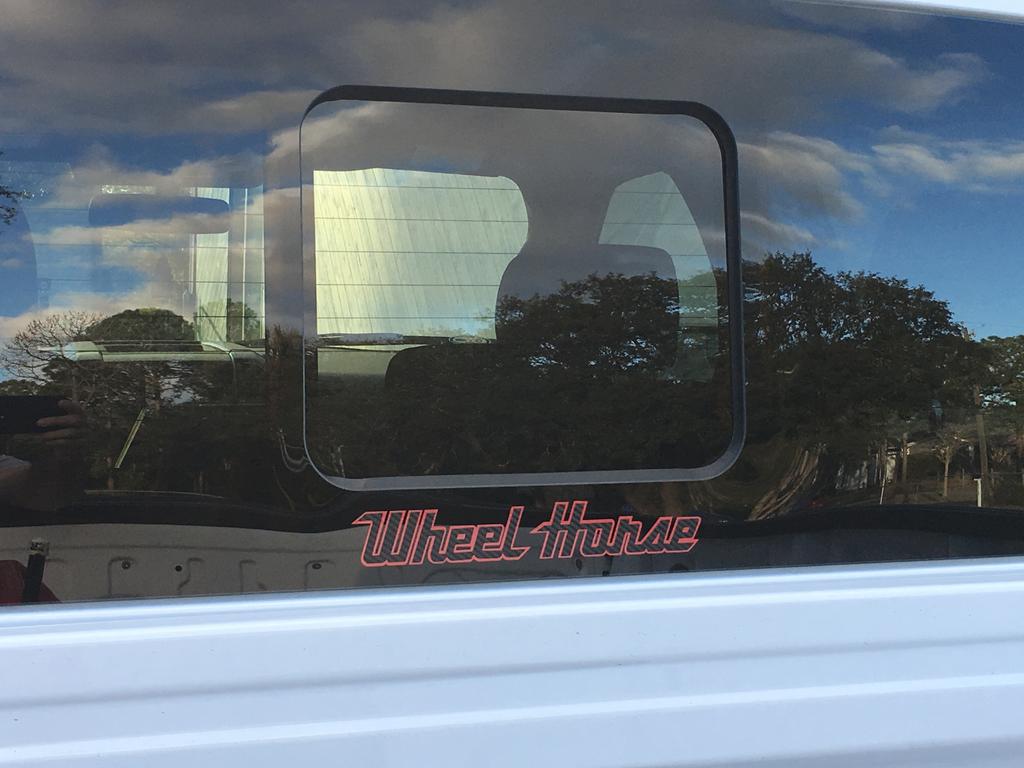

19richie66 17,932 #1806 Posted January 20, 2019 Not the horse, but the hauler........ Got bored and made some “carbon fiber” window decals. Now the hauler is official. 👍 7 7 1 Share this post Link to post Share on other sites

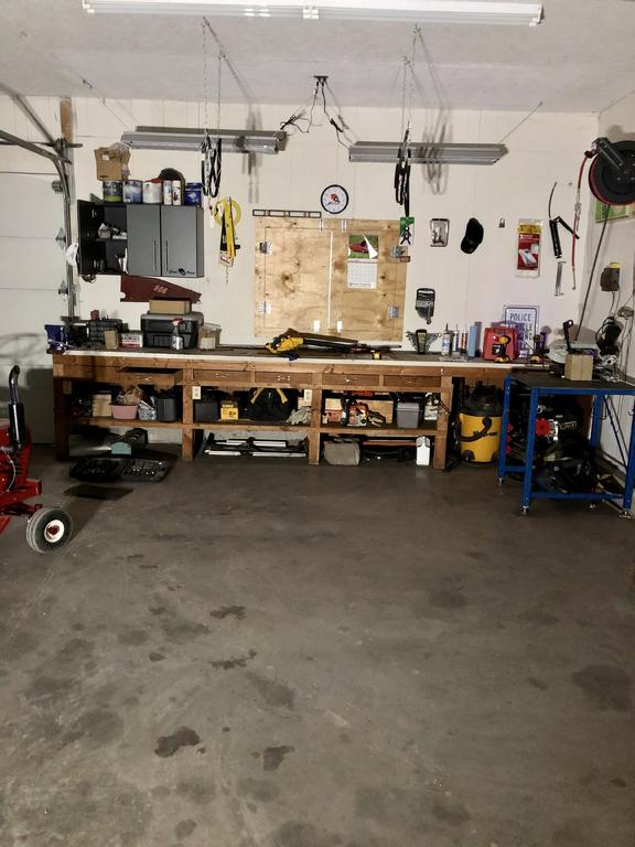

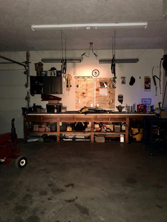

timo4352 148 #1811 Posted January 26, 2019 On 1/4/2019 at 4:18 PM, cschannuth said: Swapped out the old headlights in the 520H loader tractor for some LEDs. Here’s a before and after picture in my garage with the garage lights off completely. The before shot is actually darker than it shows because my camera tried to compensate for how dark the room actually was. The tractor still doesn’t light up the world but it’s much better than it was before. The wall is about 30’ away from the tractor. Just saw this post and those LEDs are pretty amazing! Can I ask which ones you used and where you got them? 1 Share this post Link to post Share on other sites

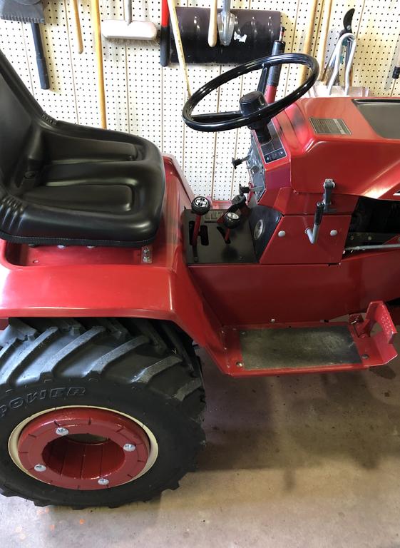

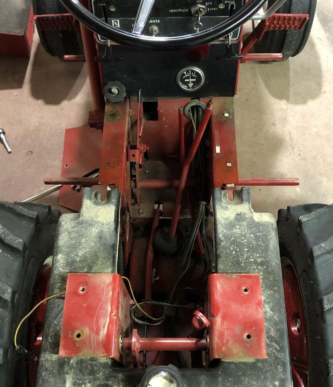

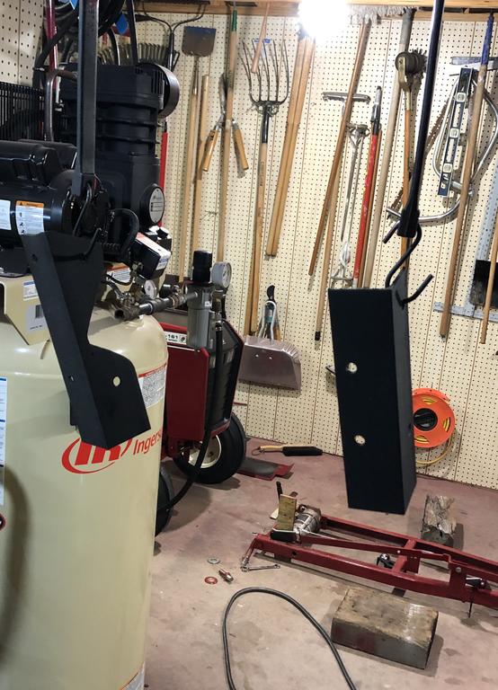

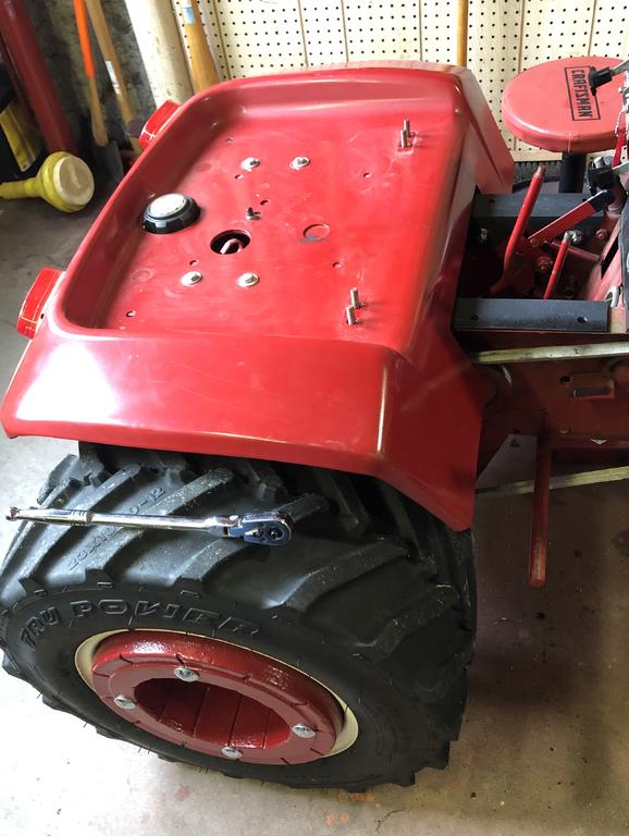

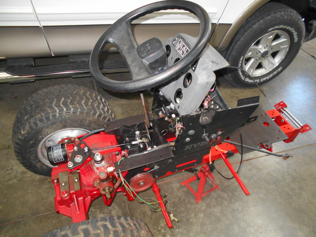

Lee1977 7,750 #1812 Posted January 26, 2019 (edited) I didn't do this all today, but I did take it off paint it and reinstall it. Bracing the transmission mount. I had already done this to my 312-8. This the C-120/180. The black reinforcing is 1/4" x 1 1/2" that I ground to fit in between the ridges on the transmission plate. I also used new bolts that were 1/4" longer. My neighbor did the welding as I can't see anything after the flash. I put these new seat on my tractor a while back, they sat up to straight. I had already put a 1/2" spacer under the hinges on the 312-8, so I made some for my C-120/180. Edited January 26, 2019 by Lee1977 6 4 Share this post Link to post Share on other sites
cschannuth 3,821 #1813 Posted January 26, 2019 2 hours ago, timo4352 said: Just saw this post and those LEDs are pretty amazing! Can I ask which ones you used and where you got them? They are the PAR 36 landscape lights from superbrightleds.com PAR36-CW9W-160: Cool White 1 Share this post Link to post Share on other sites

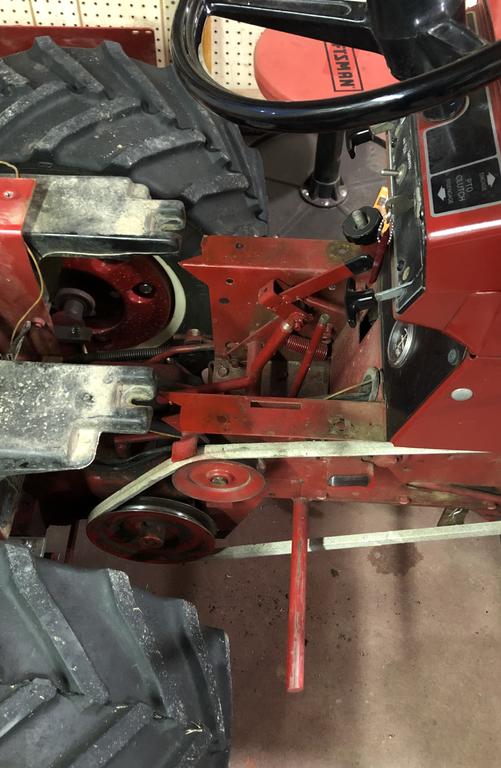

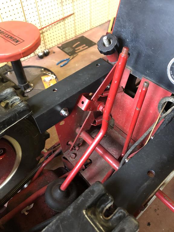

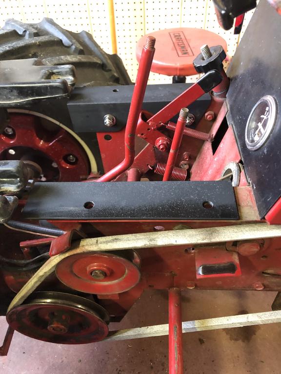

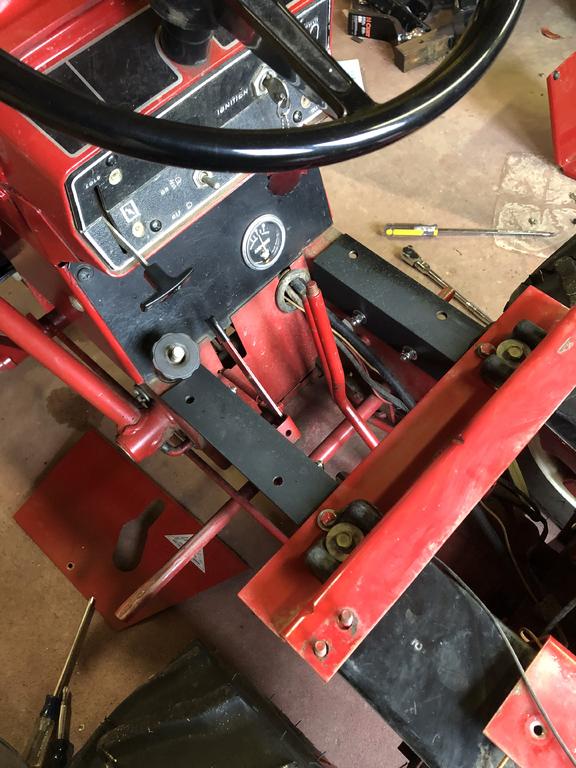

cschannuth 3,821 #1814 Posted January 27, 2019 The transmission tunnel angle broke where the front of the seat attaches. I was going to weld some angle from a bed frame but it was too small and I didn’t trust my welding so I bolted some 2x2x1/8 angle to the tunnel. It worked pretty well and it was very simple. I just had to notch the left side to miss the parking brake mechanism. 3 6 Share this post Link to post Share on other sites
cleat 9,261 #1815 Posted January 27, 2019 I did the exact same thing on my latest 520. I think it will actually be stronger than original. Cleat 2 Share this post Link to post Share on other sites
Lee1977 7,750 #1816 Posted January 27, 2019 (edited) 4 hours ago, cschannuth said: The transmission tunnel angle broke where the front of the seat attaches. I was going to weld some angle from a bed frame but it was too small and I didn’t trust my welding so I bolted some 2x2x1/8 angle to the tunnel. It worked pretty well and it was very simple. I just had to notch the left side to miss the parking brake mechanism. That, the upper steering support, and the tab on the axle pivot usually need fixing on these models. I didn't do the same, I only used 1/8" flat and used the 4 -1/4" shifter cover bolts to hold it in place. It's been that way about 3 years. Edited January 27, 2019 by Lee1977 1 Share this post Link to post Share on other sites

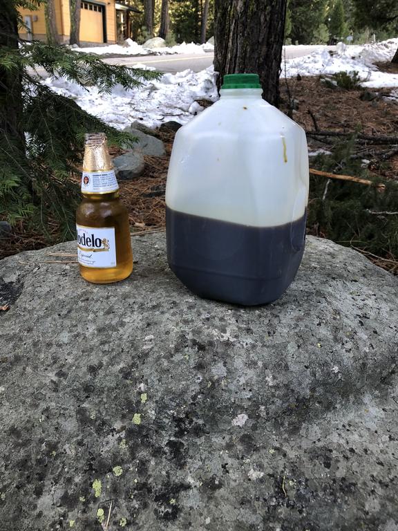

Jim anderson 77 #1819 Posted January 27, 2019 Flushed the gear oil today. I’m not sure how old the gunk in there was since the tractor is new to me. When I checked it I knew it was best to start with something fresh. Engine oil next on the list. The pic with the milk jug has a couple different liquids in it. On the left is my reward for the work. Unfortunately the milk jug isn’t the old gear oil, it is actually the diesel wash. Think I could have washed it twice, but I didn’t have enough diesel. The other pic is the gearbox gunk. 5 Share this post Link to post Share on other sites

cschannuth 3,821 #1821 Posted January 28, 2019 3 hours ago, Lee1977 said: That, the upper steering support, and the tab on the axle pivot usually need fixing on these models. I didn't do the same, I only used 1/8" flat and used the 4 -1/4" shifter cover bolts to hold it in place. It's been that way about 3 years. I probably would have done the same but I had the angle on hand and I'm pretty heavy so I wanted to make sure I never had to fix it again, LOL. Share this post Link to post Share on other sites

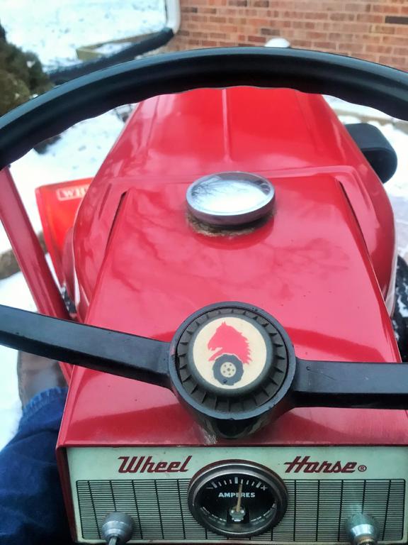

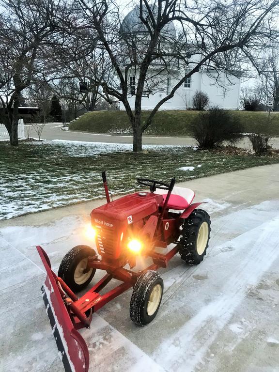

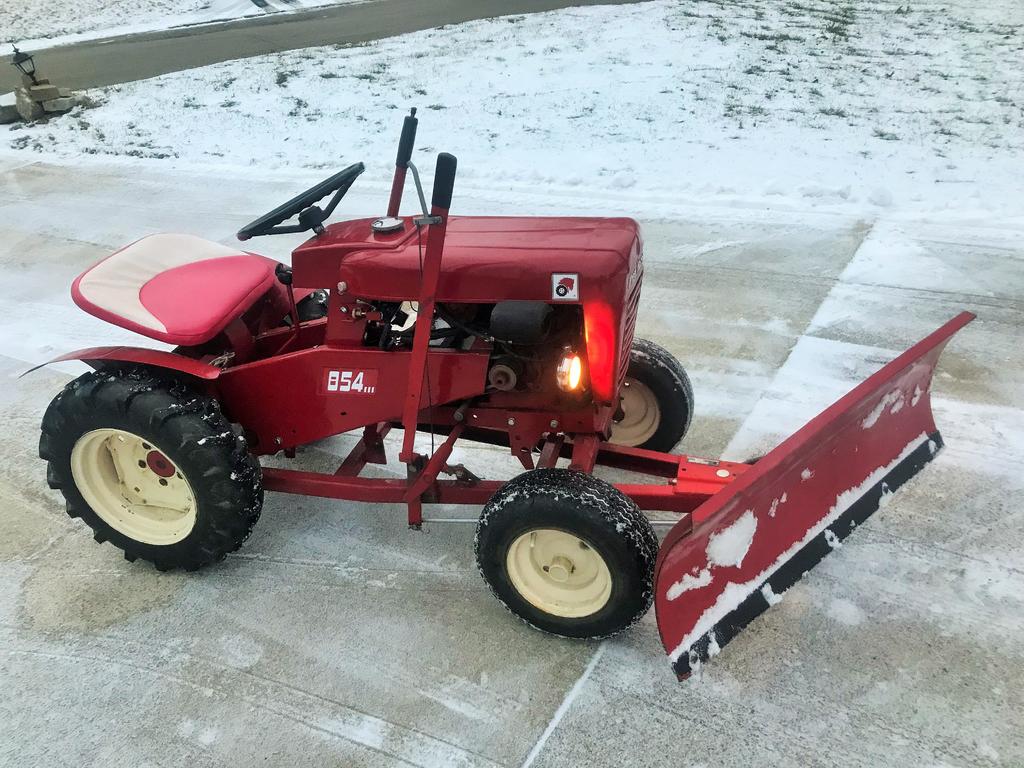

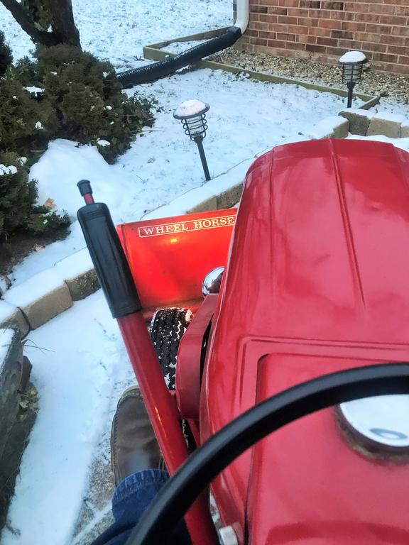

Lane Ranger 12,094 #1822 Posted January 28, 2019 (edited) Plowed the driveway and sidewalks this am with the 1964 Wheel Horse 854. Not much snow on the ground but I wanted to get it cleared off before the next round and the deep dive temperatures that are headed our way for the next three days! As ususal, the 854 did a nice job and I was back in the house after 15 minutes of seat time! The 1883 DePauw University McKim Observatory is my backdrop in the 5th photo. The Observatory is in the front of the left side of my yard between the Hawthorne trees. Some links to the History of the McKim Observatory: https://en.wikipedia.org/wiki/McKim_Observatory https://www.depauw.edu/academics/departments-programs/physics-astronomy/mckim-observatory/ Edited January 28, 2019 by Lane Ranger 1 5 Share this post Link to post Share on other sites

LengerichKA88 1,885 #1824 Posted January 28, 2019 1 hour ago, Lane Ranger said: Plowed the driveway and sidewalks this am with the 1964 Wheel Horse 854. Not much snow on the ground but I wanted to get it cleared off before the next round and the deep dive temperatures that are headed our way for the next three days! As ususal, the 854 did a nice job and I was back in the house after 15 minutes of seat time! The 1883 DePauw University McKim Observatory is my backdrop in the 5th photo. The Observatory is in the front of the left side of my yard between the Hawthorne trees. Some links to the History of the McKim Observatory: https://en.wikipedia.org/wiki/McKim_Observatory https://www.depauw.edu/academics/departments-programs/physics-astronomy/mckim-observatory/ That’s a beautiful machine! 1 Share this post Link to post Share on other sites
