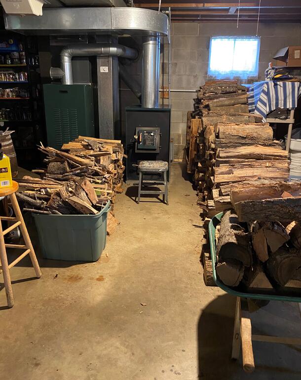

lynnmor 9,042 #18179 Posted January 6, 2023 (edited) 3 hours ago, Beap52 said: Hopefully your insurance agent rides on a green machine and doesn't peruse this Wheel Horse site! My insurance agent has a mowing service, just us peons mow and use little tractors. Do you think he would understand those of us that actually ? This is what working people do: Edited January 7, 2023 by lynnmor 8 Share this post Link to post Share on other sites

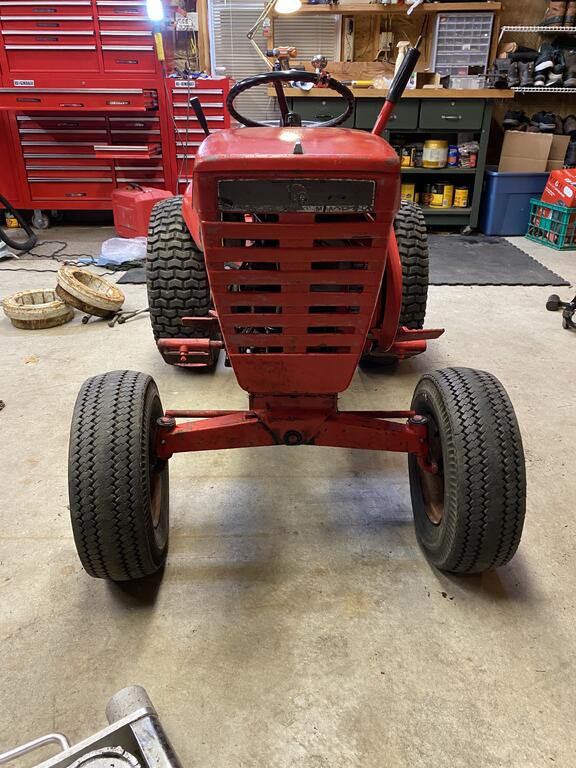

Stormin 9,988 #18183 Posted January 7, 2023 (edited) Fitted the engine back in the C-125 this afternoon. I have solid spacers instead of the rubber anti vibration ones. The original ones had succumbed to age. Now twice the front RH bolt has broken. Hi tensile cap heads. This made me think that the wobble plate, being of pressed steel, had a bit of a twist. Suspicion proved correct. Bolted down the front bolts and the plate had quite a gap on the LH side rear. The RH side rear also had a slight gap. Just thous'. Nothing to bother about. I found a washer that was a good fit in the LH gap. Cut a slot in it and inserted that. Hope fully no more broken bolts. Time will tell. Still got all the bits and bobs to refit. Edited January 7, 2023 by Stormin 3 Share this post Link to post Share on other sites

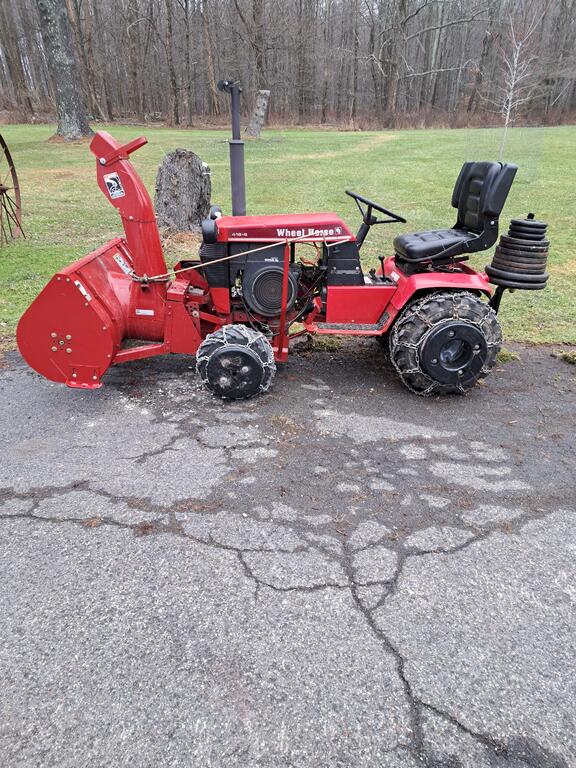

Panther416-8 342 #18186 Posted January 7, 2023 Put the front diamond pattern chains on 7 1 Share this post Link to post Share on other sites
ebinmaine 80,814 #18187 Posted January 7, 2023 19 minutes ago, Panther416-8 said: Put the front diamond pattern chains on Now that's a quit screwing around snow rig!! 3 1 Share this post Link to post Share on other sites
Panther416-8 342 #18188 Posted January 7, 2023 2 minutes ago, ebinmaine said: Now that's a quit screwing around snow rig!! Thanks eb, hoping the extra 300 lb on the rear will help with the wheel slip. Doesn't look like anything snow-wise to challenge it in the next two weeks. 3 Share this post Link to post Share on other sites
ebinmaine 80,814 #18189 Posted January 7, 2023 12 minutes ago, Panther416-8 said: Thanks eb, hoping the extra 300 lb on the rear will help with the wheel slip. Doesn't look like anything snow-wise to challenge it in the next two weeks. Oh yeah that'll help. Better to have. And not need. Share this post Link to post Share on other sites

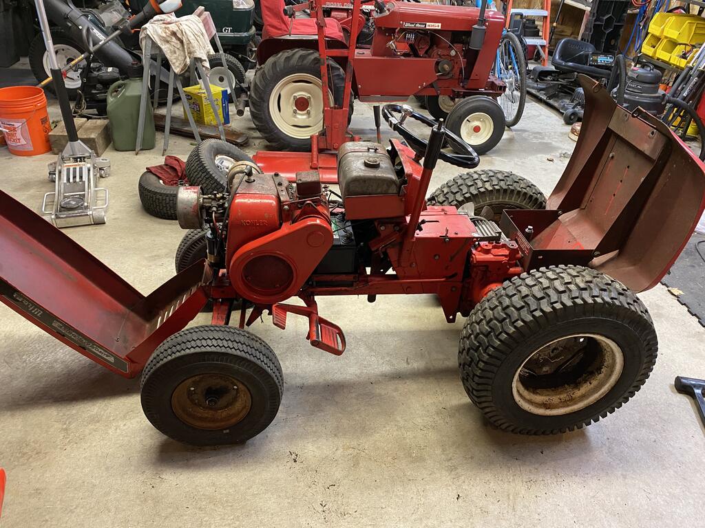

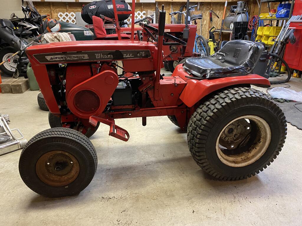

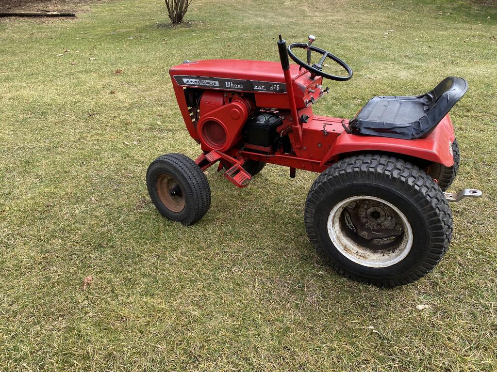

Sparky-(Admin) 26,422 #18190 Posted January 7, 2023 I need to thin the herd.. first to go was the 876 (it left today). Probably going to cut a couple more to get down to a more manageable number. 7 4 Share this post Link to post Share on other sites
Tonytoro416 1,387 #18191 Posted January 7, 2023 1 hour ago, Panther416-8 said: Put the front diamond pattern chains on I bet that thing doesn’t turn real easy when that blower is lifted up. Surely not? Share this post Link to post Share on other sites
WHGuy413 2,859 #18192 Posted January 7, 2023 43 minutes ago, Sparky said: I need to thin the herd.. first to go was the 876 (it left today). Probably going to cut a couple more to get down to a more manageable number. What a beautiful tractor. I’m hoping we find a short frame hydro for our collection some day. 1 1 Share this post Link to post Share on other sites
SylvanLakeWH 32,657 #18193 Posted January 7, 2023 43 minutes ago, Sparky said: I need to thin the herd.. Huh??? What??? Crazy talk... 3 Share this post Link to post Share on other sites

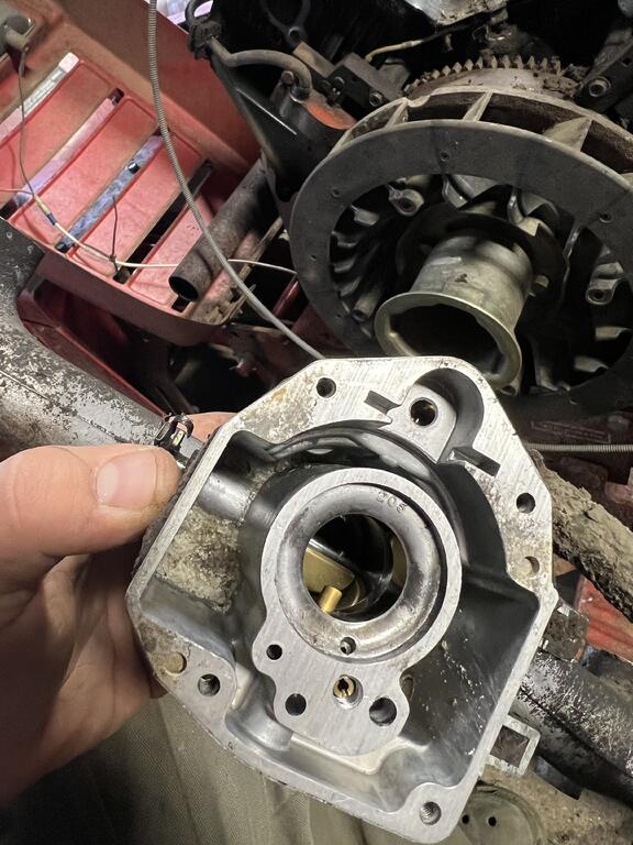

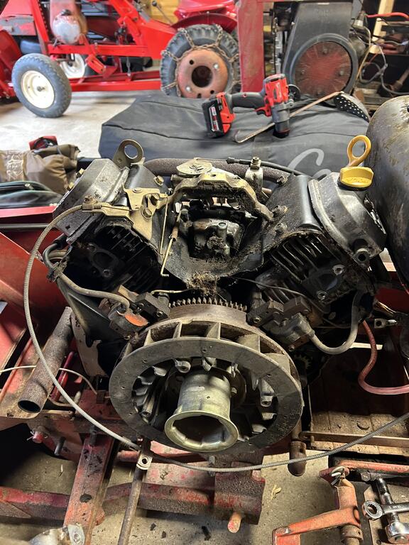

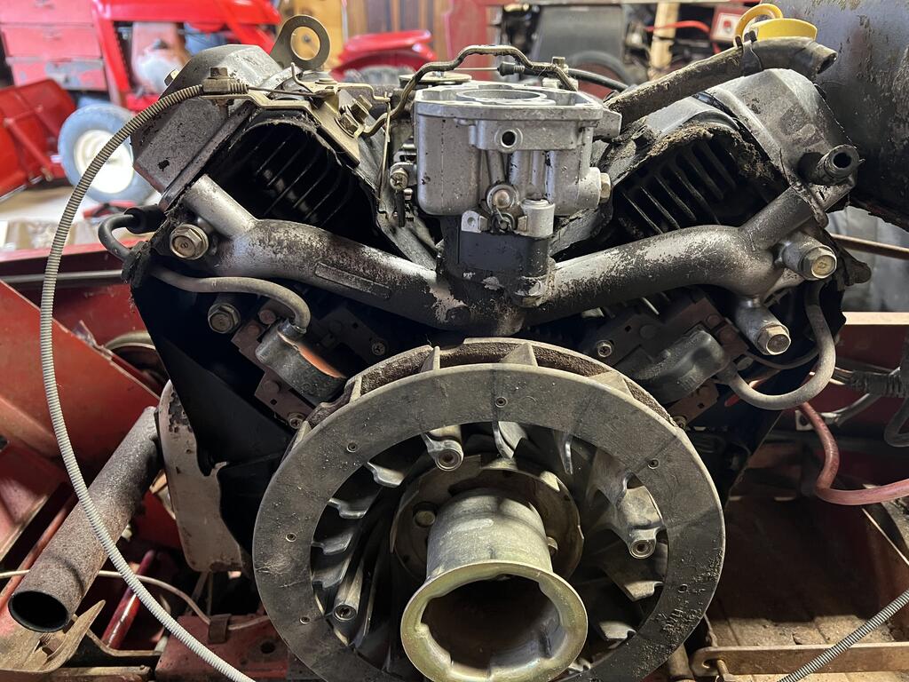

WHGuy413 2,859 #18194 Posted January 7, 2023 (edited) Spent some time in the garage this afternoon tearing into the carb on my Bronco 14. I ran it out of gas recently and it started running bad after that. I plan on using it for snow blowing so kinda need it running. I’ve opened the carb and successfully cleaned it from the top before. But after seeing how much ethanol jelly was on the inside I decided I better pull the engine shroud off and pull the whole intake off and clean it out the right way. Cleaned some of the gunk out of the cooling fins while I was in there and replaced the fuel lines and fuel filter. Put it back together and once it got gas it fired up and ran great. Even tho Alex is at his moms this weekend I kept him in the loop with pictures and video. Now to do tire chains and fix the flat front tire. https://youtube.com/shorts/6Hx7S6K7RNg?feature=share I also used Aiden’s 856 to bring in a small load of fire wood. That thing is one smooth running tractor. Edited January 7, 2023 by WHGuy413 3 1 Share this post Link to post Share on other sites
ebinmaine 80,814 #18195 Posted January 7, 2023 2 minutes ago, WHGuy413 said: ethanol jelly Matt you'd likely be ahead of the game to make a run to NH right up 91 to Hinsdale to get some non e 2 Share this post Link to post Share on other sites
WHGuy413 2,859 #18196 Posted January 7, 2023 2 minutes ago, ebinmaine said: Matt you'd likely be ahead of the game to make a run to NH right up 91 to Hinsdale to get some non e I definitely would. We do that at work with our chainsaws and stuff. Another option is I could just remember to actually treat my gas or not let tractors sit so long lol. Share this post Link to post Share on other sites
Sparky-(Admin) 26,422 #18197 Posted January 7, 2023 12 minutes ago, SylvanLakeWH said: Huh??? What??? Crazy talk... I know! In my case I like to have 6 Wheel Horses here. Easy to store and keep track of maintenance. I somehow have crept up to 9 or 10. So three need to go. It’s not easy cutting them free I’ll admit. 2 Share this post Link to post Share on other sites
ebinmaine 80,814 #18198 Posted January 7, 2023 6 minutes ago, WHGuy413 said: Another option is I could just remember to actually treat my gas or not let tractors sit so long lol. Non ethanol gas is the ONLY option to keep the ethanol pearls out. 3 Share this post Link to post Share on other sites
Sparky-(Admin) 26,422 #18199 Posted January 7, 2023 8 minutes ago, ebinmaine said: Non ethanol gas is the ONLY option to keep the ethanol pearls out. I agree! I can’t prove it but I’m sure non-ethanol has a longer shelf life than treated ethanol fuel. 1 Share this post Link to post Share on other sites
WHGuy413 2,859 #18200 Posted January 7, 2023 9 minutes ago, Sparky said: I agree! I can’t prove it but I’m sure non-ethanol has a longer shelf life than treated ethanol fuel. One of these days I will remember to take my gas can with me 1 2 Share this post Link to post Share on other sites
