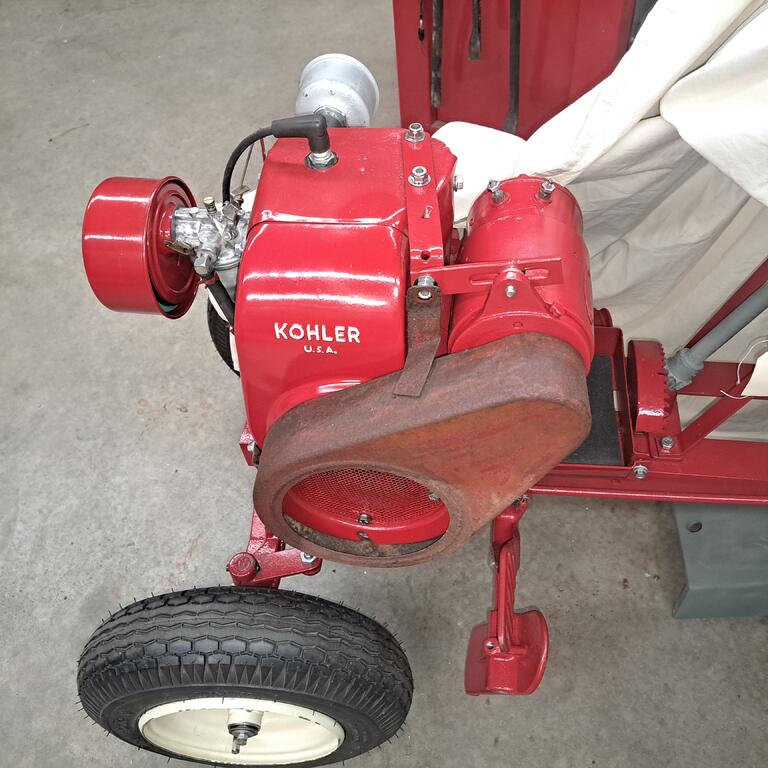

WHX?? 58,254 #18026 Posted December 18, 2022 (edited) 9 minutes ago, squonk said: the few people that are actually smarter than me! Ain't that about 15/16 of the world's population!?!? Now where's my belt guard Dan? Edited December 18, 2022 by WHX?? 10 Share this post Link to post Share on other sites
Achto 32,816 #18027 Posted December 19, 2022 1 hour ago, WHX?? said: Now where's my belt guard Dan? Belt guard? Belt guard? Ummm. Oh ya, it's safely resting in a nice warm dry place inside my house. It might could find it's way back to you for Christmas. 3 2 Share this post Link to post Share on other sites

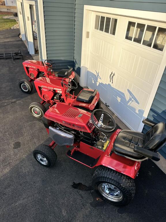

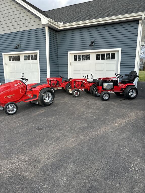

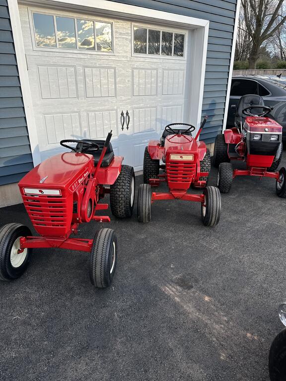

whtractors24 3,571 #18028 Posted December 19, 2022 Started to winterize some machines . 2 5 Share this post Link to post Share on other sites

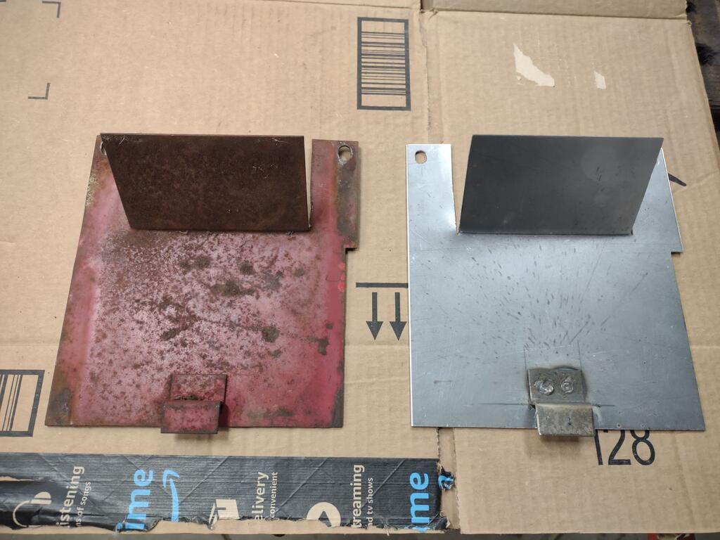

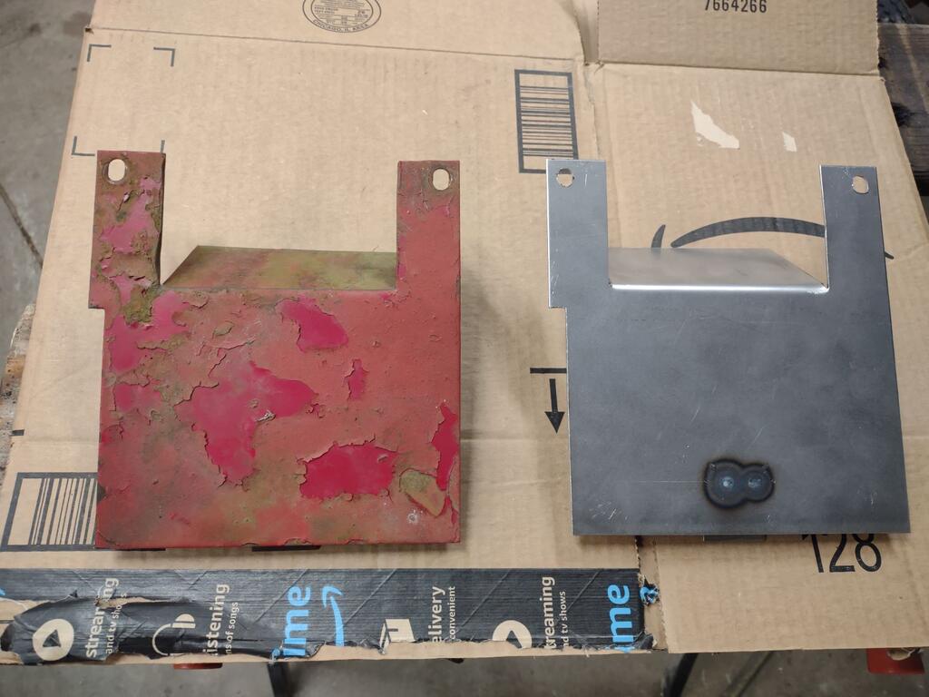

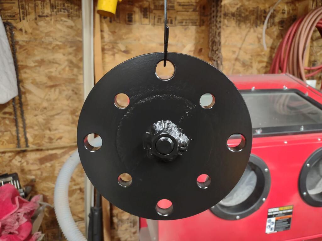

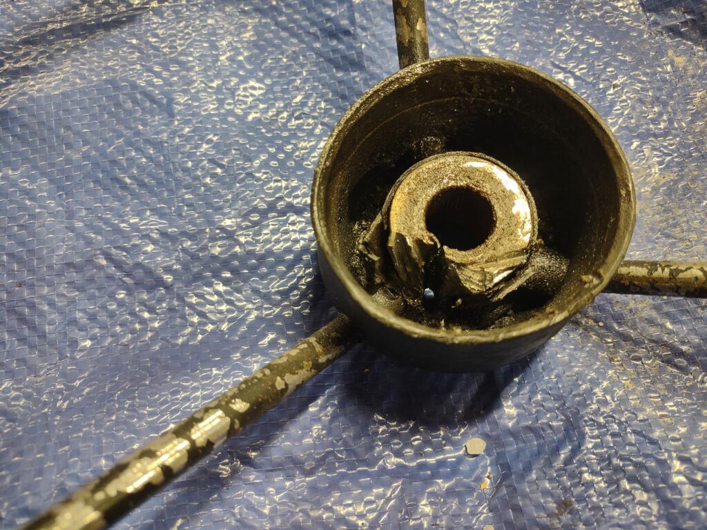

Achto 32,816 #18029 Posted December 19, 2022 I spent some time doing some fab work today. @WHX?? borrowed me a part so that I could copy it to replace a missing part on my tractor. A couple of pics of the new part next to the one that I copied. Made a puller for removing 4 bolt hubs. Destroyed a POS steering wheel in order to remove it from the tractor. 6 6 Share this post Link to post Share on other sites
WHX?? 58,254 #18030 Posted December 19, 2022 22 minutes ago, Achto said: Belt guard? Belt guard? Ummm. Oh ya, it's safely resting in a nice warm dry place inside my house. It might could find it's way back to you for Christmas. No worries... I have a finely patinaed one to use.. Will look nice with shiney red... Old and new??? 3 3 4 Share this post Link to post Share on other sites

WHX?? 58,254 #18032 Posted December 19, 2022 6 minutes ago, Achto said: Made a puller for removing 4 bolt hubs. So you took a stab at them hubs Dan? 2 Share this post Link to post Share on other sites
Achto 32,816 #18033 Posted December 19, 2022 Just now, WHX?? said: So you took a stab at them hubs Dan? Not yet, waiting for some 9/16 fine thread bolts that I ordered. None to be found locally. 1 Share this post Link to post Share on other sites
Robaroni 86 #18034 Posted December 19, 2022 11 hours ago, whtractors24 said: Started to winterize some machines . Nice! 11 hours ago, whtractors24 said: 1 Share this post Link to post Share on other sites
Tonytoro416 1,387 #18035 Posted December 19, 2022 I’d say if you just now had to start winterizing your in a hell of a lot better shape than me weather wise lol. Awesome looking rigs you have 3 Share this post Link to post Share on other sites

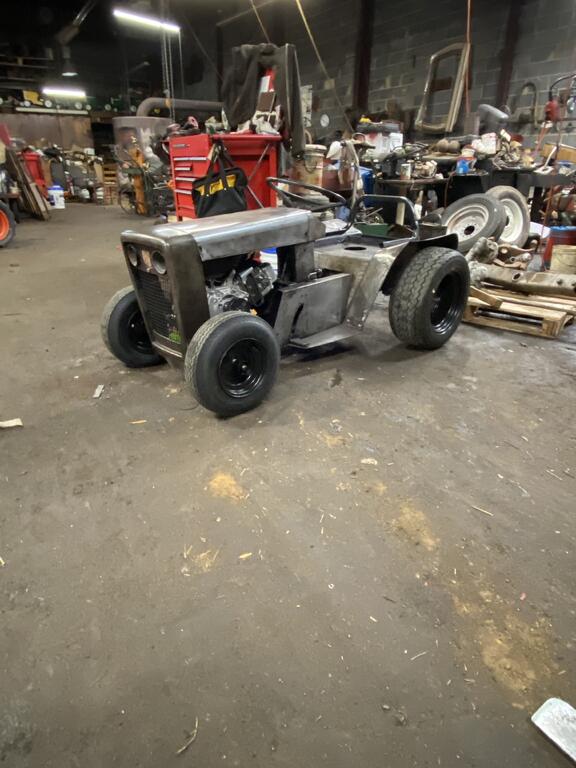

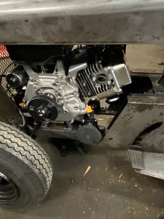

Wheelhorsenut#1 103 #18038 Posted December 19, 2022 It’s getting close to being ready to ride I got the brake mount welded in and the master cylinder hooked up. 3 7 Share this post Link to post Share on other sites
953 nut 69,645 #18039 Posted December 20, 2022 51 minutes ago, Wheelhorsenut#1 said: getting close to being ready to ride I got the brake mount welded in and the master cylinder hooked up. Have you done a build thread on the 953/1054. Looks like a great custom build. We would appreciate any pictures and information you would care to share with us. 1 1 Share this post Link to post Share on other sites

Snoopy11 5,731 #18041 Posted December 20, 2022 10 minutes ago, 953 nut said: Have you done a build thread on the 953/1054 Doesn't appear to be a build thread... I'm very curious about the engine and setup... da's right up my alley! Don Share this post Link to post Share on other sites

Wheelhorsenut#1 103 #18044 Posted December 20, 2022 30 minutes ago, 953 nut said: Have you done a build thread on the 953/1054. Looks like a great custom build. We would appreciate any pictures and information you would care to share with us. I’m not 100% sure how to make a build thread 1 Share this post Link to post Share on other sites
Wheelhorsenut#1 103 #18045 Posted December 20, 2022 20 minutes ago, Snoopy11 said: Doesn't appear to be a build thread... I'm very curious about the engine and setup... da's right up my alley! Don It’s got a stock 420 predator engine right now but it will receive a cam, a billet flywheel, a billet connecting rod, a slide carb, and a custom made header. It is chain drive with a jack shaft right behind the engine and a live axle in the back. 2 6 Share this post Link to post Share on other sites

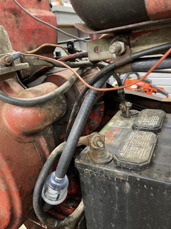

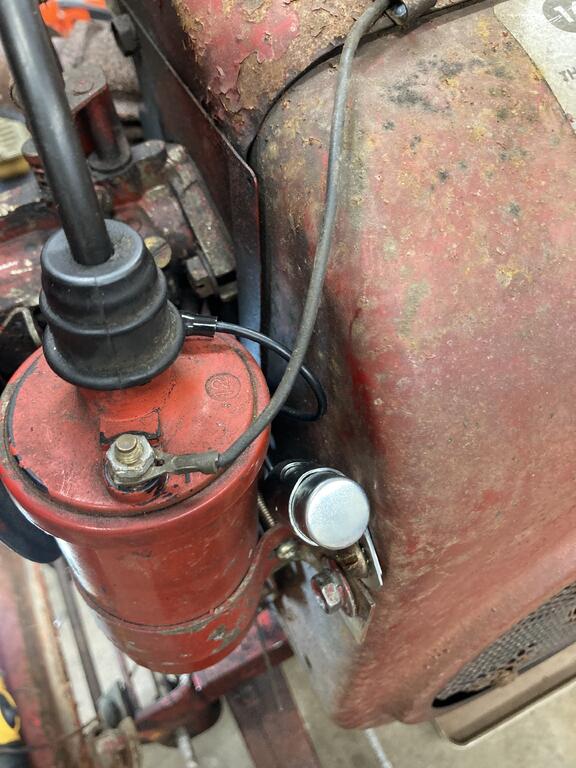

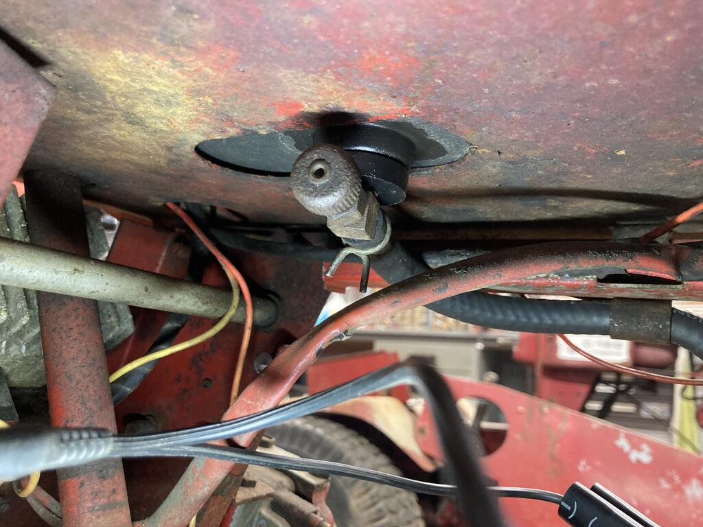

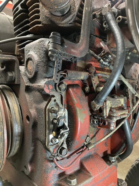

Blasterdad 3,168 #18046 Posted December 20, 2022 The C-160 got some love tonight, fresh Rotella T6, cleaned out gas tank, new grommet, new O ring in shut off valve, all new fuel lines, new fuel filter, new points & condensor. The C-161 with the snow blower is ready so the 160 will be the plow tractor this winter. The weather man is saying possible blizzard conditions Friday & Saturday here, getting the team ready... 9 2 Share this post Link to post Share on other sites

peter lena 10,080 #18050 Posted December 23, 2022 @Blasterdad good going on that , not to pick , but perfect spot for a fuel check valve on that fuel pump to carb run , shorten the hose make it straighter , straighten that check valve will hold your next start in view. my 3 engines have it , it works , consistently, have a good Christmas , pete , evil energy 5/16 " fuel check valves , install vertically , arrow facing up to carb , holds fuel charge from pump to carb , no drain back , use just a tiny amount of dielectric grease on barb ends , makes connections smooth / easy . pete 2 Share this post Link to post Share on other sites
