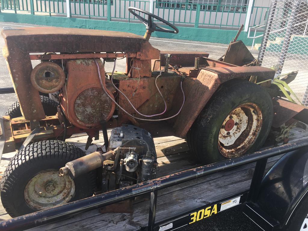

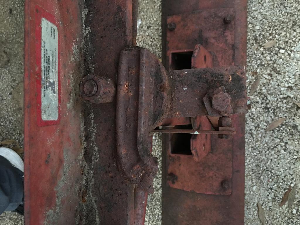

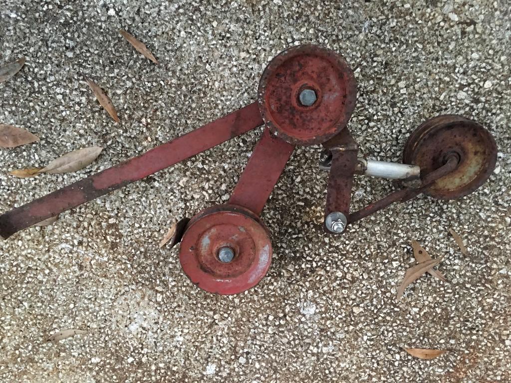

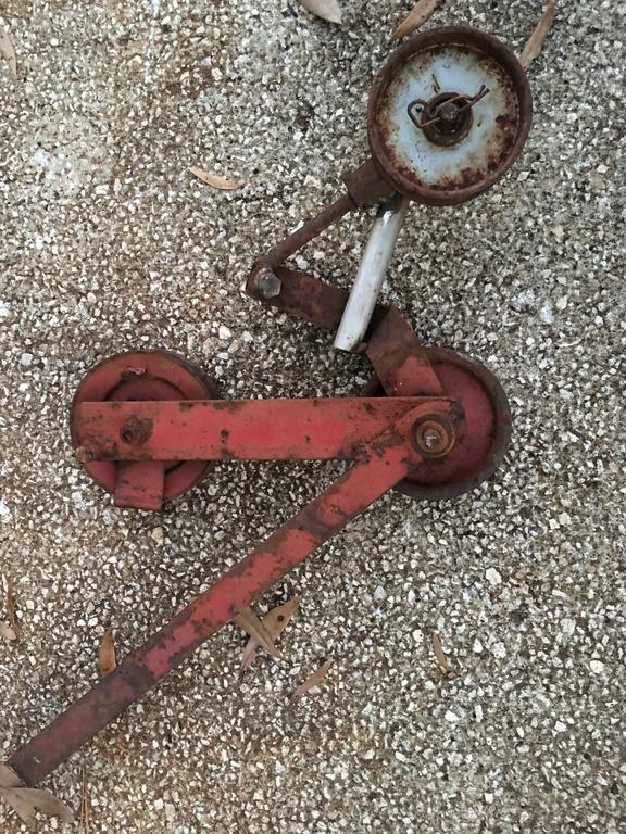

19richie66 17,937 #1776 Posted January 14, 2019 “HANDS UP AND STEP AWAY FROM THE WELDER” I am not the greatest welder but good grief people. I tried disassembly of the gt14 rototiller I got with “Rusty” the gt14. Someone had “welded” angle iron to the main frame and I couldn’t get it apart without cutting them off. Not to mention everything is rusted together and the gearbox is shot. The bearings wore out and the shaft ate into the housing. So scrap one gt14 rototiller! I did keep the three point mount and brackets for a rear blade I can make. Also the mid mount I bought must have been welded by Ray Charles fabricating. Half a C clamp welded to a pivoting bracket with a crank handle and u-joint hooked to the c-clamp. Some people. Good idea but poor excecution. Had to cut all that off and now have to cut off the plate they welded on to make it pivot(so you can grade a ditch at a angle I guess). Got a good deal but I’m having to work for it.👍 3 5 1 Share this post Link to post Share on other sites

WHX?? 58,307 #1778 Posted January 15, 2019 Hilarious Ritchie... thems what we call "farmer welds" ! Now you know why I pay Dan @Achto to be my welder friend! 7 Share this post Link to post Share on other sites

pfrederi 21,240 #1780 Posted January 15, 2019 Let me be clear I have never had a GT 14 tiller or blade. Those are not my welds (even if they look a lot like mine) 1 5 Share this post Link to post Share on other sites
Sarge 3,473 #1781 Posted January 16, 2019 Must have been the same one that welded the scab parts on my D180 front blade - except in that case he used SuperMissle 100 rod, which is easily about the hardest rod in the world to grind or cut off later. I ended up making all new parts for it out of heavier steel and used low-hydrogen 7018 - nice and strong, yet ductile. I do a lot of stick work at my job but easily get out of practice these days - it is a skill worth keeping or learning how to do correctly. No excuse for hack work, especially if it is something that can fail and cause any sort of injury. It is not that tough to learn - beg, borrow or trade out work for someone to teach you at least the basics - you'll never regret it. Sarge 5 Share this post Link to post Share on other sites

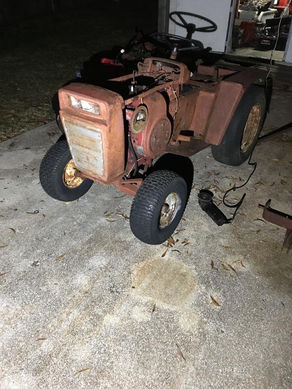

19richie66 17,937 #1787 Posted January 18, 2019 (edited) Well I still don’t know what the future holds for “Rusty” but last night I cut the butchered hood and hinge off it and put the right grille back on it. At least it looks more like a gt14. The engine is froze up but I’m not sure if it is a valve hung up or if the piston is locked tight. Have to pull the head. May stuff the magnum 12 I have in it just to test the hydro. If thats good, there might be hope for Rusty yet.👍 Definitely can use it for patina practice. Edited January 18, 2019 by 19richie66 2 3 Share this post Link to post Share on other sites
