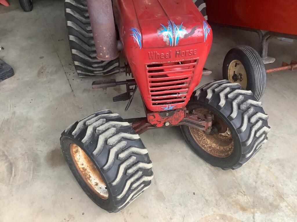

Panther416-8 342 #17929 Posted December 7, 2022 On 12/5/2022 at 8:33 PM, Pullstart said: The only thing I can add, is to turn your front tires around “backwards” for snow use. When you have them in “forward” arrangement, they turn into skids. Backwards, they actually grab and turn. Thanks Pullstart, I've seen this mentioned before. I was planning on throwing some chains on the front tires which should increase traction even with the tread forward as it is now...at least that's the thought. 1 Share this post Link to post Share on other sites
ebinmaine 80,812 #17930 Posted December 7, 2022 4 hours ago, Panther416-8 said: Thanks Pullstart, I've seen this mentioned before. I was planning on throwing some chains on the front tires which should increase traction even with the tread forward as it is now...at least that's the thought. Round roller or traditional? Make sure the front chains are certainly on the tight side. It'll be easy to throw one with all the weight. 2 Share this post Link to post Share on other sites
Panther416-8 342 #17931 Posted December 7, 2022 8 hours ago, ebinmaine said: Round roller or traditional? Make sure the front chains are certainly on the tight side. It'll be easy to throw one with all the weight. Was planning on going with traditional 2 link, either regular twist or v- bar. 1 Share this post Link to post Share on other sites

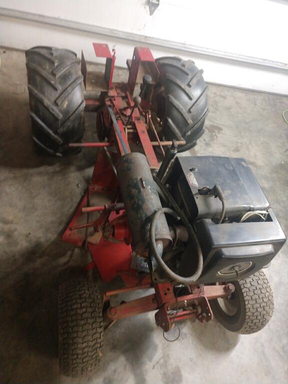

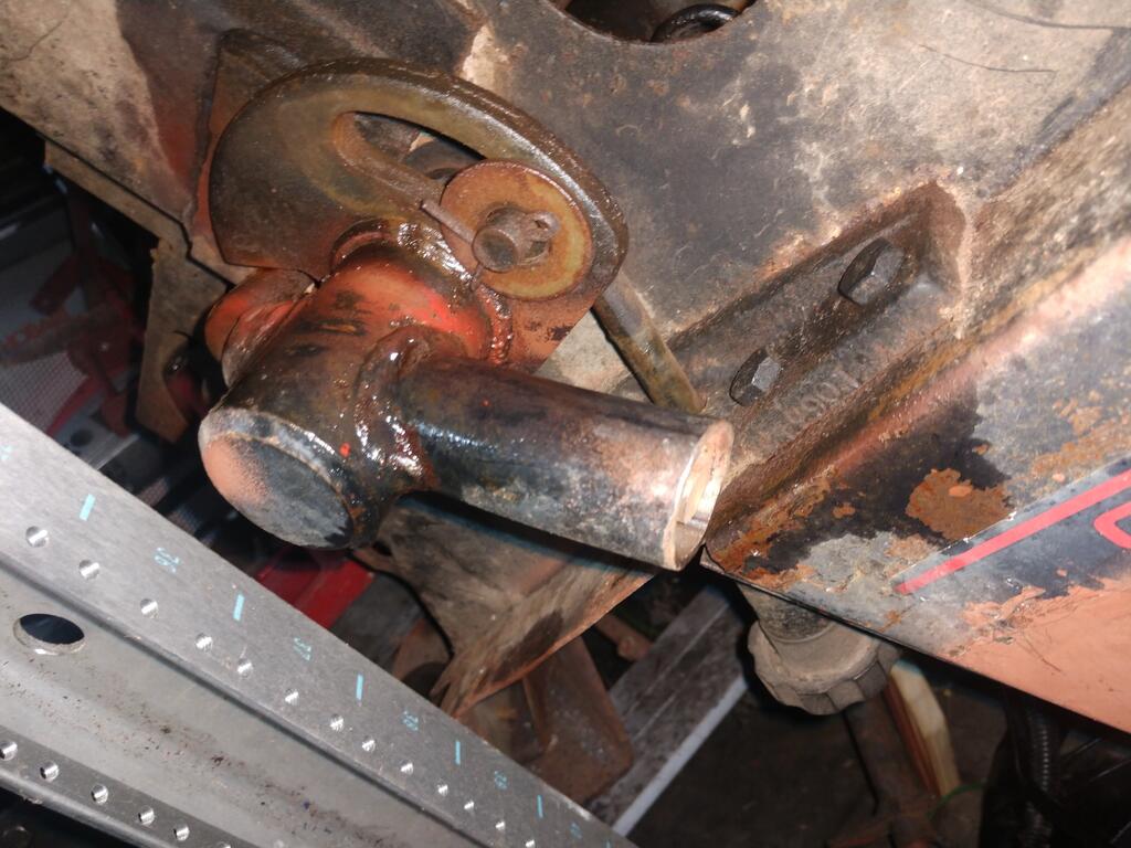

kpinnc 18,995 #17932 Posted December 8, 2022 I've been working on a friend's 312-8. It never had a lift arm on it since he got it. Some dingbat sawed it off and placed a rubber cap over it. Getting the rockshaft out is gonna be fun... Otherwise it's pretty solid. Just needs a few little things. Shifter pivot pin was broken, electrical was long overdue some attention. 7 1 2 Share this post Link to post Share on other sites
Rick3478 469 #17933 Posted December 8, 2022 11 hours ago, kpinnc said: I've been working on a friend's 312-8. It never had a lift arm on it since he got it. Some dingbat sawed it off and placed a rubber cap over it. Getting the rockshaft out is gonna be fun... What do you suppose was the theory behind that? Was he going to convert to hydraulic or electric lift? Or just didn't think the tractor would ever need to use an implement? 1 Share this post Link to post Share on other sites
kpinnc 18,995 #17934 Posted December 8, 2022 2 hours ago, Rick3478 said: Or just didn't think the tractor would ever need to use an implement? My friend uses a Ford dozer blade, that fits perfectly in the belly hitch. It has a long "arm" on the same side as where the WH lift arm should be. The PO had fabbed a winch for it mounted to the center pedestal and deleted the factory arm. Not sure if the arm went first or was cut to make room for the winch. I'm guessing the spring in the release broke or something similar. The whole assembly is relatively rust free and moves without binding. Really makes no sense to me. I have another lift arm, and I'm gonna weld a small tab for a link to his blade. It will bring it back as close as can be to factory. 4 Share this post Link to post Share on other sites

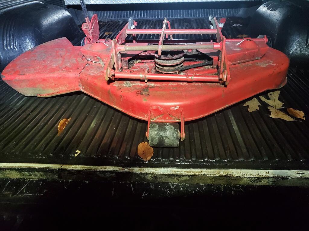

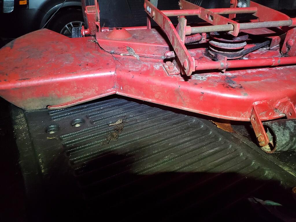

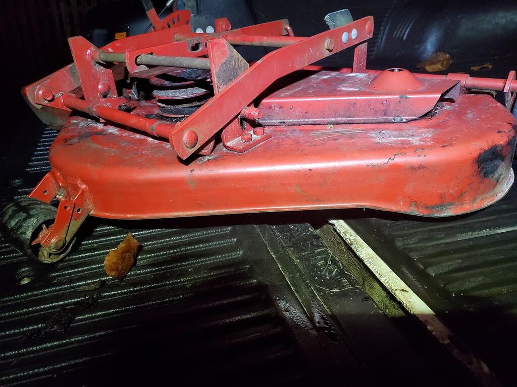

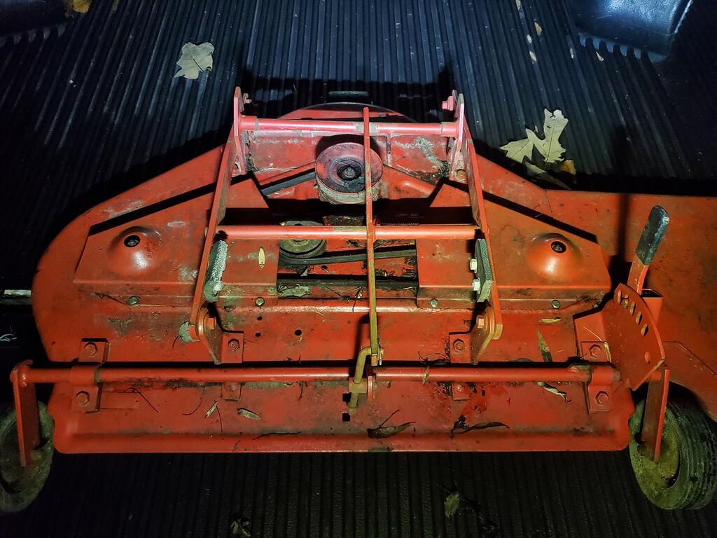

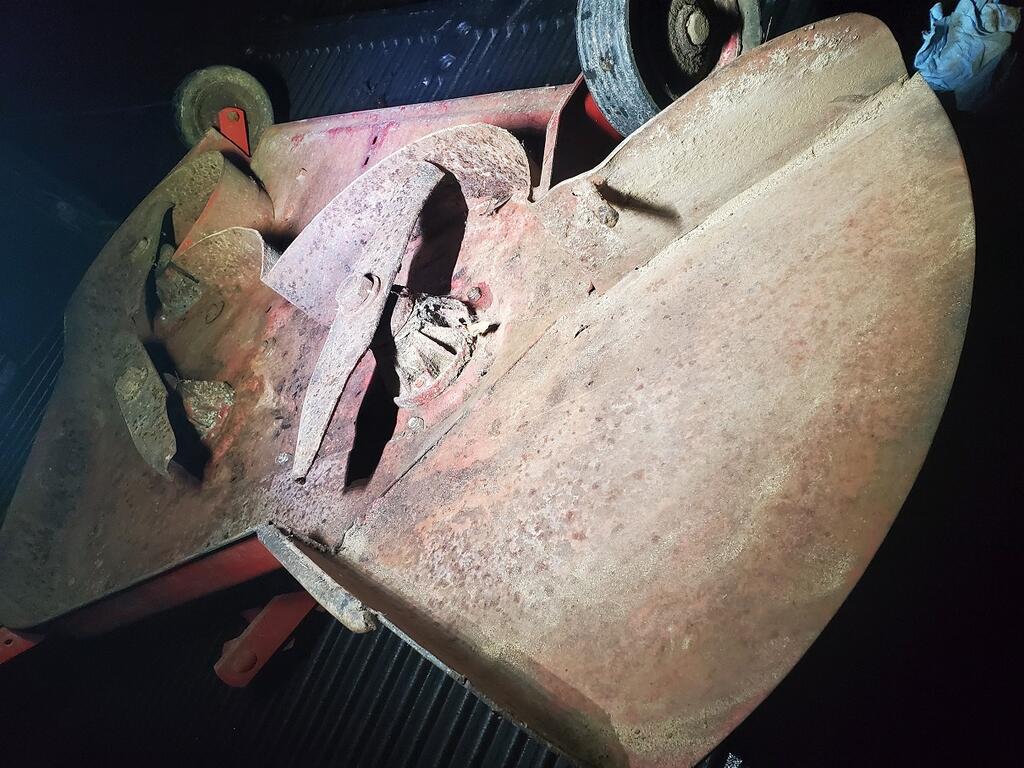

GAJoe 852 #17936 Posted December 9, 2022 (edited) Not what I did to it, but what I got for it. My 1533's came in so we can get the C-160 tranny back together. And I picked up a nice 36" mower deck for it. The 48" that came on it was patched in a couple places, rusted through in the corner and bent up some from a rough previous life. I planned on using it as is until something good came along. Well it came along. The new 36" looks as good as any that I have found of this vintage. I'll take it apart and give it a deep cleaning, geese the spindles, sharpen / balance the blades, and get a new belt on it. There is a small amount of surface rust on the underside that I will treat with Rust Reformer. Does the undercoating that I've seen some people do really help? Edited December 9, 2022 by GAJoe 8 4 Share this post Link to post Share on other sites

Tonytoro416 1,387 #17941 Posted December 9, 2022 19 hours ago, GAJoe said: Not what I did to it, but what I got for it. My 1533's came in so we can get the C-160 tranny back together. And I picked up a nice 36" mower deck for it. The 48" that came on it was patched in a couple places, rusted through in the corner and bent up some from a rough previous life. I planned on using it as is until something good came along. Well it came along. The new 36" looks as good as any that I have found of this vintage. I'll take it apart and give it a deep cleaning, geese the spindles, sharpen / balance the blades, and get a new belt on it. There is a small amount of surface rust on the underside that I will treat with Rust Reformer. Does the undercoating that I've seen some people do really help? Hit it will some rust killer of some sort then put some POR15 on it. IMO it’s better than any undercoating. Comes In a can and you brush it on. Works really well 2 1 Share this post Link to post Share on other sites

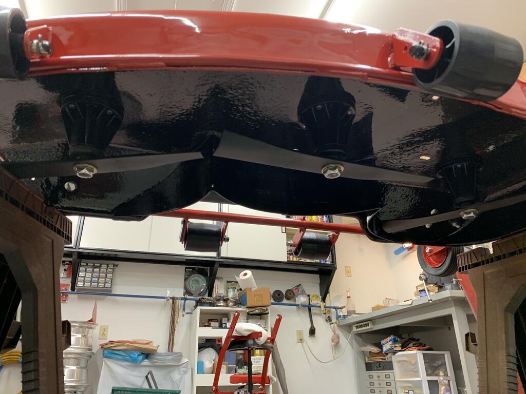

Horse Newbie 7,405 #17944 Posted December 10, 2022 7 hours ago, Tonytoro416 said: Hit it will some rust killer of some sort then put some POR15 on it. IMO it’s better than any undercoating. Comes In a can and you brush it on. Works really well And follow the instructions to the letter ! I used POR-15 on my 48 inch SD deck… 3 9 Share this post Link to post Share on other sites
Panther416-8 342 #17945 Posted December 10, 2022 19 hours ago, Horse Newbie said: And follow the instructions to the letter ! I used POR-15 on my 48 inch SD deck… Wow, could eat off of that deck. Nice job. 1 1 Share this post Link to post Share on other sites

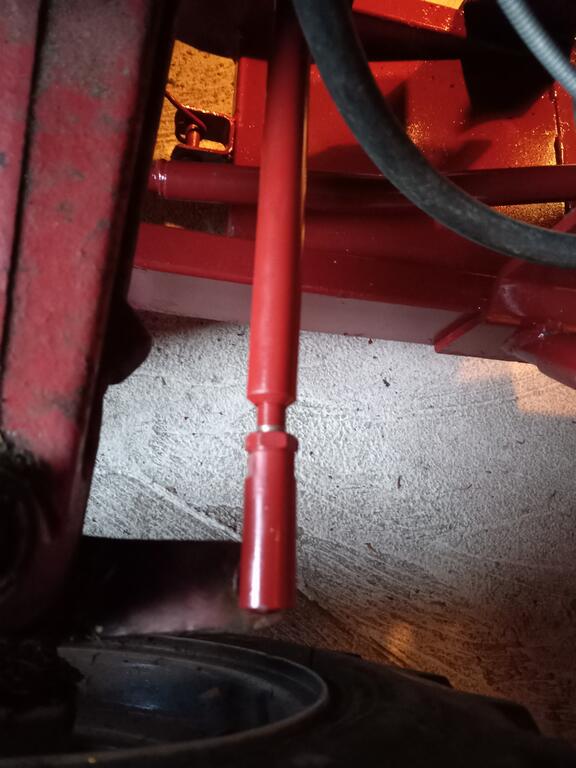

Panther416-8 342 #17946 Posted December 10, 2022 Put new adjustable tie rods on. Had about 1/2" toe out with old tie rods. With new ones in and adjusted I have about 1/4" toe in. Definitely steers much easier. 4 3 Share this post Link to post Share on other sites

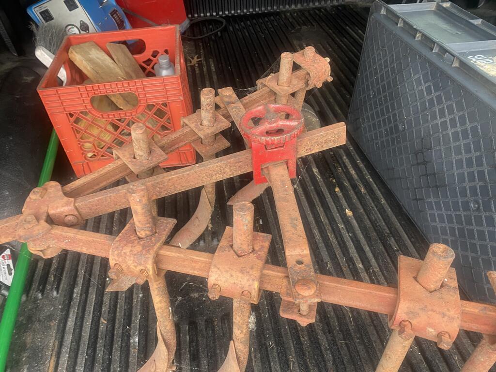

Lane Ranger 12,125 #17947 Posted December 11, 2022 (edited) Bought back an early AC-6 cultivator I sold a year ago to Chuck Hunt in Lebanon, Indiana with a number of RJ-58 items. Picked it up and had a nice visit with Chuck who’s dad use to be a Wheel Horse dealer in Lebanon. It’s old and unrestored but works well on an RJ- 58 tractor. Edited December 11, 2022 by Lane Ranger 5 5 Share this post Link to post Share on other sites

sjoemie himself 3,232 #17949 Posted December 11, 2022 3 hours ago, Lane Ranger said: That's an excellent little cultivator. I think I might copy the design to make my own. 2 Share this post Link to post Share on other sites
