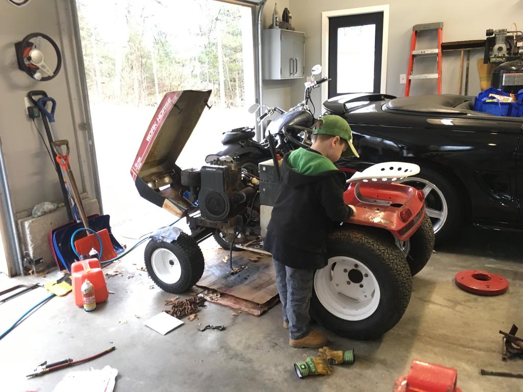

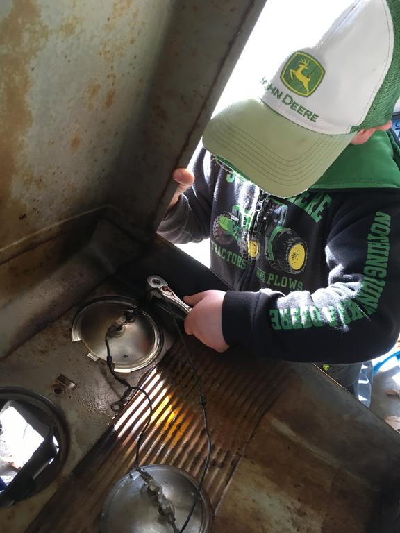

TonyToro 1,190 #156 Posted February 25, 2018 My son and I back at working on my father inlaws pulling tractor. It was about 50 degrees yesterday so no heat needed in the garage. Got the front tires mounted and put on the tractor, installed rear wheel weights and wired up the lights. Maybe today run to Walmart for a battery and see if it will run. 8 Share this post Link to post Share on other sites
dells68 7,499 #157 Posted February 25, 2018 Love the little guy helping out! 3 1 Share this post Link to post Share on other sites

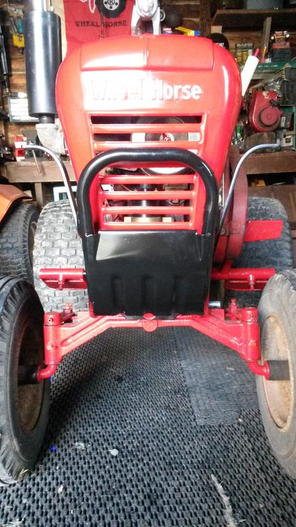

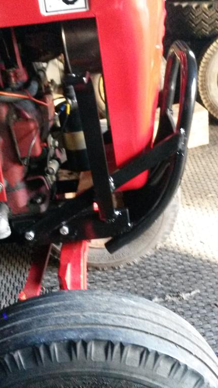

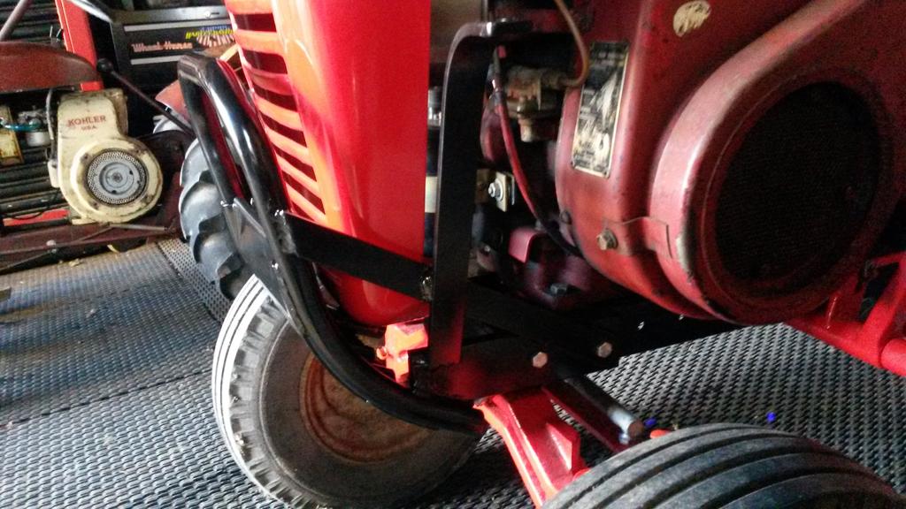

Chris G 3,392 #169 Posted February 27, 2018 I took advantage of the weather and got the push bar / light mount put on my custom 702! Also got my horse decal put on the horse hauler! 5 4 Share this post Link to post Share on other sites
WHX?? 58,308 #170 Posted February 27, 2018 Truck world that's called a bull bar Chris....awesome 1 1 Share this post Link to post Share on other sites
Chris G 3,392 #171 Posted February 27, 2018 Ya it originated as a bull bar /skid plate for a atv. I just fabbed it up to fit and to mount lights to. I didn't want to damage my extended hood. I extended the hood 3 1/2 in on top and the bottom. So I can fit a few different motors in there if ever needed. The hood was already chopped in half basically when I got it. So I figured i would get a little creative with it. 4 Share this post Link to post Share on other sites

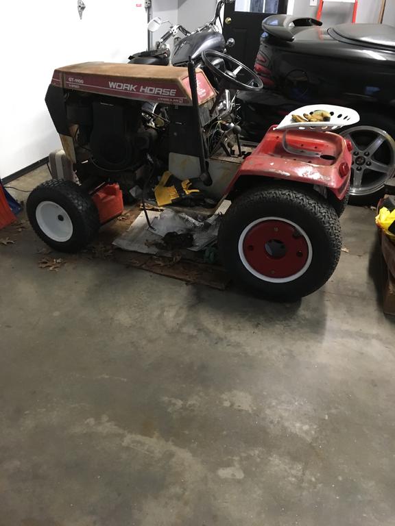

TonyToro 1,190 #172 Posted February 27, 2018 I worked on my father inlaws GT1100 to day and it RUNS! ..... but it doesn’t shut off.... 😩 back to the wiring diagram........ 1 1 Share this post Link to post Share on other sites
953 nut 69,914 #173 Posted February 27, 2018 5 minutes ago, TonyToro said: but it doesn’t shut off. You have a magneto ignition system, the key switch needs to ground the "M" wire coming from the engine to turn it off. Be sure the switch has a good ground. 1 Share this post Link to post Share on other sites
TonyToro 1,190 #174 Posted February 27, 2018 10 minutes ago, 953 nut said: You have a magneto ignition system, the key switch needs to ground the "M" wire coming from the engine to turn it off. Be sure the switch has a good ground. Ok thank you, I will take a look after diner. This is the tractor the had the electrical melt down. Share this post Link to post Share on other sites

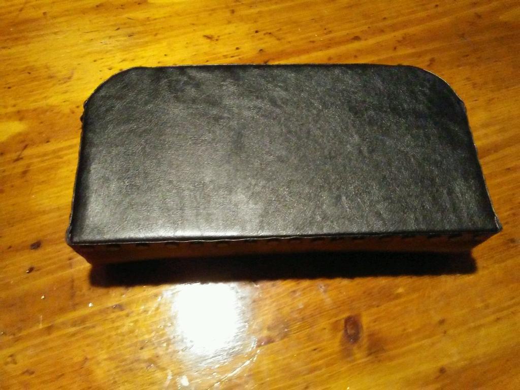

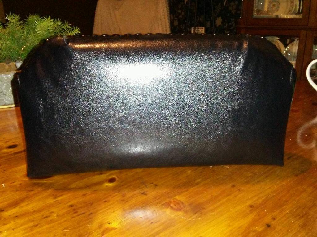

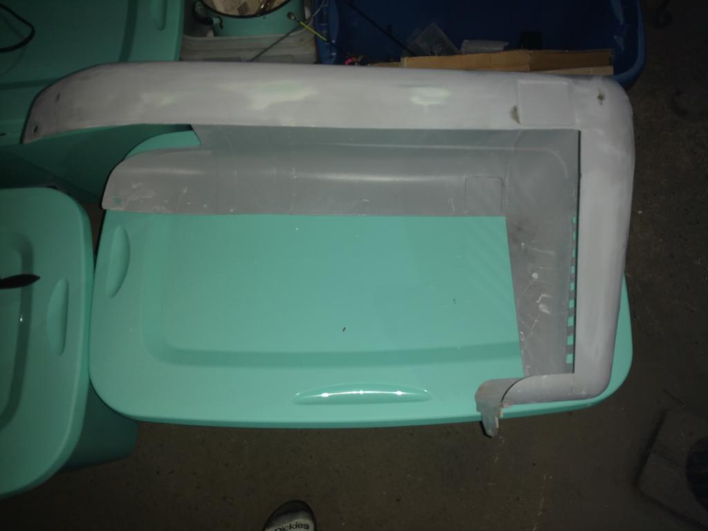

Chris G 3,392 #175 Posted March 1, 2018 Well today I built a new back rest. So as soon as I find a square pan, I can mount it on one of the horses. Also cleaned up and cleared a couple more part for the 401. 2 1 Share this post Link to post Share on other sites
