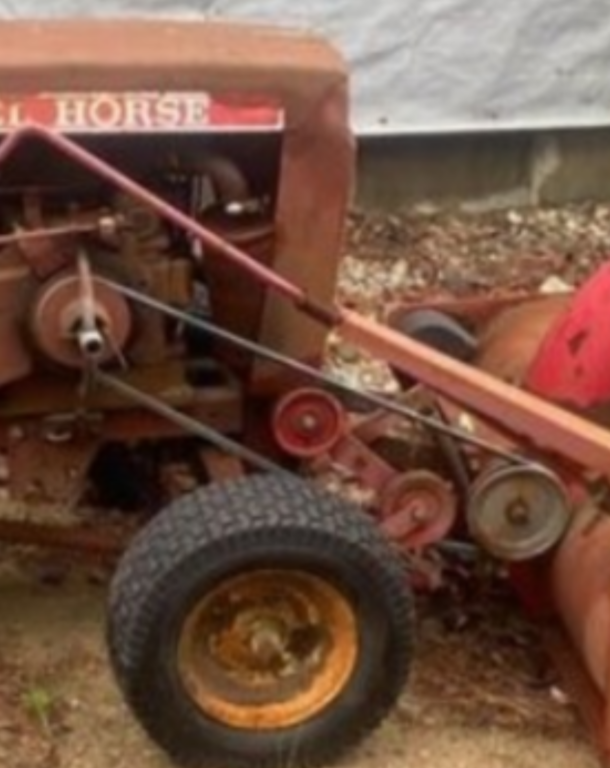

ebinmaine 80,811 #17357 Posted October 8, 2022 12 minutes ago, Heatingman said: lots of belt systems dont use tensioner systems at all. Id have to see the set up you have, to say for sure. But you can have just 2 pulleys and a belt without an idler at all. Think bike chain. Just sorta stretch the belt into place. Here's a pic. It's clearly not correct. Turns the blower. All the time. 1 Share this post Link to post Share on other sites
Ed Kennell 47,481 #17358 Posted October 8, 2022 39 minutes ago, ebinmaine said: Here's a pic. It's clearly not correct. Turns the blower. All the time. Looks like he just turned the tensioner up side down to be able to use the one tensioner pulley with a short belt. No tensioner works on two rigid fixed distance pulleys, but the PTO to blower drive pulley distance changes quite a bit over the blower lift range. The belt would surely jump off without a tensioner. 4 Share this post Link to post Share on other sites

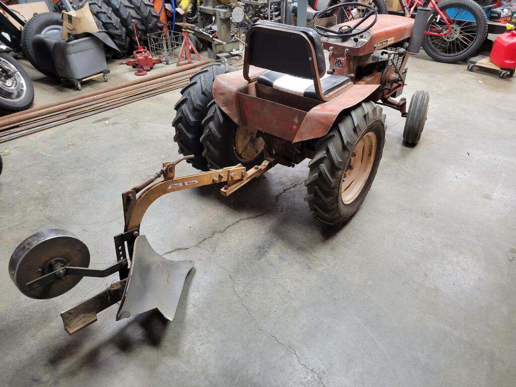

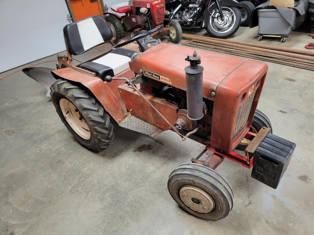

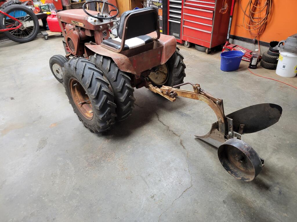

Shynon 7,720 #17359 Posted October 9, 2022 All ready to play!! 5 10 Share this post Link to post Share on other sites

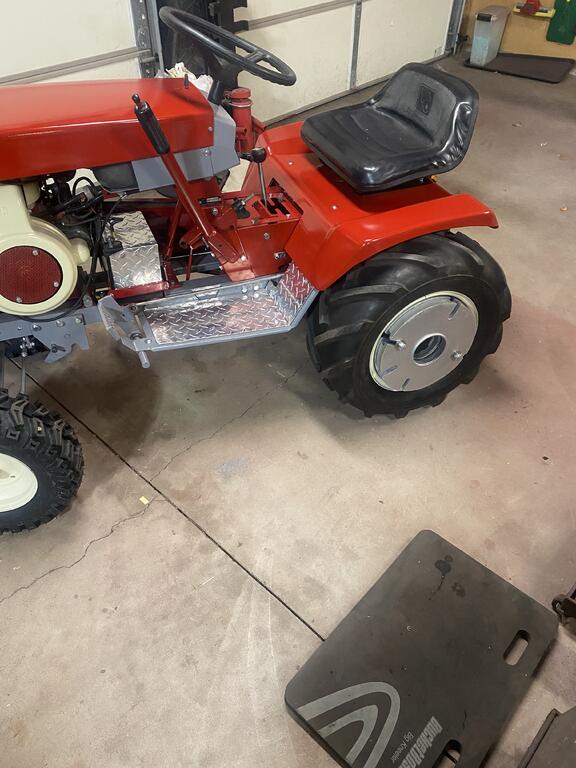

Heatingman 977 #17360 Posted October 9, 2022 Just mounted some weights. Their off a simplicity. About 25 lbs each, so total of around 100 lbs. Used 3/4 PVC as a spacer to have bolt tension prior to sliding the weights into place. Seemed to make the install easier and probably less damage to the paint on the rims. 7 6 Share this post Link to post Share on other sites
sjoemie himself 3,232 #17361 Posted October 9, 2022 8 hours ago, Shynon said: All ready to play!! Now I know what my next Wheel Horse should be! Looks like a 'proper' big tractor with the dual wheel like that. Most duals on the gt's are another wheel bolted on, I like this better. Got any close-ups of the system you're using? Greetings from the Netherlands, Mark 2 2 Share this post Link to post Share on other sites
WHX?? 58,254 #17362 Posted October 9, 2022 Might even have to play on it abit myself ... 2 Share this post Link to post Share on other sites

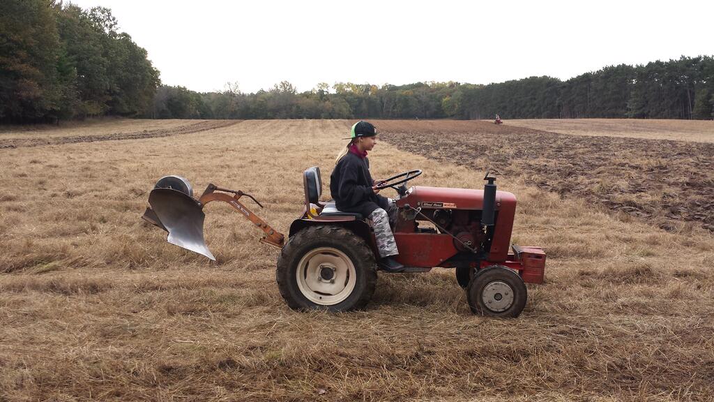

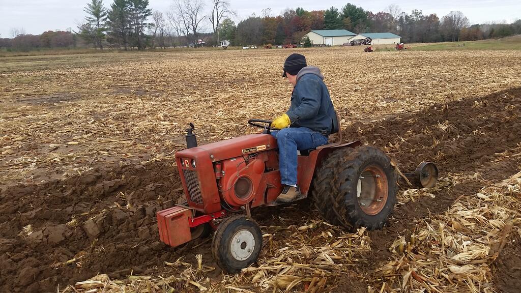

WHX?? 58,254 #17363 Posted October 9, 2022 (edited) A pic of it in action Mark. @sjoemie himself Pullstart's dau hauled the mail on it. Shop looks awful squared away Tom Edited October 9, 2022 by WHX?? 4 4 Share this post Link to post Share on other sites
squonk 48,184 #17364 Posted October 9, 2022 Like the suitcase weight "keep the weights from falling off into the furrow thingy! " 3 Share this post Link to post Share on other sites

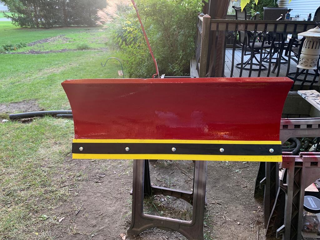

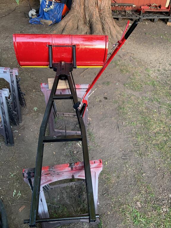

Andy N. 2,842 #17365 Posted October 9, 2022 On 10/6/2022 at 10:15 PM, Heatingman said: Mounted the plow On 10/6/2022 at 10:32 PM, Jeff-C175 said: Me did too Got mine assembled after the refresh. Probably wait for a few weeks before install. 4 6 Share this post Link to post Share on other sites
Jeff-C175 7,211 #17366 Posted October 9, 2022 9 minutes ago, Andy N. said: mine assembled That's the plastic edge? I thought about that myself, but ended up opting for the rubber. 2 1 Share this post Link to post Share on other sites
Heatingman 977 #17367 Posted October 9, 2022 24 minutes ago, Jeff-C175 said: That's the plastic edge? I thought about that myself, but ended up opting for the rubber. Got some thick HDPE plastic, bolted in place with the original wear strip on mine. 2 4 Share this post Link to post Share on other sites
Heatingman 977 #17368 Posted October 9, 2022 36 minutes ago, Andy N. said: Got mine assembled after the refresh. Probably wait for a few weeks before install. looks good. Wonder if that bend in the control arm needs to bend out. Had to make a bracket to move mine outward to clear the footboard. 2 Share this post Link to post Share on other sites

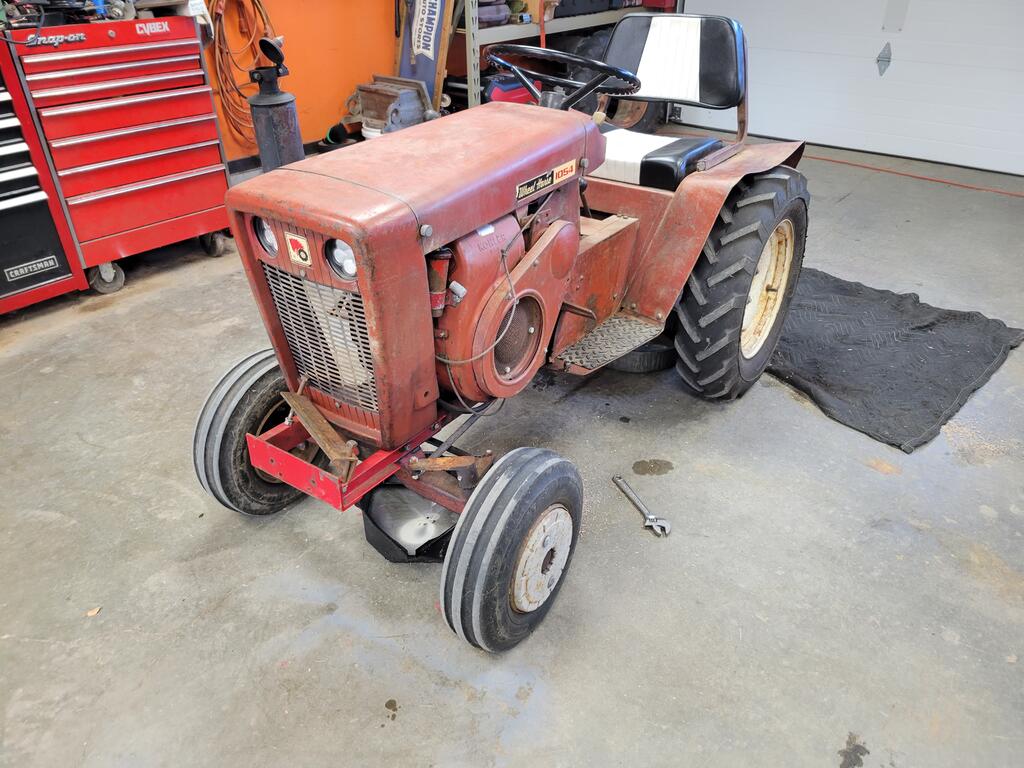

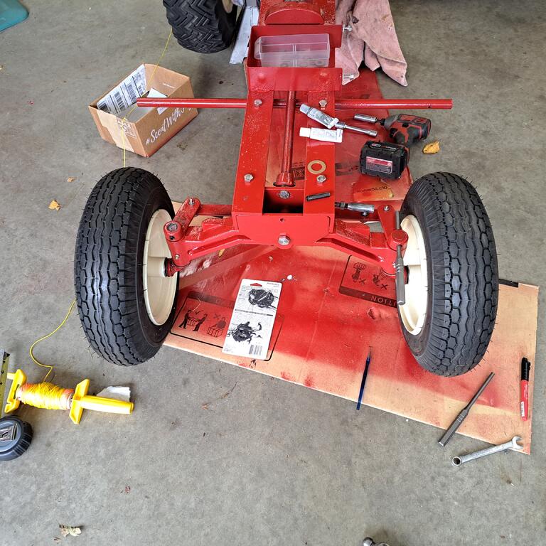

WHX?? 58,254 #17369 Posted October 9, 2022 Those plows look almost too nice to use fellas... Worked on a front end for the 701. What a pain given what i had off the carcass to work with. Roll pin holes wallowed out. Steering arms pin holes all wallowed out.... I shoulda looked for replacements but was up for the challenge. My success hinges on the results of high strength epoxy. 8 1 Share this post Link to post Share on other sites

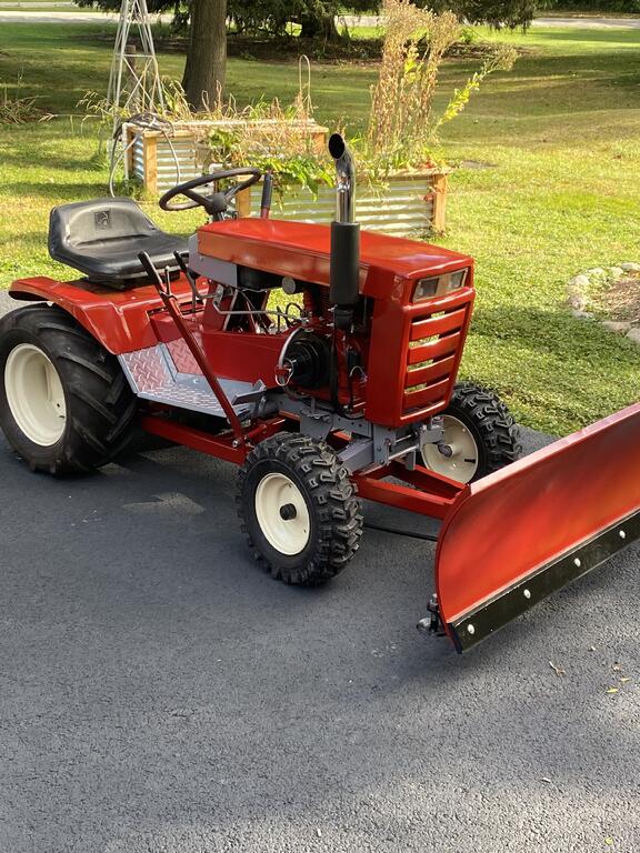

Andy N. 2,842 #17370 Posted October 9, 2022 (edited) 8 hours ago, Heatingman said: looks good. Wonder if that bend in the control arm needs to bend out. Had to make a bracket to move mine outward to clear the footboard. The control arm angle is good for my 418-A. This will be my 5th winter using this plow. Just giving it a refresh. Of course I don't have a pic of the right side with it mounted on the 418-A. But I do with it mounted on the 312-8. Edited October 9, 2022 by Andy N. 5 Share this post Link to post Share on other sites
Handy Don 17,515 #17371 Posted October 10, 2022 3 hours ago, WHX?? said: My success hinges on the results of high strength epoxy It looks like you were considering kite string as part of the repair but went with epoxy instead. Good choice! 1 Share this post Link to post Share on other sites
WHX?? 58,254 #17372 Posted October 10, 2022 (edited) 47 minutes ago, Handy Don said: considering kite string as part of the repair but went with epoxy instead. Good choice! Mason's line Don strung around tires to check alignment. Trying to get a little toe in. Or anything even close to it! Since the drag link has no adjustments everything was set by the roll pins through the top of the spindles & steering arms. They looked like Swiss cheese. Edited October 10, 2022 by WHX?? 1 Share this post Link to post Share on other sites
Handy Don 17,515 #17373 Posted October 10, 2022 (edited) 22 minutes ago, WHX?? said: Mason's line Don strung around tires to check alignment. Trying to get a little toe in. Or anything even close to it! Since the drag link has no adjustments everything was set by the roll pins through the top of the spindles & steering arms. They looked like Swiss cheese. Ah, nice trick using string! Yep, all built in at the factory with no plans for adjustments after wear. (But is it you who often reminds us this isn't race cars or rockets? ) Those steering arms were the only parts I didn't disassemble on the 854 frame -- they were tight and aligned and I knew all I could do is ruin them! Edited October 10, 2022 by Handy Don 1 2 Share this post Link to post Share on other sites
WHX?? 58,254 #17374 Posted October 10, 2022 27 minutes ago, Handy Don said: is it you who often reminds us this isn't race cars or rockets? Tis me... 2 Share this post Link to post Share on other sites
squonk 48,184 #17375 Posted October 10, 2022 Drill out holes to next larger roll pin size. 2 1 Share this post Link to post Share on other sites
