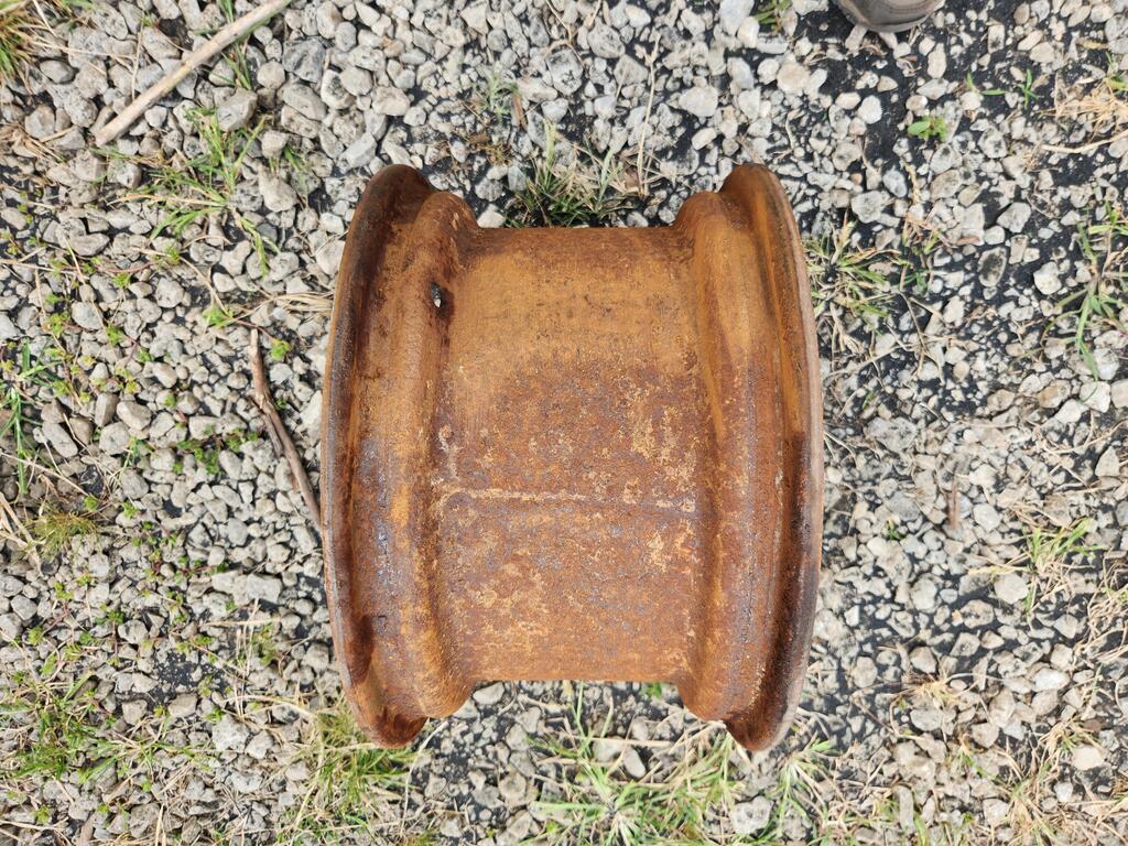

Gregor 4,848 #16954 Posted September 10, 2022 Over time I have seen several posts about breaking the bead on tires. To be honest, I never paid a whole lot of attention to them, because when I wanted new tires, I simply took the wheels to the local tire shop, and told them what to put on. I went to the local tire shop today. They quoted me $400 for 2 Carlisle turf tires mounted on my rims. I thought thay was a bit steep. I brought my tires back home. Now I had to break the beads. It aint easy! Driving over the tire with my truck, did no0thing, although, it does hold the tire still while you attack it with a sawzall, oscillating saw, grinder, and cold chisel, but I did get the tires off.One tire had something very sticky, and ugly inside. That was not fun to clean up. Both were quite rusty inside. Last year I bought a cheap little HF sand blaster, but I didn't have compressor enough to run it properly. Now I have access to a VERY large compressor, and it worked much better. My main focus was the bead area, and it cleaned really well. I also did the outside. They are not show quality, but good enough for a plow tractor. If you do a lot of painting, you NEED to get a sand blaster. So much better than a wire wheel, a brush, sand paper. I should have had this thing 10 years ago. When I think of all the money I spent having things blasted, I could have bought my own large compressor. 4 2 Share this post Link to post Share on other sites

Heatingman 977 #16959 Posted September 10, 2022 32 minutes ago, Gregor said: Over time I have seen several posts about breaking the bead on tires. To be honest, I never paid a whole lot of attention to them, because when I wanted new tires, I simply took the wheels to the local tire shop, and told them what to put on. I went to the local tire shop today. They quoted me $400 for 2 Carlisle turf tires mounted on my rims. I thought thay was a bit steep. I brought my tires back home. Now I had to break the beads. It aint easy! Driving over the tire with my truck, did no0thing, although, it does hold the tire still while you attack it with a sawzall, oscillating saw, grinder, and cold chisel, but I did get the tires off.One tire had something very sticky, and ugly inside. That was not fun to clean up. Both were quite rusty inside. Last year I bought a cheap little HF sand blaster, but I didn't have compressor enough to run it properly. Now I have access to a VERY large compressor, and it worked much better. My main focus was the bead area, and it cleaned really well. I also did the outside. They are not show quality, but good enough for a plow tractor. If you do a lot of painting, you NEED to get a sand blaster. So much better than a wire wheel, a brush, sand paper. I should have had this thing 10 years ago. When I think of all the money I spent having things blasted, I could have bought my own large compressor. Was that just to put on tires you provided? 1 Share this post Link to post Share on other sites

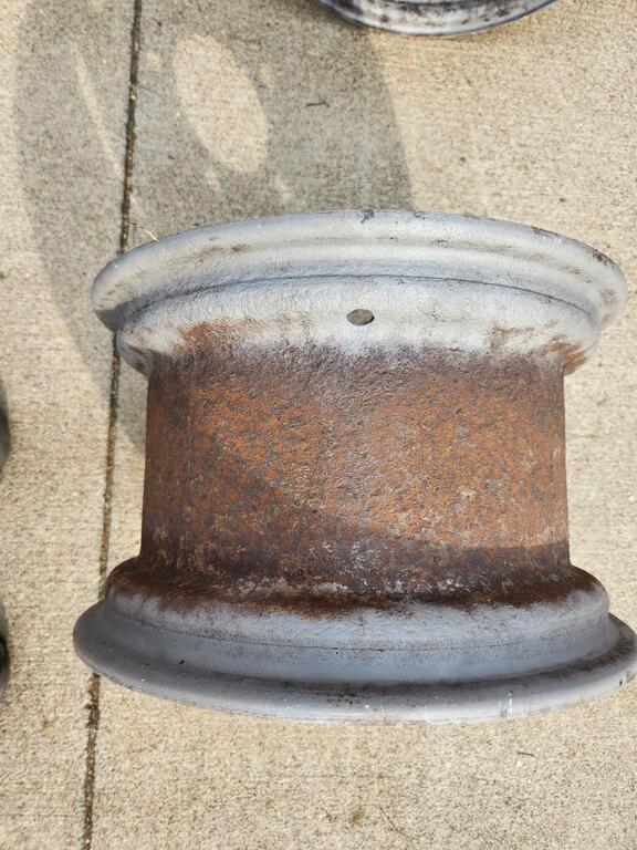

Gregor 4,848 #16962 Posted September 10, 2022 I took 23 X 8.50 - 12's off of these rims. I assume I can put 23 X 10.50 - 12's back on. ??????? 3 Share this post Link to post Share on other sites
953 nut 69,642 #16963 Posted September 10, 2022 1 hour ago, Gregor said: If you do a lot of painting, you NEED to get a sand blaster. So much better than a wire wheel, a brush, sand paper. Before placing any rusted parts in the media blaster it is a good idea to use a needle gun, it will cut your blasting time by 75% and your glass beads will last a lot longer. 6 Share this post Link to post Share on other sites
SylvanLakeWH 32,654 #16964 Posted September 11, 2022 1 hour ago, Gregor said: I took 23 X 8.50 - 12's off of these rims. I assume I can put 23 X 10.50 - 12's back on. ??????? I did on a C 105 no issues… 4 Share this post Link to post Share on other sites

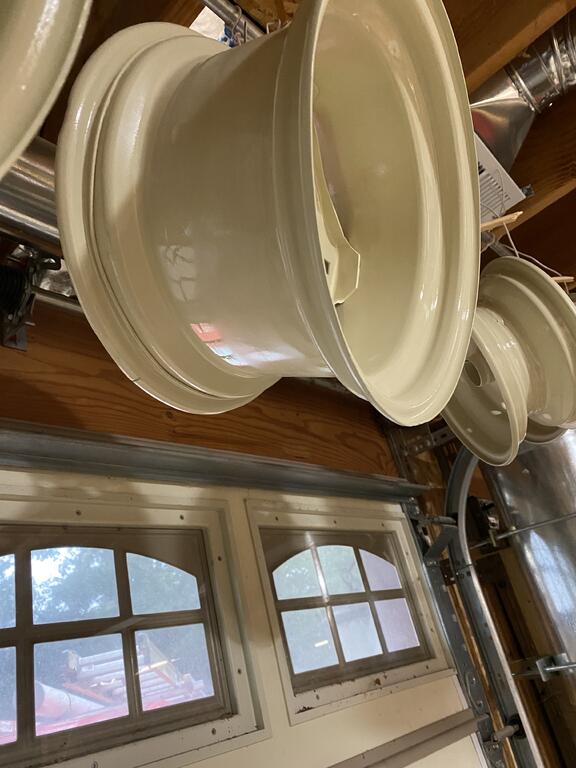

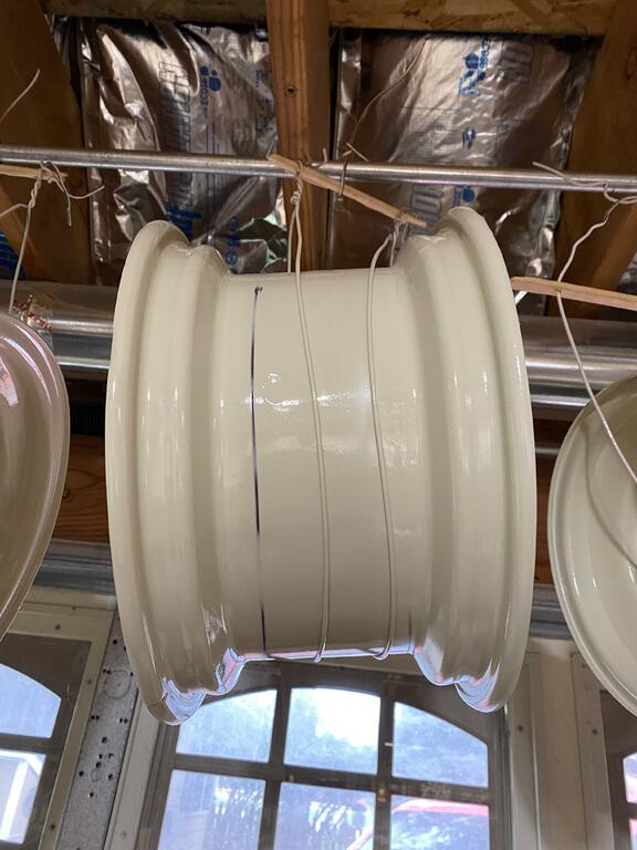

Heatingman 977 #16968 Posted September 11, 2022 Could not help myself. Almond really pops on the rims. Just about ran out of daylight. And moved them inside just after sunset. 4 7 1 Share this post Link to post Share on other sites

Heatingman 977 #16970 Posted September 11, 2022 (edited) Couple more passes around the border and this will be looking good. Edited September 11, 2022 by Heatingman 4 5 Share this post Link to post Share on other sites

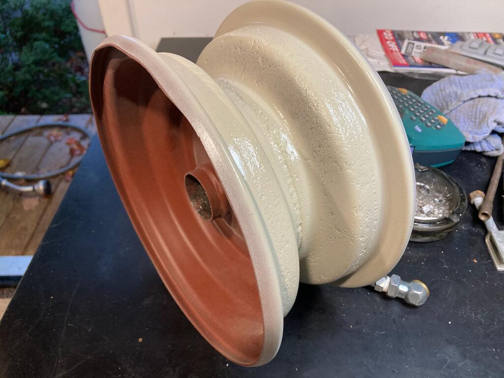

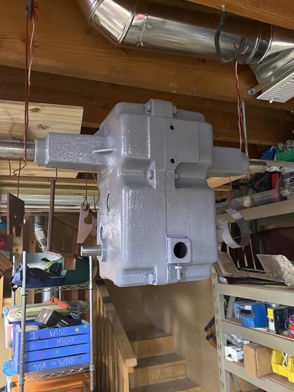

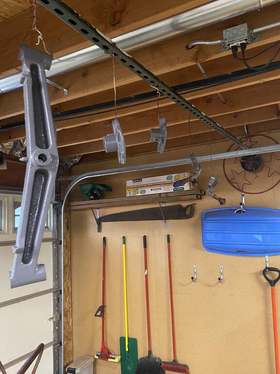

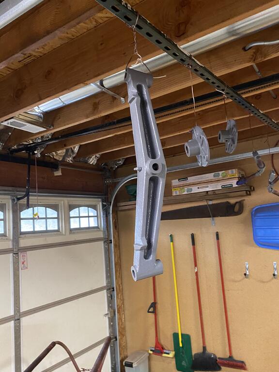

Heatingman 977 #16971 Posted September 11, 2022 Decided to try an air brush to touch up the rims where my hanging supports were. Worked very well, highly recommended getting one for such work. Almost no overspray, barely any fumes, and did a great job. Think I might even use it to paint all the little brackets, and pulleys and such. 4 1 Share this post Link to post Share on other sites
oliver2-44 11,760 #16972 Posted September 11, 2022 @Heatingman what airbrush do you have. Share this post Link to post Share on other sites
Heatingman 977 #16973 Posted September 11, 2022 3 minutes ago, oliver2-44 said: @Heatingman what airbrush do you have. I picked this one up this morning from Menards, and an upgraded hose from Harbor Fright. 2 1 Share this post Link to post Share on other sites

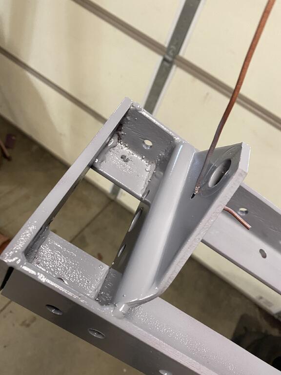

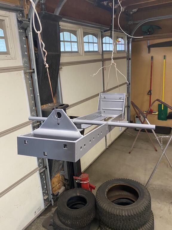

Heatingman 977 #16974 Posted September 11, 2022 The airbrush really saved this rainy day in regards to what I had planned to get done with the tractor. Was able to paint the frame, trans, splindles, and hubs inside without having to set up as spray booth, or tarps for overspray, etc… Took a while to paint the larger parts, but really was able to get into the nooks and crannies of the parts easily. I’ll definitely be using this thing more, even when painting with the full size paint gun to get into those hard to reach areas. 11 1 Share this post Link to post Share on other sites
