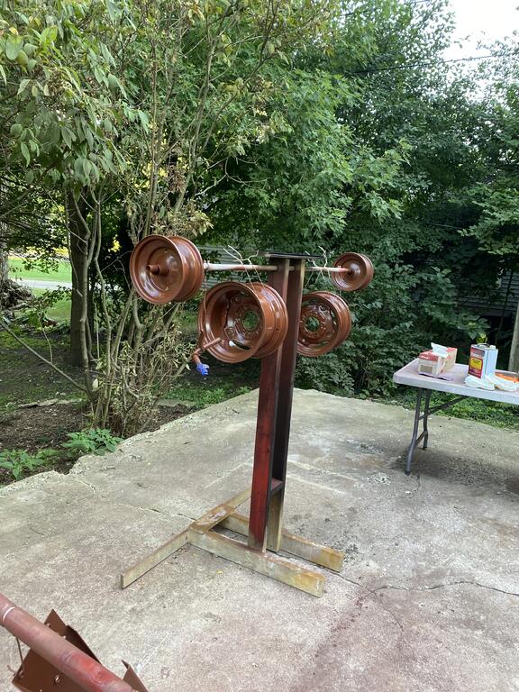

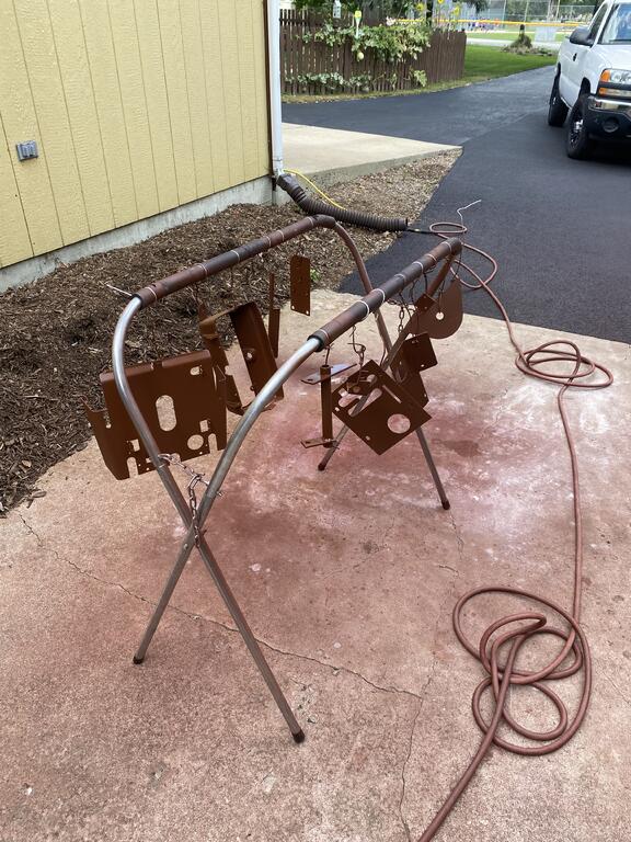

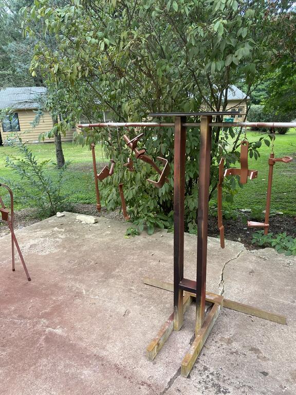

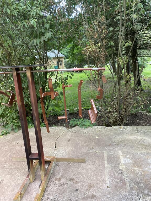

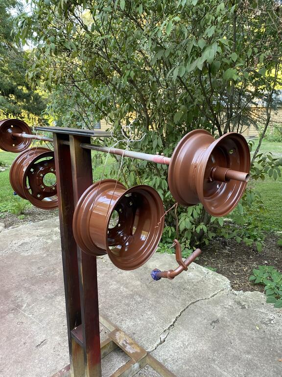

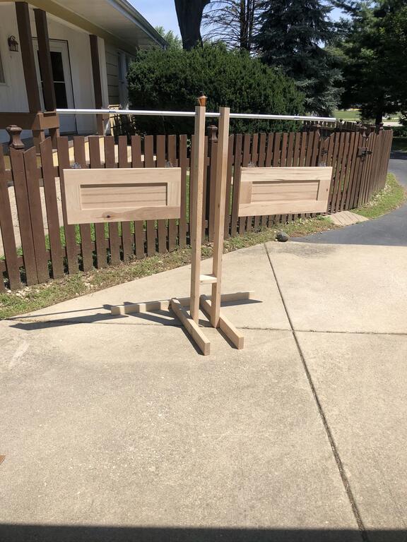

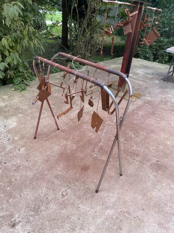

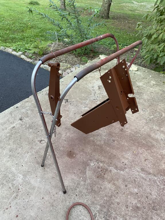

Heatingman 977 #16927 Posted September 8, 2022 (edited) Got some primer on the frame, rims, and related parts. Before I started, my elderly neighbor asked what I was up to. Showed her around the project and got to talking about a lawn sweeper I want to find. Turns out she has one, and an old riding mower that belonged to her father that she wants to get rid of. Both mine for the taking when I have space. Wish I had more stuff to hang parts from to paint. Gonna be a multi day process for each step. (Prime and paint) Still got a bunch of parts ready for primer. The device the rims are on was purpose built for spraying cabinet doors from when I remodeled the kitchen. Back when lumber was still cheap Edited September 8, 2022 by Heatingman 1 12 Share this post Link to post Share on other sites

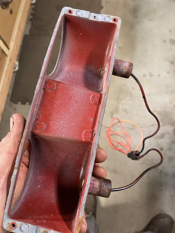

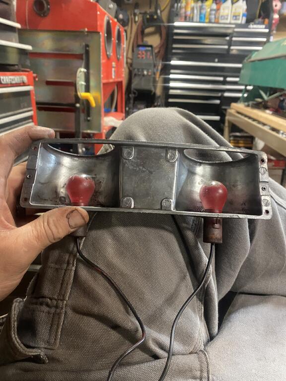

Heatingman 977 #16930 Posted September 9, 2022 Also while I was sitting around, decided to breath life into the headlight fixture that @Burnerman graciously sent me. I’ll get me some 1156 led bulbs and should have really nice headlights for plowing. 4 1 Share this post Link to post Share on other sites

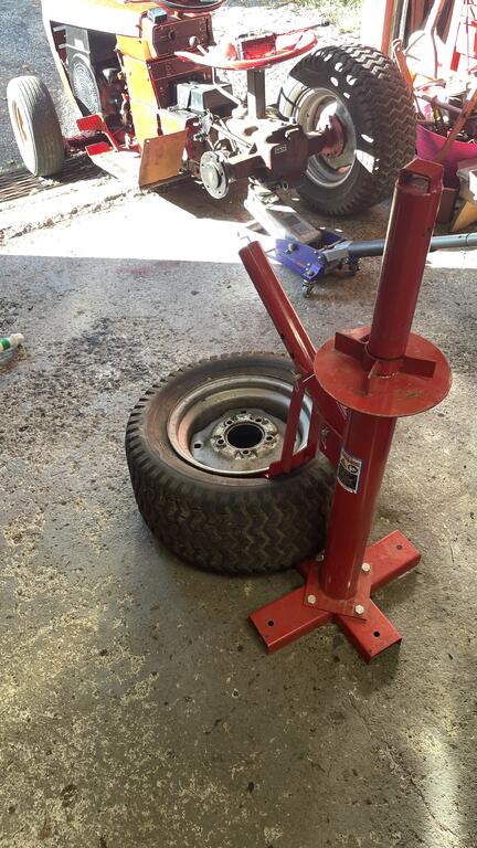

Burnerman 759 #16931 Posted September 9, 2022 Looking good @Heatingman👍 I put a tube in the other rear tire on my play tractor after work. 6 2 Share this post Link to post Share on other sites

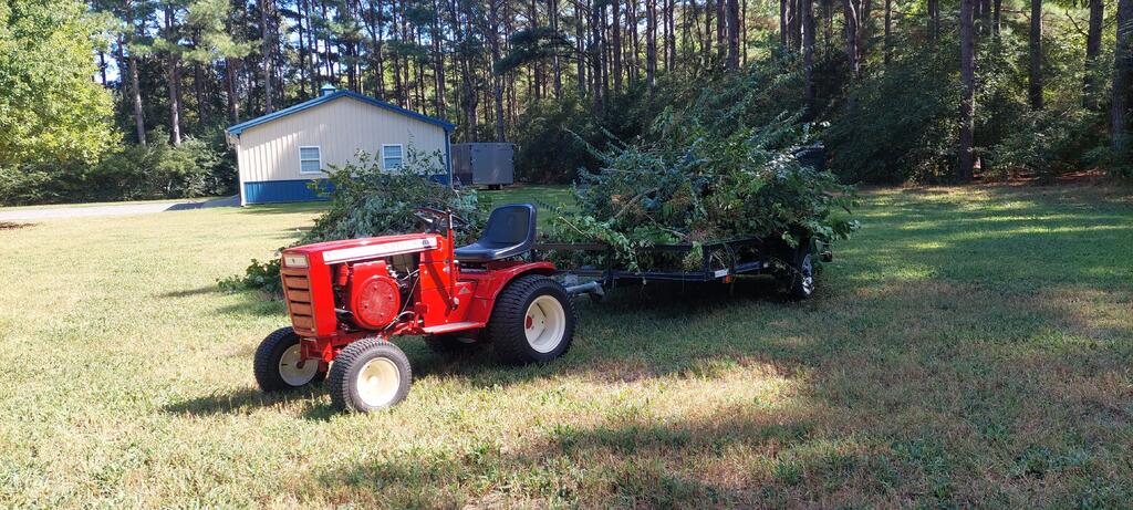

dmoore 1,042 #16934 Posted September 9, 2022 Not so much working on it as some light work with it.. 5 5 Share this post Link to post Share on other sites
Heatingman 977 #16935 Posted September 9, 2022 6 hours ago, Burnerman said: Looking good @Heatingman👍 I put a tube in the other rear tire on my play tractor after work. How well does that bead breaker work on the the really old ones? 3 Share this post Link to post Share on other sites
ebinmaine 80,811 #16936 Posted September 9, 2022 2 hours ago, Heatingman said: How well does that bead breaker work on the the really old ones? Sometimes it takes some serious persistence or even alternative tools. Sawzall. 6' crowbar. Strong gorilla. Etc.... But they get the job done. 3 Share this post Link to post Share on other sites
Heatingman 977 #16937 Posted September 10, 2022 23 minutes ago, ebinmaine said: Sometimes it takes some serious persistence or even alternative tools. Sawzall. 6' crowbar. Strong gorilla. Etc.... But they get the job done. I had to use the 12 ton press on one of mine. Had to rig a make shift pressing foot to angle into the rim to direct more force to the bead itself. Im considering making an adapter foot attachment for the press. really depends on how much of this type of thing I’ll be doing. 1 Share this post Link to post Share on other sites
ebinmaine 80,811 #16938 Posted September 10, 2022 3 minutes ago, Heatingman said: depends on how much of this type of thing I’ll be doing. We've used ours quite a bit. Really only had one tire that fought me to near submission. I did eventually win. 2 Share this post Link to post Share on other sites
Wheelhorse#1 1,997 #16939 Posted September 10, 2022 On 9/8/2022 at 11:02 PM, Heatingman said: Also while I was sitting around, decided to breath life into the headlight fixture that @Burnerman graciously sent me. I’ll get me some 1156 led bulbs and should have really nice headlights for plowing. I added HVAC foil tape the inside of mine as well that gave it a little extra reflection.just a idea ! 3 Share this post Link to post Share on other sites
953 nut 69,642 #16940 Posted September 10, 2022 14 hours ago, Heatingman said: How well does that bead breaker work on the the really old ones? The HF tier changer will do a good job breakin the bead unless it is rusted badly. If that is the case you can open up a gap between the rim and tire and put in some liquid wrench and give it a few days to work. If that won't do the trick then I use the front end loader to break the bead, seems a bit extreme but it is effective. 2 Share this post Link to post Share on other sites
Heatingman 977 #16941 Posted September 10, 2022 38 minutes ago, 953 nut said: The HF tier changer will do a good job breakin the bead unless it is rusted badly. If that is the case you can open up a gap between the rim and tire and put in some liquid wrench and give it a few days to work. If that won't do the trick then I use the front end loader to break the bead, seems a bit extreme but it is effective. If I had one, Id use the front end loader too. 1 Share this post Link to post Share on other sites

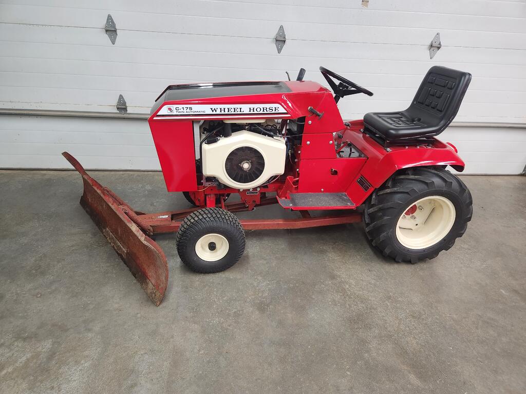

Gregor 4,848 #16942 Posted September 10, 2022 I got the blade on my 175A. Complete with adjustable link. With it all the way down, I can just take some of the weight off of the front tires. We'll see how that works out. Now I have to decide if I want to take it off, blast it, and paint it. Again, we'll see. Right now it has Deestone ags on the back. I don't like them at all, but I can trade tires with another tractor and put the Carlisle ags on, or turf tires. When pushing snow, if you have weights and chains, does it really matter what tire you have on. I have one heavy plastic wheel weight, and one that's just hollow. Should I fill the hollow one with concrete? Or what? Thanks Greg 2 Share this post Link to post Share on other sites
Ed Kennell 47,474 #16943 Posted September 10, 2022 1 minute ago, Gregor said: does it really matter what tire you have on. Turf tires with chains put more steel to the ground than ags with chains. IMO 3 Share this post Link to post Share on other sites
pfrederi 21,204 #16944 Posted September 10, 2022 35 minutes ago, Ed Kennell said: Turf tires with chains put more steel to the ground than ags with chains. IMO Weight is your friend and you want it somewhat balanced other wise one wheel will spin easily 1 Share this post Link to post Share on other sites
Heatingman 977 #16945 Posted September 10, 2022 41 minutes ago, Gregor said: I got the blade on my 175A. Complete with adjustable link. With it all the way down, I can just take some of the weight off of the front tires. We'll see how that works out. Now I have to decide if I want to take it off, blast it, and paint it. Again, we'll see. Right now it has Deestone ags on the back. I don't like them at all, but I can trade tires with another tractor and put the Carlisle ags on, or turf tires. When pushing snow, if you have weights and chains, does it really matter what tire you have on. I have one heavy plastic wheel weight, and one that's just hollow. Should I fill the hollow one with concrete? Or what? Thanks Greg You dont like the Deestone ags in general, or for this application? And why? Just curious, not trying to get you to change your mind, Ive no dog in the fight. 1 Share this post Link to post Share on other sites
Gregor 4,848 #16946 Posted September 10, 2022 Deestones are just so much smaller than Carlisles or other tires. Here is Carlisle and Deestone, Both are 23 X 10.50 - 12 5 1 Share this post Link to post Share on other sites

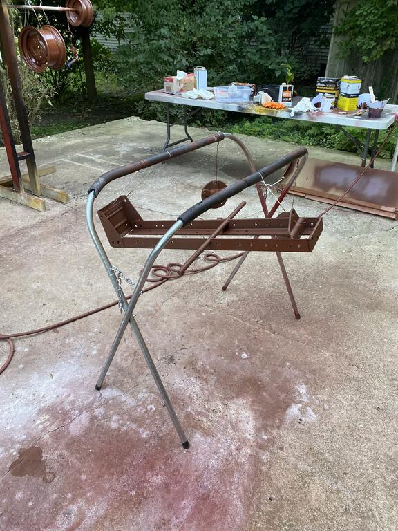

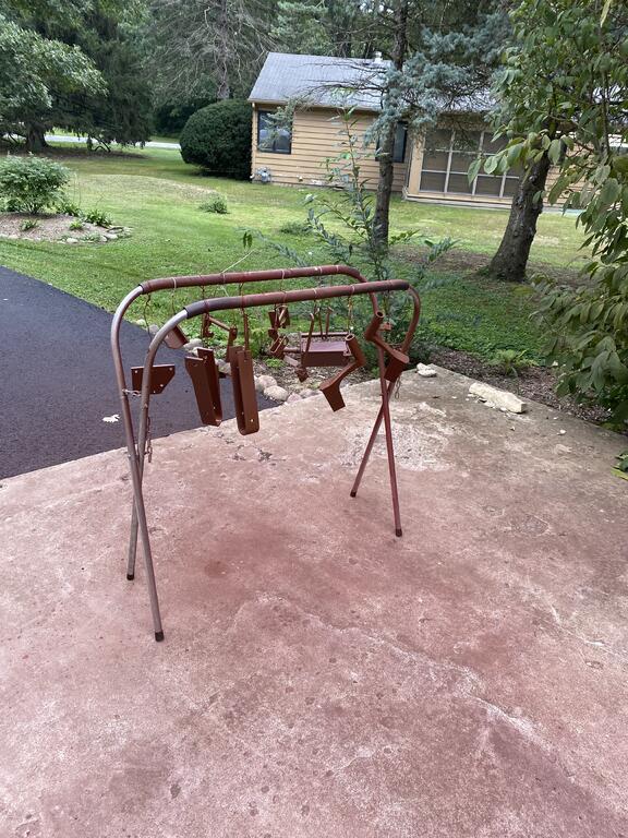

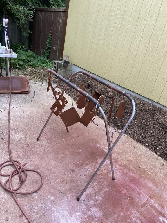

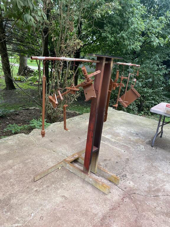

Heatingman 977 #16948 Posted September 10, 2022 Got some more parts primed. Over packed the one hanger station, ended up with a run on the mule drive housing, and one of the seat springs cause I was trying to get in with the gun to hard spots, then overspray built up too fast outside the target area. So in a few days, I’ll have some sanding to do, then maybe touch up prime those parts. Prolly use the rattle can for that. So, lesson learned, slow down dummy (me) or make more hanger space, or both. Gonna rain on Sunday which is a bummer. Was hoping to get some color down on the rims, maybe the frame. 7 Share this post Link to post Share on other sites

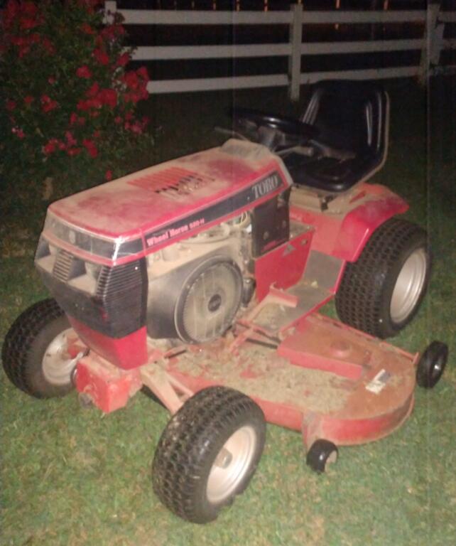

kpinnc 18,995 #16949 Posted September 10, 2022 The electric PTO on my zero turn mower has stopped working (bad switch I think), so I had to once again enlist the help of one of my Wheel Horses. I'd been using the 520-H with a 42SD deck for the small spaces that my zero turn wouldn't fit, but that was a once per week for 10 minutes job. This time I had to break out the 60SD and work the ole girl for several hours. As expected, she didn't complain and did a great (albeit much slower) job. It was well after dark when we finished. Now she needs another bath! 3 4 Share this post Link to post Share on other sites
