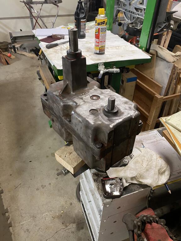

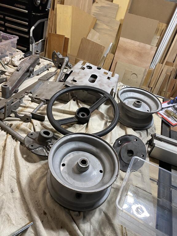

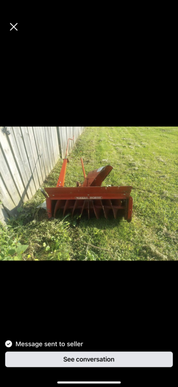

Heatingman 977 #16878 Posted September 5, 2022 Got the trans back together, sand blasted a bunch of parts, and made a deal for a snowblower for my B-80. I’ll be picking that up in the morning. 5 3 Share this post Link to post Share on other sites

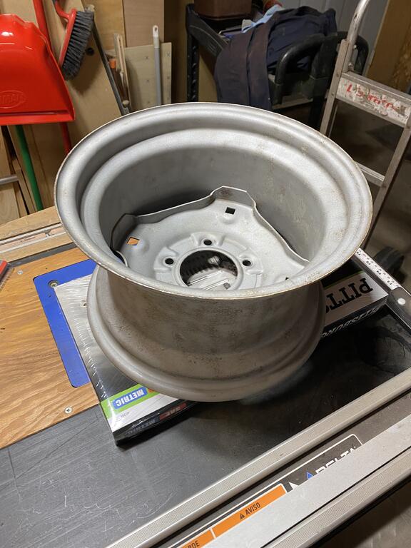

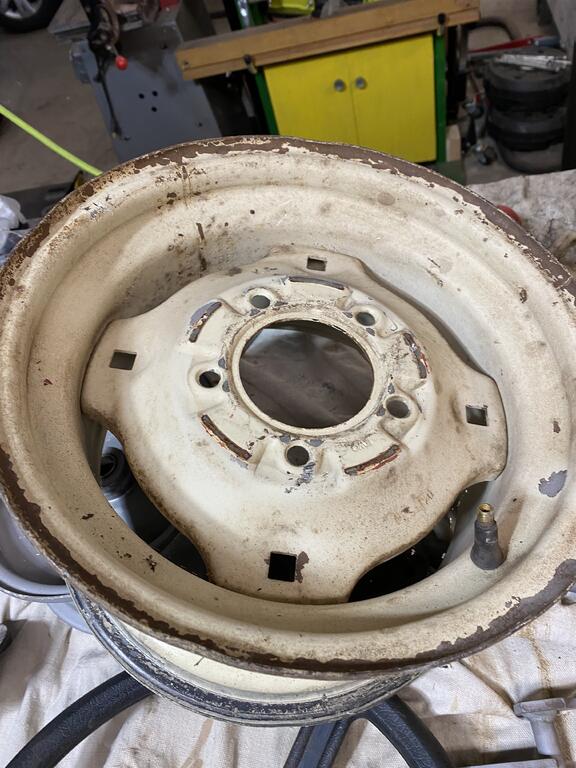

Heatingman 977 #16879 Posted September 5, 2022 Also dismounted the tires from those rims. What a pain that was. I worked in a tire shop as a teenager for a summer and I cant recall a bead ever being as hard to break as these. Apparently rust makes for a super bead sealer. For one of them I had to use the 12 ton press. 2 1 Share this post Link to post Share on other sites
ineedanother 2,872 #16880 Posted September 5, 2022 Nice work. I wrestled a couple tires this week myself and it wasn't pleasant in my small shop here in NC. Have you tried an e-tank in lieu of so much sand blasting? I do it for about 90% of cleanup now. Easy, clean, cheap, and actually more thorough to get down to the bare metal without stripping it away. Works while I'm in bed or at the office. Worth a look... 3 Share this post Link to post Share on other sites
Heatingman 977 #16881 Posted September 5, 2022 8 minutes ago, ineedanother said: Nice work. I wrestled a couple tires this week myself and it wasn't pleasant in my small shop here in NC. Have you tried an e-tank in lieu of so much sand blasting? I do it for about 90% of cleanup now. Easy, clean, cheap, and actually more thorough to get down to the bare metal without stripping it away. Works while I'm in bed or at the office. Worth a look... I have not tried. Been looking into it, but from what Ive read, its does not work to remove paint, just rust. If it removes paint, I’ll definitely give it a try. This project has by far been the most use my sandblaster has ever seen. Usually I just use it for small parts every now and again. This last few weeks its been almost daily. 1 Share this post Link to post Share on other sites
oliver2-44 11,760 #16882 Posted September 5, 2022 (edited) 18 minutes ago, Heatingman said: I have not tried. Been looking into it, but from what Ive read, its does not work to remove paint, just rust. If it removes paint, I’ll definitely give it a try. This project has by far been the most use my sandblaster has ever seen. Usually I just use it for small parts every now and again. This last few weeks its been almost daily. An E tank will certainly remove paint. Even tight paint with no rust under it. It will certainly take a little longer than just removing rust. But with minimal labor I say let it cook while I work on other things. The surface area of the sacrificial electrode is important, the more the better. Many use several pieces of rebar. I like to use flat metal. I pick up scraps of red iron such as purlin, C channel etc at the scrap yard. Edited September 5, 2022 by oliver2-44 3 Share this post Link to post Share on other sites

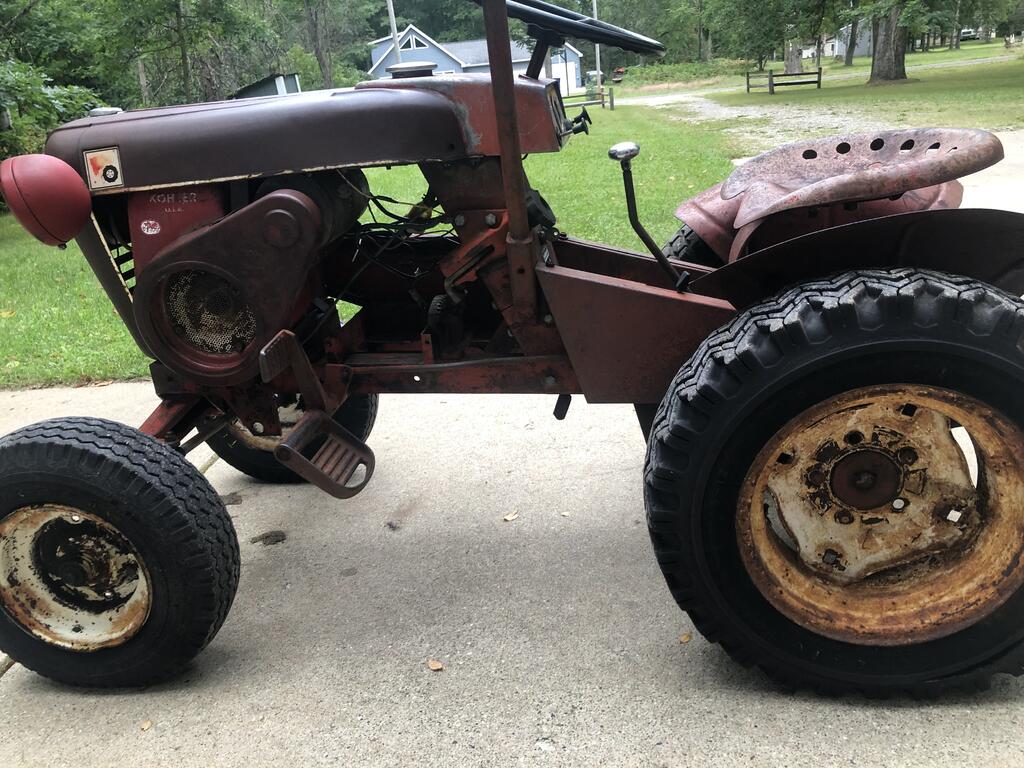

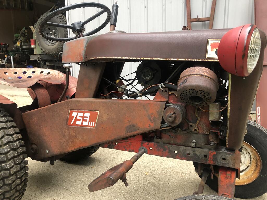

Rob J. 1,944 #16887 Posted September 5, 2022 I cleaned the 753 up a bit. I believe this to be a survivor original with the exception of the lights. It needs some TLC for sure but will be back in service soon enough. The 1045 gets out of the stable finally and let run through it’s paces to check everything over. Cheers! 4 6 Share this post Link to post Share on other sites

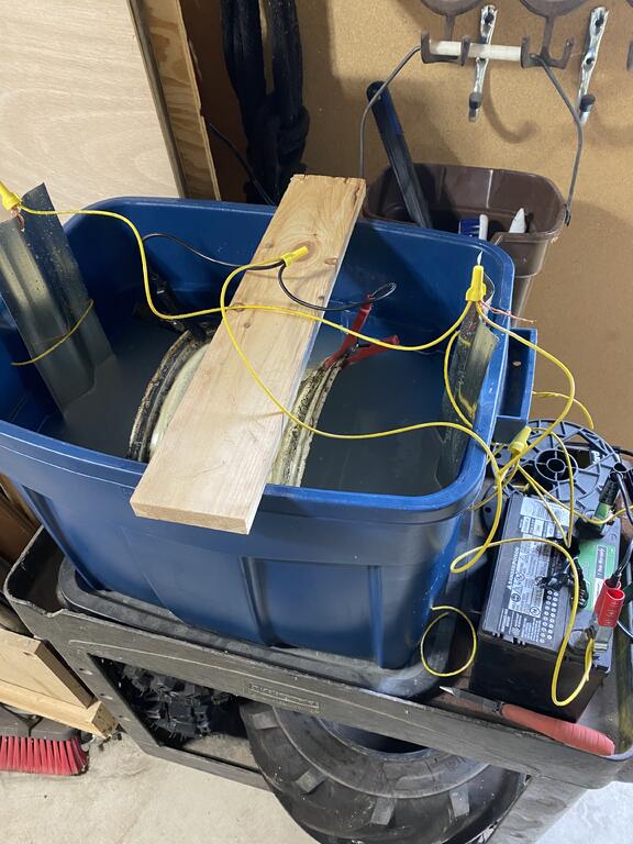

Heatingman 977 #16888 Posted September 5, 2022 I set this up earlier. Thought I posted already, maybe not. So Its been cooking for a few hours. See how it goes. Its definitely slow compared to the blasting cabinet. 4 1 Share this post Link to post Share on other sites

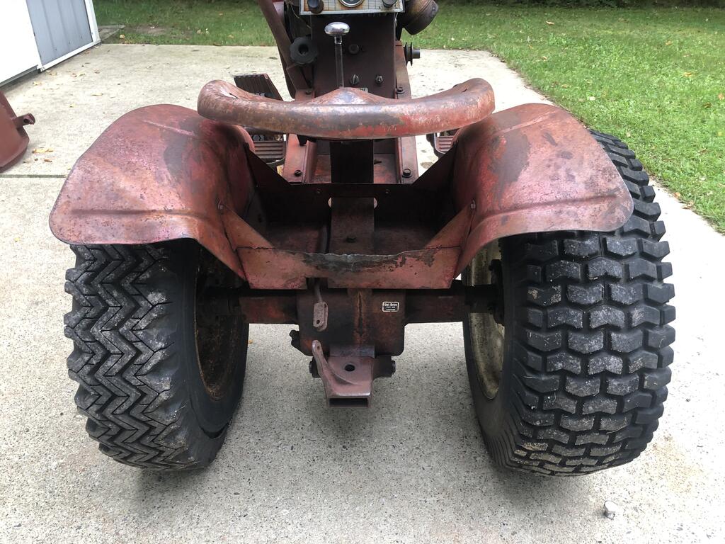

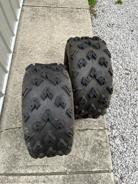

Evguy 567 #16889 Posted September 5, 2022 Picked up some new shoes for the horse from market place, hopefully not too aggressive. 3 3 1 Share this post Link to post Share on other sites
Snoopy11 5,731 #16890 Posted September 5, 2022 2 minutes ago, Evguy said: Picked up some new shoes for the horse from market place, hopefully not too aggressive. Are those ATV treads? They look similar to the treads on the LX that I have... I like them! Don Share this post Link to post Share on other sites

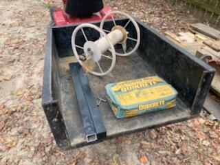

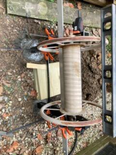

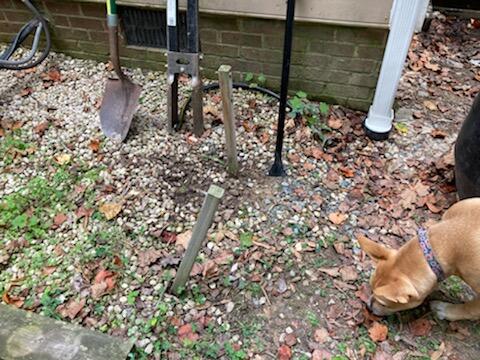

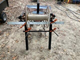

ineedanother 2,872 #16891 Posted September 5, 2022 Not much today but it was nice to have the day out of the office for the holiday. I did order a set of wheel bearings and a couple other things but got sidetracked with this mess. I'm a bit frugal and not very tolerant of poor engineering and design so several years ago I repurposed a hose reel from one of those carts that don't have enough wheelbase to support the hose and stay upright. Yeah, those ones. The problem with that is that I just bolted it to a couple PT balusters pounded into the ground a couple feet. Sturdy enough for the past several years but one of the legs finally gave way. Not well done on my part when I hang 100' of heavy garden hose on it. Fixed now with some repurposed 2" aluminum channel from an old sign post. The cross pieces are just clamped and will be removed once the concrete sets (if the rain holds off long enough) and I'll be good to go again 4 3 Share this post Link to post Share on other sites
Evguy 567 #16892 Posted September 5, 2022 1 hour ago, Snoopy11 said: Are those ATV treads? They look similar to the treads on the LX that I have... I like them! Don They’re Black diamond tires. I think they are six ply atv tires. Guy said they were on a zero turn he purchased. 1 Share this post Link to post Share on other sites

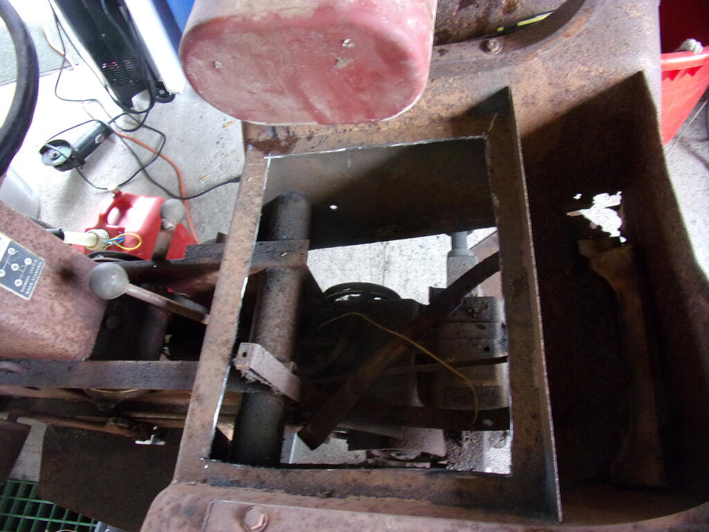

Ed Kennell 47,469 #16893 Posted September 5, 2022 (edited) I cut a hole in the 953s seat pan to remove the fuel tank. The tank looks good on the inside, but has one small rust thru from the outside. I'll solder that closed then test for leaks. I'll make a bolt on cover plate so the tank can easily be removed in the future. I cleaned and set the points and plug, and added an IV fuel tank. Couple squirts of fuel in the carb and she lit up. She doesn't smoke....that's the muffler burning the insulation off the jumper cables. Edited September 5, 2022 by Ed Kennell 4 3 1 Share this post Link to post Share on other sites

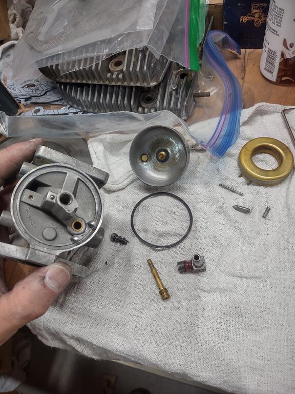

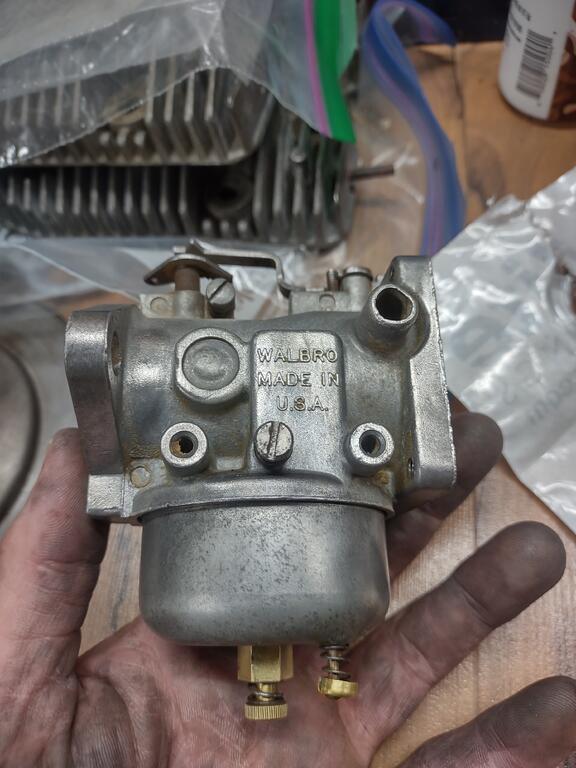

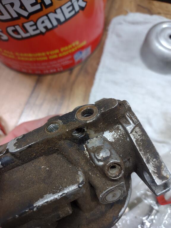

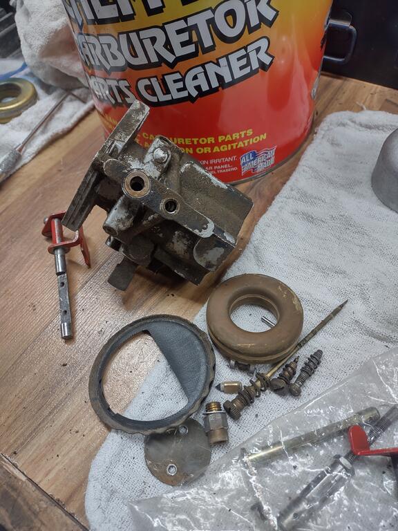

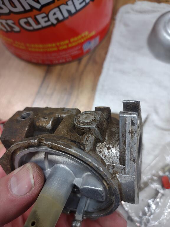

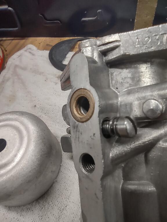

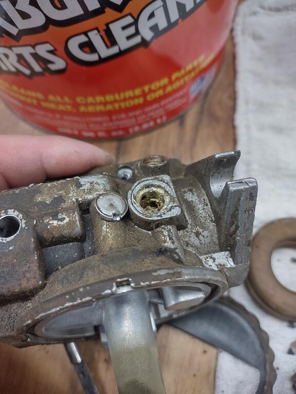

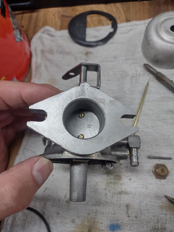

ebinmaine 80,811 #16894 Posted September 5, 2022 I played carburetor repair 🐻 today. Finished disassembly of my own Tecumsehorse carb off the 1974 C160-8 OHV160. That's soaking for a few days. I took this pic just for my own reference on how the float spring sets. For a member's Kohler carb I removed the throttle shaft blade, hand planed both ends and top, finished clean up, added washers to the body where the shaft goes through, then reassembled the whole carb. After that I started disassembly on another #30 carb for a K341. It's FILTHY. This carb had been apart in the distant past. Used thoroughly again. 2 lifetimes of wear on this one. The throttle shaft was not only worn out but broken at the top point of attachment. I'll replace that and the choke shaft with the pictures spares (in red). The Welch plug has been out in the past as well. As you can see it isn't flush and it's some nasty behind it. When done it'll be swapped out for the one on a C160 when I need it next. I believe I'll have 2 spares. Anyone tell me how to get this bushing out? 7 3 Share this post Link to post Share on other sites
