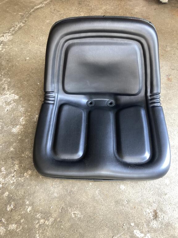

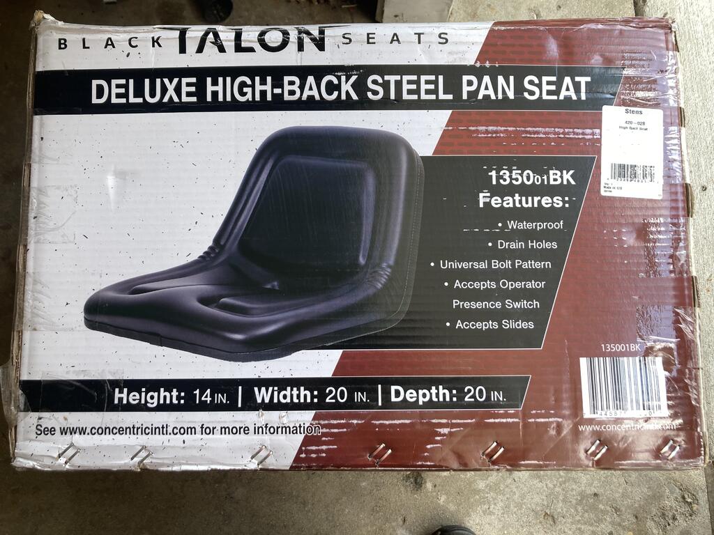

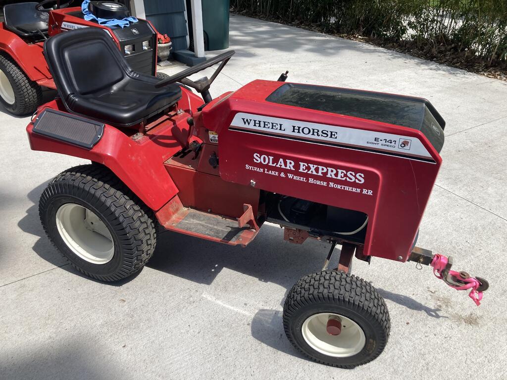

SylvanLakeWH 32,648 #16031 Posted June 12, 2022 (edited) New seat for the E 141 from Lincoln at A to Z… fit perfectly and love the look!!! Edited June 12, 2022 by SylvanLakeWH 14 4 Share this post Link to post Share on other sites

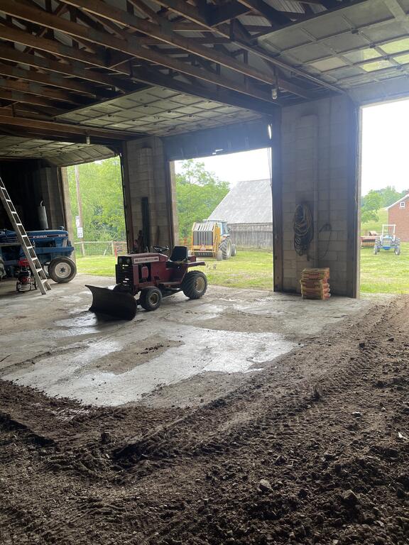

Desko 686 #16033 Posted June 12, 2022 Haven't been active much due to trying to get ready for a wedding is hectic lol but I did get the D160 out and took the mower off and threw the blade back on to do some barn work so it got to play with the big boys while I was pushing dirt/rock with it so I could put down milling material for the reception along with some concrete repairs. (Original barn burnt in the 80s so there was some popped out spots) 14 2 Share this post Link to post Share on other sites

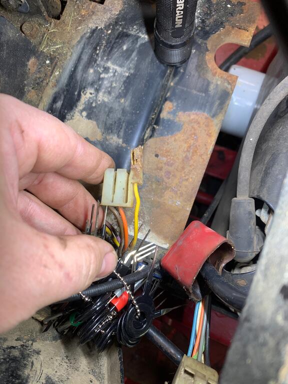

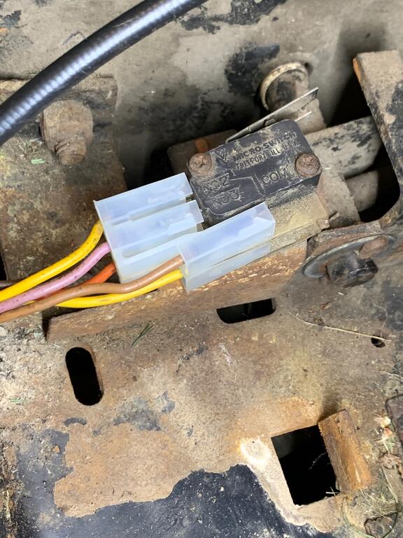

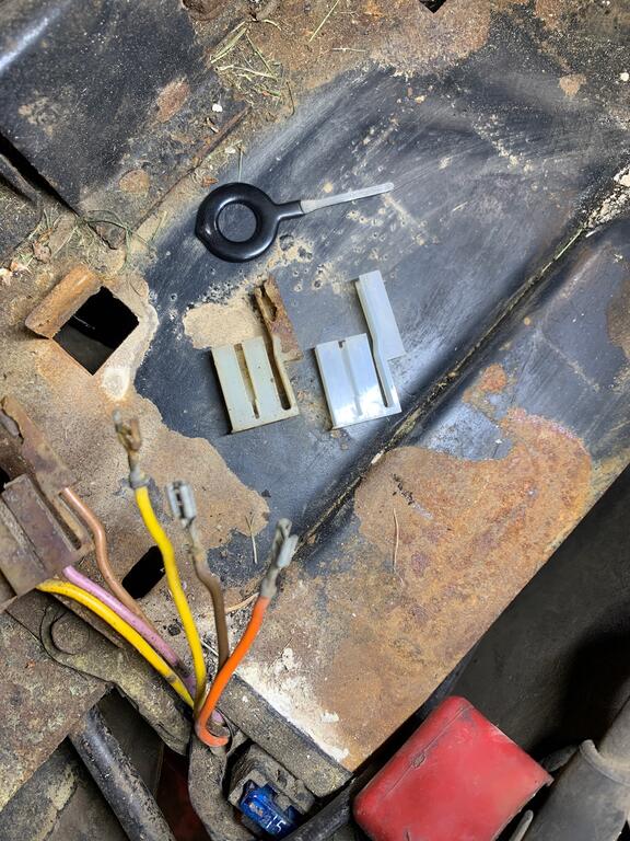

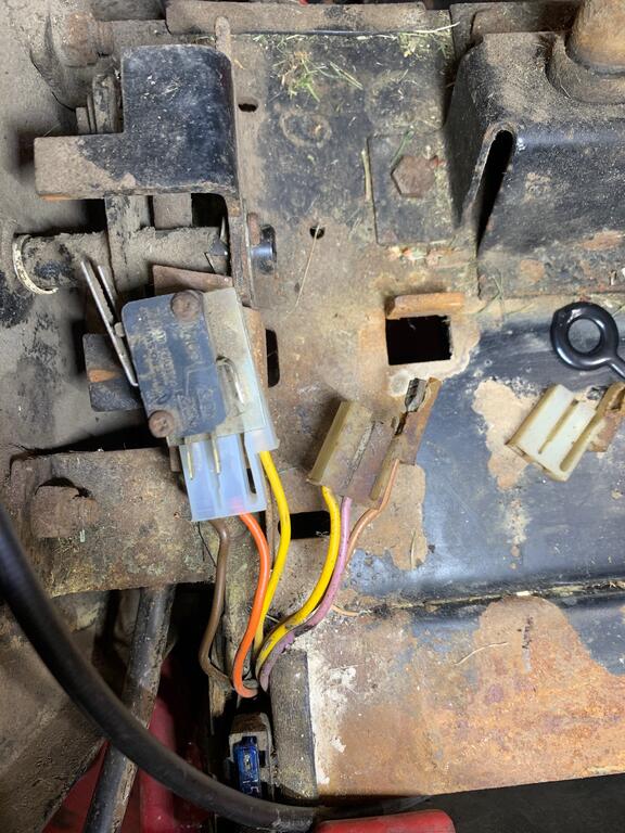

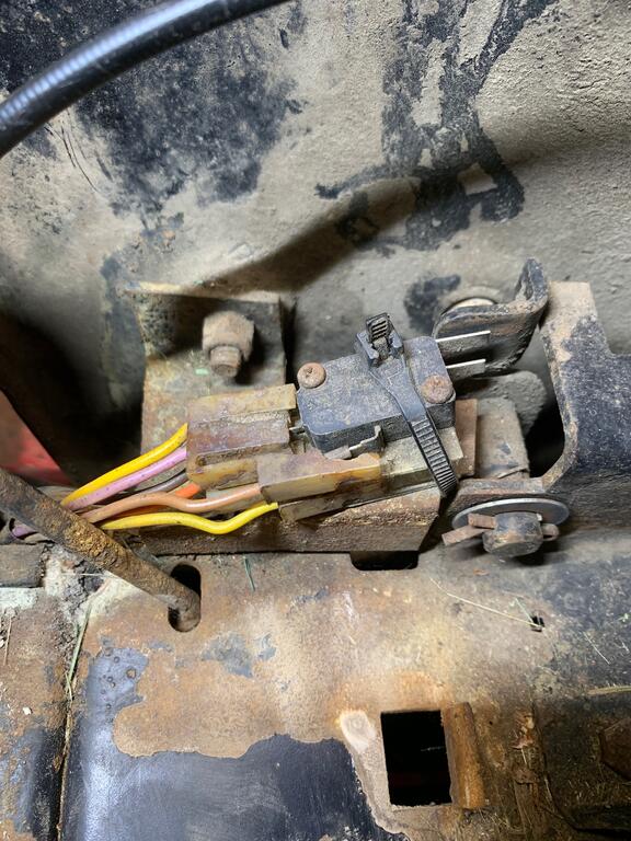

Andy N. 2,842 #16034 Posted June 12, 2022 Repaired the wiring connections to the PTO safety switches on the 520-H. And removed the ty wrap that someone had previously installed. Only had to put new connections on 2 of the wires. 11 5 Share this post Link to post Share on other sites
Handy Don 17,512 #16035 Posted June 12, 2022 1 hour ago, Andy N. said: Repaired the wiring connections to the PTO safety switches on the 520-H. And removed the ty wrap that someone had previously installed. Only had to put new connections on 2 of the wires. I know a number of members think the safety switches are more trouble than they are worth. I believe in them and I'm pleased to see you keeping them in good operating condition. Congrats 3 1 Share this post Link to post Share on other sites
tunahead72 2,662 #16036 Posted June 12, 2022 3 hours ago, SylvanLakeWH said: New seat for the E 141 from Lincoln at A to Z… fit perfectly and love the look!!! I bought that same seat from A-Z at one of the shows a couple of years back, love it! 3 1 Share this post Link to post Share on other sites
tunahead72 2,662 #16037 Posted June 13, 2022 2 hours ago, Andy N. said: Repaired the wiring connections to the PTO safety switches on the 520-H. And removed the ty wrap that someone had previously installed. ... Just wondering, how are the switches working now that you removed the zip tie? I'm curious why it was put there in the first place. 3 Share this post Link to post Share on other sites

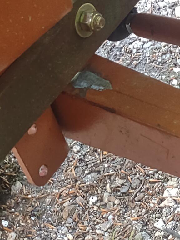

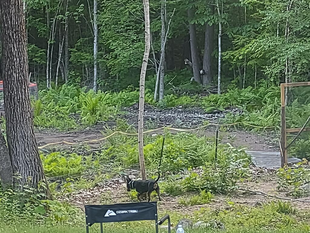

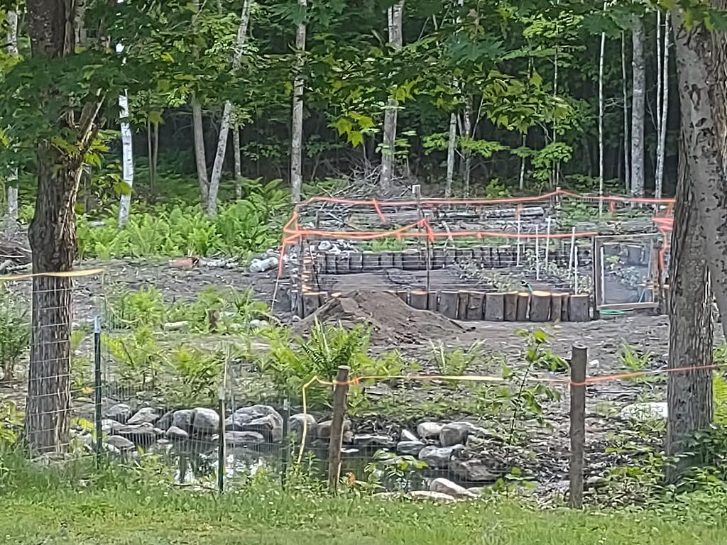

ebinmaine 80,808 #16038 Posted June 13, 2022 Fair amount done again today. Since I installed the Mackissic chipper shredder the left side of the bracket has seriously impeded the axle tilt to that direction. Today I ground the nub of the casting of the axle flat. Much better. We also finished moving the rest of the 10 yds of loam we'd had delivered a few weeks ago. I moved 4 loads of around 15 - 17 cu feet each so well over 2 cu yds. All hand shovel loaded. 90% hand shovel unloaded too. Damn good workout. Part of it is now a path from the pallet bridge to the garden gate. The rest is now in a spare loam pile. While I started getting my head wrapped around what needs to be done to move the truck and it's portable garage, Trina and her mom moved and stacked more firewood. 7 Share this post Link to post Share on other sites
Andy N. 2,842 #16039 Posted June 13, 2022 30 minutes ago, tunahead72 said: Just wondering, how are the switches working now that you removed the zip tie? I'm curious why it was put there in the first place. Switches ohmed out good and worked fine. I didn't put the them on there so not sure why. 1 Share this post Link to post Share on other sites

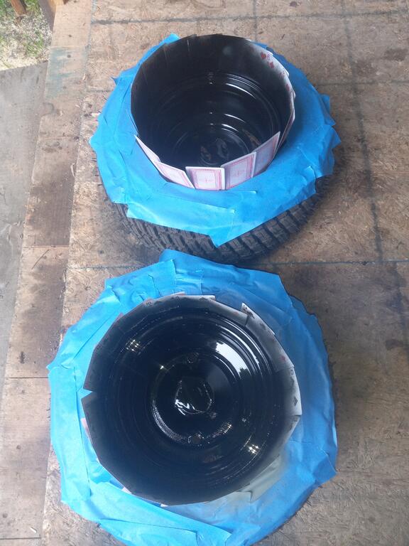

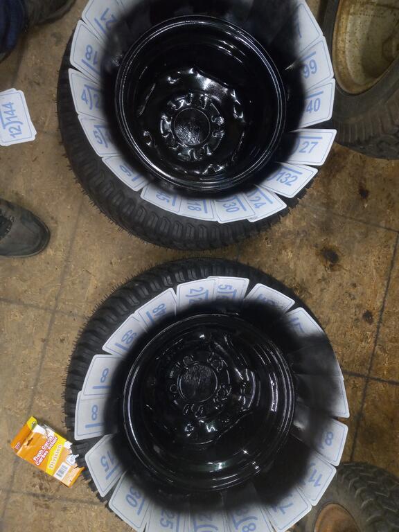

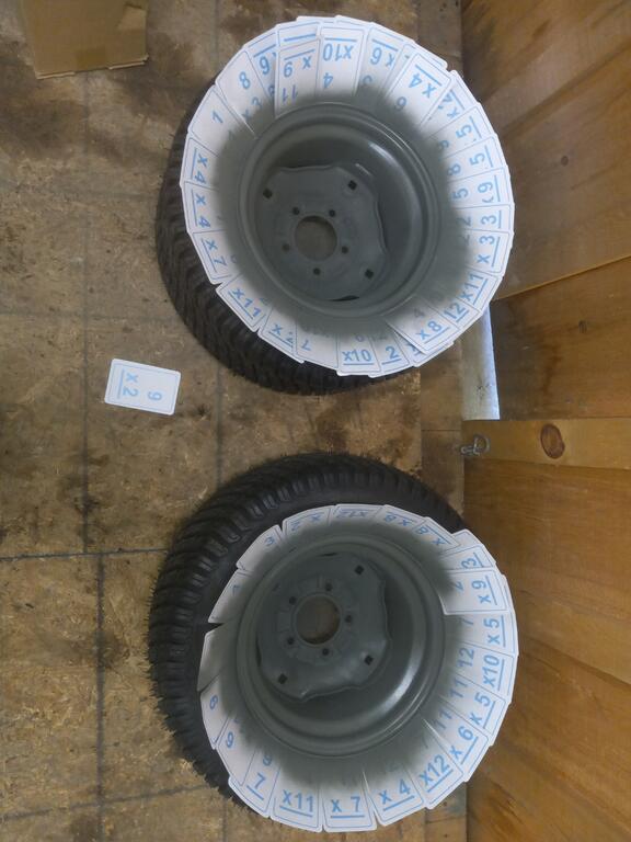

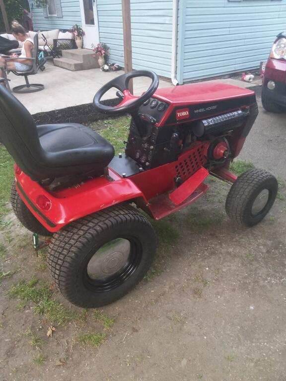

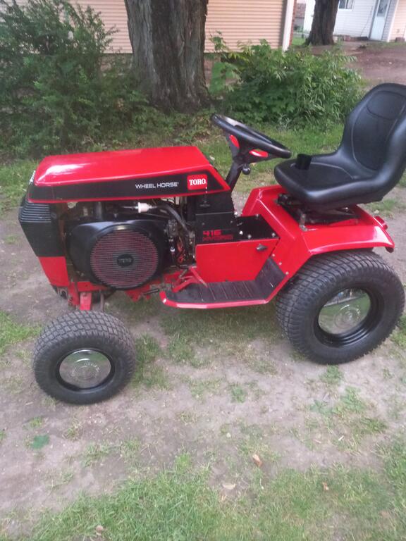

Cee245 861 #16040 Posted June 13, 2022 Put all new tires on and cleaned up my 416H a little bit. Used the card method to paint rims. Worked well overall although putting the cards on the rear rims was tougher as the slightest wind blew them over. On the front, they were very secure and stood more upright. Which is why I taped the front tires and painted the rears by the doors of the shed to avoid fumes. This machine is prob not going to be used much mowing anymore which is why I went with black rims. 10 5 Share this post Link to post Share on other sites

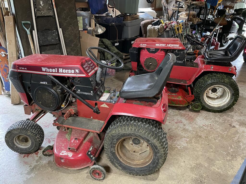

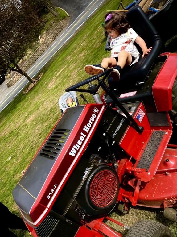

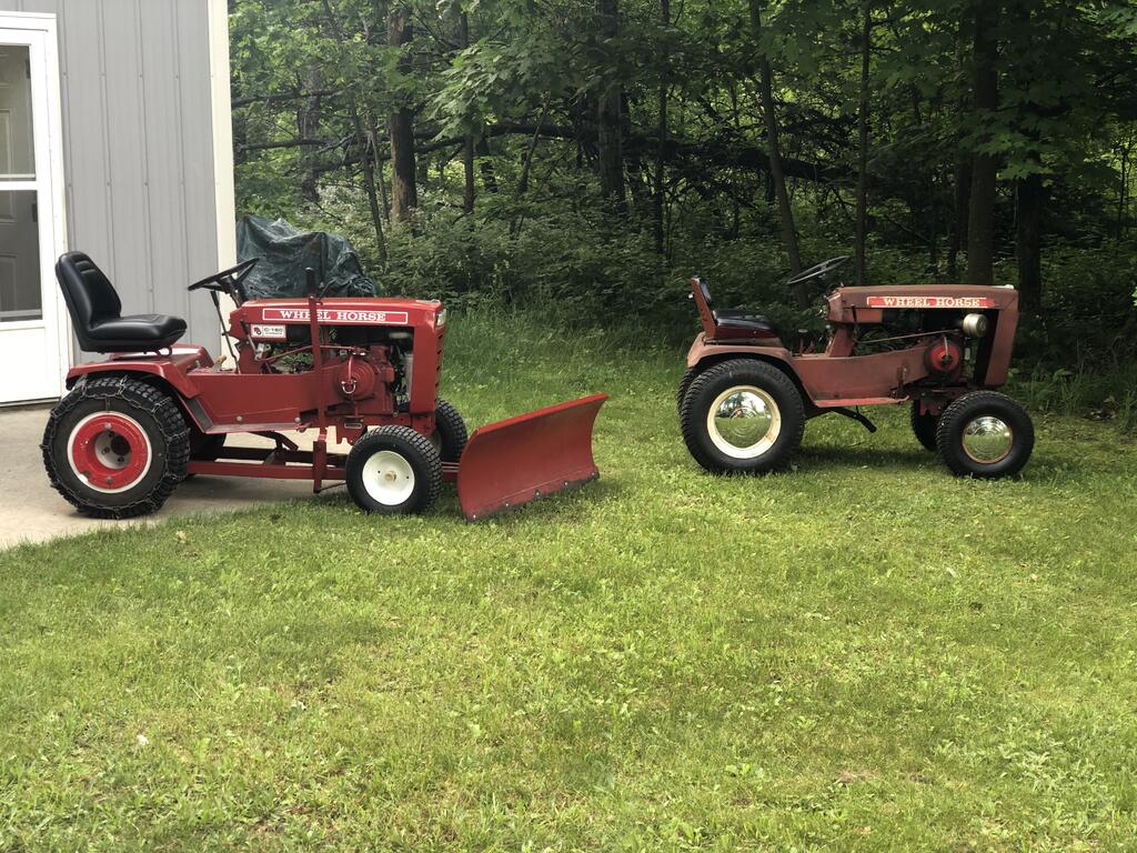

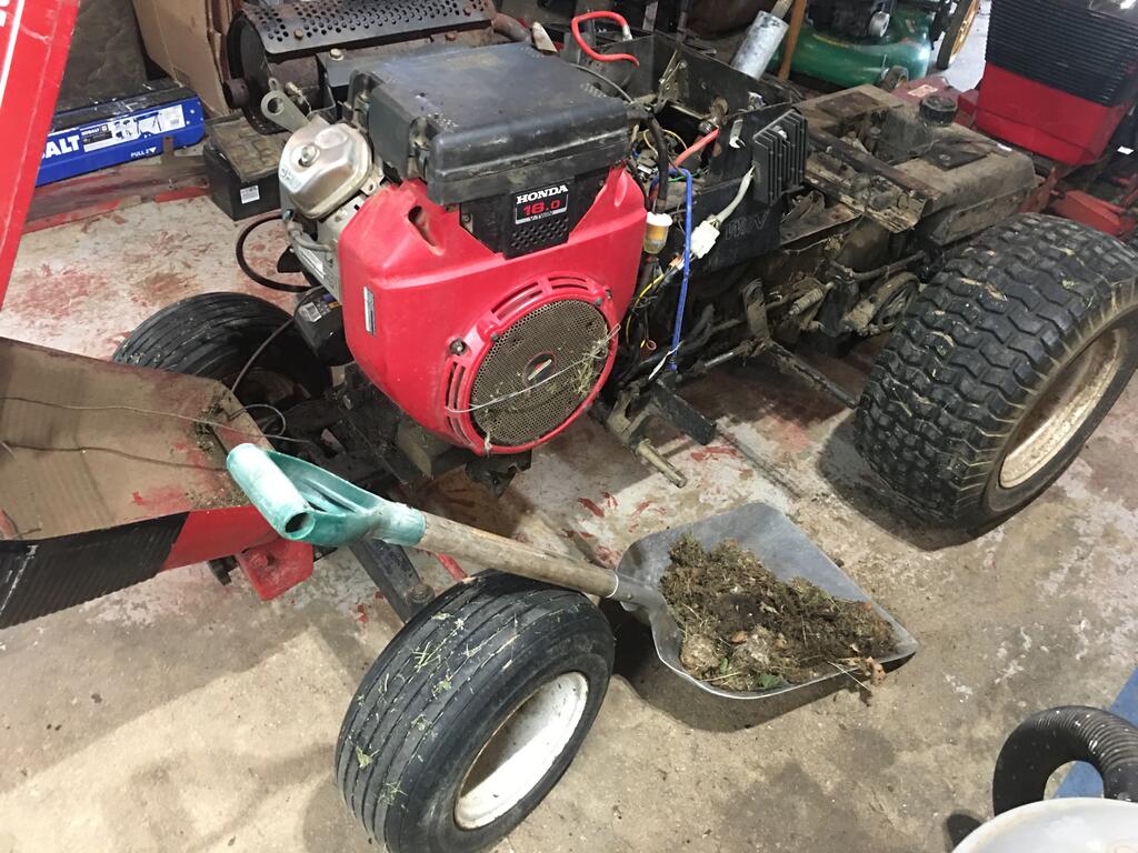

davem1111 2,381 #16041 Posted June 13, 2022 Did some mowing with the GT-1848 with the recently repaired and mostly repainted 48" deck, but then I blew the bearings on the drive belt idler pulley, so I finished mowing with the 312-A and 42" deck. I had been away so the grass was about a foot tall in many places - gotta go over it all again in a few days. Here are the 2 tractors mentioned, resting in the garage last night: I won't have the new idler pulley till Tuesday but got a new belt already at Rural King. Took things apart and found that the whole compartment under the shifter plate had been filled up with bedding by mice. What's in the shovel was about 2/3 of what came out, the rest was sucked up by the shop vac: Gave the GT a power wash next, mainly to get the crud out of the cooling fins on the hydro pump: 7 3 Share this post Link to post Share on other sites

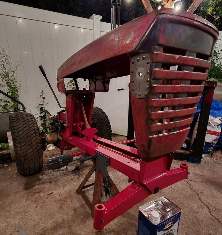

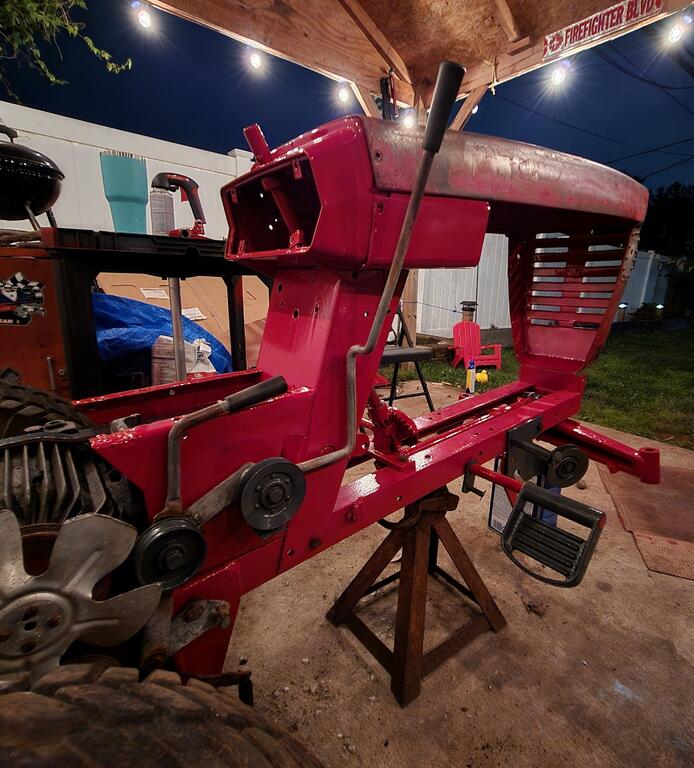

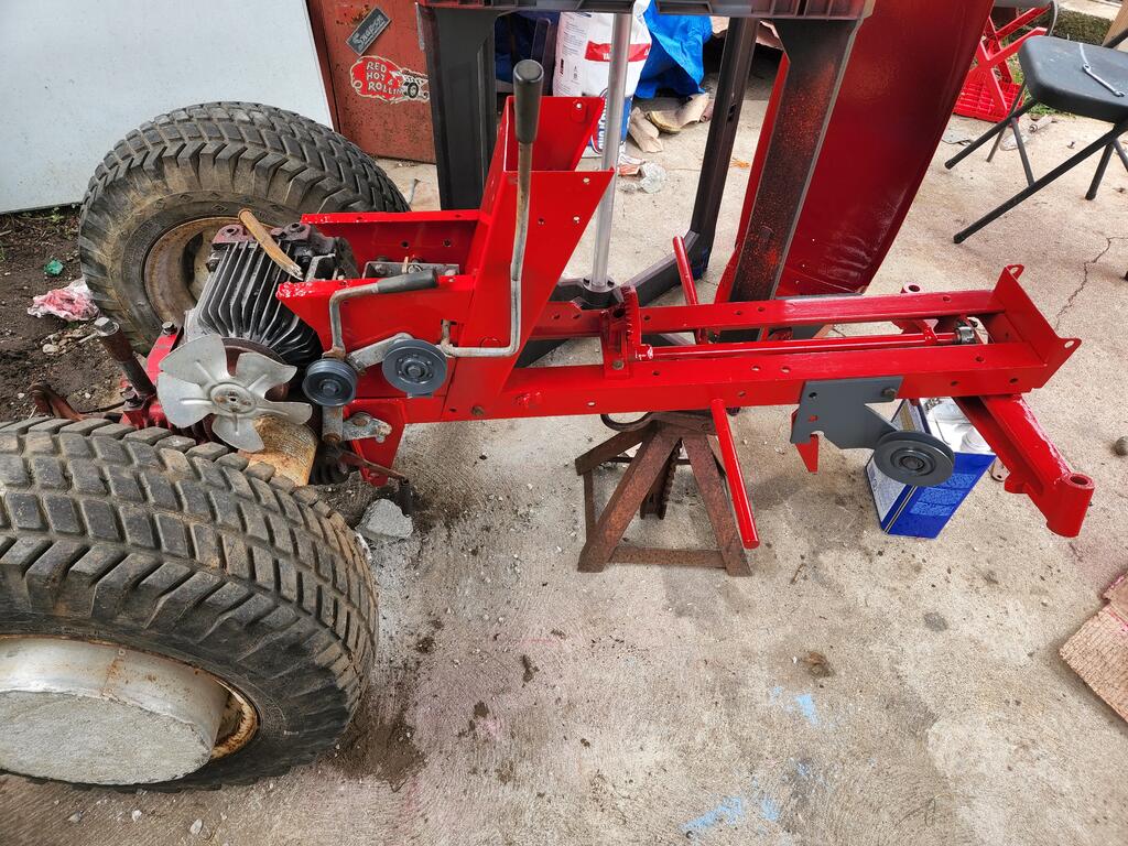

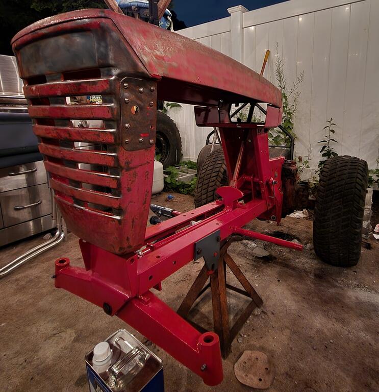

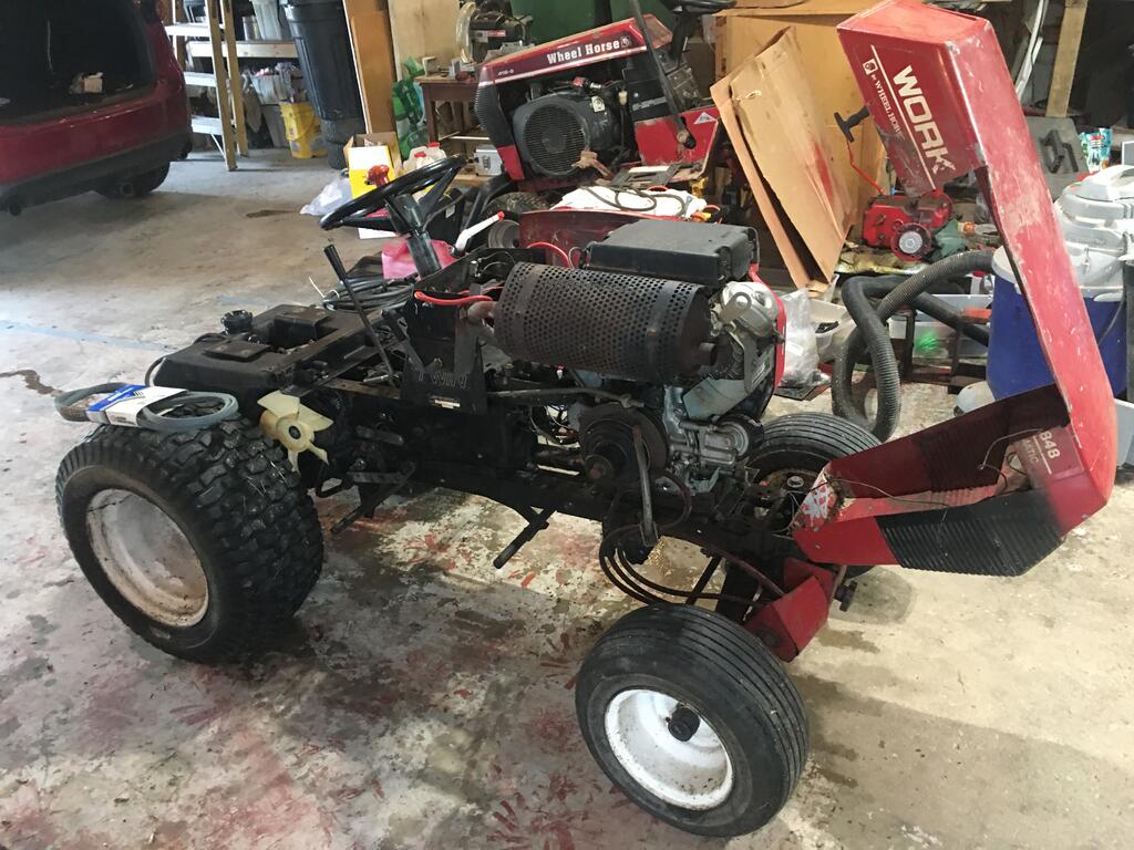

Monstrosity 1,153 #16042 Posted June 13, 2022 Assembly has begun trying to get it back together quickly hood and fender pan still need paint. The plate welded to fix has become a problem with the parking brake lever... now need to add a bend to those brackets. Need to get the wheel weights off still and want to test the trans before tearing apart it seemed to start to fail but I did not have the correct belt on it... Inspector is in bed and couldn't give his approval yet. 9 2 Share this post Link to post Share on other sites

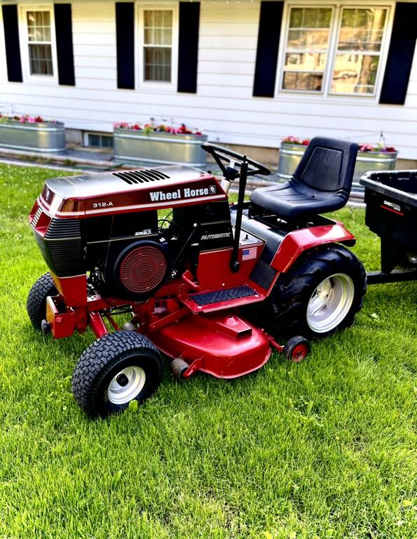

josephvigg 88 #16046 Posted June 13, 2022 The past few weekends we - replanted the raised flower beds, thatched and reseeded the lawn, swept the property, got a good tan, oh and of course gave the old girl a nice bath. 9 11 Share this post Link to post Share on other sites

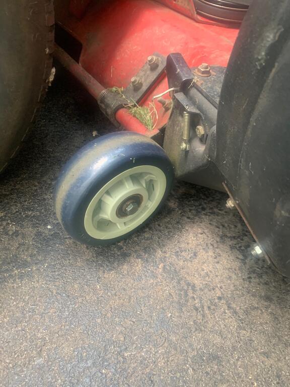

Sewman 20 #16048 Posted June 14, 2022 (edited) I found a broken 6-wheel stock cart where there's 2)wheels on each end that swivel & the center ones are stationary.I'm scrapping it & took the larger center wheels off & the have some nice sealed ball bearings in them & finally last Sat. I decided to mount them on my deck.They have a 1/2" bore so I got a couple bushings 3/8" to 1/2" 2)3 1/2" 3/8" bolts & put them on. Edited June 14, 2022 by Sewman 2 3 Share this post Link to post Share on other sites
Maxwell-8 4,371 #16049 Posted June 14, 2022 9 minutes ago, Sewman said: I found a broken 6-wheel stock cart where the 2 on each end swivel & the center ones are stationary.I'm scrapping it & took the larger center wheels off & the have some nice sealed ball bearings in them & finally last Sat. I decided to mount them on my deck.They have a 1/2" bore so I got a couple bushings 3/8" to 1/2" 2)3 1/2" 3/8" bolts & put them on. I am not a big fan of the stock deck wheels replaced mine with some compressor wheels that also have nice sealed bearings. 3 Share this post Link to post Share on other sites
