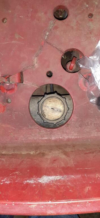

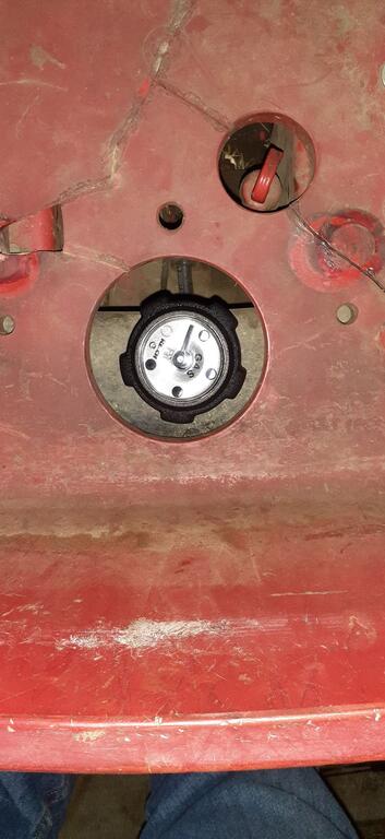

Aaron Coffman 55 #15904 Posted May 26, 2022 Put on a new "Stens" replacement gas cap for my 1981 Wheel Horse Manual C-125. Before and after photos are below. Very happy with the new product! 6 1 Share this post Link to post Share on other sites

peter lena 10,079 #15908 Posted May 26, 2022 @Aaron Coffman , welcome aboard , being a newbie , have you ever checked that trans dip stick right there ? how about the related shift boot ? if oil is milky or funky looking or if shift boot is torn / ripped , time to change both . always look for related issues as you check things , use a razor blade to cut off shifter boot , use dielectric grease on shifter shaft top and related boot hole for easy installation. pete 1 1 Share this post Link to post Share on other sites

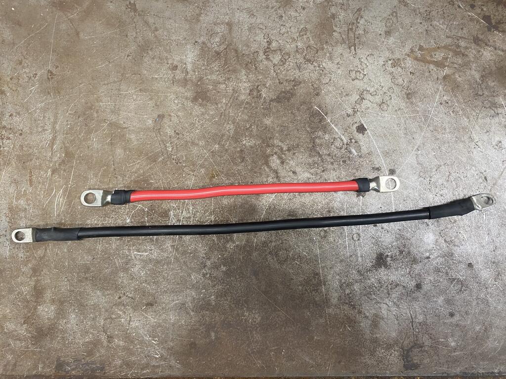

BrianKoch 370 #15909 Posted May 26, 2022 Made new battery cables. 3 5 Share this post Link to post Share on other sites

peter lena 10,079 #15912 Posted May 26, 2022 @BrianKoch nice job on those . bolt one to battery ground bolt point behind dash , other end to corner of engine , clutch pedal side , use serrated washers and dielectric grease . that will enhance grounding for electrical rectifier , on engine tin , also go from rectifier area with a separate wire for better headlight grounding , you will also probably notice your amperage gauge , working with more action due to better grounding . also like your large mount holes , look like 3/8 " ? keep it sparky , pete Share this post Link to post Share on other sites

Aaron Coffman 55 #15914 Posted May 26, 2022 2 hours ago, peter lena said: @Aaron Coffman , welcome aboard , being a newbie , have you ever checked that trans dip stick right there ? how about the related shift boot ? if oil is milky or funky looking or if shift boot is torn / ripped , time to change both . always look for related issues as you check things , use a razor blade to cut off shifter boot , use dielectric grease on shifter shaft top and related boot hole for easy installation. pete Thank you for the advice! 1 Share this post Link to post Share on other sites

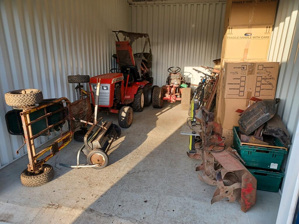

Dan.gerous 2,696 #15916 Posted May 26, 2022 Third wheelhorse in their temporary new home. One more joining them tomorrow but the last one will stay for yard maintenance until the day we leave. Off early in the morning to pick up the two Yanmar diesels 15 Share this post Link to post Share on other sites

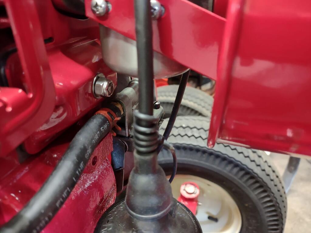

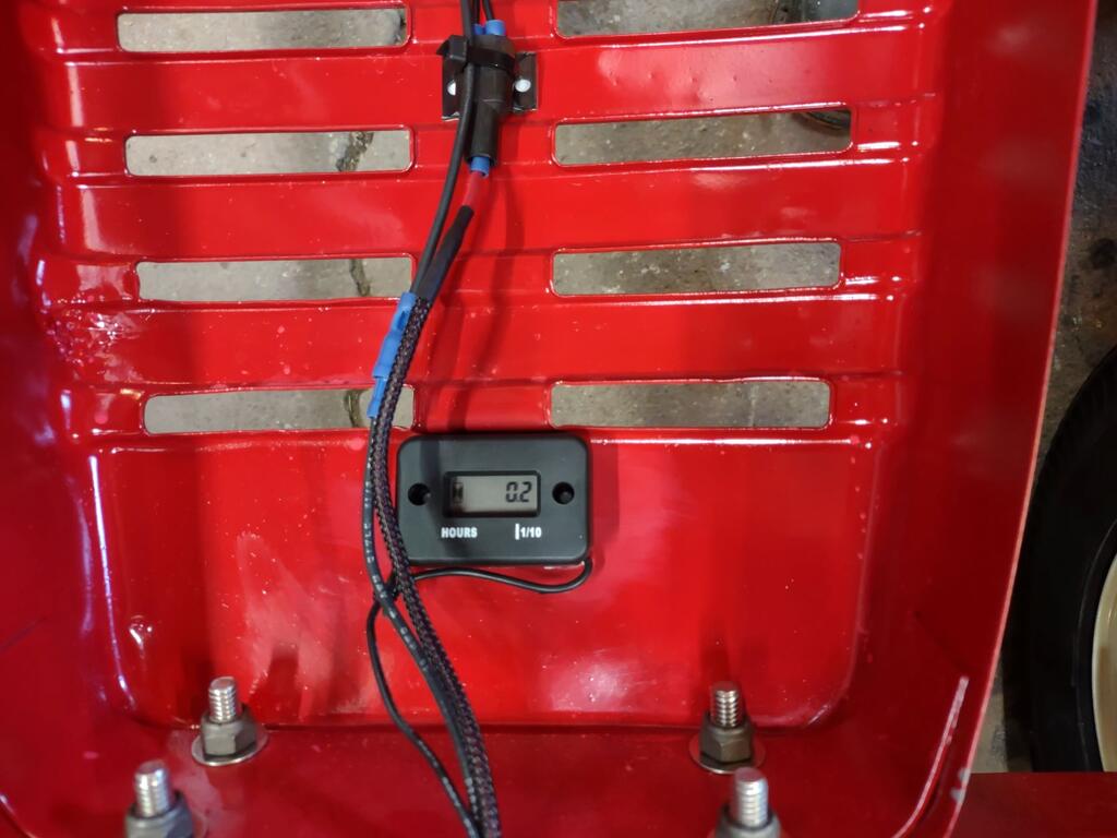

Achto 32,816 #15919 Posted May 27, 2022 Installed an hour meter on the 867 that I restored over the past winter. I did not want to cut a hole to mount a 2" gauge so I opted for one with an inductive pick up that I could hide inside of the hood. These are great little hour meters that will literally work on any engine that has a spark plug. No battery power required. For anyone that may be interested in one of these hour meters. https://www.amazon.com/Magicalmai-Inductive-Motorcycle-Snowmobile-Waterproof-Hour/dp/B07Y3ZYBLW/ref=sr_1_8?crid=22NAEGQFGZR19&keywords=small+engine+hour+meter+waterproof&qid=1653694140&sprefix=small+engine+hou%2Caps%2C106&sr=8-8 9 6 3 Share this post Link to post Share on other sites
sjoemie himself 3,232 #15920 Posted May 28, 2022 That is a nice unit. My dad uses those on his vintage 2-stroke dirt bike to keep track of when the piston needs changing. Works like a charm. I've been looking for an analog rpm-gauge which can be installed in a similar way but so far haven't been lucky enough to find one. They all seem to be digital. If anyone knows a source please let me know. 3 Share this post Link to post Share on other sites
Tractorhead 9,217 #15921 Posted May 28, 2022 27 minutes ago, sjoemie himself said: That is a nice unit. My dad uses those on his vintage 2-stroke dirt bike to keep track of when the piston needs changing. Works like a charm. I've been looking for an analog rpm-gauge which can be installed in a similar way but so far haven't been lucky enough to find one. They all seem to be digital. If anyone knows a source please let me know. Analog gauges was available about 5years ago for Marine Engines, but actually i also find just digital gauges. use also one on of the Digital on the Bavarian, this is a combo of RPM and Hour meter. it starts automatically if engine turn over. very handy but only digital available. 5 Share this post Link to post Share on other sites
pfrederi 21,204 #15922 Posted May 28, 2022 I bought one of those digital hour meters (Briggs and Stratton brand) when I bought our JD GT235. Worked great for about 5 years then the internal non replaceable battery died. 20 years later tractor still runs great but no hour count... 3 Share this post Link to post Share on other sites

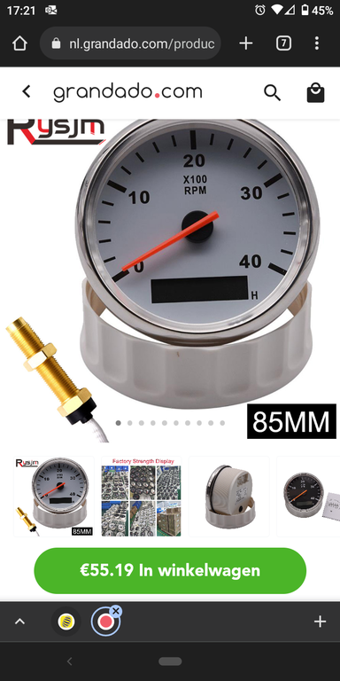

sjoemie himself 3,232 #15923 Posted May 28, 2022 Well I did find this but there's little to no product description available. Now I don't mind a bit of a gamble but electronics are a bit of a mystery to me so I have no idea if I can make it work or not. 1 Share this post Link to post Share on other sites
