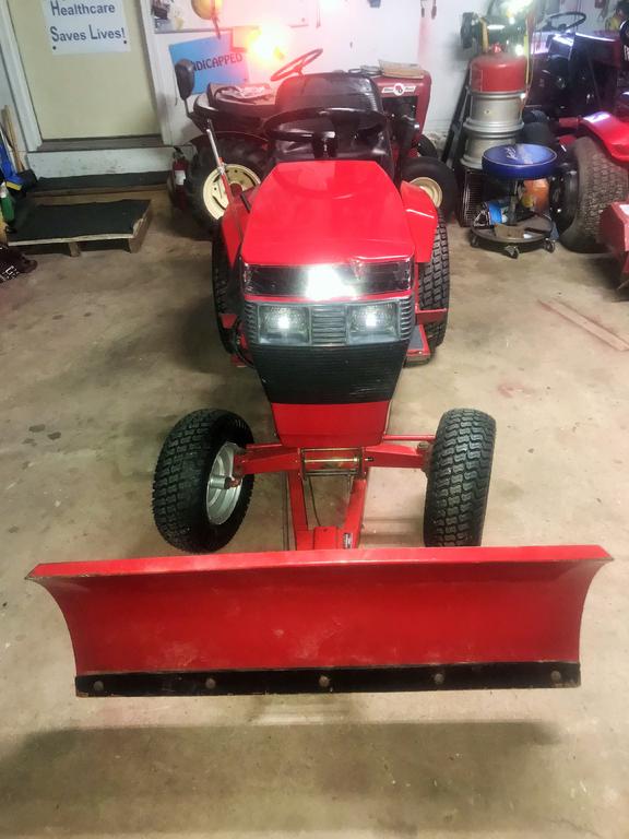

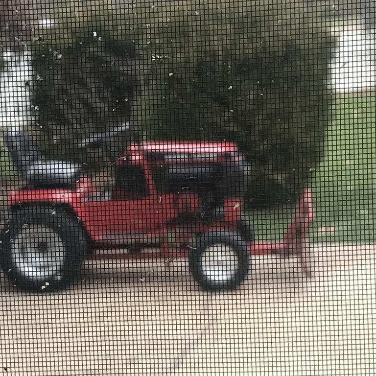

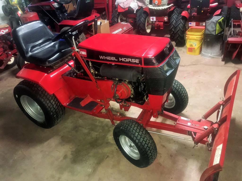

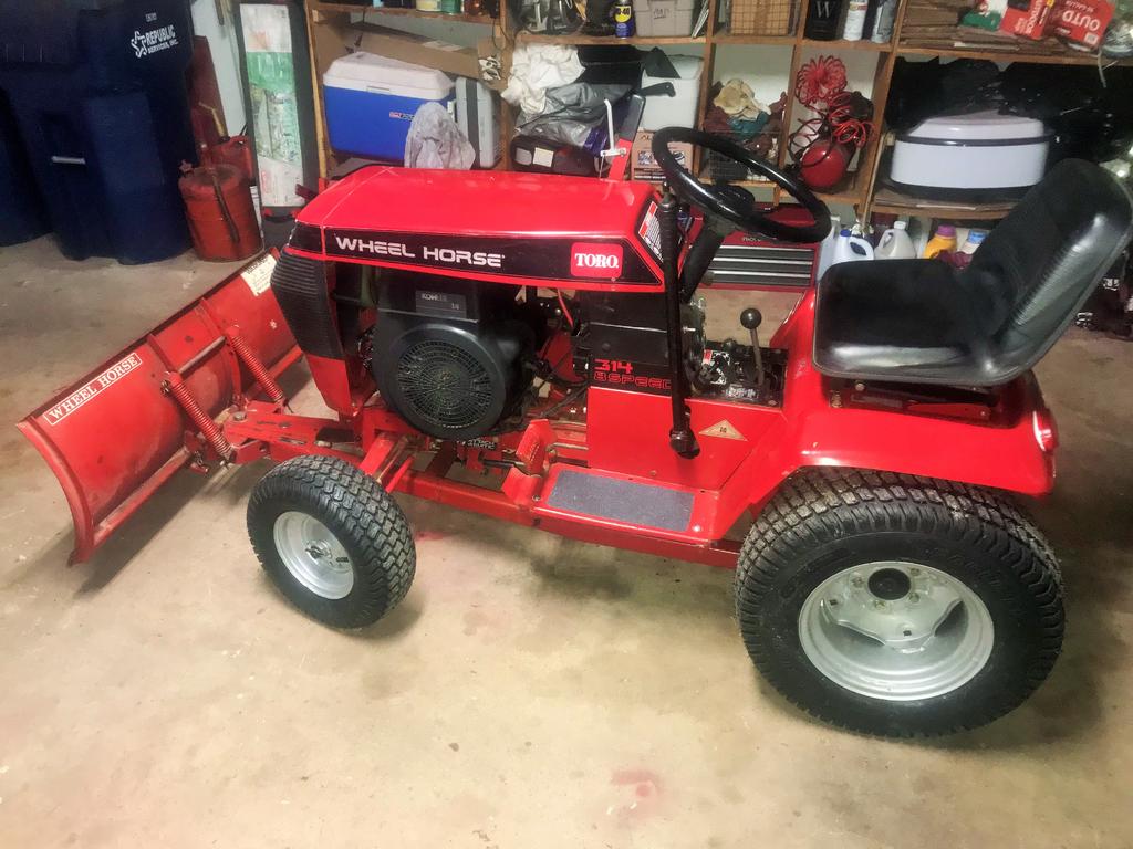

Lane Ranger 12,094 #1551 Posted December 1, 2018 I am ready for the winter also! 314-8 and 42 inch plow all set to go! 6 2 2 Share this post Link to post Share on other sites

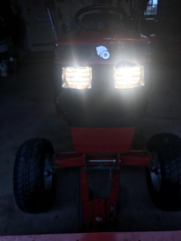

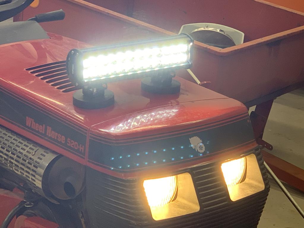

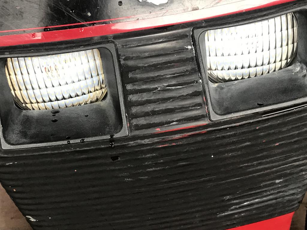

edpm3 19 #1567 Posted December 7, 2018 (edited) Fixed the headlights. It was a reluctant switch. Cleaned it up and it works fine. Replaced the incandescent bulbs with LEDs. For good measure, added an LED light bar and harness with rare earth magnet mounts. All items sourced from Amazon. I have some matte black adhesive vinyl I may try on the chute to help cut the reflective glare. Edited December 7, 2018 by edpm3 3 3 1 Share this post Link to post Share on other sites
Tractorhead 9,217 #1568 Posted December 8, 2018 (edited) On 29. November 2018 at 5:21 PM, edpm3 said: LED Lightbar Hi, suggesting to PIAA's. if you need extreme light get the 18" one is more tan enough...... 😎 Trust me 😉 Oh, too late - i didn't see your last items before i wrote...😇 Edited December 8, 2018 by Tractorhead Share this post Link to post Share on other sites

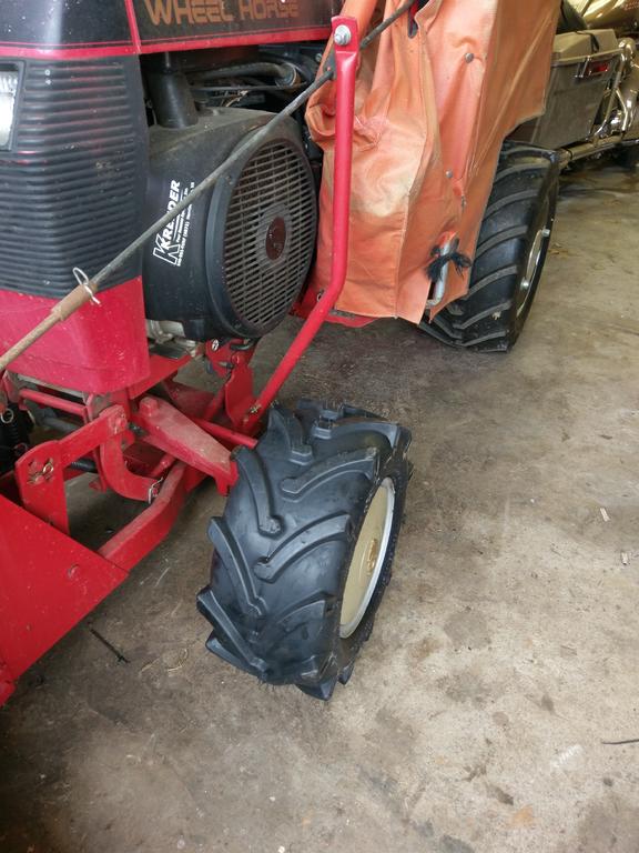

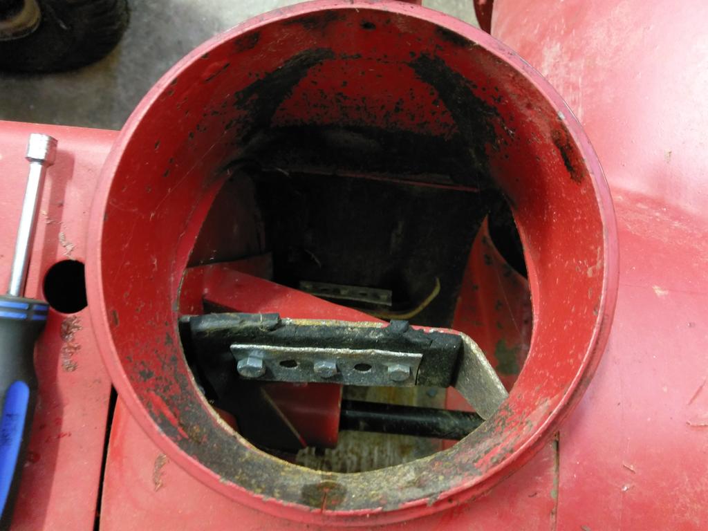

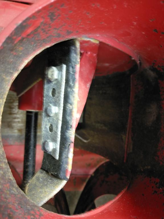

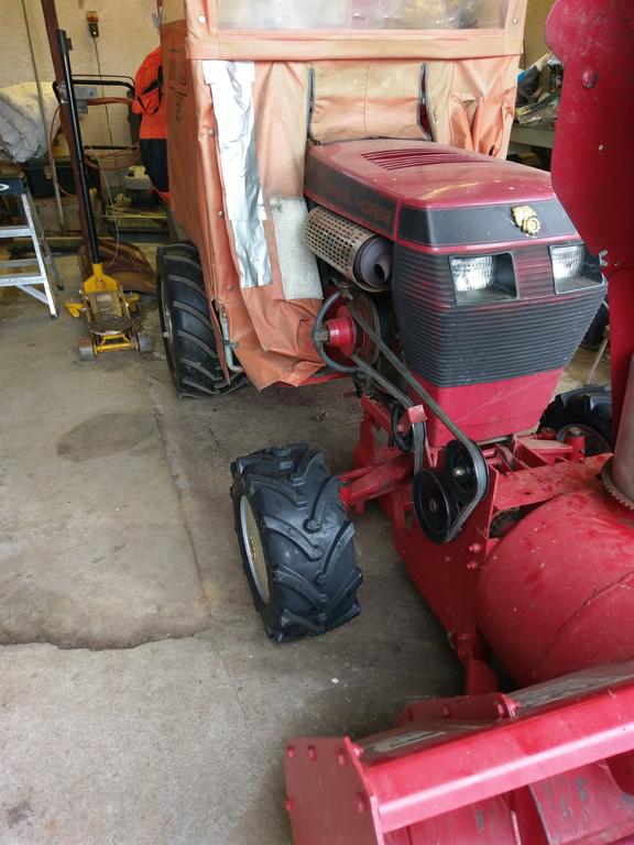

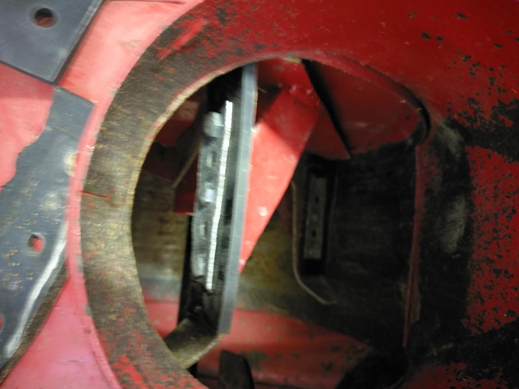

WVHillbilly520H 10,379 #1571 Posted December 8, 2018 Replaced the torn rubber impeller paddle extensions and gave it another pair of new front shoes to match the rears, Jeff. 3 6 Share this post Link to post Share on other sites
PeacemakerJack 11,039 #1572 Posted December 8, 2018 Looks good Jeff! I really like the style of those tires, sharp. With those paddle extensions fixed, you are ready for the nasty stuff when it shows up again. Hopefully this time around it will just be powder snow and not that garbage you received last time! 1 1 Share this post Link to post Share on other sites
Tractorhead 9,217 #1573 Posted December 8, 2018 Are these kena Bear claw's tyres? Looks good ! 👍 Share this post Link to post Share on other sites
Chris G 3,385 #1574 Posted December 8, 2018 I love them tires! But if you use a snow blade you can't turn very far with them fronts. But I will definitely be using mine again when it's back to the mud. Those tires are great though. 1 Share this post Link to post Share on other sites
WVHillbilly520H 10,379 #1575 Posted December 8, 2018 51 minutes ago, Tractorhead said: Are these kena Bear claw's tyres? Looks good ! 👍 If you're referring to my tires they are "OTR LAWN TRAC R1" (which are original equipment on Kubota) 16x7.50-8 front and 23x10.50-12 rear. 1 1 Share this post Link to post Share on other sites
