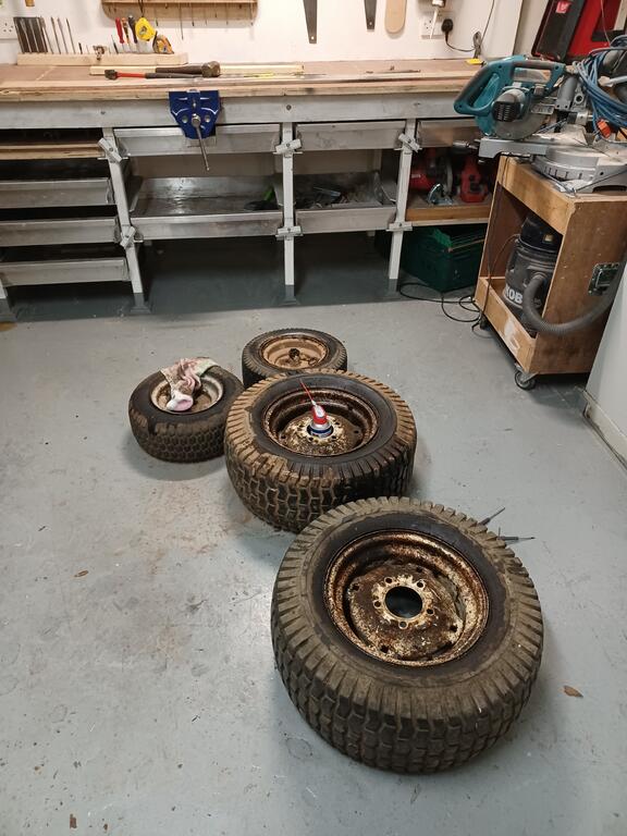

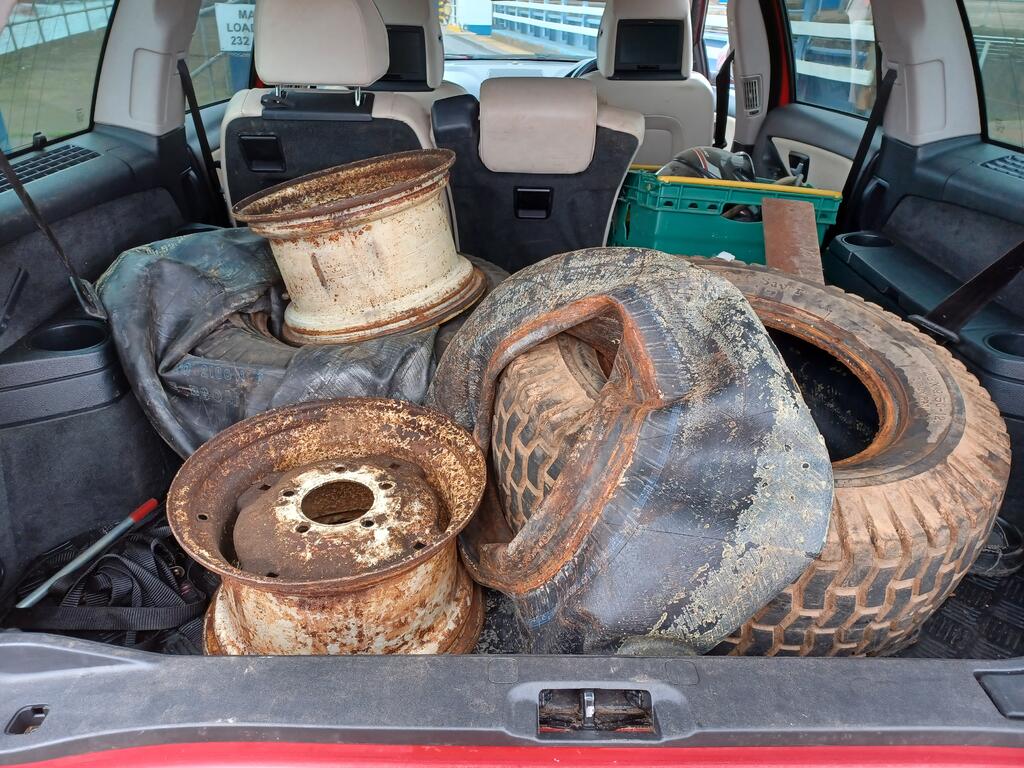

Dan.gerous 2,696 #15626 Posted May 6, 2022 On 5/5/2022 at 8:46 PM, Dan.gerous said: Unloaded the car into the workshop on the ship, will fetch the plow on if I get the wheels done. They are solid on the rims so have left them soaking in WD40 for a while, hopefully that will help break the bead....that and a large hammer! Who knows how long they have been on the rims for. Forgot to bring the little key for removing the tyre valve, luckily two very small flat head screw drivers does the same trick. Now its time to go to work, but its strangely comforting having a project from home to keep me busy The big ones are not keen to come off the rims, rust must have welded them on. We are in Aberdeen in the morning so will see if I can get them up to a tyre machine as I dont have a large bolster on here to bully them off. I took one off the van last year and that had a sledge hammer on a bolster and a lot of sweat to get it off. Usually just driving over it is enough to pop the bead. 3 Share this post Link to post Share on other sites

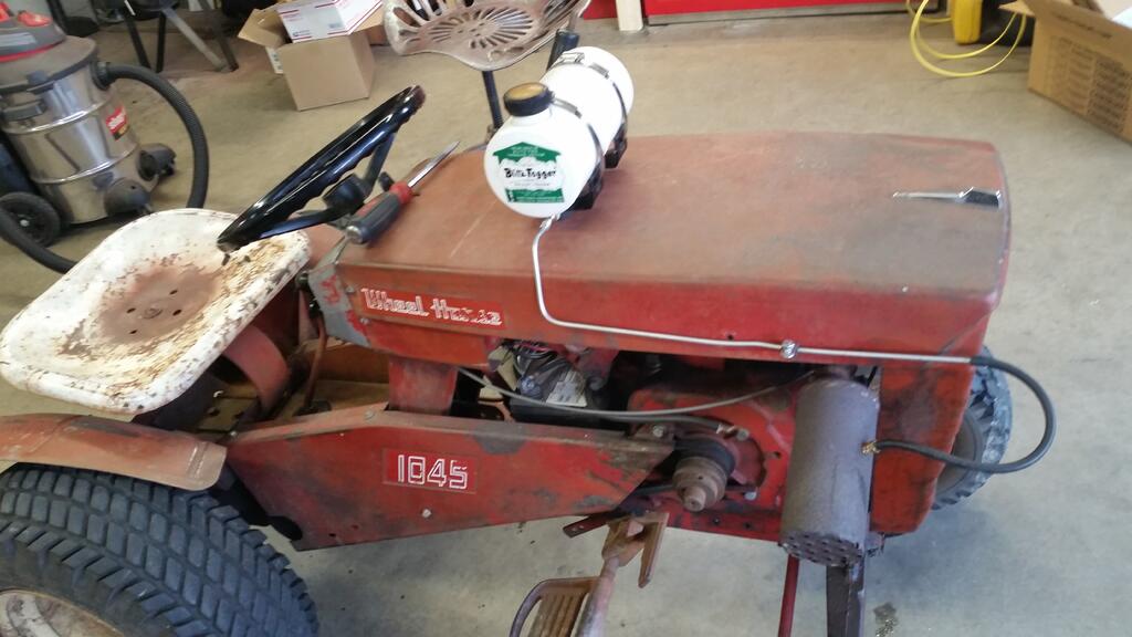

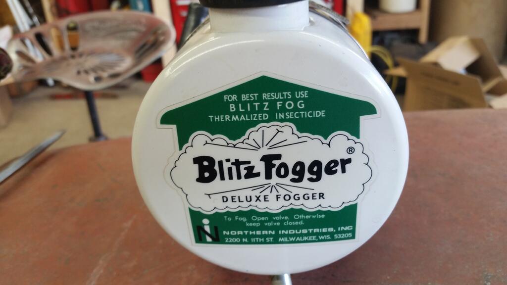

WHX?? 57,685 #15627 Posted May 7, 2022 Skeeter seasons coming.... best get the Biltz Fogger on and operational. 6 5 Share this post Link to post Share on other sites
ebinmaine 80,190 #15628 Posted May 7, 2022 12 minutes ago, WHX?? said: Skeeter seasons coming.... best get the Biltz Fogger on and operational. Interesting piece, those. I have one of the tanks here. 2 Share this post Link to post Share on other sites
kpinnc 18,871 #15629 Posted May 7, 2022 2 hours ago, Dan.gerous said: The big ones are not keen to come off the rims, rust must have welded them on. On the rear wheels- I've used a 2x6 board about 3 feet long, set on the tire almost to the edge of the rim like a ramp, then ease my truck onto the "ramp" with decent results. Usually the bead breaks as soon as you get the weight onto the plank. Then back up, flip the wheel, and repeat on the other side. ...of course with the valves removed. My make a loud bang otherwise. 2 3 Share this post Link to post Share on other sites
Dan.gerous 2,696 #15630 Posted May 7, 2022 2 hours ago, kpinnc said: On the rear wheels- I've used a 2x6 board about 3 feet long, set on the tire almost to the edge of the rim like a ramp, then ease my truck onto the "ramp" with decent results. Usually the bead breaks as soon as you get the weight onto the plank. Then back up, flip the wheel, and repeat on the other side. ...of course with the valves removed. My make a loud bang otherwise. That sounds easier than the way I do it, usually just diving onto the tyre - however haven't had to resort to that with a wheelhorse rim yet, and a car tyre is a larger target! Will have a play today with the big electric buggy and a plank, and if that fails there is a tyre shop just up the road, although that would seem like accepting defeat and also probably cost money. 2 Share this post Link to post Share on other sites

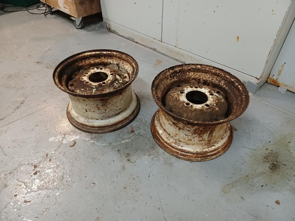

Dan.gerous 2,696 #15632 Posted May 7, 2022 Managed to blag my way for the tyre bloke to ping these off today. Didn't want paying but I got them a box of chocolates as a thank you. Now the job can begin. 10 Share this post Link to post Share on other sites
ebinmaine 80,190 #15633 Posted May 7, 2022 26 minutes ago, Dan.gerous said: Managed to blag my way for the tyre bloke to ping these off today. Didn't want paying but I got them a box of chocolates as a thank you. Now the job can begin. Looks by the rust rings they were well fastened. 4 Share this post Link to post Share on other sites
Dan.gerous 2,696 #15634 Posted May 7, 2022 4 minutes ago, ebinmaine said: Looks by the rust rings they were well fastened. Yes, even the machine struggled with one of them, glad I used common sense over valour! 2 2 4 Share this post Link to post Share on other sites

Handy Don 17,261 #15637 Posted May 7, 2022 2 hours ago, Dan.gerous said: Managed to blag my way for the tyre bloke to ping these off today. Didn't want paying but I got them a box of chocolates as a thank you. Now the job can begin. Yeah, can see why those tires and wheels really needed convincing to part company! The rust line on the tube from water coming in around the valve tells the tale. 1 2 Share this post Link to post Share on other sites
Dan.gerous 2,696 #15638 Posted May 7, 2022 30 minutes ago, 8ntruck said: It is nice to be older and to have the resources to have the opportunity to farm out jobs you really don't want, or can't do Does this mean I have finally become a mature, sensible, adult at 47 years old? 🤔 6 Share this post Link to post Share on other sites
Dan.gerous 2,696 #15639 Posted May 7, 2022 18 minutes ago, Handy Don said: Yeah, can see why those tires and wheels really needed convincing to part company! The rust line on the tube from water coming in around the valve tells the tale. This is one of 8 sets lurking about needing painting, luckily these are visibly the worst ones! 2 Share this post Link to post Share on other sites

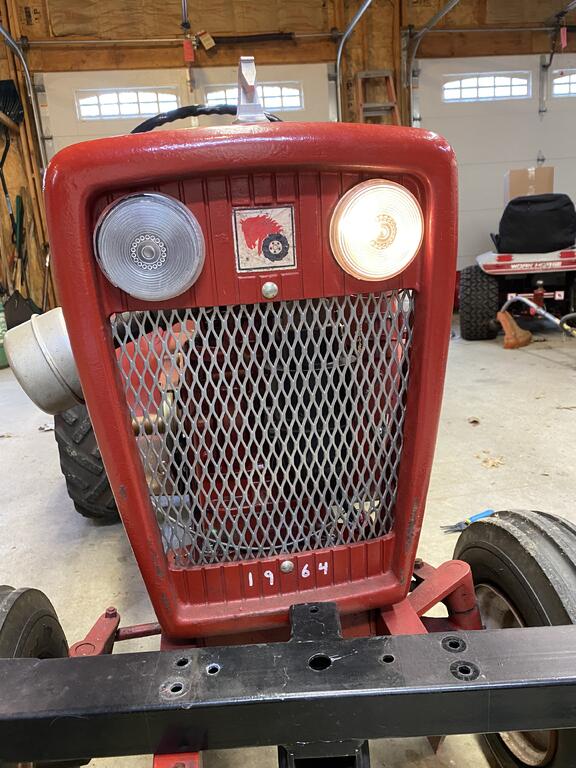

Sparky-(Admin) 26,195 #15643 Posted May 7, 2022 Worked on the wiring on my 1054, got the lights “mostly” lit. One of the headlight lenses disintegrated as soon as I removed it to check the status of the bulb 6 2 Share this post Link to post Share on other sites
ebinmaine 80,190 #15644 Posted May 7, 2022 2 minutes ago, Sparky said: lenses Model glue or careful application of super glue? 1 Share this post Link to post Share on other sites

953 nut 68,346 #15650 Posted May 7, 2022 1 hour ago, Sparky said: headlight lenses disintegrated as soon as I removed it I think Lowell may have some from Glenn's stock or may have already made some. 1 Share this post Link to post Share on other sites
