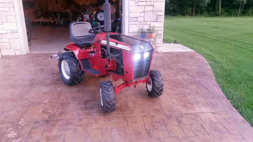

bds1984 1,516 #1528 Posted November 30, 2018 (edited) On 11/28/2018 at 4:52 PM, edpm3 said: Put the snowblower on for the first time in about 15 years. Still works. Headlights are kaput and even when they worked, didn't throw much light so the next project might be an LED light bar. Mine were very dim and just didn't throw much light either. When I refreshed my C165 I replaced the headlamps with some LEDs that were the same size. But after running a snowblower, a light bar mounted up higher, say on the hood, might be a better option. Edited November 30, 2018 by bds1984 Added image Share this post Link to post Share on other sites

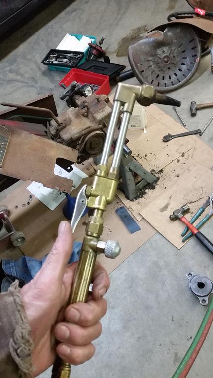

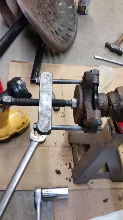

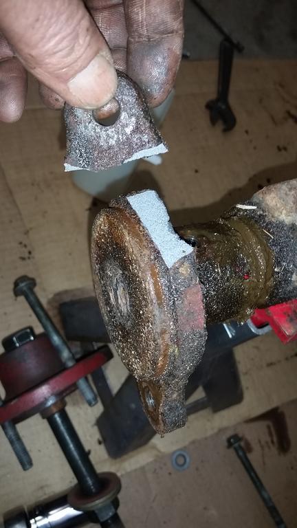

WHX?? 57,863 #1529 Posted November 30, 2018 (edited) I crippled my horse Round two With the persuader Edited November 30, 2018 by WHX21 1 1 4 Share this post Link to post Share on other sites

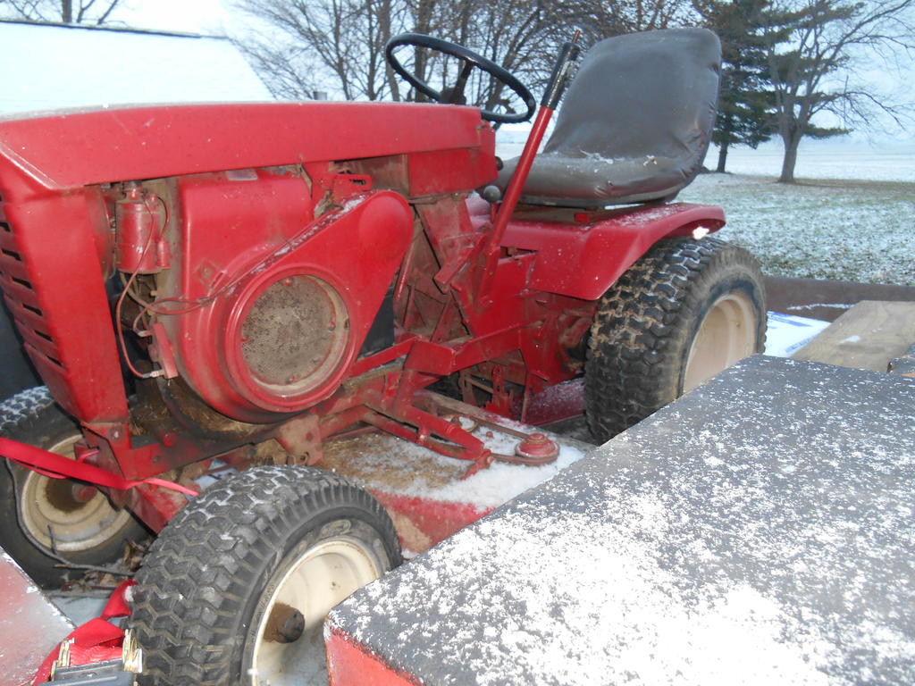

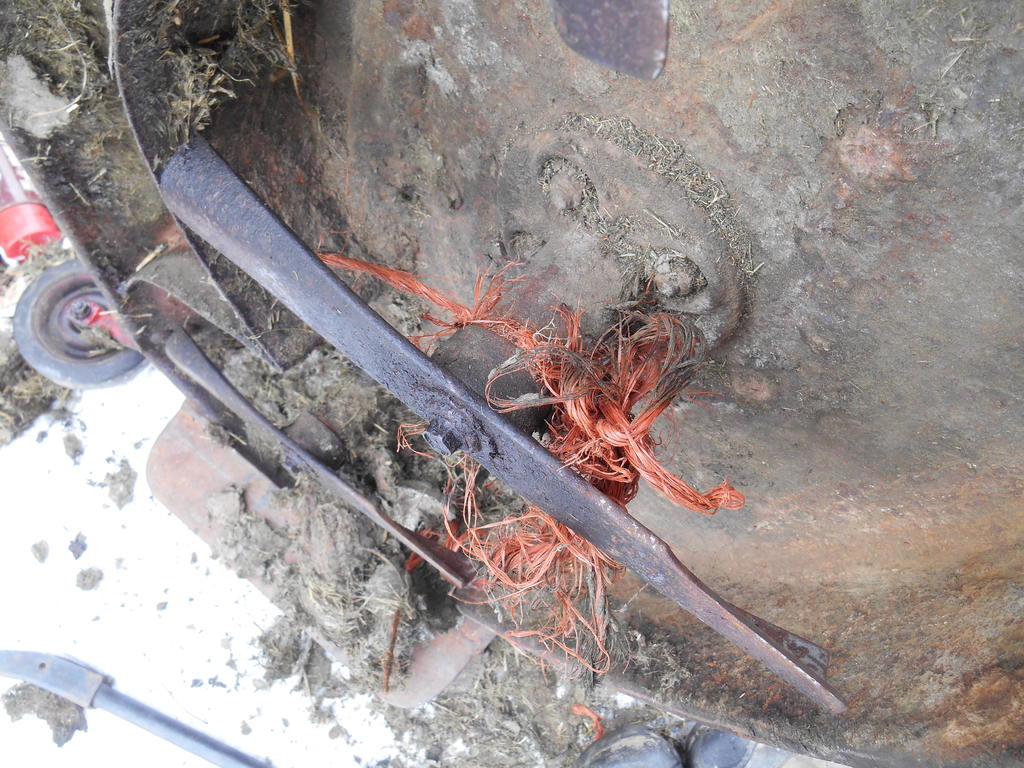

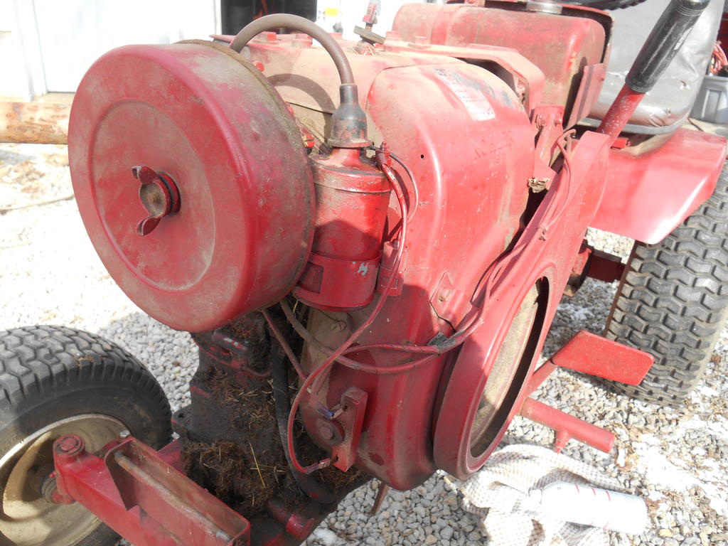

ohiofarmer 3,470 #1532 Posted November 30, 2018 Here is one that i just picked up stole for a buck fifty A little rough here and there. The PO had the battery poles reversed. The battery is good, but the spark is weak. A timing light only flashes occasionally on an installed spark plug. Even though the deck was abused, it is a really thick gauge steel and weighs twice what you would expect. There is an extra part I am not used to. It appears to have a resistor installed before the coil. I don't know whether or not to eliminate that and try a different coil or not. 1 1 Share this post Link to post Share on other sites
953 nut 68,656 #1533 Posted November 30, 2018 1 hour ago, ohiofarmer said: extra part I am not used to. It appears to have a resistor installed before the coil. Good Buy! A lot of automotive coils didn't have the built in resistor like our so the external resister was used. I bet if you clean up the points you will have a stronger spark. Share this post Link to post Share on other sites
pfrederi 21,088 #1534 Posted November 30, 2018 If the PO reversed the battery (making it a positive ground) did he also reverse the wires on the coil? If you have corrected the battery terminals make sure the feed from the ballast resister goes to the + terminal on the coil the wire to condenser and points on the -. In a positive ground system those connections are reversed. 1 Share this post Link to post Share on other sites

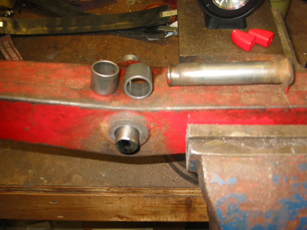

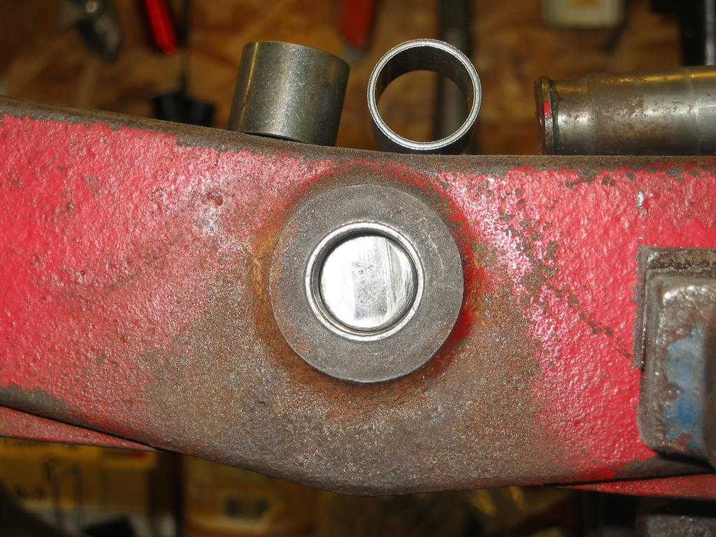

pfrederi 21,088 #1535 Posted November 30, 2018 Been working at tighten up a very sloppy front axle pivot. Drilled out the pivot hole in the axle to 7/8" then pressed in two sleeves to get back down to 3/4". Had to do a bit of reaming as I think the sleeves ID shrank a bit when pressed in. But now the pivot pin slides in and out nicely and is wobble free. Have to work on the front of the frame hole as it is a bit sloppy. You can see how worn the existing pin was, lying on top of axle. 4 Share this post Link to post Share on other sites
ebinmaine 80,423 #1536 Posted November 30, 2018 12 minutes ago, pfrederi said: shrank a bit when pressed in. But now the pivot pin slides in and out nicely Paul is this the kind of thing that can be done on a really big vice? Or do you really need more of a heavy-duty press? Share this post Link to post Share on other sites
pfrederi 21,088 #1537 Posted November 30, 2018 2 minutes ago, ebinmaine said: Paul is this the kind of thing that can be done on a really big vice? Or do you really need more of a heavy-duty press? The pressing in wasn't hard. Tricky part was getting the hole drilled out nicely. Required a fair amount of fiddling around on the drill press to make sure it would drill straight and true. Chucked in a 3/4 bit and slide the axle over it. Took awhile and shims to get the axle securely clamped to the table and keep bit centered. Then had to swap out bit to 7/8 for the drilling. Share this post Link to post Share on other sites
ebinmaine 80,423 #1538 Posted November 30, 2018 4 minutes ago, pfrederi said: fiddling around on the drill press Mounting things on my drill press is another one of the skills I need to acquire over the next few months. I only have a very small basic drill press Vise to hold stuff and it's a very cheap piece. I'm hoping to pick up a used one somewhere at some point or another that won't break the bank but is of decent usable quality. Share this post Link to post Share on other sites
pfrederi 21,088 #1539 Posted November 30, 2018 2 minutes ago, ebinmaine said: Mounting things on my drill press is another one of the skills I need to acquire over the next few months. I only have a very small basic drill press Vise to hold stuff and it's a very cheap piece. I'm hoping to pick up a used one somewhere at some point or another that won't break the bank but is of decent usable quality. Used wooden shims and big C clamps to hold it to the table. 1 Share this post Link to post Share on other sites
ebinmaine 80,423 #1540 Posted November 30, 2018 1 minute ago, pfrederi said: Used wooden shims and big C clamps to hold it to the table. I guess I'm going to have to try some experimenting. I already have those things. Share this post Link to post Share on other sites
pfrederi 21,088 #1541 Posted November 30, 2018 2 minutes ago, ebinmaine said: I guess I'm going to have to try some experimenting. I already have those things. Issue is there is only the front surface of the axle that is a right angle to the pivot hole and there is small collar around the hole you have to shim to make up for that and then the c clamps are pulling against a tapered surface on the back of the and they wanted to slip. Just took some fiddling nothing over whelming.... Share this post Link to post Share on other sites
cleat 9,262 #1542 Posted November 30, 2018 Looking good. A lot of wear on the ends of the pin is likely because the tab on the pin broke off allowing the pivot to tale place on the ends VS in the axle where it should. Cleat Share this post Link to post Share on other sites

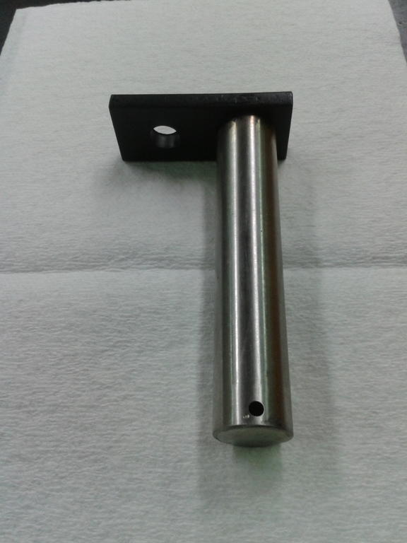

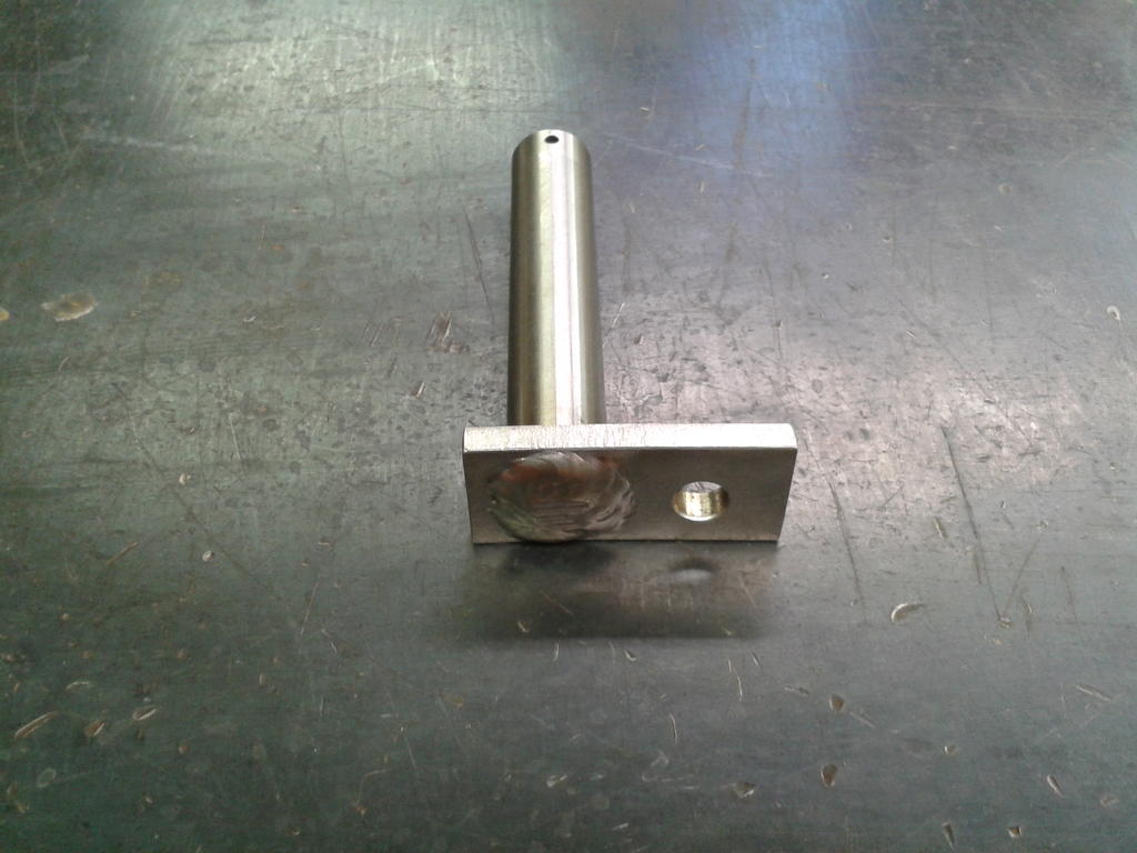

pfrederi 21,088 #1543 Posted November 30, 2018 Does anyone know why WH put a groove in the front of the pivot pin for a snap ring. The plate on the back end that bolts to the frame should keep it form going either forward or backwards. I made a new pin but do not have the tools to make a snap ring groove. Don't think I need it but want to make sure. Share this post Link to post Share on other sites
Lee1977 7,750 #1544 Posted December 1, 2018 3 hours ago, pfrederi said: Does anyone know why WH put a groove in the front of the pivot pin for a snap ring. The plate on the back end that bolts to the frame should keep it form going either forward or backwards. I made a new pin but do not have the tools to make a snap ring groove. Don't think I need it but want to make sure. I don't know why they put a snap ring there, but I do now what it does. It keeps the pin in place after the tab brakes. With out it and a broken tab the pin could lock up the steering. If you have made the pin long enough you can use a washer and carter key. We put a snap ring groove in mine as I have a friend with a lathe. I also used a 3/16" thick tab. Share this post Link to post Share on other sites
ohiofarmer 3,470 #1545 Posted December 1, 2018 10 hours ago, pfrederi said: If the PO reversed the battery (making it a positive ground) did he also reverse the wires on the coil? If you have corrected the battery terminals make sure the feed from the ballast resister goes to the + terminal on the coil the wire to condenser and points on the -. In a positive ground system those connections are reversed. I checked and the points and condenser go to the terminal marked {dist.} or distributor, I assume. The PO included a new in box coil with an included receipt. I took it back for another $43.00 refund, So we are into this horse for $107.00 so far. The parts of the failed raider ten engine should bring that spark back. For all I know, the PO having the battery poles reversed may have messed up the old coil and resistor? Anyway, I really appreciate your input as it addressed some concerns . I now understand that the coil that was on there was not correct. I also will take the time to check all the connections and clean/file the points for a dependable spark. 1 Share this post Link to post Share on other sites
cleat 9,262 #1546 Posted December 1, 2018 2 hours ago, Lee1977 said: I don't know why they put a snap ring there, but I do now what it does. It keeps the pin in place after the tab brakes. With out it and a broken tab the pin could lock up the steering. If you have made the pin long enough you can use a washer and carter key. We put a snap ring groove in mine as I have a friend with a lathe. I also used a 3/16" thick tab. When I make new pins, I drill a hole for a cotter key. Not really needed, just for safety. Hate to lose control at full mowing speed. Here are the plans I use. Front axle pin plans.pdf Here is the completed pin. Cleat 4 Share this post Link to post Share on other sites
R. L. Addison 300 #1547 Posted December 1, 2018 If I was to drill & bush that hole, I would take two identical pieces of flat stock & put between machine table & machined boss & clamp it. Clearance would have to be provided for the drill to go through without drilling into the table, & clamping (for position) would be easier on the other face of the machined boss. Wish I could draw you a picture as I'm afraid I'm being confusing. MMmm m m m let me stew on that for a while,. maybe I can do it with a camera after Mama is home. 1 Share this post Link to post Share on other sites

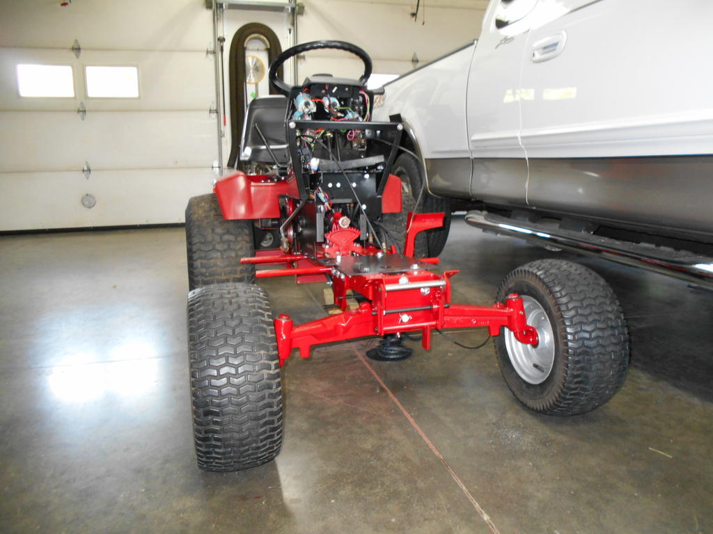

Sarge 3,473 #1548 Posted December 1, 2018 I do a lot of those - it is a very common wear point due to the sheer weight of the engines and all the heavy gauge sheet metal. To top it off, there is slop in nearly all of them between the frame mounting point and the thickness of the pin boss on that axle - I use bronze/brass shim washers to set them close to a zero fit. Generally, I try to leave .010" clearance for grease to keep things lubricated and prevent galling. For the hole for the pin, I use a long length bronze oilite bushing and pick either a thin-walled one or thick walled standard one to accommodate the casting size. Using a full-length bushing helps prevent wear, especially when using a plow blade so it can't focus the stress on either the front or rear portion of the axle casting. The original design incorporated a hollow area in the center for the purpose of storing grease, but it rarely flows into or fills that cavity - which is why they wear out the hole and pin. I make the pins out of the harder grades of 300 stainless - the surface finish and hardness helps to prevent the pin wearing and allows the bushing to do it's job and not wipe out the pin. They can also be made from 1018 steel or similar. Using Super OIlite versus standard oiled bronze helps here too - there is an incredible amount of stress in the center pin and front wheel spindles on these heavy machines. The spindles will show the largest wear and issues, doing the whole axle with bushings/sleeves make them like new again - except better. Sarge Share this post Link to post Share on other sites
Racinbob 13,113 #1549 Posted December 1, 2018 19 hours ago, pfrederi said: Does anyone know why WH put a groove in the front of the pivot pin for a snap ring. The plate on the back end that bolts to the frame should keep it form going either forward or backwards. I made a new pin but do not have the tools to make a snap ring groove. Don't think I need it but want to make sure. Probably being redundant as the others have said. Wheel Horse didn't do it on all the tractors. I have a couple that the pin is flush with the front of the frame. I have no concerns about it. Share this post Link to post Share on other sites

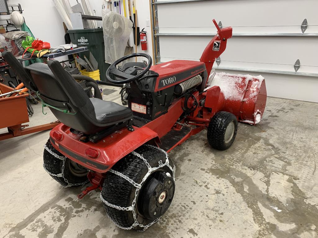

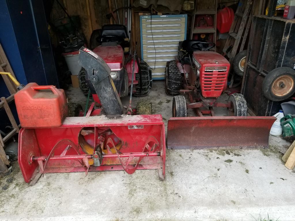

cafoose 3,817 #1550 Posted December 1, 2018 Got my snow equipment ready the last couple days! 1 1 1 Share this post Link to post Share on other sites
