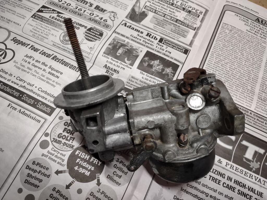

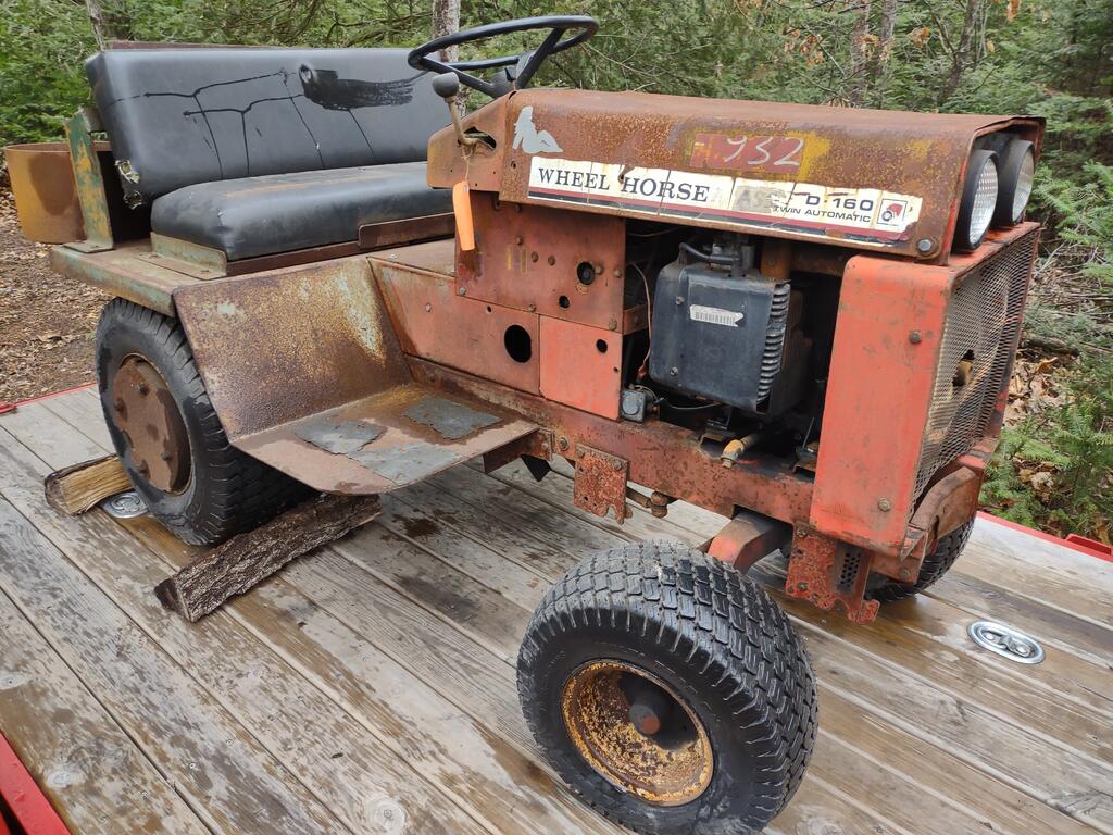

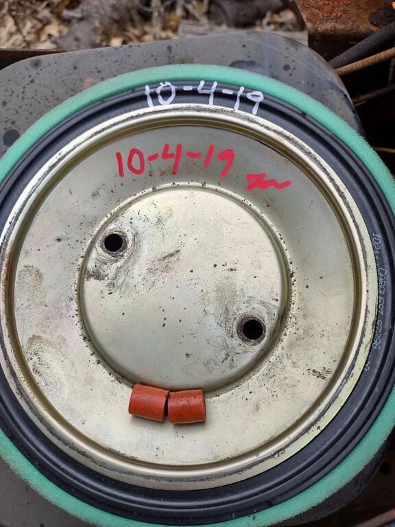

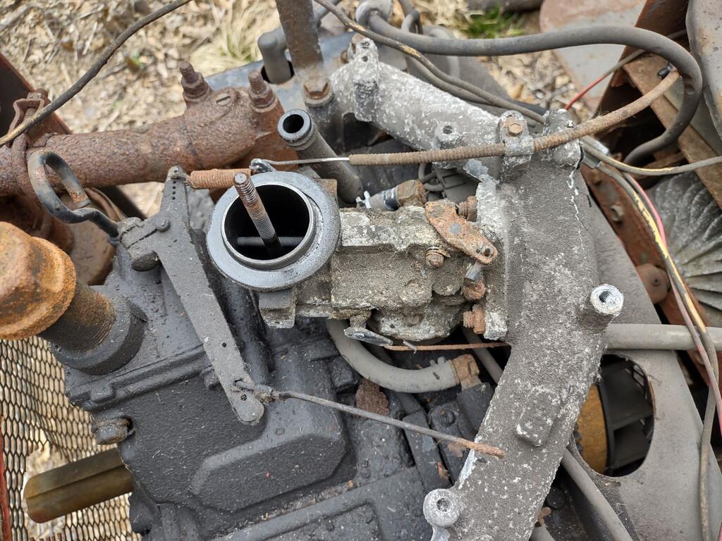

Achto 32,816 #15427 Posted April 25, 2022 (edited) Spent a little time with the newest member of my herd. The starter was not retracting all of the way so it was rubbing when I turned the engine over by hand. I removed the starter and cleaned up the worm gear on it. I did not have any dry graphite on hand to lube the worm gear so I broke some lead out of a contractors pencil and crushed it to use as a dry lube. I had no idea when this tractor has ran last. Was a little hopeful to see that it had some type of service around 3yrs ago. under the air filter looked a bit scary though. After some scrubbing I was able to find a carburetor under all that gunk. Once I get the carb rebuilt I will hook up an IV bottle & see if this beast will run. Edited April 26, 2022 by Achto 10 3 Share this post Link to post Share on other sites
johnnymag3 2,646 #15428 Posted April 25, 2022 Love the sitting woman decal !!!!! 1 2 Share this post Link to post Share on other sites
Achto 32,816 #15429 Posted April 26, 2022 11 minutes ago, johnnymag3 said: Love the sitting woman decal Oh yes, she's keeper. 2 2 Share this post Link to post Share on other sites

WHX?? 58,254 #15434 Posted April 26, 2022 13 hours ago, Achto said: some lead out of a contractors pencil and crushed it to use as a dry lube. That's using the old noggin for something other than a hat rack! Best get it off the trailer before the weight of it flattens the tires! 13 hours ago, johnnymag3 said: Love the sitting woman decal !!!!! It's properly coined a trucker gal. He basically bought them and the tractor was free! 2 3 Share this post Link to post Share on other sites
Achto 32,816 #15435 Posted April 26, 2022 15 minutes ago, WHX?? said: Best get it off the trailer before the weight of it flattens the tires! Got the tow valve open & unloaded the tractor. Rolls pretty easy too, the front tires made it a whole 6" off the ramps before it came to a stop again. It's about like trying to push a 1000lb rock. 2 2 Share this post Link to post Share on other sites
WHX?? 58,254 #15436 Posted April 26, 2022 8 minutes ago, Achto said: It's about like trying to push a 1000lb rock. Good thing it not a gear jammer then and we'd had to push start it! 3 Share this post Link to post Share on other sites

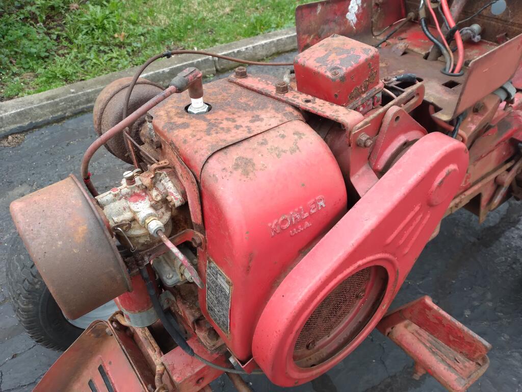

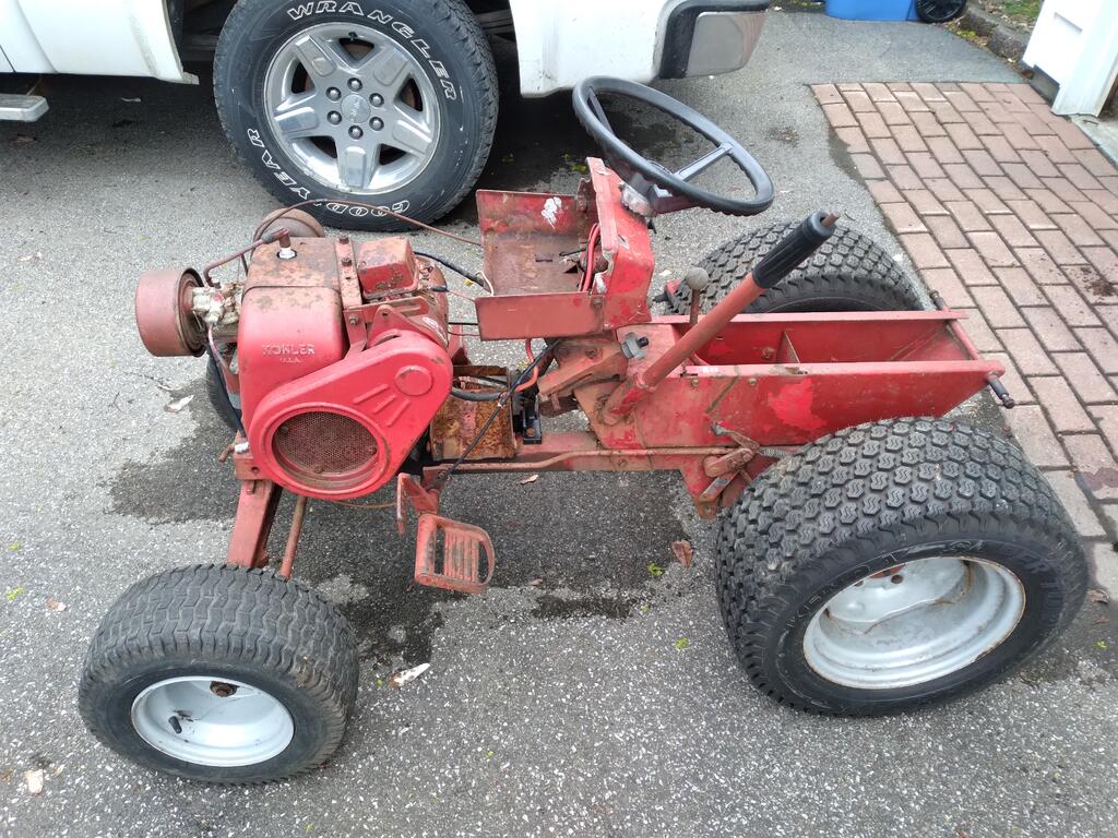

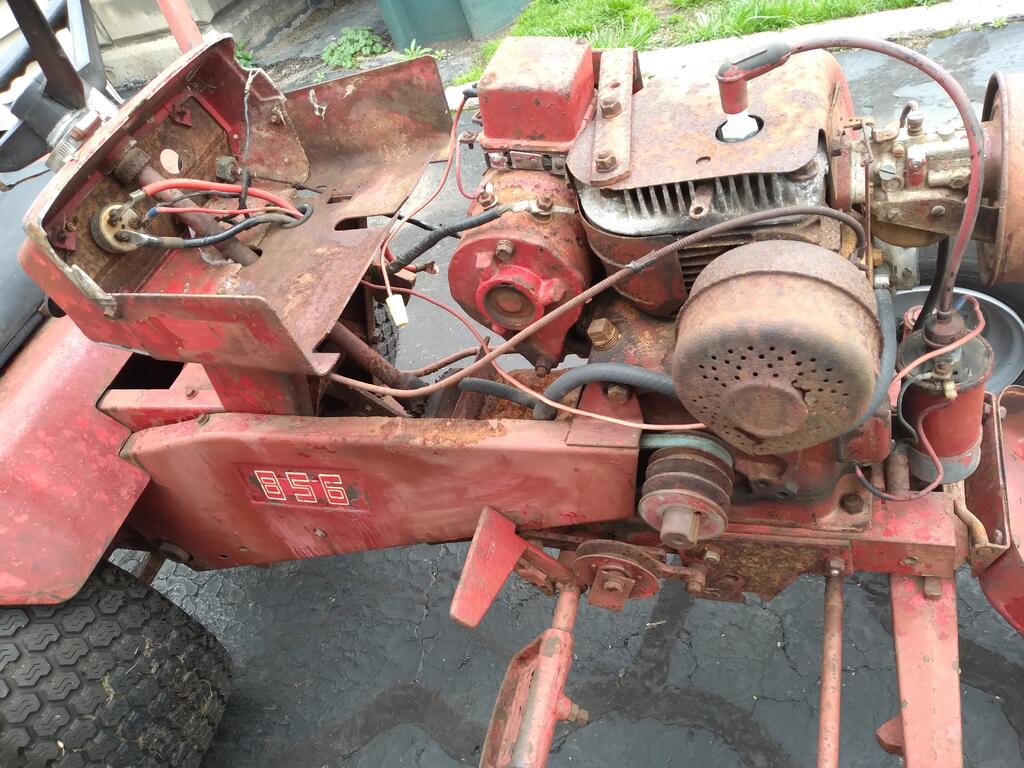

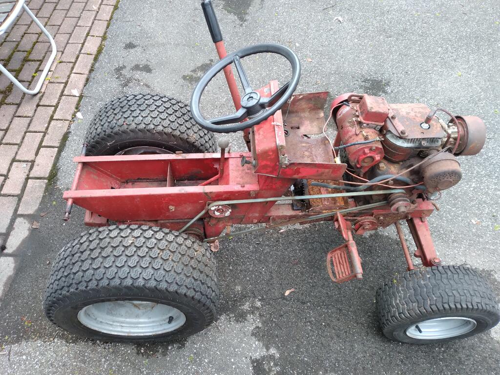

D_Mac 9,339 #15437 Posted April 26, 2022 Started pulling the 856 project apart today. Not sure where to start. I think clean and rebuild the carb and rewire it all. Also I don't think the ignition switch is correct. Might have to add a solenoid or replace the key switch. 10 1 Share this post Link to post Share on other sites
ebinmaine 80,808 #15438 Posted April 26, 2022 47 minutes ago, D_Mac said: I don't think the ignition switch is correct. Might have to add a solenoid or replace the key switch. Looks like that may be the right one. Why do you think it's not correct? 1 Share this post Link to post Share on other sites
johnnymag3 2,646 #15439 Posted April 26, 2022 25 minutes ago, ebinmaine said: Looks like that may be the right one. Why do you think it's not correct? I think it is supposed to have the Cole Hersee switch....with the Genny start ?? 2 Share this post Link to post Share on other sites
D_Mac 9,339 #15440 Posted April 26, 2022 24 minutes ago, ebinmaine said: Looks like that may be the right one. Why do you think it's not correct? Well the cables seem to big for the switch. Also it uses a different key then my other ones. 2 Share this post Link to post Share on other sites
rjg854 13,391 #15441 Posted April 26, 2022 The wires have to be heavy to carry the correct current on that type of switch 6 1 Share this post Link to post Share on other sites

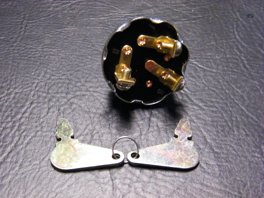

squonk 48,180 #15442 Posted April 26, 2022 (edited) Cables need to be big. minimum 6 ga. The correct switch isn't any bigger. It's the rating of the internal contacts what counts. Should be 70 Amp switch 3 terminal. There is a possibility that some one replaced it with a generic 3 terminal switch at some point. Edited April 26, 2022 by squonk 5 1 Share this post Link to post Share on other sites
johnnymag3 2,646 #15443 Posted April 26, 2022 Just now, squonk said: Cables need to be big. The correct switch isn't any bigger. It's the rating of the internal contacts what counts. Should be 70 Amp switch 3 terminal. There is a possibility that some one replaced it with a generic 3 terminal switch at some point. I do have a new switch in the box if he wants to grab it........30.00 shipped 6 1 Share this post Link to post Share on other sites
johnnymag3 2,646 #15444 Posted April 26, 2022 (edited) cole hersee.webp 27 minutes ago, johnnymag3 said: D Mac... I do have a new switch in the box if you want to grab it........30.00 shipped Edited April 26, 2022 by johnnymag3 1 1 Share this post Link to post Share on other sites
squonk 48,180 #15445 Posted April 26, 2022 Should look like this Cole Hersee 95521B 2 1 Share this post Link to post Share on other sites
D_Mac 9,339 #15446 Posted April 26, 2022 1 hour ago, johnnymag3 said: cole hersee.webp 50.39 kB · 3 downloads Thanks, I will keep it in mind. Going over everything first to see what I'm going to need. I know it's going to need a lot. I need to cut corners where I can. I know I have good solenoids already. I want to use what I have on hand before buying anything. Like on the last project.... the 875 quickly added up and before you know it you have more into it then what it's worth. I planned on keeping the 875 so I didn't care. Also the 875 was in much better condition then this 856. Remember this 856 had sat out in the weeds for decades. It's more of a challenge just to see if it can run and drive again. Here it is before we dragged it out. It is in rough shape. 4 3 Share this post Link to post Share on other sites

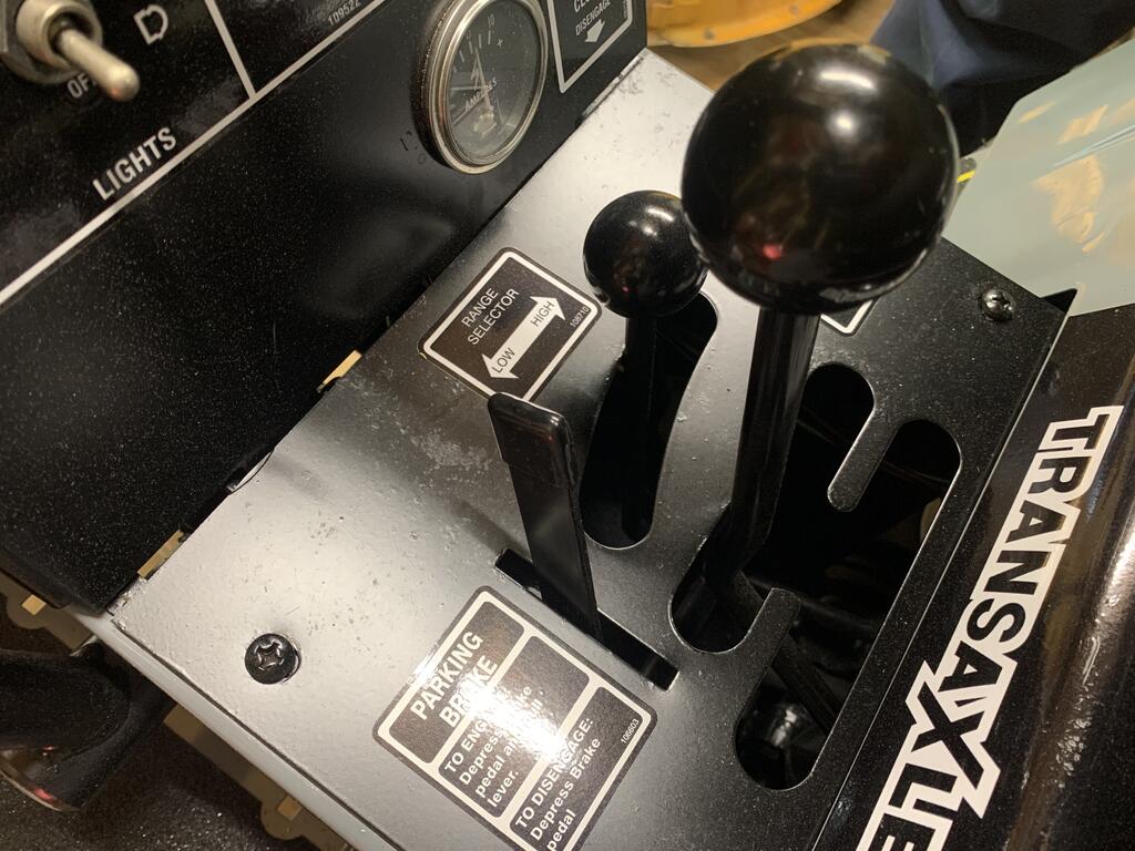

Horse Newbie 7,405 #15447 Posted April 27, 2022 My shifter knob and brake lever rubber end came in from Lowell, so I put them on the 1984 Work Horse… All I need now is the Hi-Lo shifter knob ( on back order from Lowell) and the Work Horse will be done… 6 6 Share this post Link to post Share on other sites
