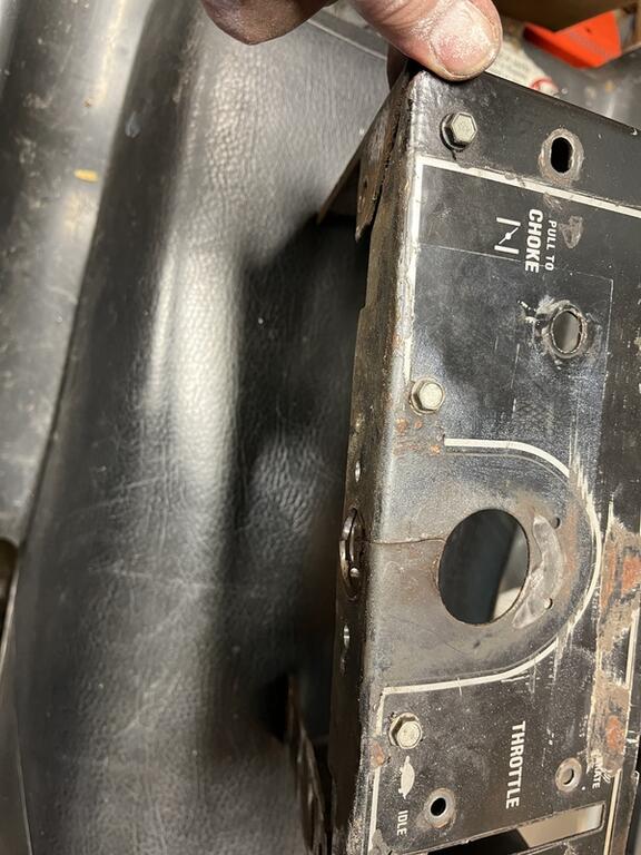

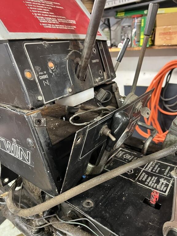

Evguy 567 #15406 Posted April 22, 2022 I took advantage of the good weather and fabricating a new top steering bushing. as it turns out, it’s not the first repair, a piece of strut had been used to repair a crack in the dash at bottom of shaft hole. Wheel doesn’t flop around now, all good. 7 Share this post Link to post Share on other sites

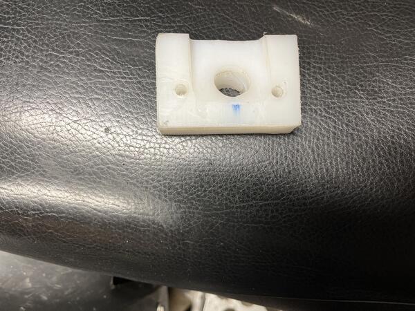

Evguy 567 #15410 Posted April 23, 2022 52 minutes ago, ebinmaine said: If you get a chance, pics would be appreciated. A few pics I drilled block at 25 degrees and beveled the same for locking collar. Bottom picture shows placement, collar not slid up. 4 2 Share this post Link to post Share on other sites

oliver2-44 11,759 #15412 Posted April 23, 2022 3 hours ago, Evguy said: A few pics I drilled block at 25 degrees and beveled the same for locking collar. Bottom picture shows placement, collar not slid up. Is that block some of the lubricant impregnated plastic or a Teflon material. 2 Share this post Link to post Share on other sites
Evguy 567 #15413 Posted April 23, 2022 40 minutes ago, oliver2-44 said: Is that block some of the lubricant impregnated plastic or a Teflon material. Teflon I think, I used it in a project as an insulator and had some left over, I plan on a dab of grease when it goes together 5 Share this post Link to post Share on other sites

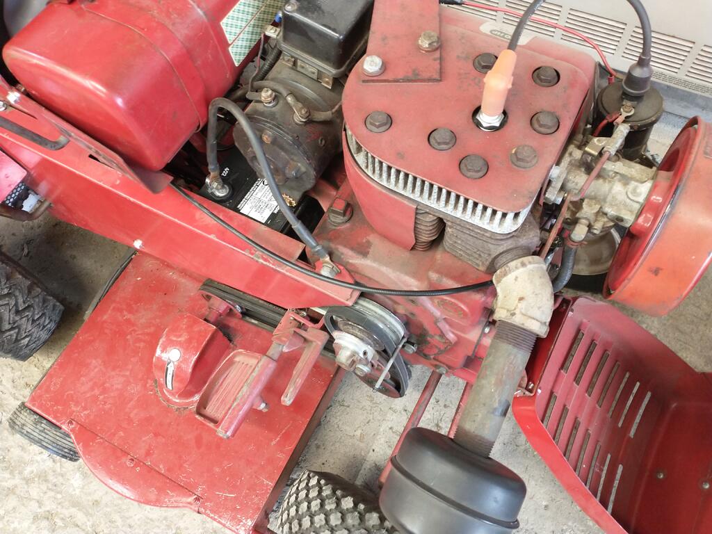

squonk 48,180 #15414 Posted April 23, 2022 New throttle cable on the 1075 Wheel a Matic! 4 3 Share this post Link to post Share on other sites

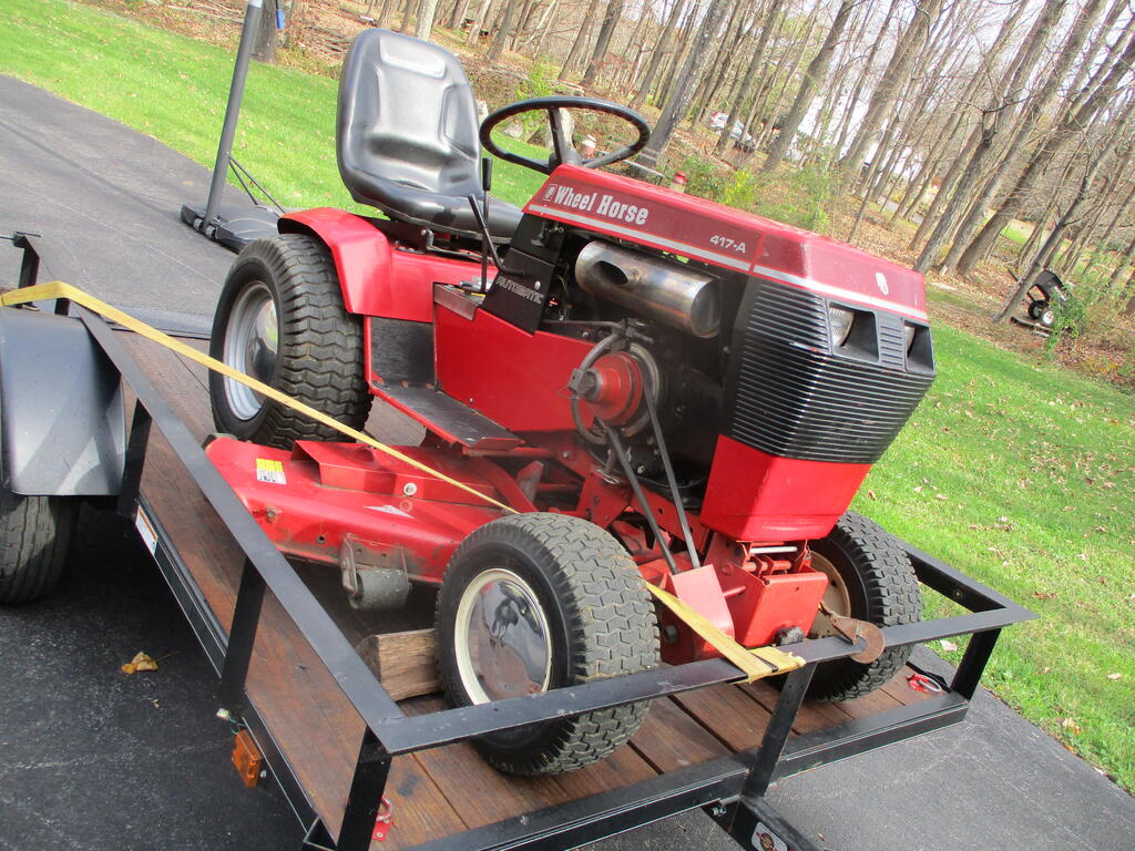

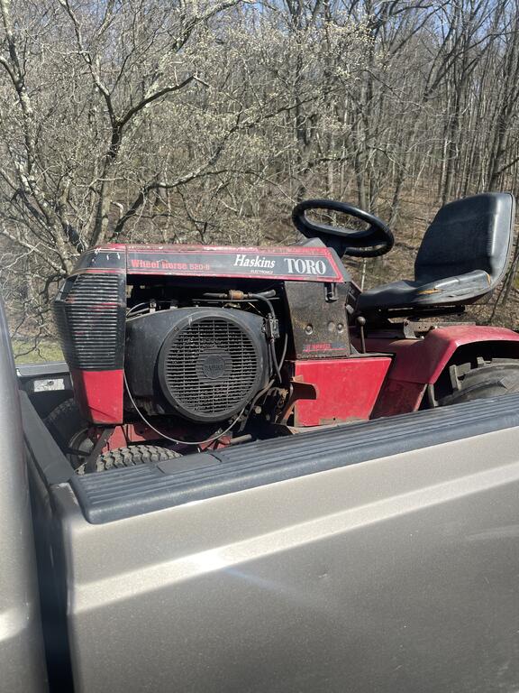

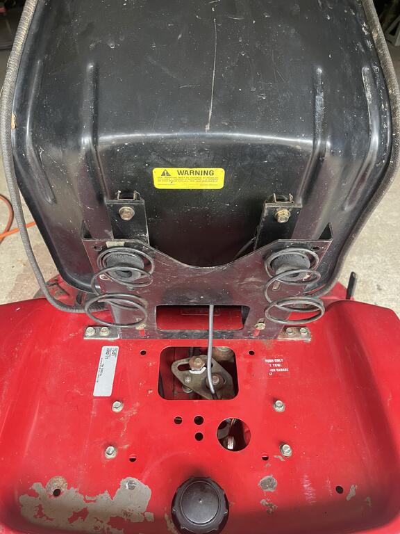

Desko 686 #15415 Posted April 23, 2022 (edited) I got and added the suspension to the 416 seat and I gotta say it's a much better ride! I know they don't belong there per say but there are no other holes in the seat pan to mount them like they should be but instead of guessing and drilling I improvised and they work good there. Something really special followed me home today a 520-8 with electric lift! I made the 5 hour trip to NY to pick it up didn't get it dirt cheap but he also threw in a free snow blade with it also! Edited April 23, 2022 by Desko 5 5 Share this post Link to post Share on other sites

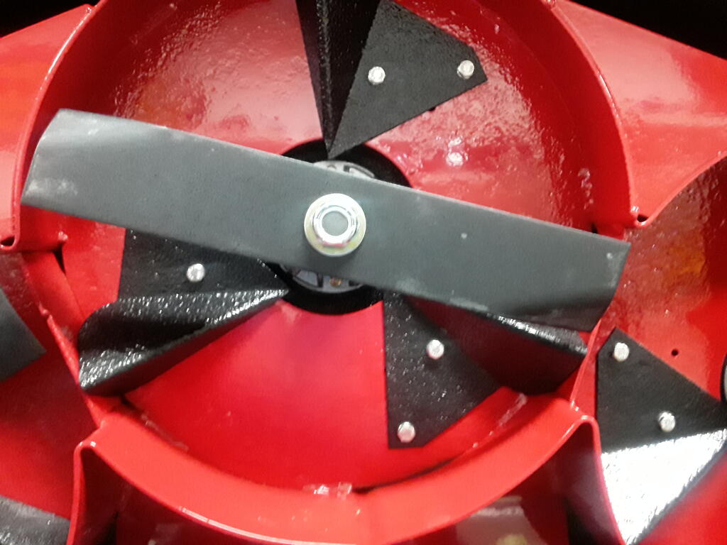

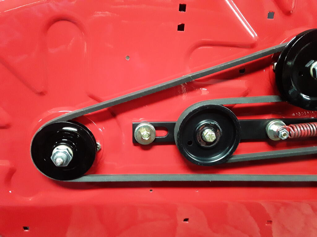

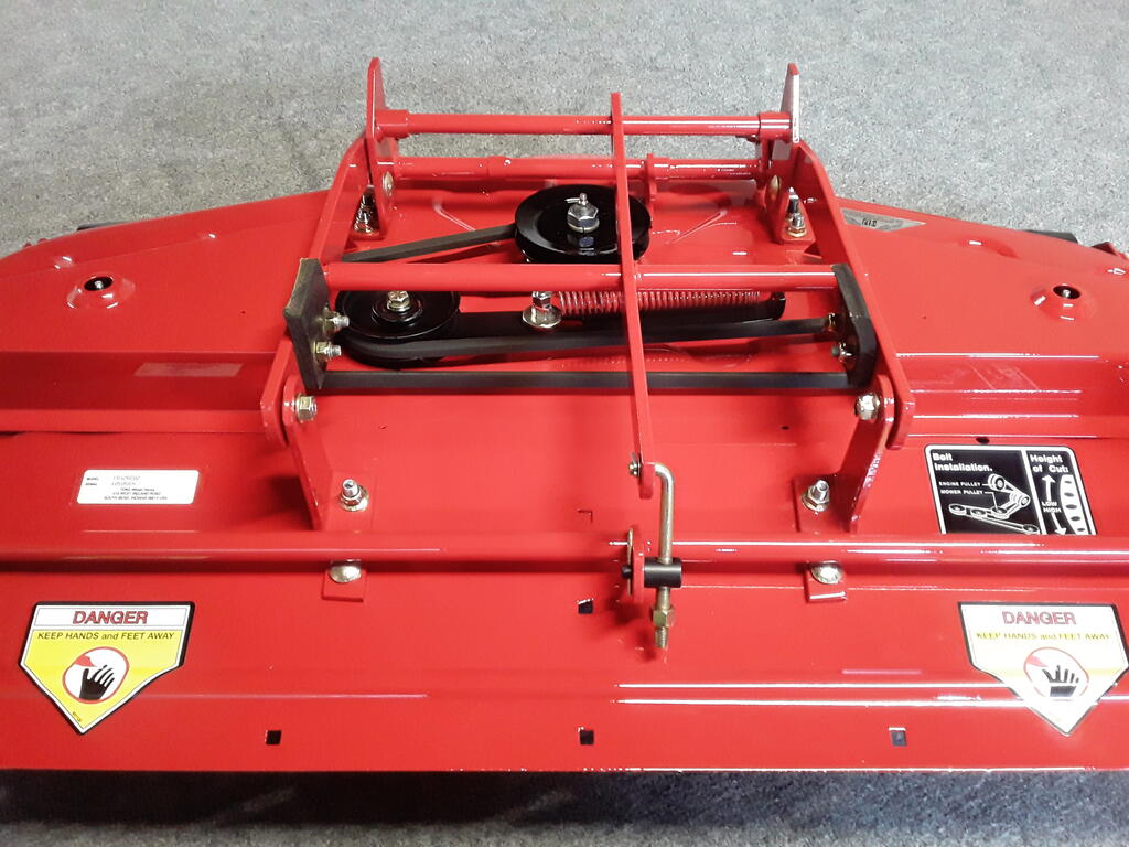

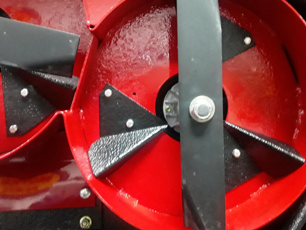

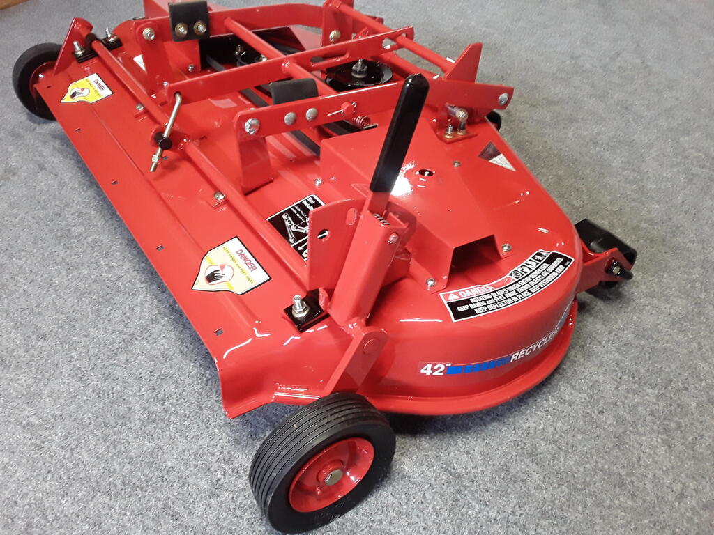

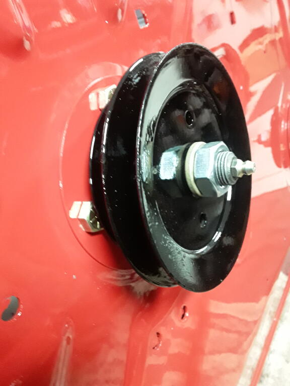

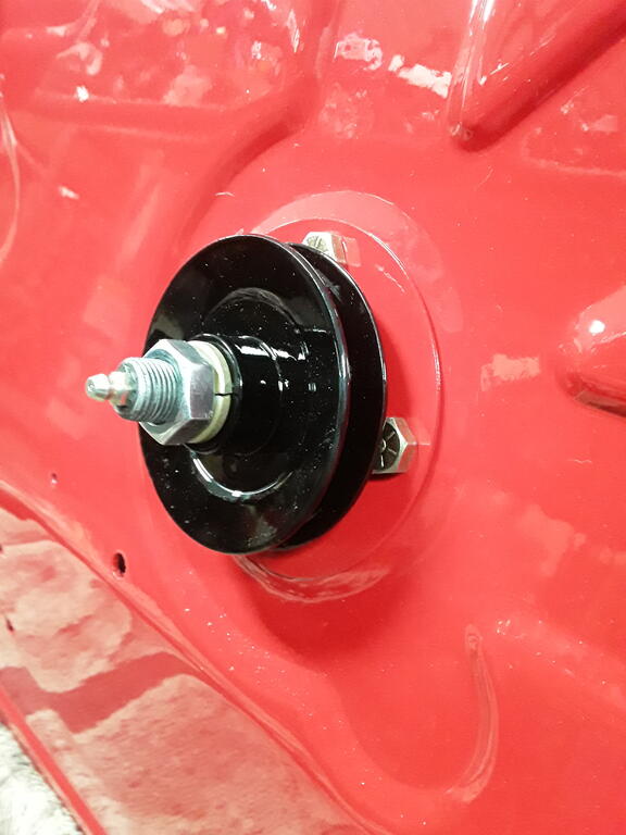

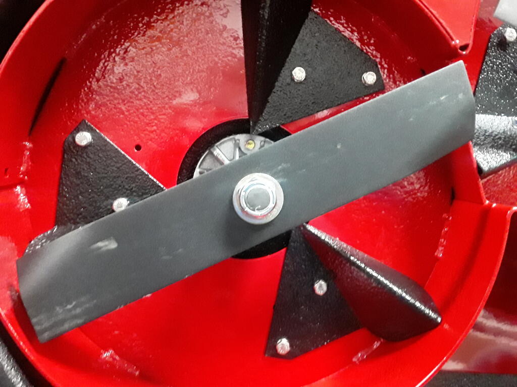

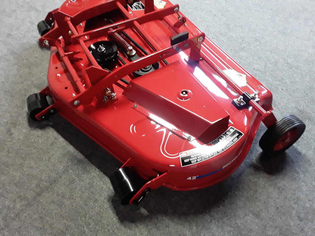

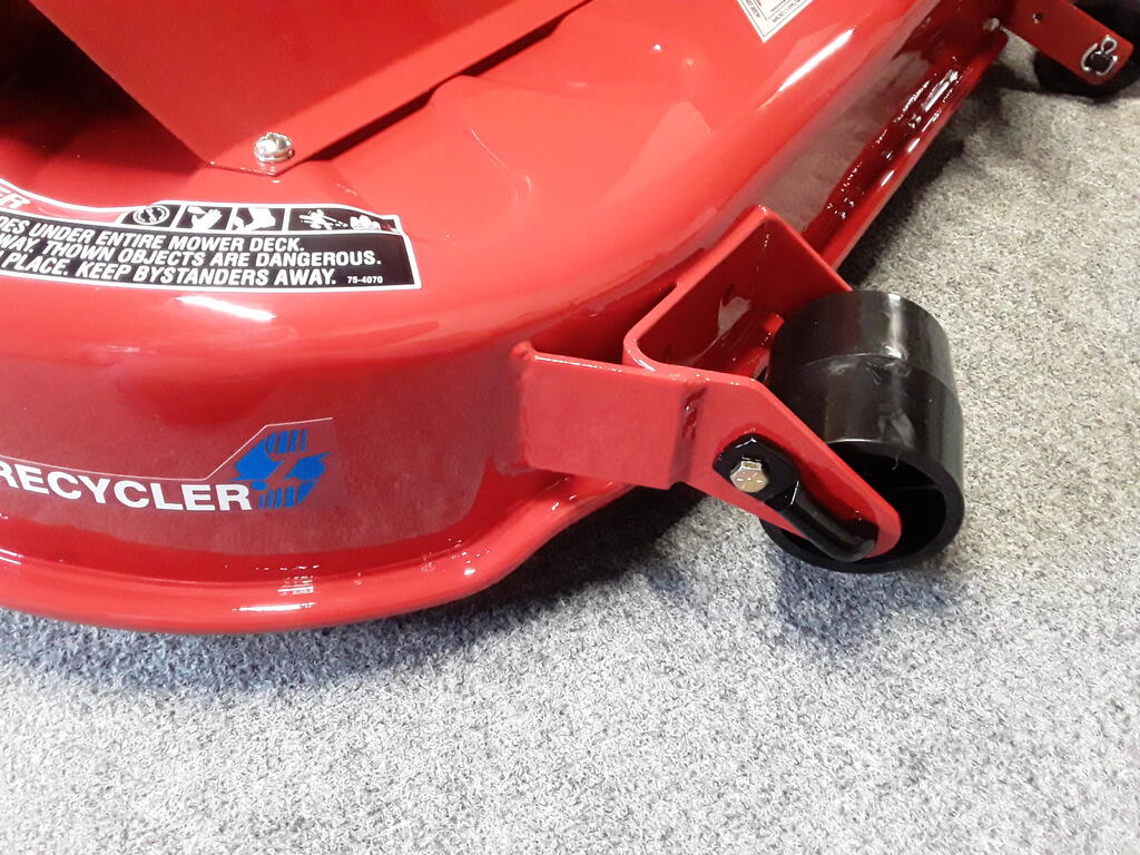

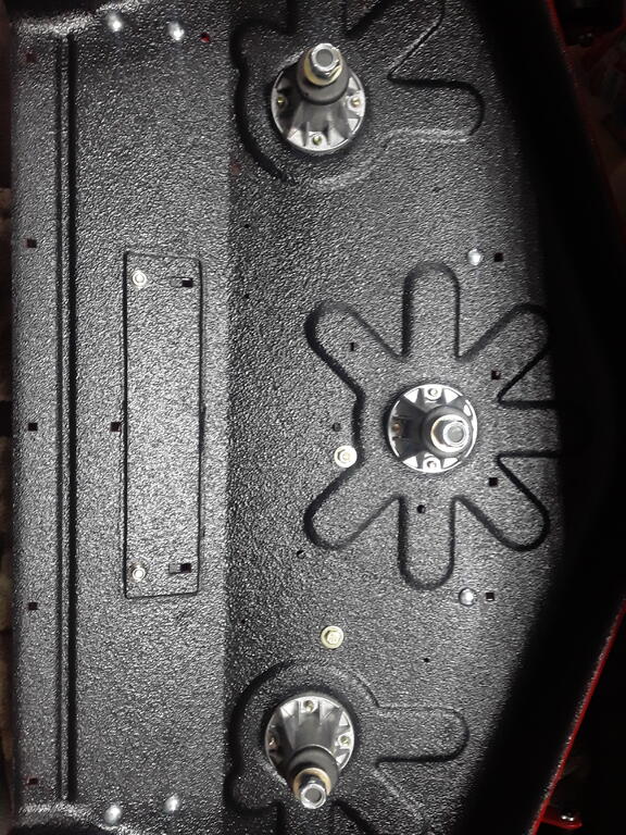

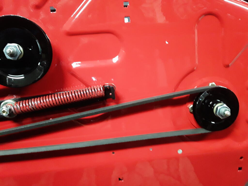

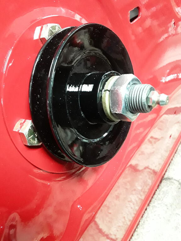

76c12091520h 4,290 #15416 Posted April 23, 2022 Completed the assembly / restoration on a 42" recycler deck. Probably the nicest cutting deck Wheel Horse ever offered. 2 18 Share this post Link to post Share on other sites
Wheelhorse#1 1,997 #15417 Posted April 23, 2022 (edited) Brian .Beautiful work.Do you know if they made this deck in other sizes than the 42 ? Edited April 23, 2022 by Wheelhorse#1 1 Share this post Link to post Share on other sites

davem1111 2,381 #15420 Posted April 24, 2022 2 hours ago, 76c12091520h said: Completed the assembly / restoration on a 42" recycler deck. Probably the nicest cutting deck Wheel Horse ever offered. Wow! If that doesn't look "brand new", then NOTHING does, even when it is. Awesome work! 1 Share this post Link to post Share on other sites
Horse Newbie 7,405 #15421 Posted April 24, 2022 38 minutes ago, davem1111 said: Wow! If that doesn't look "brand new", then NOTHING does, even when it is. Awesome work! I agree !… top notch every time… Brian does not spare any expense with his work ! 1 Share this post Link to post Share on other sites
76c12091520h 4,290 #15422 Posted April 24, 2022 2 hours ago, Wheelhorse#1 said: Brian .Beautiful work.Do you know if they made this deck in other sizes than the 42 ? 42" only when it comes to the " vintage " Wheel Horses . If I remember correctly, they did make some recycler inserts for later 48"s and some other XI Series decks 3 Share this post Link to post Share on other sites
dmoore 1,042 #15423 Posted April 25, 2022 Someone is going to get a NICE mower deck! Exquisite Brian 1 Share this post Link to post Share on other sites
