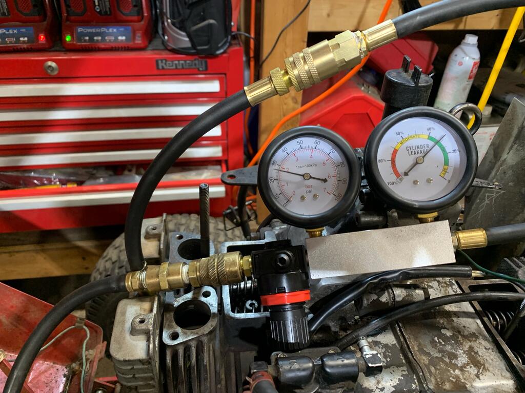

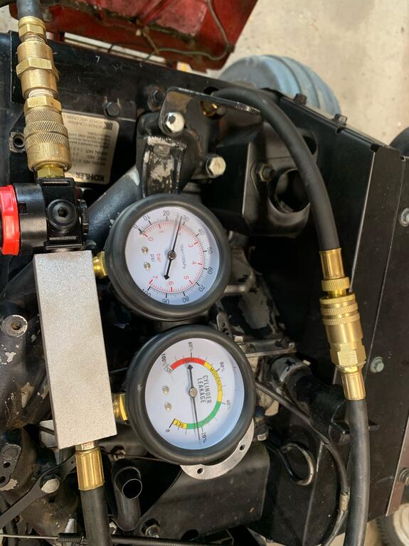

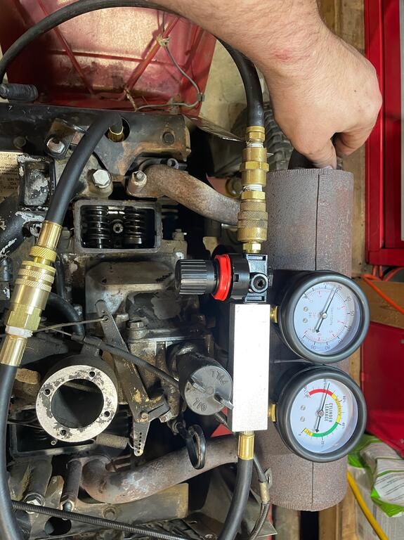

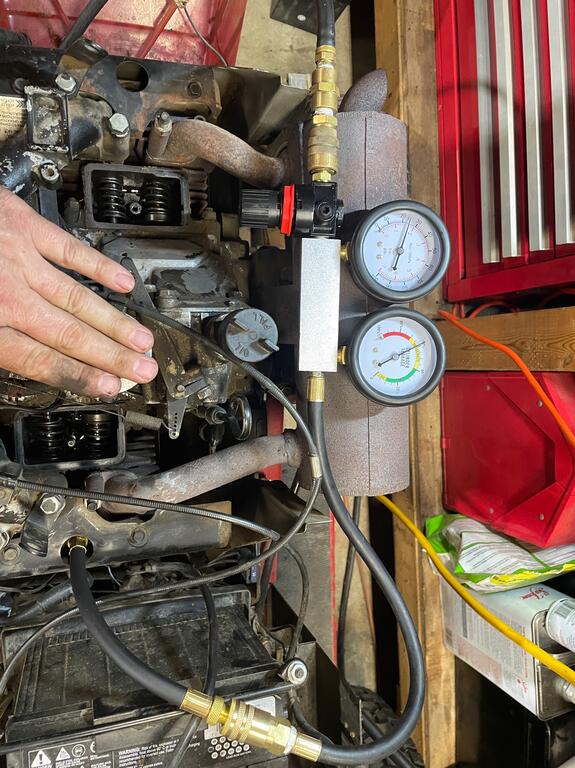

Andy N. 2,842 #15036 Posted March 20, 2022 3 hours ago, johnnymag3 said: Can that be achieved with the M18? by cranking??? I was always under the assumption that you cant ...due to decompression release on them....Maybe Im wrong??? I do have several Compression testers...Hmmmm I found that compression leak down works the best. I did this on my 418-A last fall when it was hard starting and found that it needed a valve job. I did the valve job and have a small ticking noise on the front cylinder, but knew I probably would as I got a little aggressive on one of the valve stems and the clearance is a little more than it should be. This would at least help isolate if it’s something in the valve train. Before and after pics of the leak down compression. 2 Share this post Link to post Share on other sites
