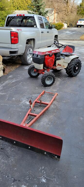

ebinmaine 80,811 #14976 Posted March 16, 2022 4 minutes ago, pfrederi said: Never weighed it.. Wrestled it on many years ago and have never taken it off since. Mounting is a huge PITA. I normally have wheel weights and 50-75 on the rear. Borroed them all last year to fit out a plow tractor for my Brother... Maybe you could get your brother to stand on the back of the tractor while you're sweeping? 2 Share this post Link to post Share on other sites

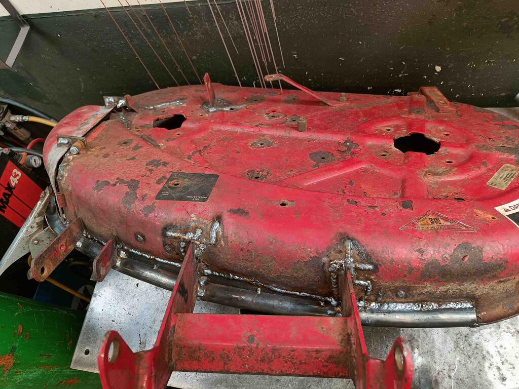

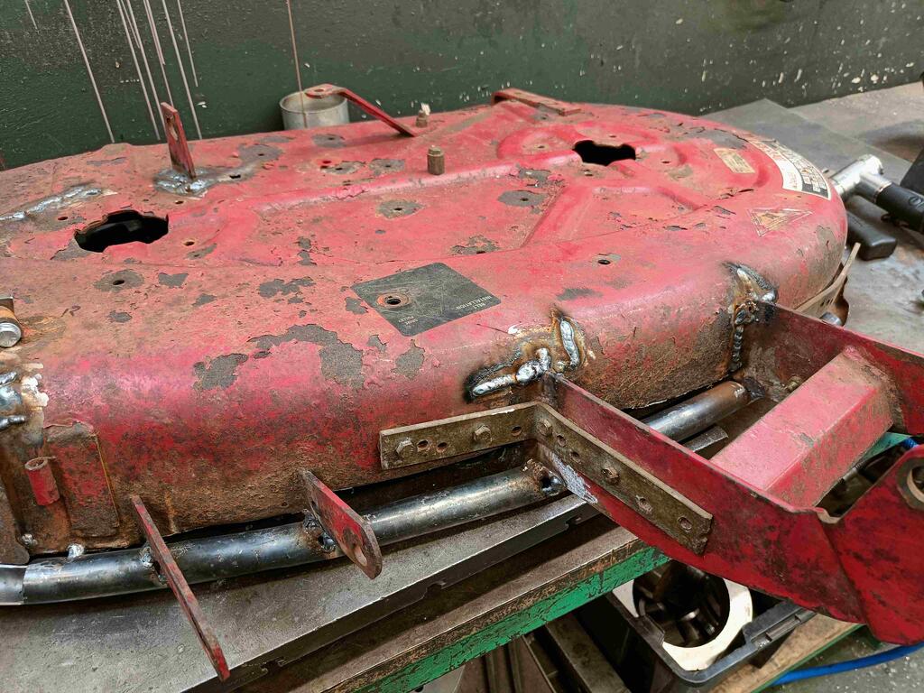

Fergus 62 #14978 Posted March 17, 2022 Today, well actually the last few months, I have been conducting a weldathon on this knackered deck. It's coming along nicely though 5 1 Share this post Link to post Share on other sites
ebinmaine 80,811 #14979 Posted March 17, 2022 1 minute ago, Fergus said: conducting a weldathon on this knackered deck. It's coming along nicely though Looks like a good save! Keep us posted. 2 Share this post Link to post Share on other sites
Fergus 62 #14980 Posted March 17, 2022 Getting there 3 3 Share this post Link to post Share on other sites

Ifixoldjunk 778 #14985 Posted March 17, 2022 @Fergus Nice job. I have a 42 side discharge with some rot that needs to be taken care of. Just don’t have the time lol. Did you just plug the rust holes with little beads it looks like? 1 Share this post Link to post Share on other sites
Fergus 62 #14986 Posted March 17, 2022 15 minutes ago, Ifixoldjunk said: @Fergus Nice job. I have a 42 side discharge with some rot that needs to be taken care of. Just don’t have the time lol. Did you just plug the rust holes with little beads it looks like? No, those were drilled holes for the previous owner's bodged on brackets 😁 Share this post Link to post Share on other sites
Handy Don 17,514 #14987 Posted March 18, 2022 4 hours ago, Fergus said: conducting a weldathon on this knackered deck You are one determined bloke to try bringing that one back. Carry on, sir! 1 Share this post Link to post Share on other sites
Ed Kennell 47,474 #14988 Posted March 18, 2022 1 hour ago, Handy Don said: You are one determined bloke to try bringing that one back. Carry on, sir! I second that. 2 Share this post Link to post Share on other sites

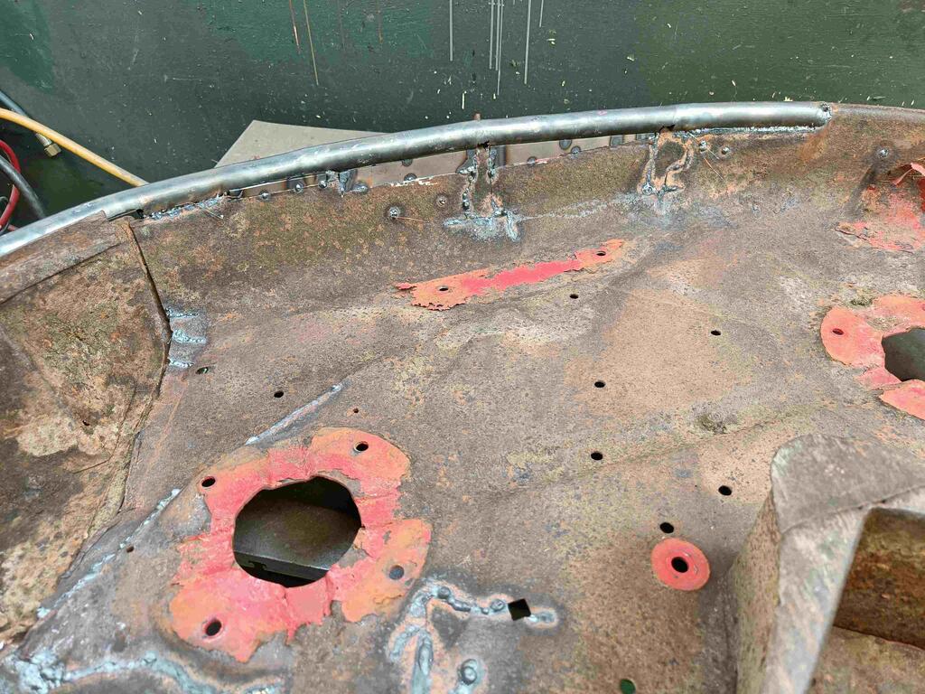

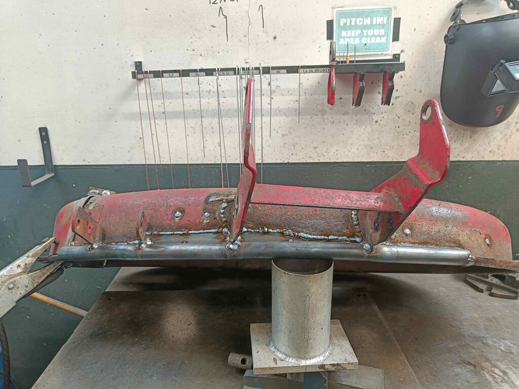

Fergus 62 #14989 Posted March 18, 2022 Nearly there! They're not available new so it's welding or no mower. I think it's been around 6 hours of work in lunch breaks at work so far. 4 2 Share this post Link to post Share on other sites

peter lena 10,080 #14991 Posted March 18, 2022 @Fergus agree with others on your attempted save , not sure how difficult it is to remove or drop that deck , but that , would be the most important thing you could do to it regularly , dry it out in the sun if possible , clean out the bottom side , lubricate it with a soak down . scrape it down, leave it upside down when not in use , to dry out and soak in the oil to the metal. lightly sharpen blades , look for another deck . been doing this for years . this is my deck, just an idea that works , pete 3 Share this post Link to post Share on other sites

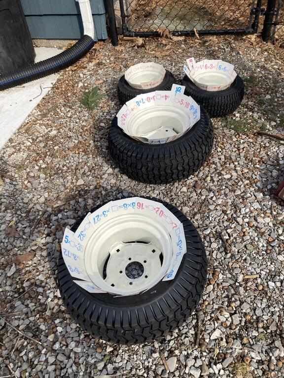

SylvanLakeWH 32,654 #14997 Posted March 18, 2022 Finally found a use for math flash cards… 4 1 4 Share this post Link to post Share on other sites

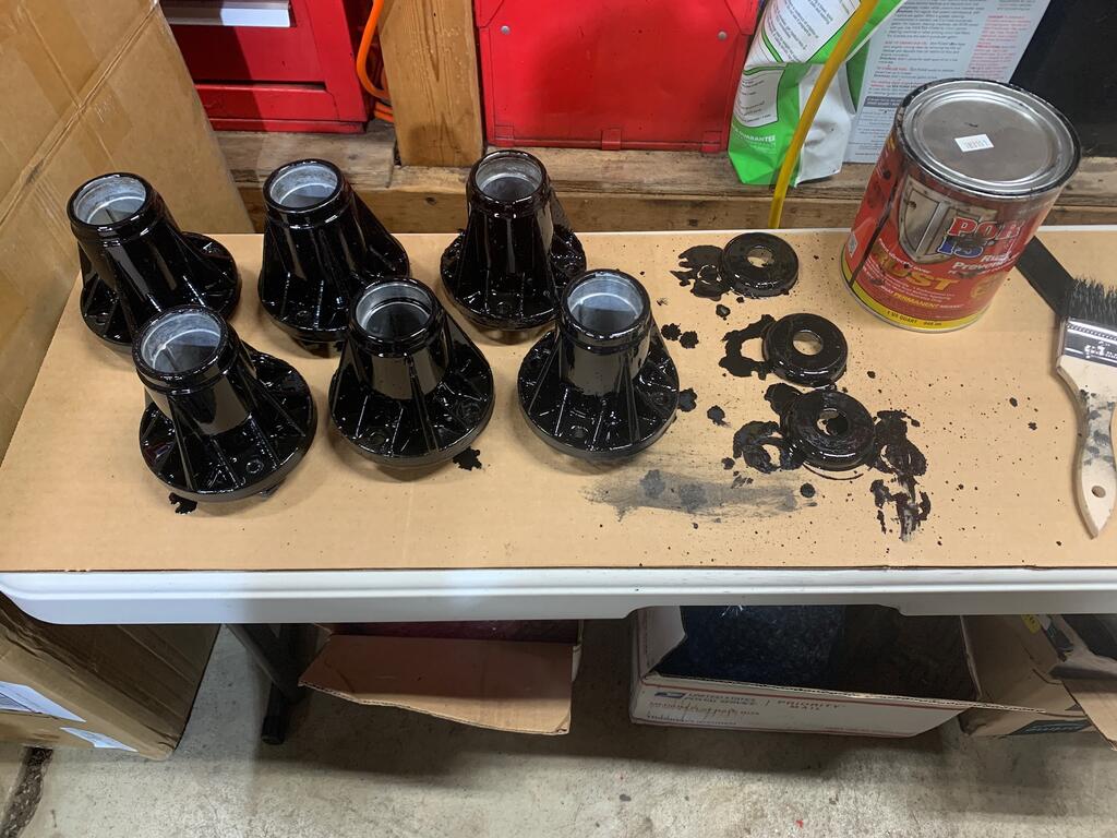

Andy N. 2,842 #14998 Posted March 18, 2022 Cleaned up and painted some spindle housings with Por 15. Ultrasonic cleaned the hardware in evaporust too. 5 3 Share this post Link to post Share on other sites

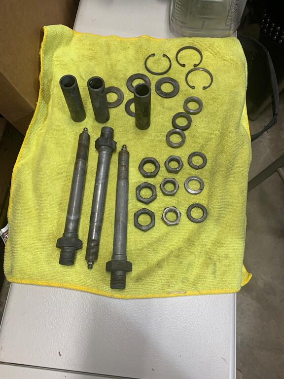

Horse Newbie 7,405 #15000 Posted March 19, 2022 1 hour ago, Andy N. said: Cleaned up and painted some spindle housings with Por 15. Ultrasonic cleaned the hardware in evaporust too. I have to rebuild my 48 inch SD deck for my 1994 520H. I have new spindles with the sleeves as shown in the pic (yellow rag). My concern is “Do you have to, or can you line up the grease holes in the sleeves with the grease holes in the spindle shafts” And since the holes with positively not be, or stay lined up, will the grease work it’s way to the bearings ?… this has been in the back of my mind since I first looked closely at the design… Share this post Link to post Share on other sites
