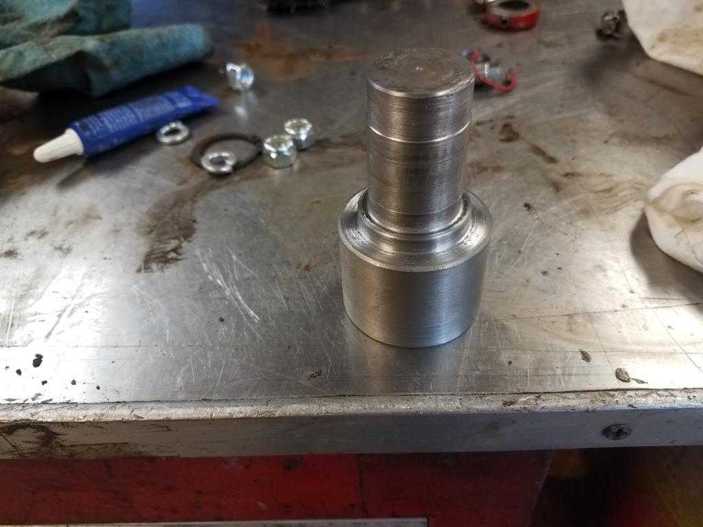

WHX?? 58,360 #128 Posted February 5, 2018 On 2/4/2018 at 9:16 AM, Shynon said: custom bearing driver for wheel and brake bearing set to proper depth to install the seal. Interesting Tom, Dan @Achtowith access to a lathe you could make one or three of them! 3 Share this post Link to post Share on other sites
Achto 32,940 #129 Posted February 5, 2018 13 minutes ago, WHX14 said: On 2/4/2018 at 9:16 AM, Shynon said: custom bearing driver for wheel and brake bearing set to proper depth to install the seal. Interesting Tom, Dan @Achtowith access to a lathe you could make one or three of them! I get the feeling that your wanting one of those Jim. I'll have to look up the dimensions, unless Tom wants to post them. 1 Share this post Link to post Share on other sites
WHX?? 58,360 #130 Posted February 5, 2018 2 hours ago, Achto said: wanting one of those Jim As long as you are in production mode! Prollybetter than by guessing and goshing with a inappropriately sized socket! What I do need is to get off my keester and pick up a bearing & seal driver kit! 3 2 Share this post Link to post Share on other sites

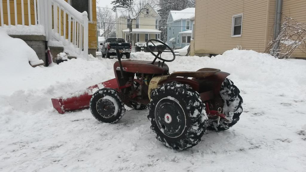

Chris G 3,401 #131 Posted February 10, 2018 (edited) Well I went out this morning and changed the oil and did a little greasing and such on my suburban. Then got some seat time in plowing! Edited February 10, 2018 by Chris G 2 7 Share this post Link to post Share on other sites

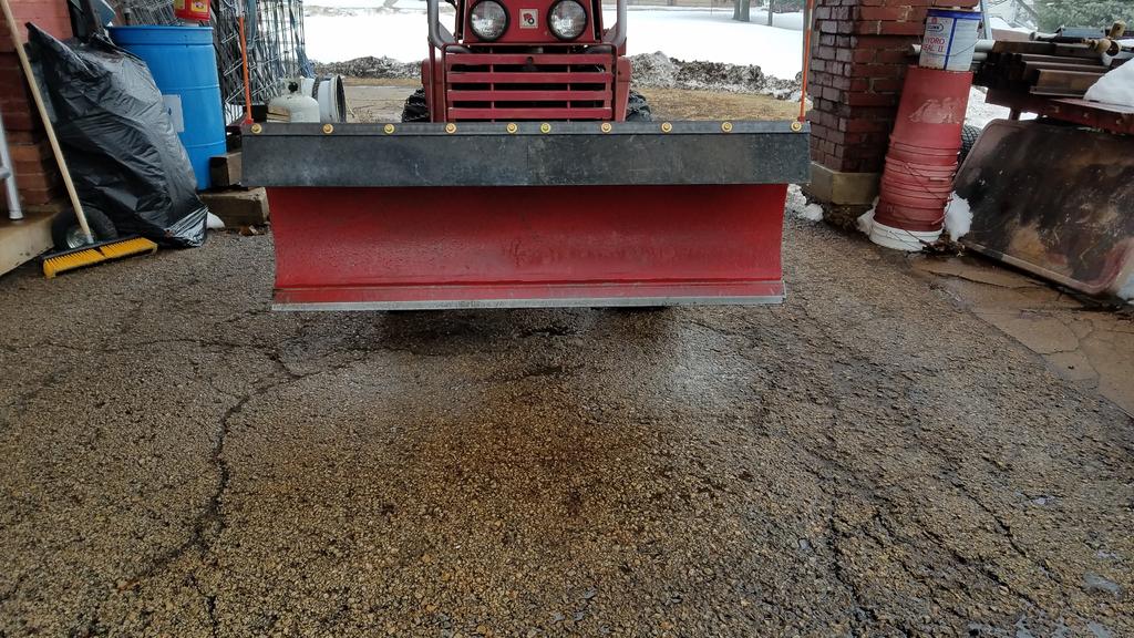

Sarge 3,473 #135 Posted February 15, 2018 Installed a NOS hose from a member on the D - nice to see the 3pt stay up and not leak all over the place for once, not to mention it's a lot stronger now since it's not getting air in the cylinder. Got tired of the engine melting any snow that came over the top of the blade and freezing up the linkage over time - the thing will push piles way over the height of the blade easily, so I built a flap for it . Rubber strips are old stock ones that were used on Western truck plows a buddy had at the shop - it's a great material. The flap sure helps a lot to keep material from topping over and seems to roll the snow easier as well - may make a more permanent one out of steel this summer to help it roll even more. Everything was melting heavily yesterday since it warmed up to 40*F - pulled the trailer out of the way and plowed the area it sits so all the water could drain out of the parking lot and not force it toward the shed and cause it to sink . 3pt lift works a lot better and the flap performed as expected, overall a good day but that dampness put an ache in my joints I can't get rid of a day later...ugh. Sarge 7 3 Share this post Link to post Share on other sites
ebinmaine 81,198 #136 Posted February 15, 2018 1 hour ago, Sarge said: The flap sure helps a lot to keep material from topping over and seems to roll the snow easier as well - may make a more permanent one out of steel this summer to help it roll even more. It's a change you'll appreciate. Love the snow foils. .... Share this post Link to post Share on other sites

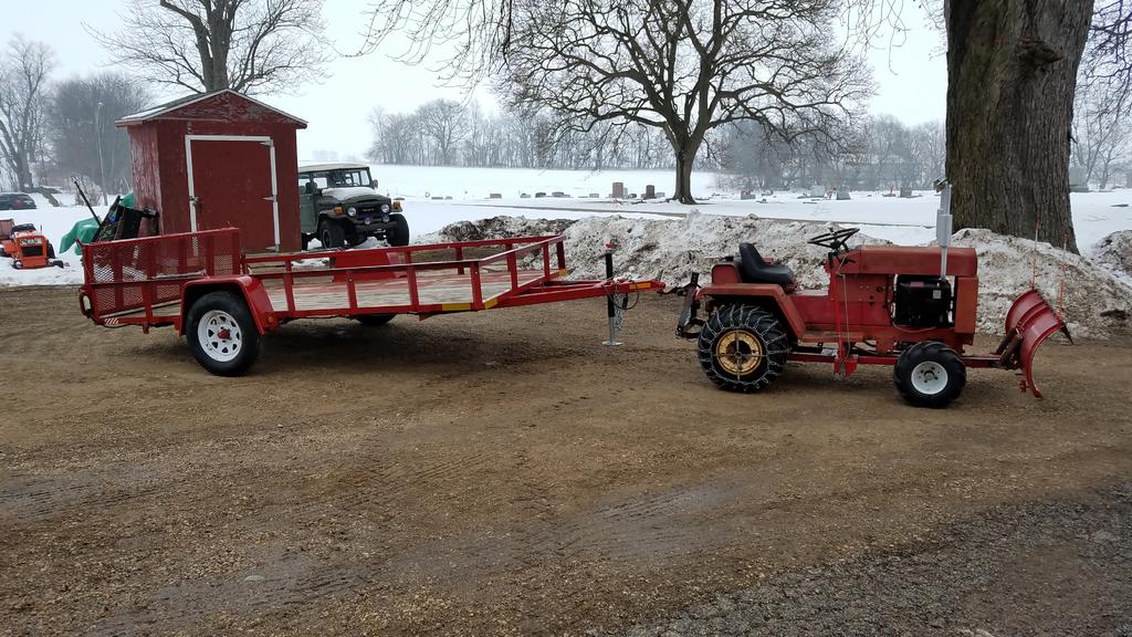

Thegearhead0324 1,875 #137 Posted February 16, 2018 Today I made a few changes to the 1257. Gt14 intake, had to lower the lights for it which look better to me. I know it's early and February but I took the plow off and put on the sickle bar. Trying to rush winter to be over. Plus I miss the look of it, but definitely didn't miss putting it on... awkward lol. 2 7 Share this post Link to post Share on other sites

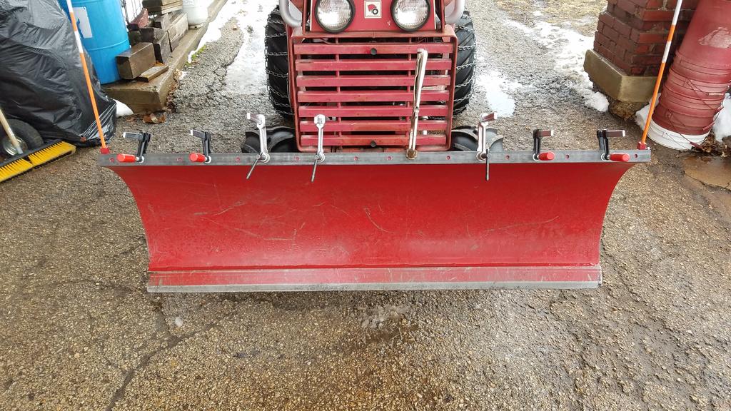

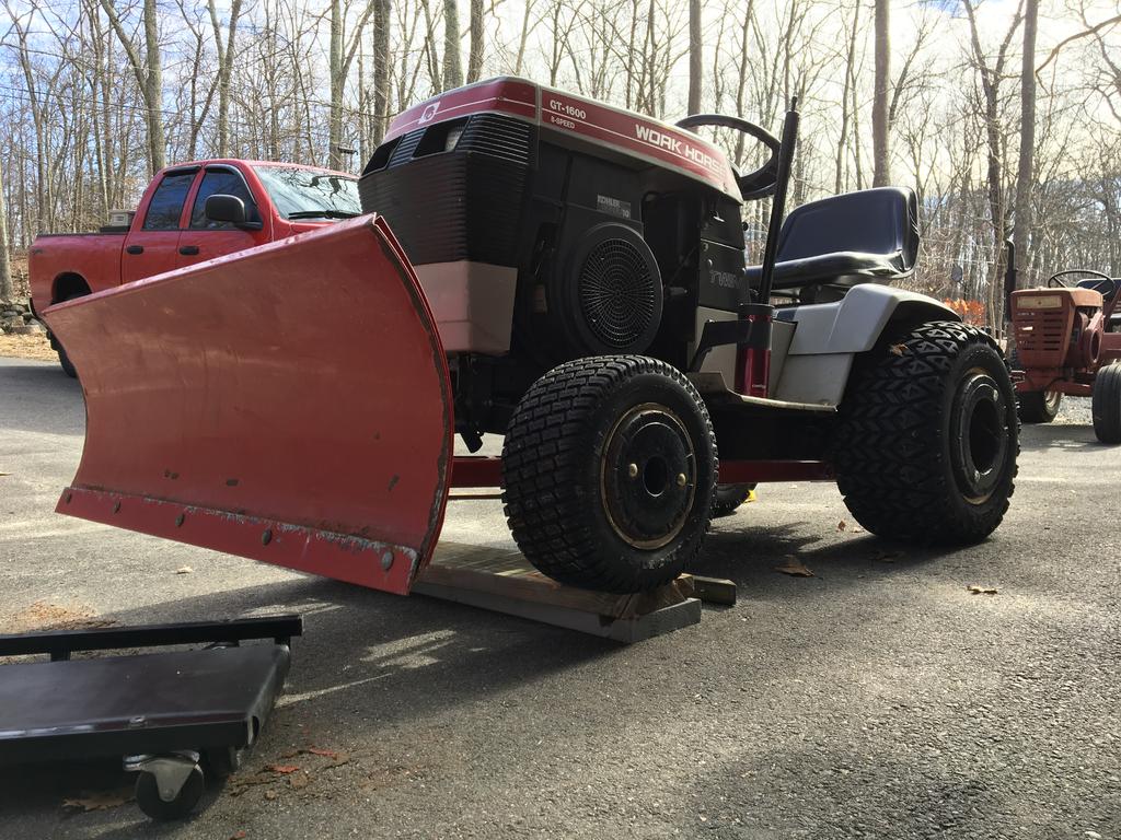

Sparky-(Admin) 26,764 #138 Posted February 17, 2018 Flipped the cutting edge on my snow beast...in preparation for tomorrow’s snow! 3 1 Share this post Link to post Share on other sites
Sarge 3,473 #139 Posted February 17, 2018 The more I see those the more I regret not fixing the one I had - badly broken trans and blown engine along with most of the sheet metal being flattened but it could/should have been saved anyway. I had no idea at the time what it really was, that was before I got here and long before I got the old 1277. Bad move, duh...those are really growing on me and I do like the original Briggs twins in them but most were badly abused around here. The 16hp twin I had was a victim of a large elm tree...almost smashed flat but it was really only the hood/engine and steering column which had saved the dash stand for the most part. Sarge 1 Share this post Link to post Share on other sites

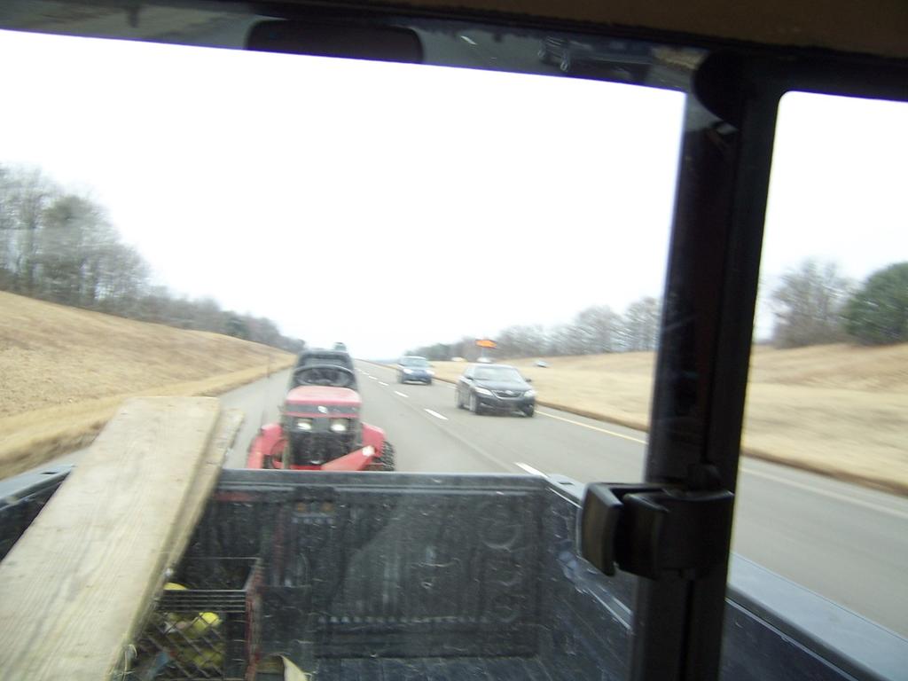

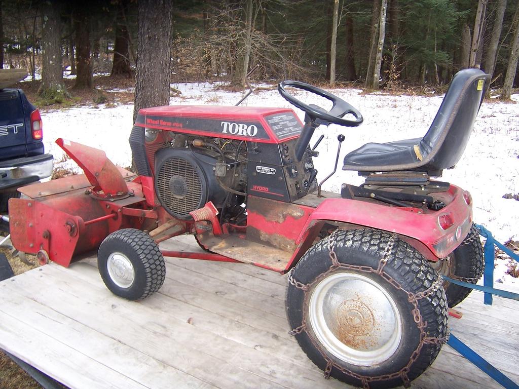

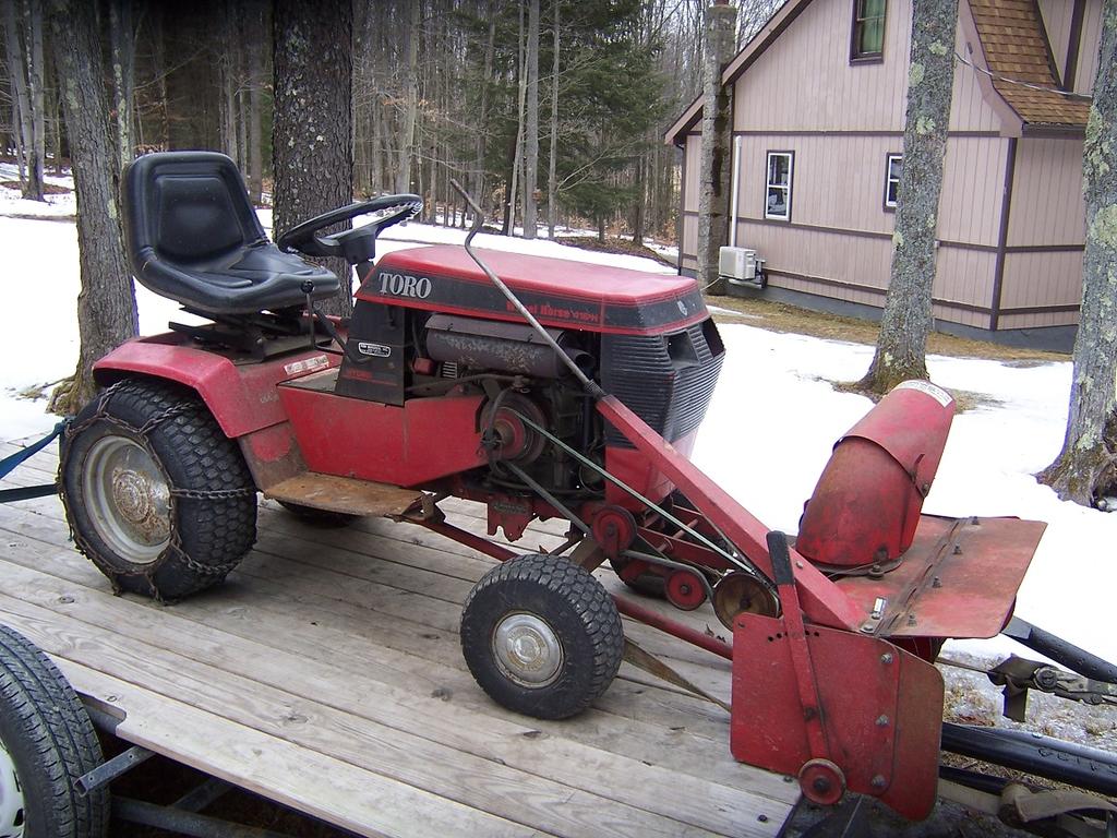

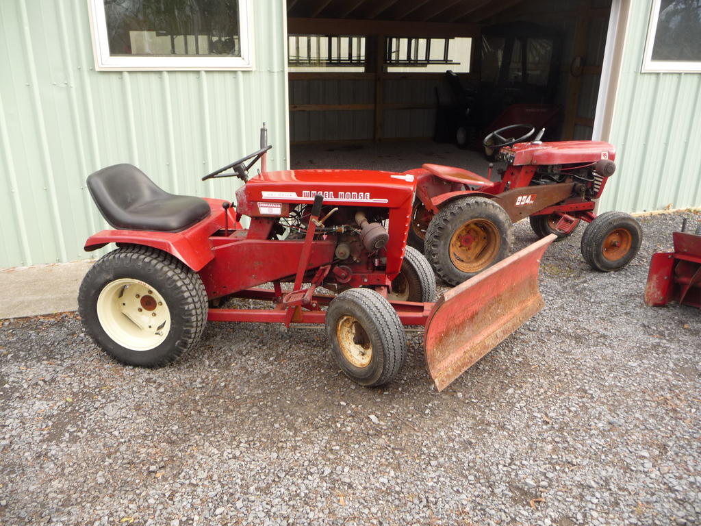

BIGMIKE 78 #140 Posted February 17, 2018 I just brought this 416-H home today. I know that it runs well, Goes forwards and goes backwards. Doesn't stop too well and the engine cuts out when I engage the PTO 100%. But mores the fun to diagnose and fix. Got a cab lined up for it too. 8 1 Share this post Link to post Share on other sites
WVHillbilly520H 10,379 #141 Posted February 18, 2018 6 minutes ago, BIGMIKE said: I just brought this 416-H home today. I know that it runs well, Goes forwards and goes backwards. Doesn't stop too well and the engine cuts out when I engage the PTO 100%. But mores the fun to diagnose and fix. Got a cab lined up for it too. Good deal, looks like (to me) 6" instead of 8" front wheels, my eyes (pictures) may be decieving me, but looks to be a solid tractor to build upon, as far as stopping with my hydros I hardly ever use the service/parking brake while moving just the motion control lever, linkage may need a little adjustment, the PTO maybe adjusted s bit too tight or a bad bearing in the blower, you did try at WOT not at idle?, Good luck with your new "toy" I mean tool, Jeff. 2 1 Share this post Link to post Share on other sites
BIGMIKE 78 #142 Posted February 18, 2018 3 minutes ago, WVHillbilly520H said: Good deal, looks like (to me) 6" instead of 8" front wheels, my eyes (pictures) may be decieving me, but looks to be a solid tractor to build upon, as far as stopping with my hydros I hardly ever use the service/parking brake while moving just the motion control lever, linkage may need a little adjustment, the PTO maybe adjusted s bit too tight or a bad bearing in the blower, you did try at WOT not at idle?, Good luck with your new "toy" I mean tool, Jeff. WOT. The belts run and the augurs spin up as long as you don't go the last 1/2 inch on the PTO lever. As soon as you do it just quits. Ease off and it catches again. I am in the seat at WOT. Some research indicates maybe seat safety switch? Aggravating thing is, it worked when the seller demonstrated for me. 100 miles later at home...no workey. So sumpin' happened. I am on it and it will get fixed. Snow is coming and BigMike wants to play with his new toy. I will start a thread. 5 Share this post Link to post Share on other sites
953 nut 70,466 #143 Posted February 18, 2018 1 hour ago, BIGMIKE said: maybe seat safety switch? Aggravating thing is, it worked when the seller demonstrated for me. 100 miles later at home...no workey. Could be a wire came loose from the PTO or seat switch while traveling, Clean and tighten all the connections one at a time and it should be OK. 2 Share this post Link to post Share on other sites
BIGMIKE 78 #144 Posted February 18, 2018 (edited) 20 hours ago, 953 nut said: Could be a wire came loose from the PTO or seat switch while traveling, Clean and tighten all the connections one at a time and it should be OK. Thanks for the advice. It was the seat safety switch. I did it to myself most likely letting the seat bounce up and down on the tow trip home. I dug around in my junk drawer and found I piece of rubbery plastic to replace it. Fired it up and tested the PTO and success! Had to try it out on our 5" snowfall we got last night. It was awesome. I am going to love this. Next it to clean it up and check for leaks. BIGMIKE Edited February 18, 2018 by BIGMIKE Add a picture 2 2 Share this post Link to post Share on other sites

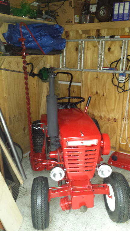

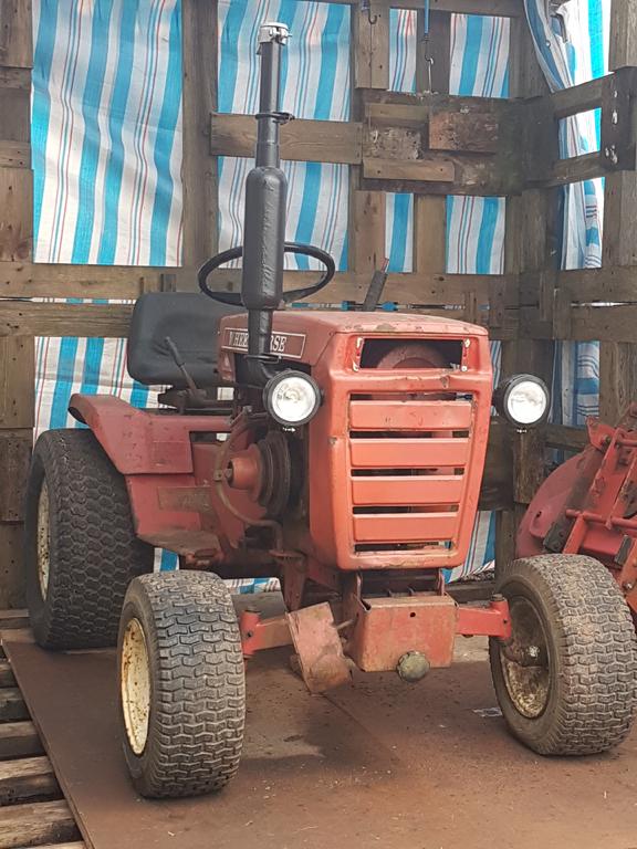

Ian_Courts 77 #147 Posted February 19, 2018 (edited) Got the exhaust fitted today. I now have a Wheel Horse with a Cherry Bomb!! Edited February 19, 2018 by Ian_Courts 7 Share this post Link to post Share on other sites

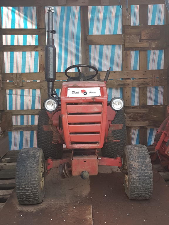

Ian_Courts 77 #148 Posted February 20, 2018 Home made escutcheon plate fitted today. 3mm plasticard & an ebay decal 4 1 Share this post Link to post Share on other sites
19richie66 17,950 #149 Posted February 20, 2018 (edited) It fits the bill. Looks good to me. Edited February 20, 2018 by 19richie66 1 Share this post Link to post Share on other sites
tunahead72 2,662 #150 Posted February 20, 2018 On 2/18/2018 at 8:10 PM, Ian_Courts said: Got the exhaust fitted today. I now have a Wheel Horse with a Cherry Bomb!! Cool, can't wait to see the video! There is a video, isn't there? 1 Share this post Link to post Share on other sites
